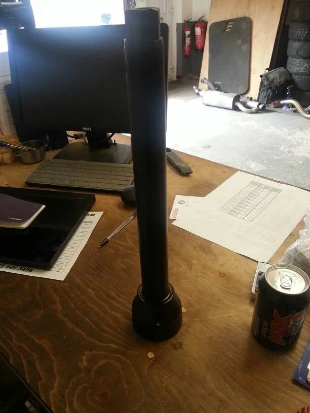

I've got an extra long 21mm and 22mm for this very reason... not that it helps you though lolz.
Mole grips tight on the inner tie bar will help you to
