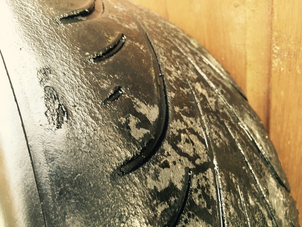

I'd like a bit of advice please. I ran my RSRs at 30psi hot and they didn't like it, one of the shoulders has all but gone but I'm concerned about this one bit......
I'd like to swap the fronts left to right and ideally run them one more day......opinions on whether they're ok or not?

Looks like it's gone through to the cords, I wouldn't be putting that anywhere near my car personally.
