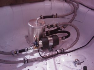

If it's in the car then yes. Our is in the spare wheel well, then covered over. I'll try and find pics for you, but they are in our build thread.

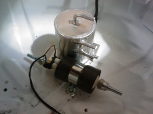

Last summer we did a few track sessions at a car show held at Mallory Park. The car suffered from really bad fuel starvation around Gerard’s. This was with half a tank of fuel so to stop this happening we have fitted a swirl pot and 2nd fuel pump in the spare wheel well. The standard ‘in-tank’ pump will supply the pot (holds about a litre of fuel) and the 2nd pump will supply the engine. This ensures that if the pump in the main tank fails to pick up fuel under heavy cornering forces, the engine wont stutter. The 2nd pump still has the fuel in the swirl pot to draw from and supply the engine untill the in tank pump picks up again.

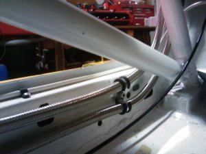

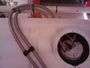

Were using stainless steel overbraided fuel hose to run the lines down the pasenger side of the car. Then through the bulkhead and along to the driver side to where we have fitted the fuel filter. The lines all connected to the swirl pot and fuel pump in the boot. The stock in-tank pump had the braided line treatment. The loom fitted through a grommet in the floor and a steel cover made to fit instead of the standard rubber/plastic one.

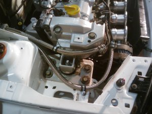

Temporary connections made to the stock fuel lines on the fuel rail.
After running the pumps to bleed the system we then checked for leaks. We were ready for the first start up!!!!
