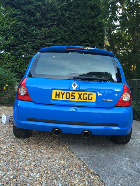

Hey up lads,

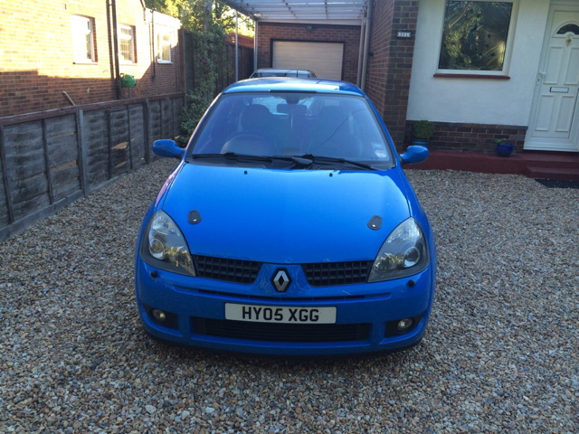

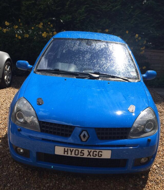

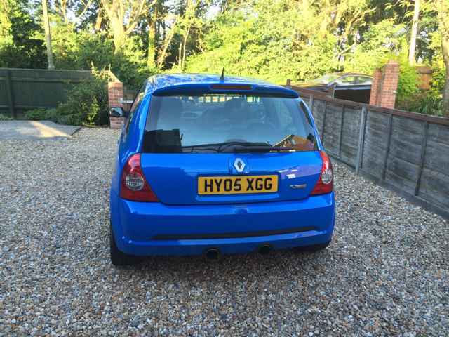

Picked up my clio 2 weeks ago and loving it already, since then I've done a few bits so thought I'd start a thread.....
Here's a pic from when I got her home

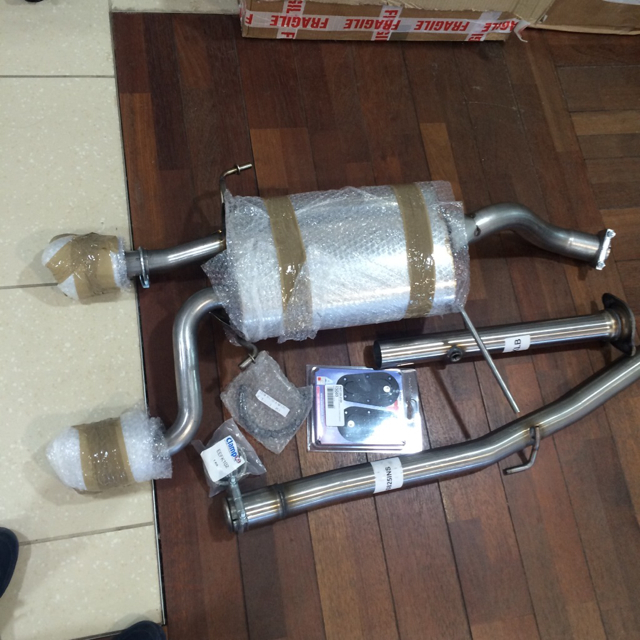

Then the following weekend I went to ktec to pick up a few goodies. Ktec/janspeed supersport exhaust system, ktec decat, aerocatches and some carbon exhaust surrounds.

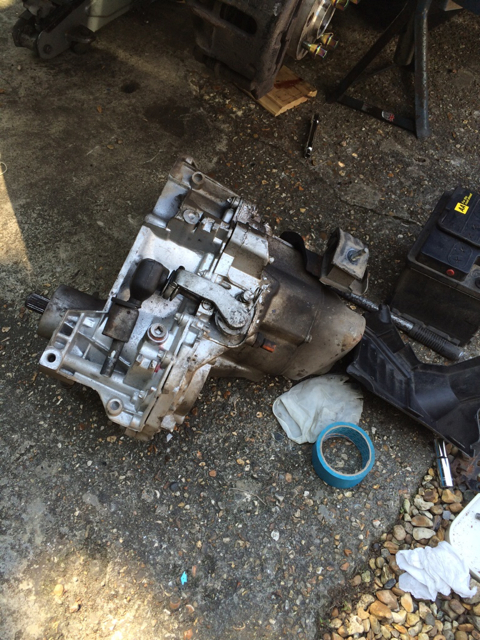

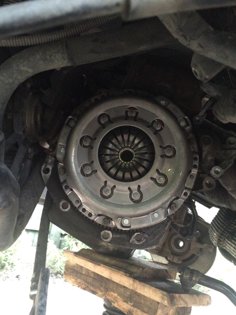

Also the gearbox had a slight crunch from 4th to 3rd so took the box out on Wednesday, was sent to agency transmission for a full rebuild. Took me just under 4 hours to get it out on my own on my drive

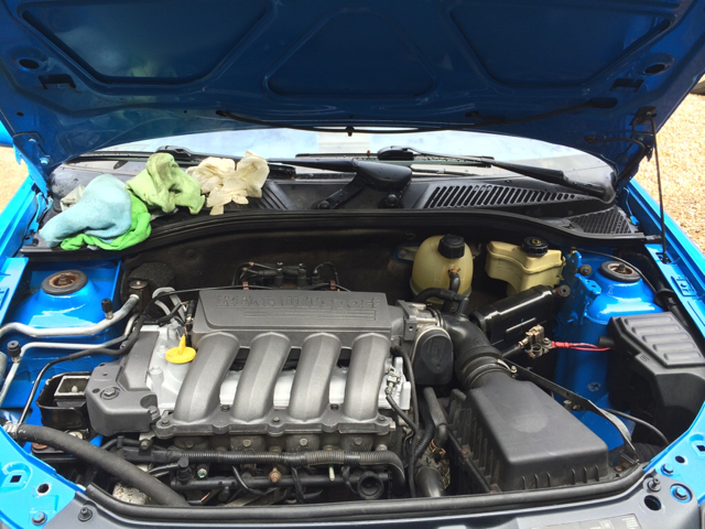

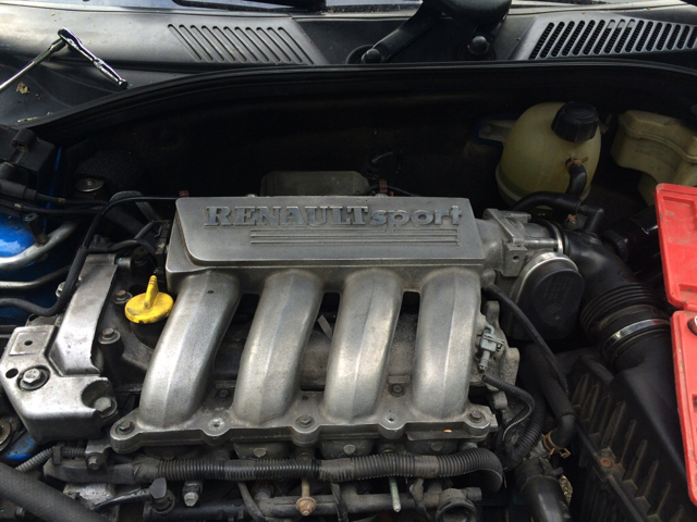

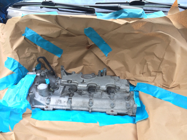

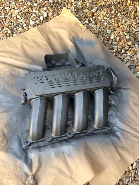

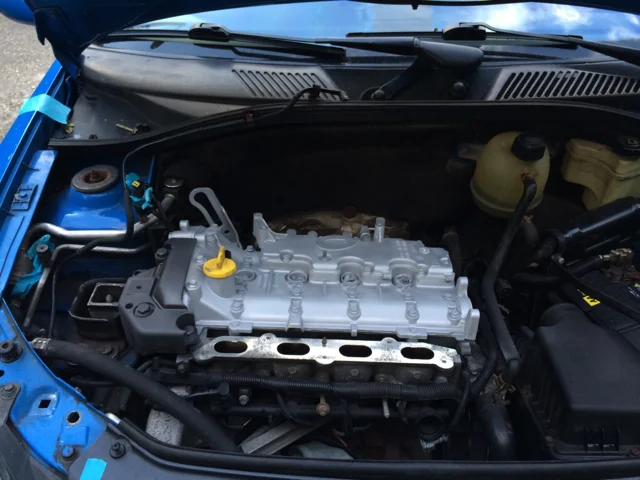

And whilst the gearbox is at agency transmissions I've done a few little things. Fitted a new LUK clutch, fresh set of NGK plugs, sprayed the rocker cover and inlet manifold, changed the engine oil and filter and gave the engine bay a little de grease.
Will be doing loads more to the car so just keep an eye out

Nice work. Out of interest did you drop the full subframe, just the passenger side or did you go out the top when removing the gearbox? Got to do mine next weekend and thinking I'm going to just remove the subframe and hope the captive nuts don't give up on me.
I removed the subframe
Mate, left the struts, calipers and hub stills on! Comes out easy then

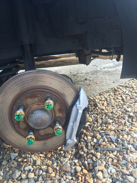

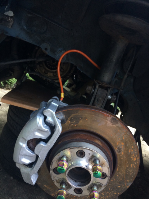

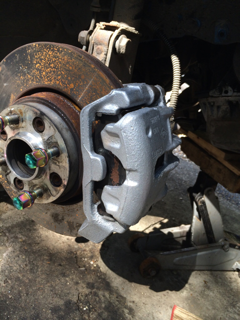

Gave my calipers a paint today took them off, wire brushed them down and gave them 2 coats of silver hammerite smooth!
http://img.tapatalk.com/d/14/06/29/eda6asub.jpg[/IMG
Also fitted my aerocatches as well.

Nice mate, i see you have 20mm front spacers?
I am looking for a set of tpi bolts like yours, have yours been cut down to fit?
Yeah mate, spacers were on the car when I bought it, so were the bolts. I don't think they've been cut down, thread looked pretty normal.
Threads were trimmed by about 2-3mm mate, they were bottoming out on the hub at the standard length.

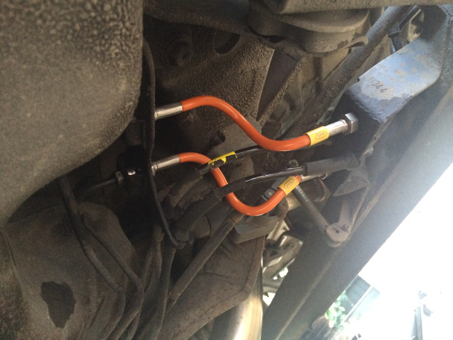

Just ordered some new plates with the 3/4 front plate, hel braided lines, ate super blue racing brake fluid, new coolant header tank, renault coolant and a citroen c2 ariel, hopefully they should all be here by tomorrow
Plates and the braided hoses turned up today so got them fitted also fitted some new rear brake pads and painted the rear calipers. Slightly annoyed as I payed an extra £5 postage from euro car parts for some bits to be delivered today but they didn't so I'll be ringing them up in the morning.

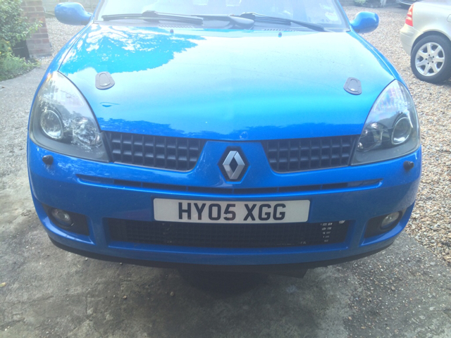

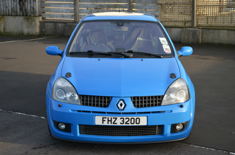

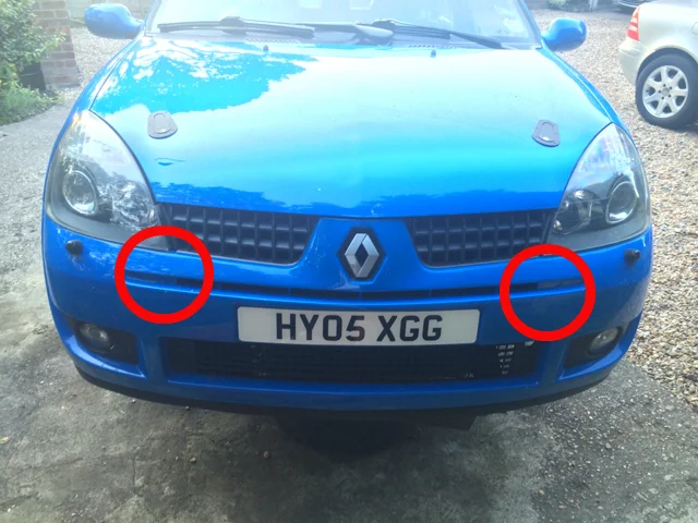

Get some of the oem black front bumper inserts as your bumper must've been repainted.
Looks good. Nice touches so far!
Thanks mate, yeah it had them on when I got the car but they were tatty so I removed them, where can I get some more?
I've had a hard time finding what is meant by these inserts, can you link me to what they are and where they go? Thanks
Nice car btw, this colour is by far the best imo.
See attached for pics with and without the inserts

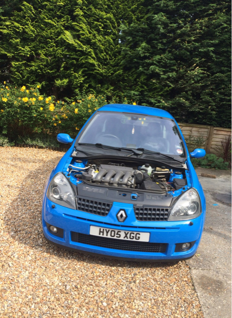

Just a little update!

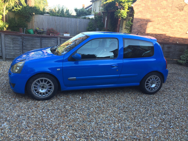

Car is all running now gearbox is in and feels sweet, gear changes are nice and smooth. Also swapped my Turini's and some cash with Bobby. for his 2118's, gave them a slight refurb, put the stickers on and they've came out pretty good, here's a couple of pics
Trev

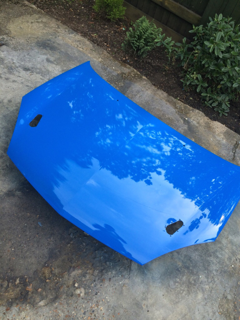

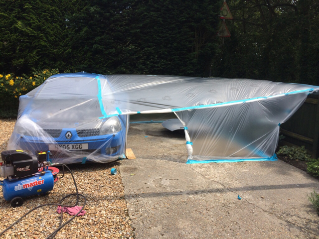

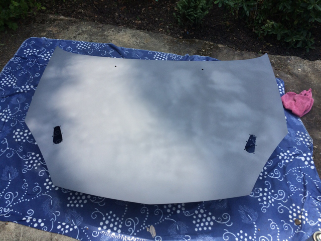

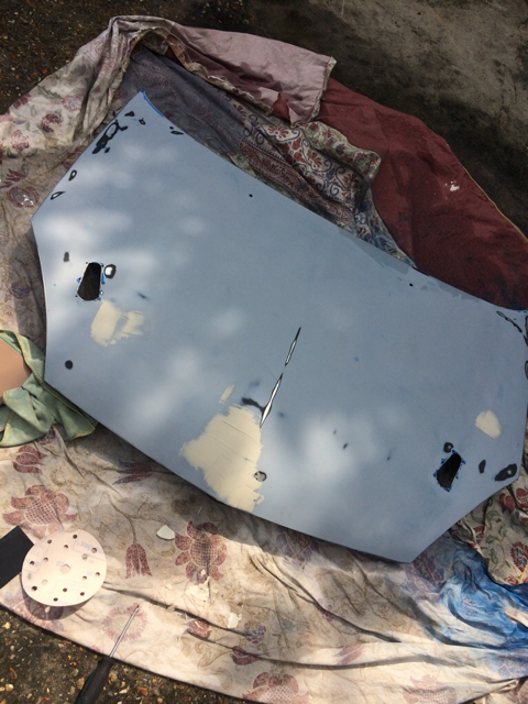

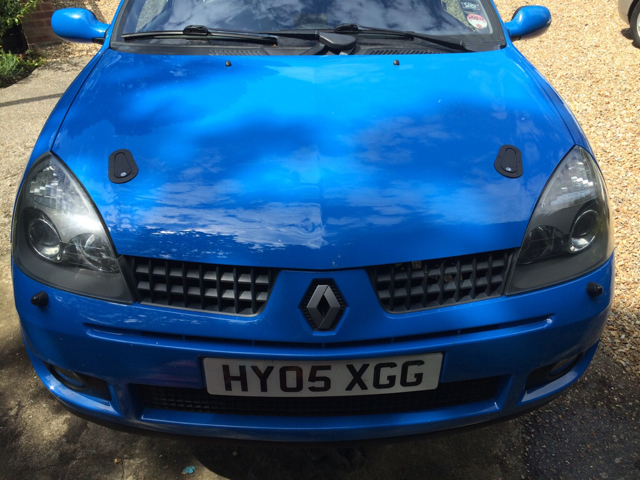

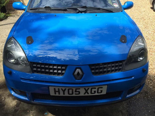

Sprayed the bonnet over the weekend, it hasd a massive stone chip on the front and major lacquer peel on one side, came out pretty good for a home job and the colour match was spot on here's a few pics.
Trev
Added some filler to sort out a few dents
Primed
Homemade spray booth
Top coat & lacquer done
Flatted and polished and finished!
