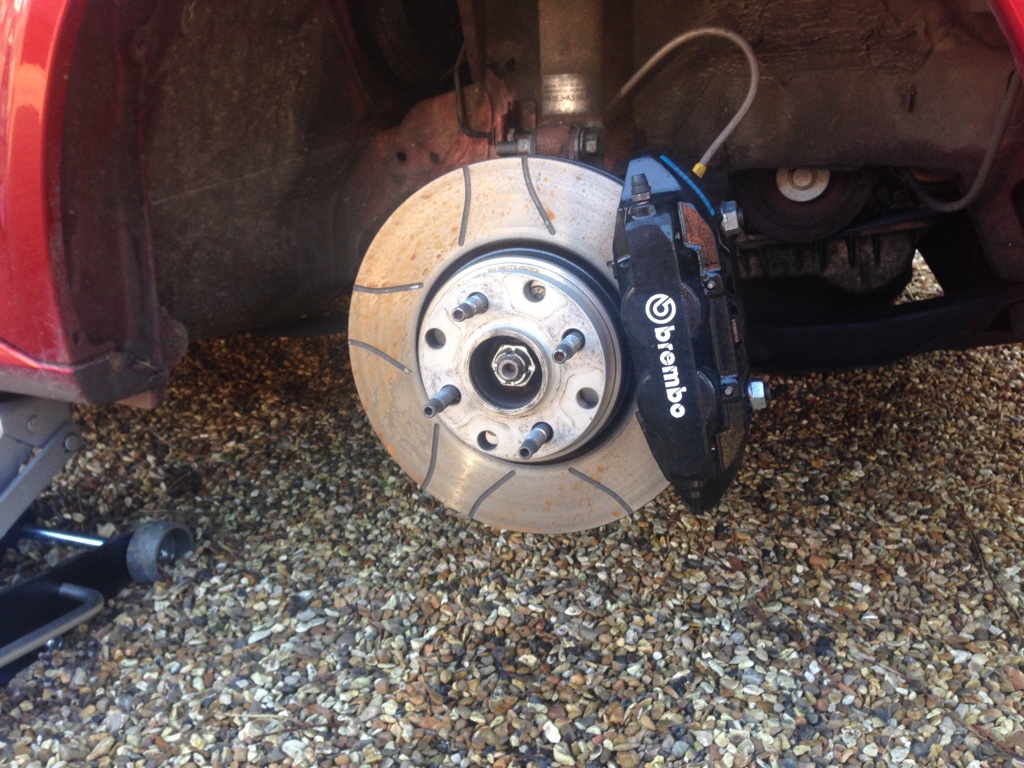

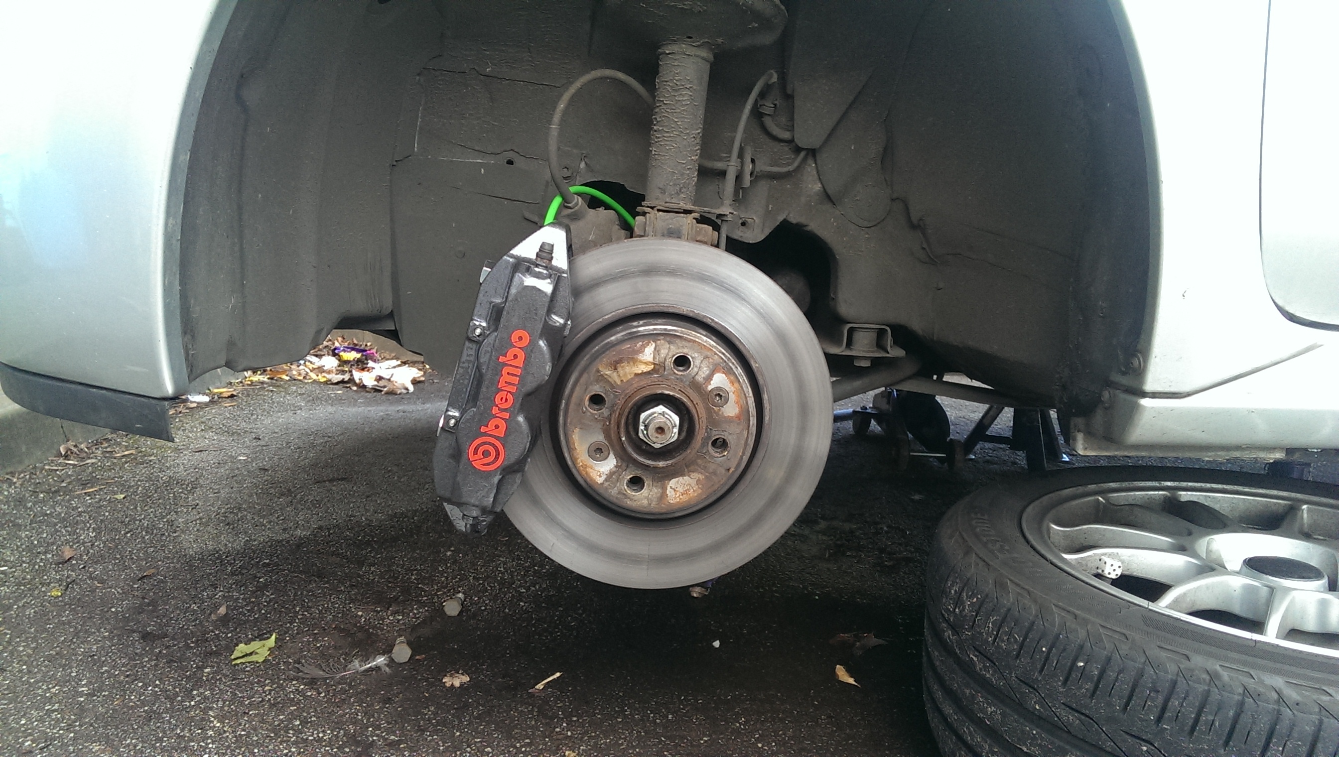

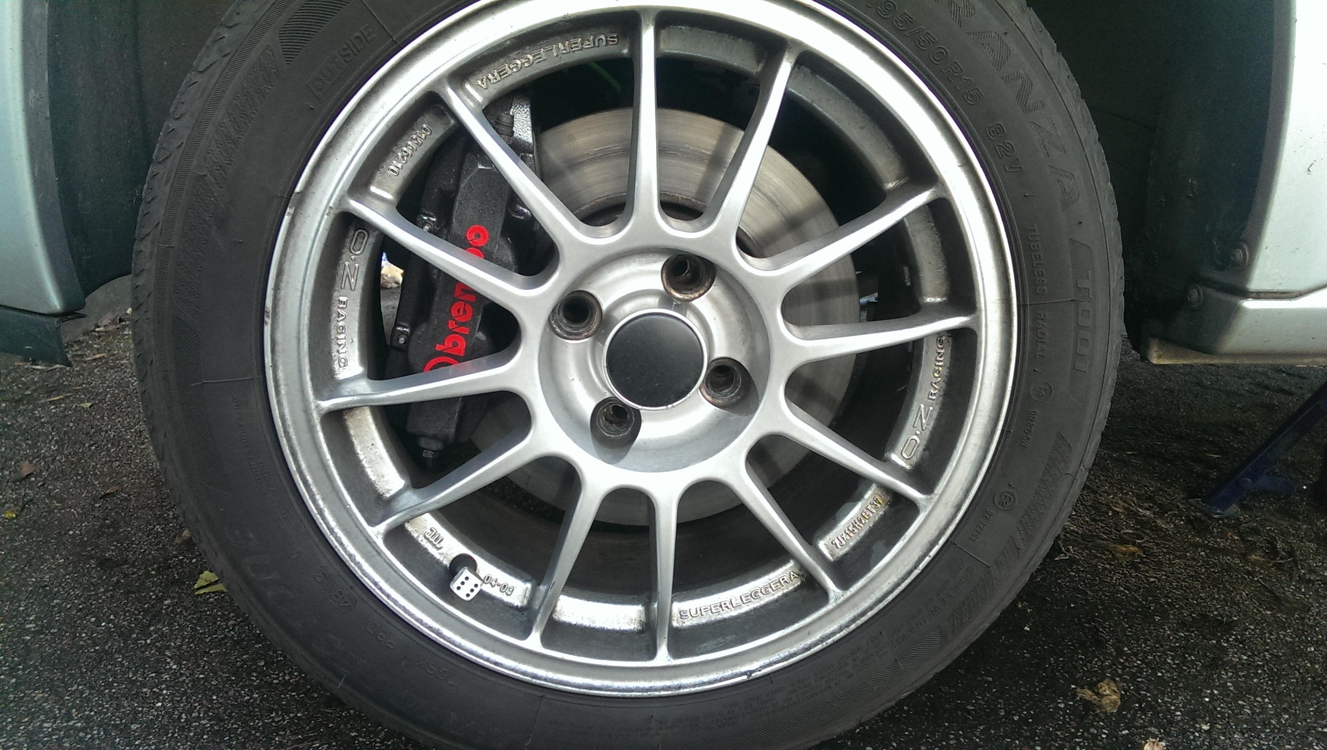

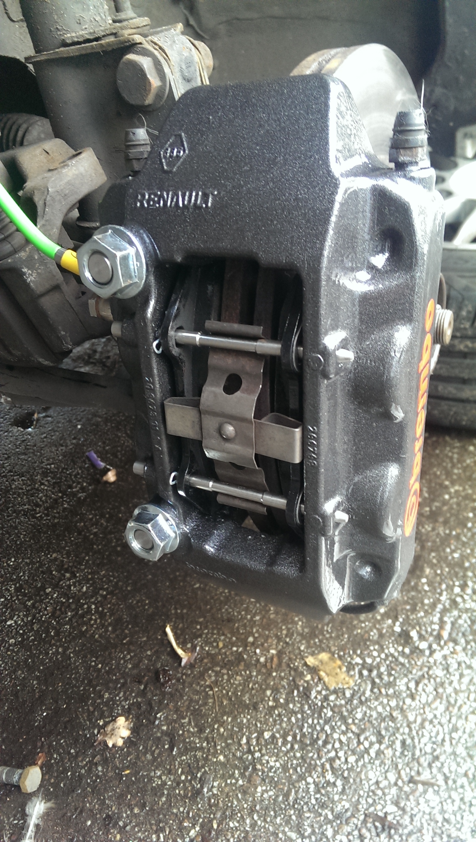

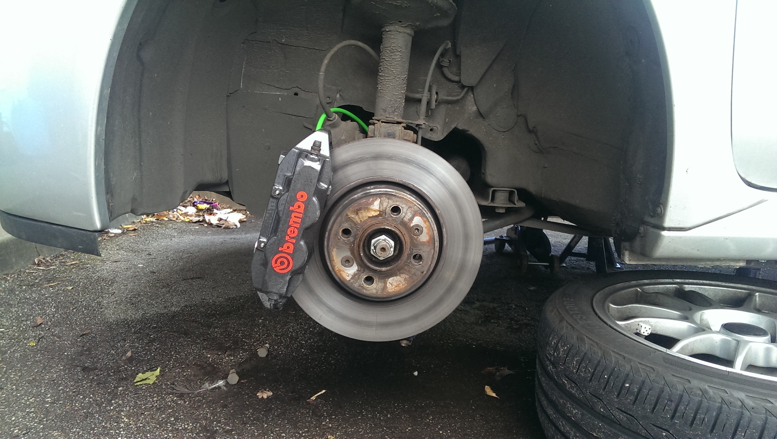

Bolted the 197 brembos on today to see what spacers i need.
280mm setup with brackets from chris powell
Mintex 1144 pads

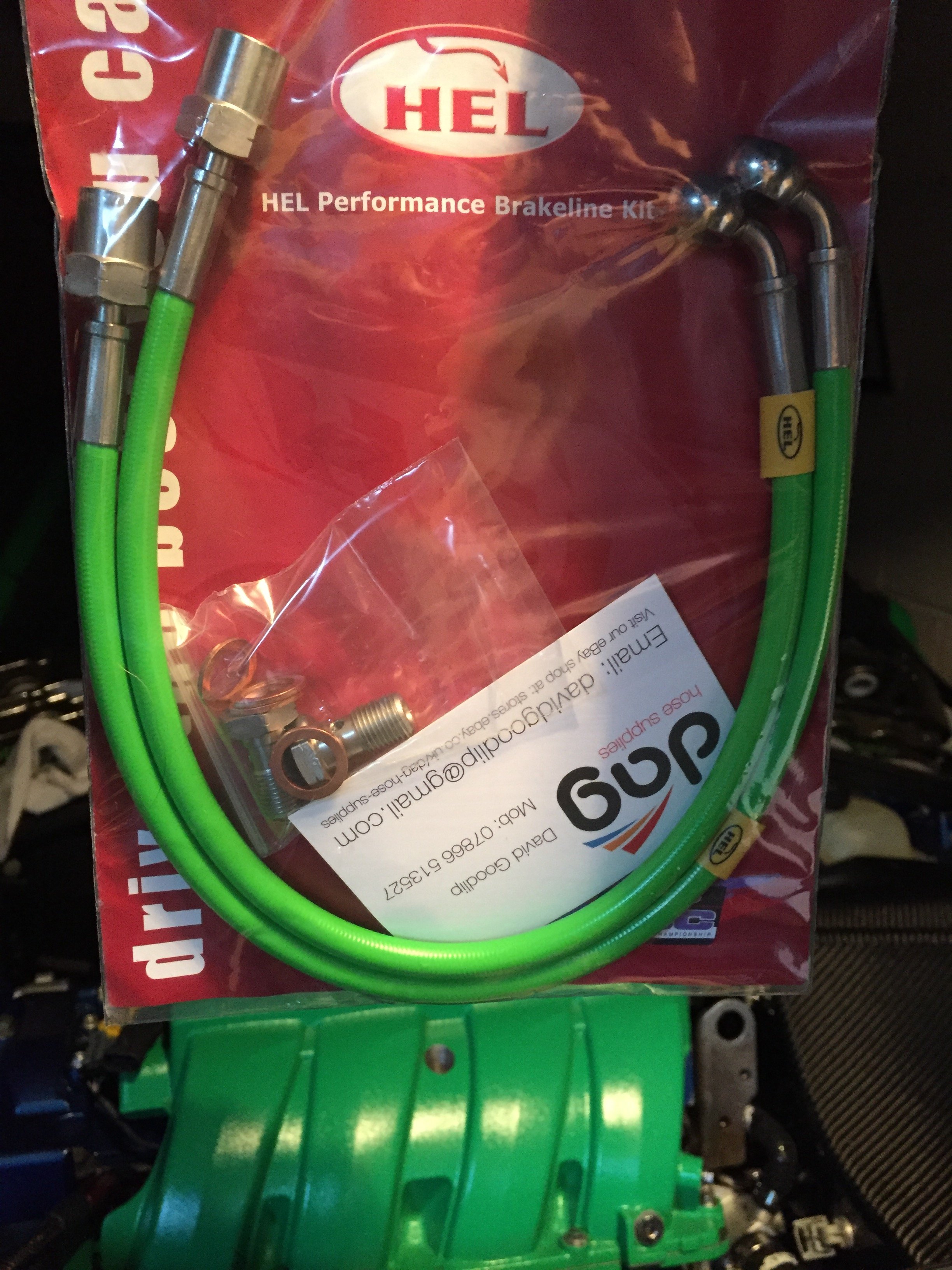

Green HEL lines
Stainless pins and R clips.
Just need 16mm spacers and stud conversion
Few pics.

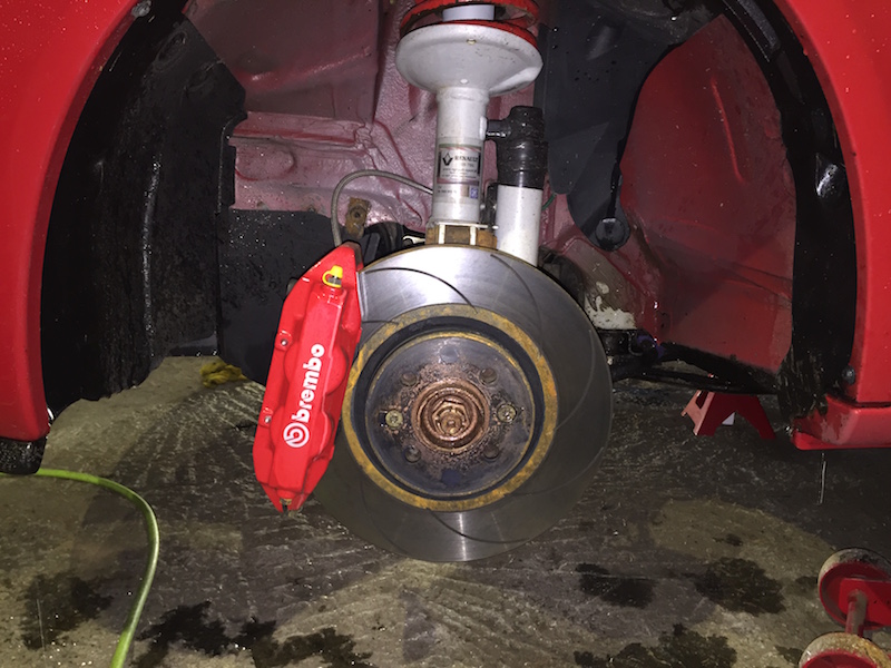

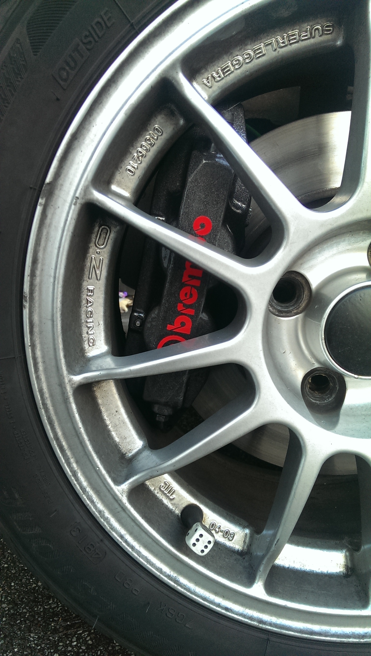

Looking at these pictures even with the 280mm brembo brackets the caliper still does not sweep the whole disc and it sticks out at the bottom like mine do. I take it this is the same with all renault 197/200/Meg225 calipers regardless of the disc size ?
MarcB
  Too Many
As @MartinR says, it's all about the pad swept area. You'd need a bell and rotor setup of you didn't want the rusty unswept area around the disc. That's what I'll be doing on mine.
Perfect, Atleast i know that anyone using either 280 or 300mm set up with genuine Renault calipers will more than likely have this issue.

Tbf i hate that ring and have always done. Even with standatd calipers on most cars this happens but it seems alot larger on the 300 mm discs.
Bell and rotor is a great option but an expensive one just to eradicate a ring of rust. Although i do agree it rotors and bells look loads better

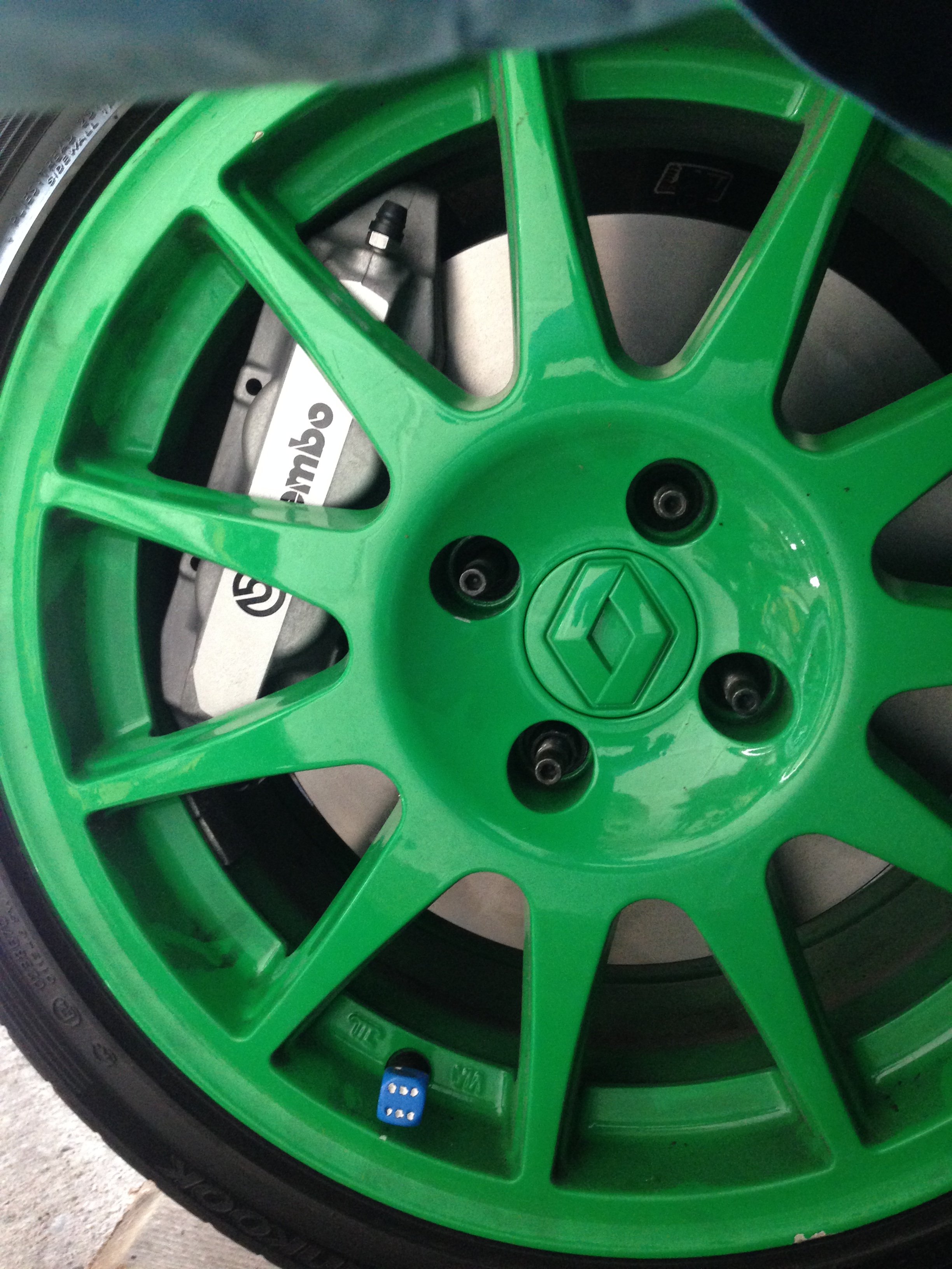

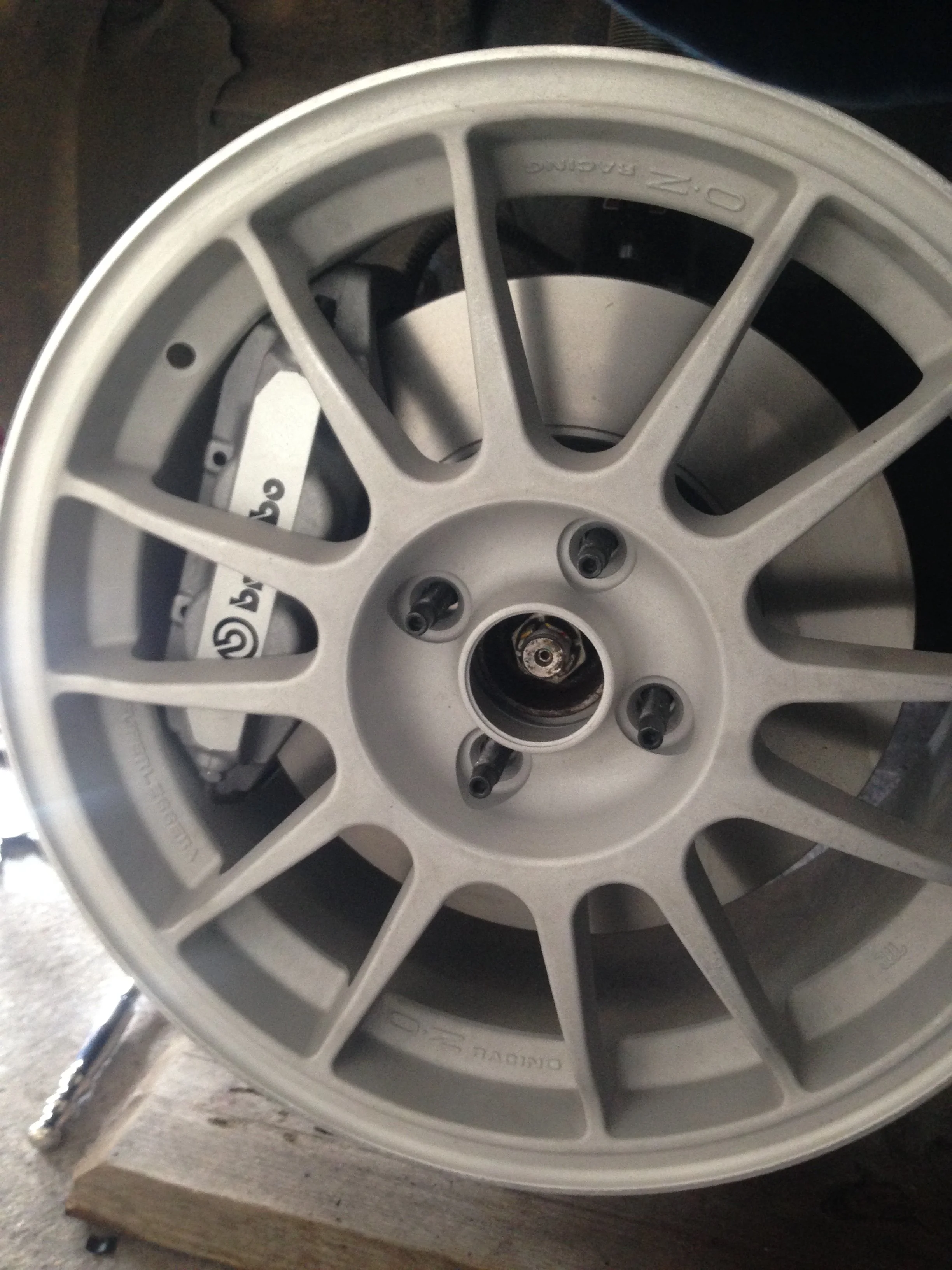

@MarcR™ I had my brackets machined quite a bit, and this is as good as I can get the pad swept area. On 280s obviously. Pretty much the same as Martins but I don't get the "rusty ring". Snigger.
  172

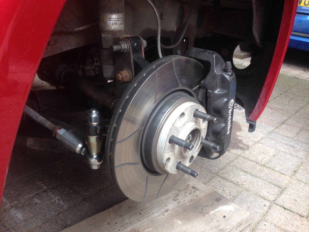

Oh, some proper fitting brackets! :) Improves the questionable amount of thread engagement on the stud/nut too.

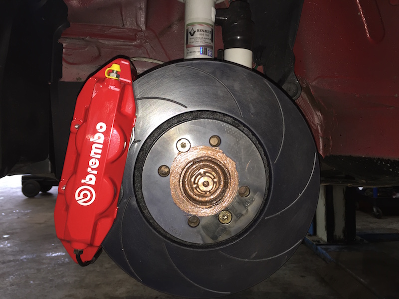

Really need to see someone that fits the 300mm discs..any takers?
Crybert
  Cup 172
Cool, I did think that. Space is very tight there..will it be the same on a cup turini then? I've been told they won't require machining. My heid is mince

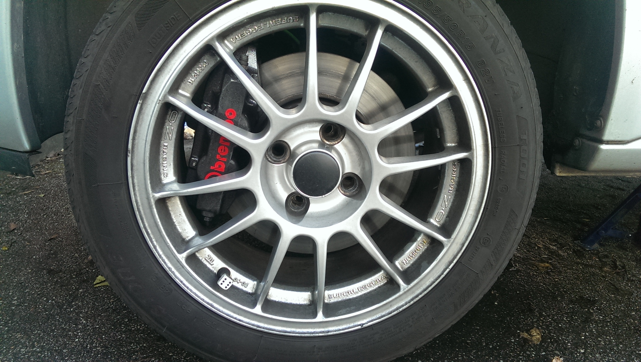

So would it just be a case of 197 brembos and the brackets to fit under 15" wheels? Obviously spacers too.
It's just I see that some people sell calipers and say they're from 197/200. I presume they are the same. It's the megane calipers that bigger?
Master cylinder stays the same? I'm talking for a ph2, not ph1.
No spacers and a cup turini.
You can't run wheel weights where the caliper runs though!
Yeah your going to need a spacer mate. Not all 15's will fit so choose wisely. My 15" turinis wouldn't fit over @Cub. 's setup. Ever!!
197/200/225/230 brembos are all the same. 250's have a larger pad area and they're total overkill for a Clio though tbf.
Standard master cylinder will work, there's just a bit more travel, albeit nothing horrendous I'm led to believe.
