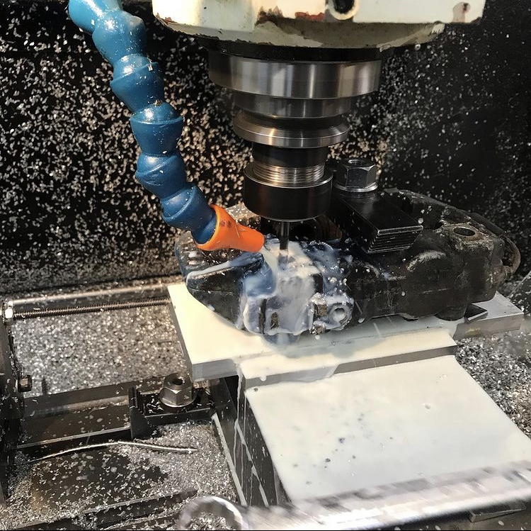

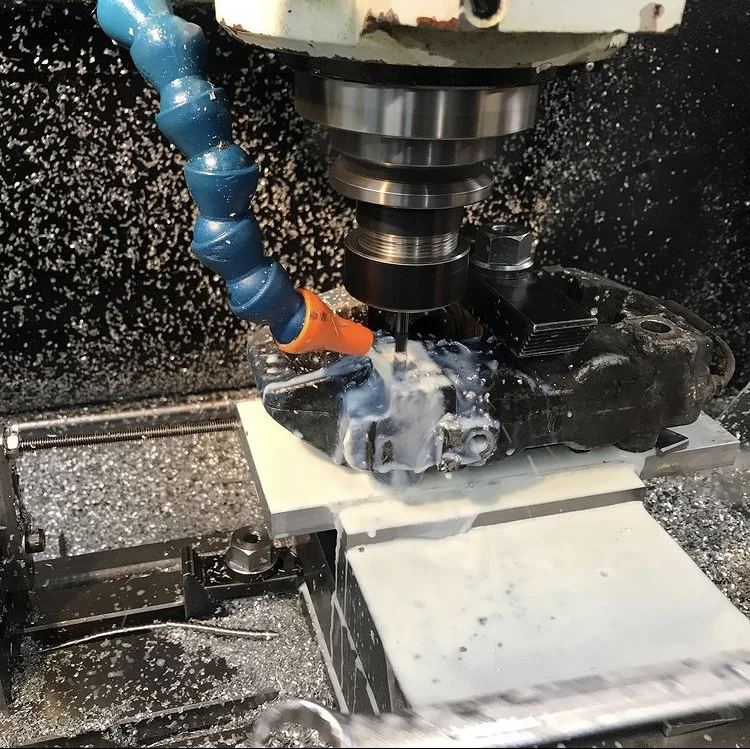

I machined mine myself. Sadly I’m all the way in Gloucester. If you’re stuck then you could always post them to me and I’ll take the 5mm off for you as I’ve still got the mounting plate I made to do the job

They're basically counter bored, but the tols are tight. It's definitely doable but obviously harder than taking 5mm off
