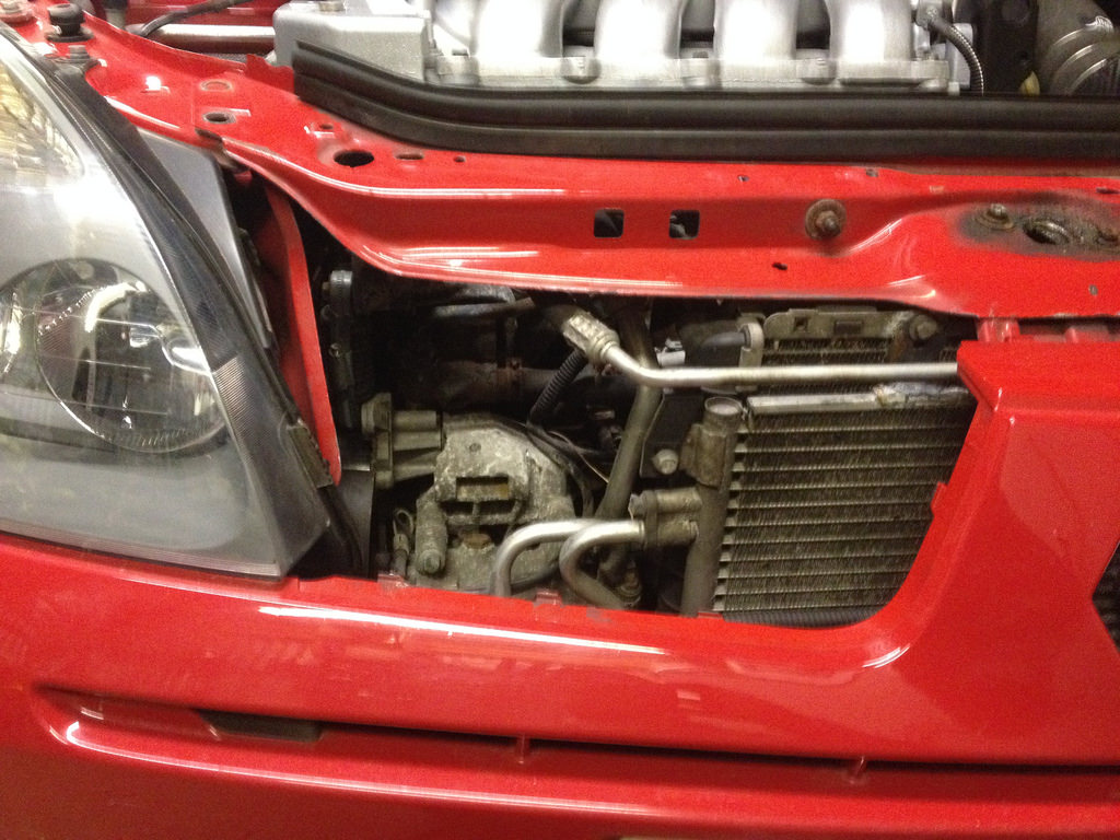

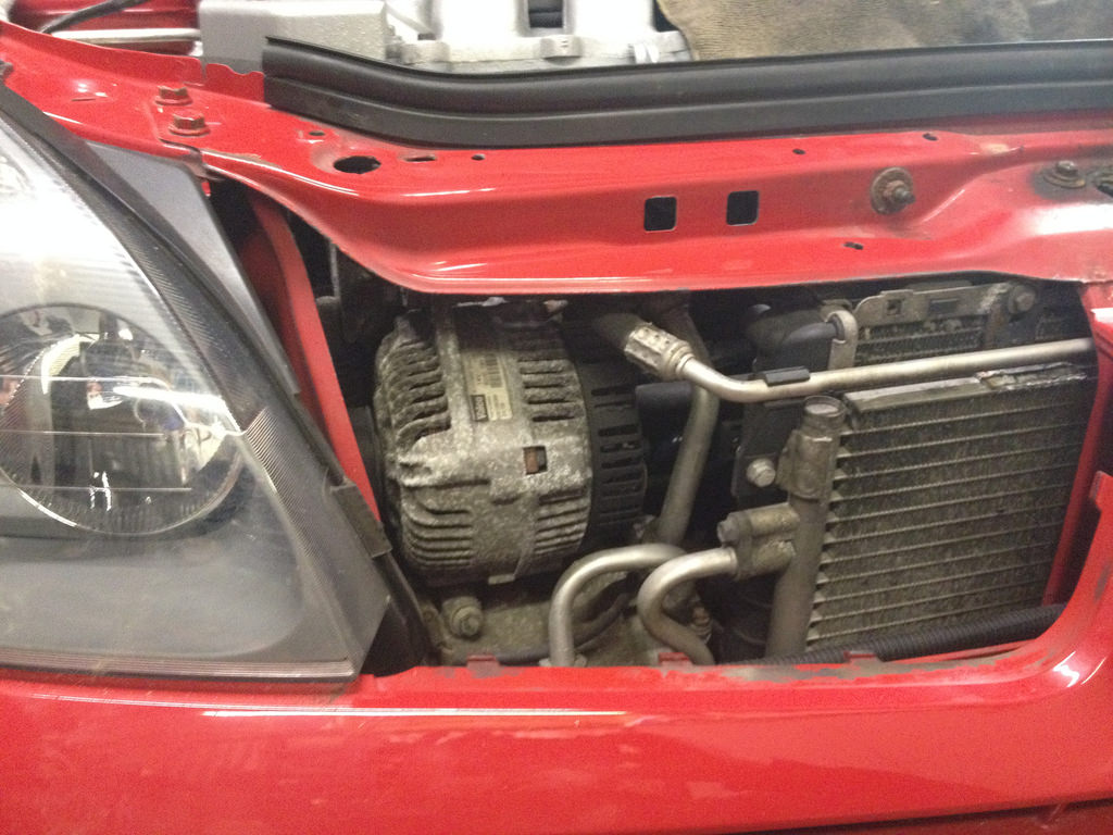

Had initially thought of taking the whole bumper off but more I looked the more unnecessary it seemed to be if I could just get the grill off instead, would save me having to jack car up to get at the bumper bolts etc etc.

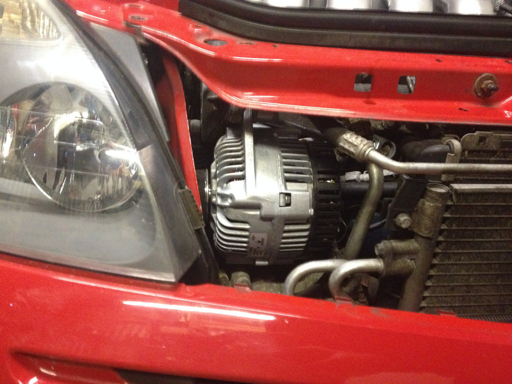

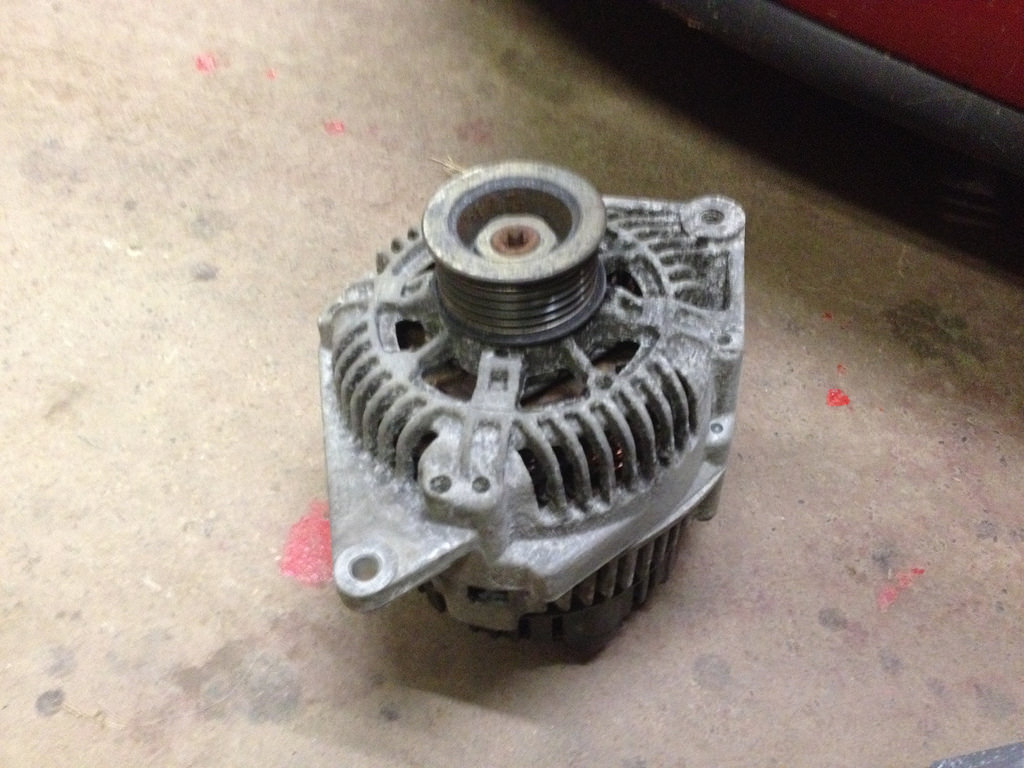

Off with the grill, fuel rail guard and cracked on with getting it out. What a right pain it was, the long lower bolt just did not want to slide out and then the joy of thrying to get the tension off the belt. Had bought a tool but that was about as much use as a normal ratchet with the space and the angle.
IMG_0783 by KeithRoberts185, on Flickr
Was begining to loose temper with it but a quick cup of tea and a post on here, thanks to @NorthloopCup 's reply and got into the jubilee bin and got the tension taken off and after swearing some more and wrecking my hands I got to this stage late afternoon.
IMG_0786 by KeithRoberts185, on Flickr

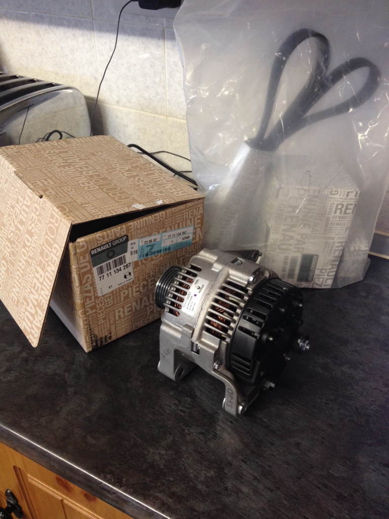

Alternator had deffinately seen better days, bearing shot and the nice smell of burnt windings.
IMG_0787 by KeithRoberts185, on Flickr
Literally 30 seconds to get new one in through hole and located compared to about 10min of cursing getting old out and few min later all done. Lug was fine too, some corrosion on nut but fine otherwise.
IMG_0824 by KeithRoberts185, on Flickr

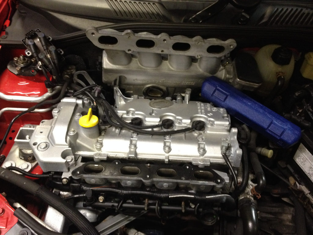

Onto following week and now with it running again needed to sort the stuttering issue that I had had before alternator failed. Was only noticable on load between 1-2k rpm.
Pretty certain it was one of two things, 1 ignition issue or 2 injector issue. I wasn't getting any EML up and there weren't any codes saved so first thing I wanted to eliminate was an injector issue with the spray pattern.
Had a spare set and cleaned them up in an ultrasonic bath followed by bench testing them at work to make sure they sprayed as best as I could with what I had. Unfortunately this didn't solve the problem although it was slightly better.

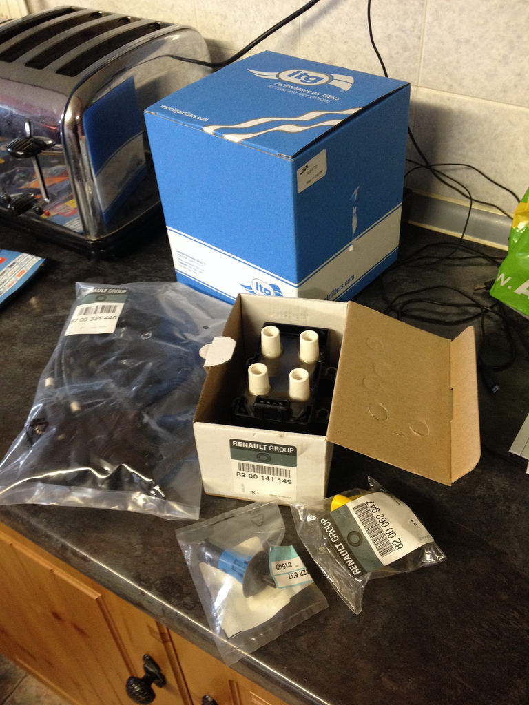

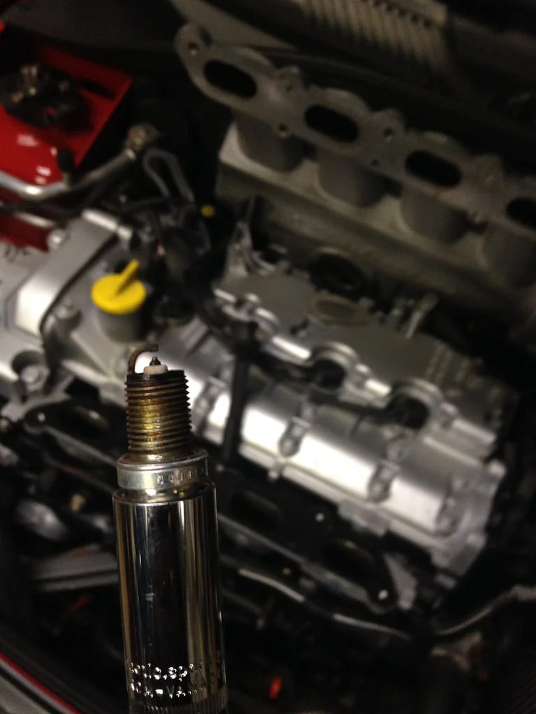

Next up as it needed some anyway was a nice new set of plugs. Old ones all looked pretty good for age/mileage but changed anyway. Didn't make any difference.
IMG_0831 (5) by KeithRoberts185, on Flickr

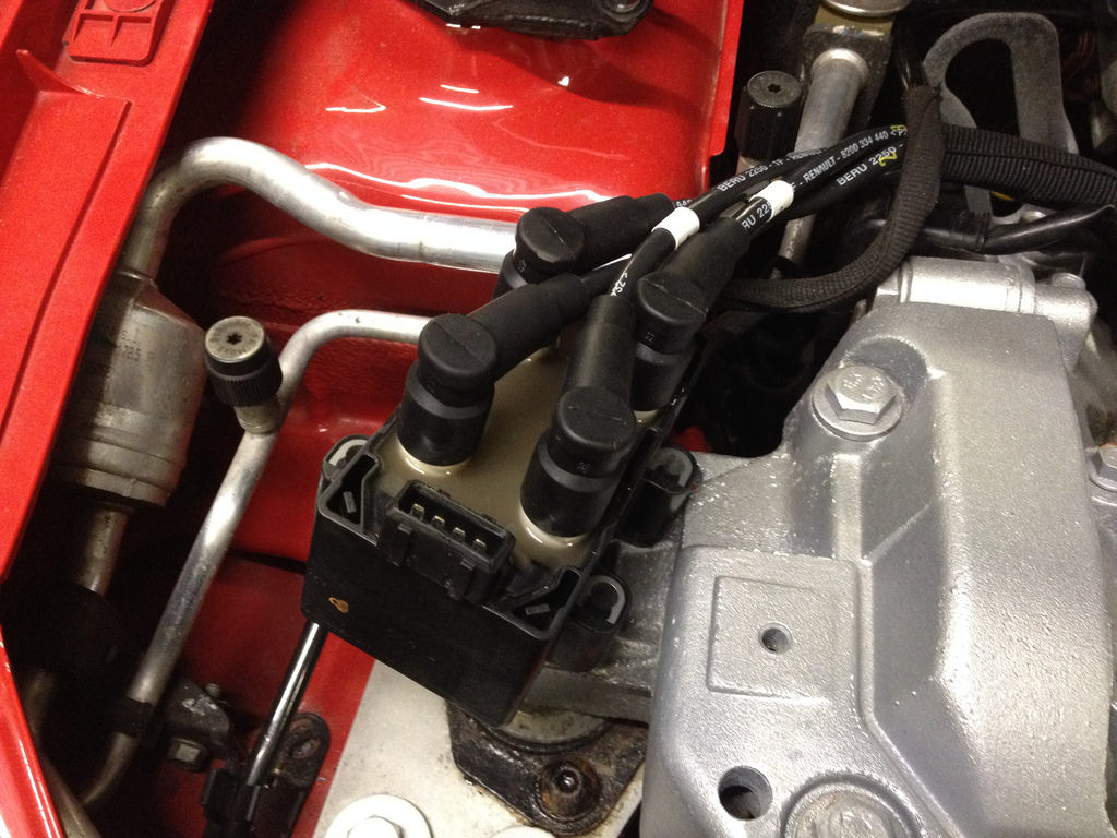

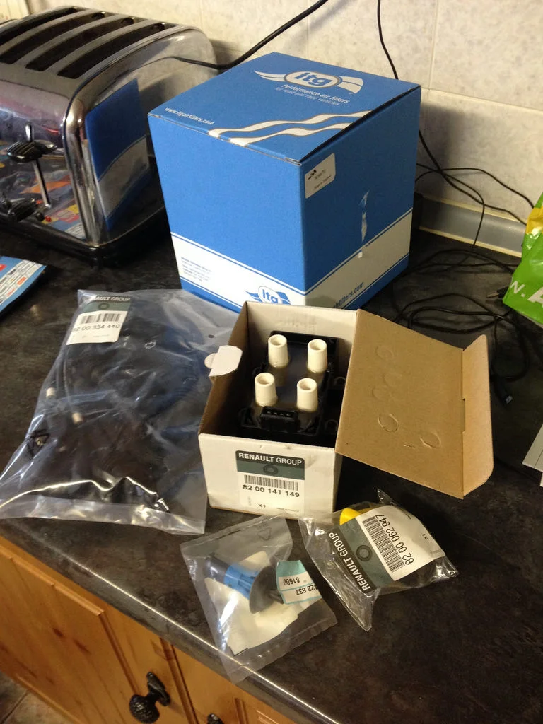

So next step was the coil pack and leads and again had a spare set from years ago that I had to go digging for, put them on and bye bye stutter :smile: From looking at the coil pack I'd have said it was most likely this as underneath out could see the casing pulling away slightly from the insulating moulding. For peace of mind and they're not much got a nice brand new coil pack and leads fitted (tbh they were on cards to be changed soon anyway)
IMG_0925 by KeithRoberts185, on Flickr
IMG_0927 by KeithRoberts185, on Flickr
IMG_0929 by KeithRoberts185, on Flickr
IMG_0827 by KeithRoberts185, on Flickr

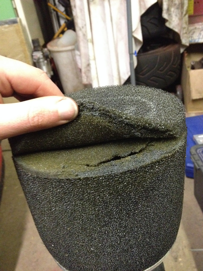

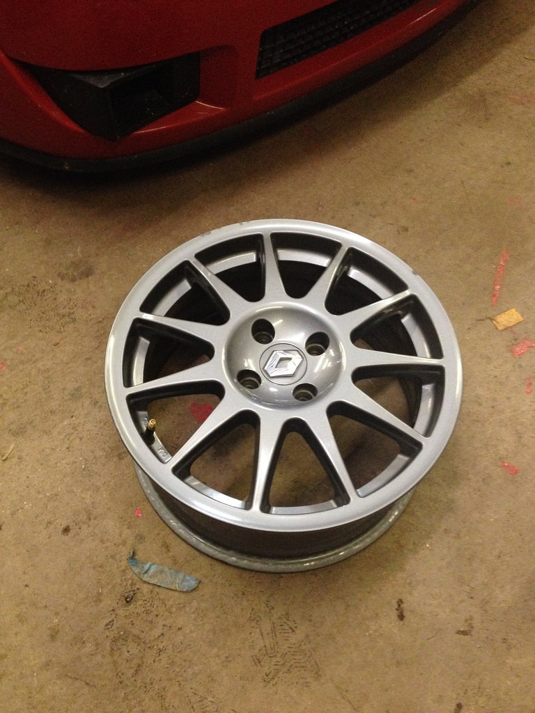

All running great. Next on job list was a quick clean to the air fillter, unfortunately I was greeted to this ...
IMG_0905 by KeithRoberts185, on Flickr
Was not happy, but from looking at it and inside the airbox I can only put it down to over oiling and that cars been standing a bit last year or so meaning the oils pooled at lowest point in fillter and settled there as rest of fillter was fine. So got online to merlin motorsport and couple days later had new one. For future referance its a JC60 cylindrical with an 70mm ID inside the Maxogen
IMG_0933 by KeithRoberts185, on Flickr
Another spare to add to the collection off good old eBay, very little curbing and very light where it is. Got it for a good price too complete with center cap..

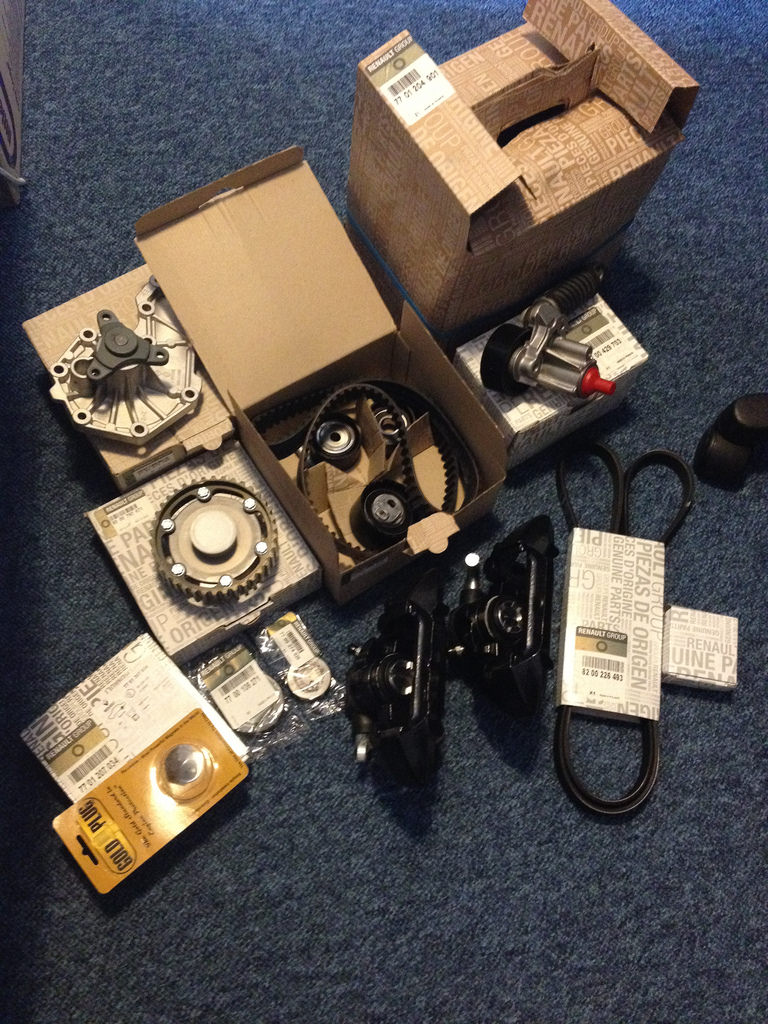

Got little red booked into the guys at Birchdown next month for the Belts , dephaser (which I almost forgot I had bought) waterpump, rear calipers, disc, pads and handbrake cables along with engine and gearbox oil change.
Then trackday at Ty Croes - Anglesey in June.
One of my little parts collection for Birchdown
photo 2 by KeithRoberts185, on Flickr

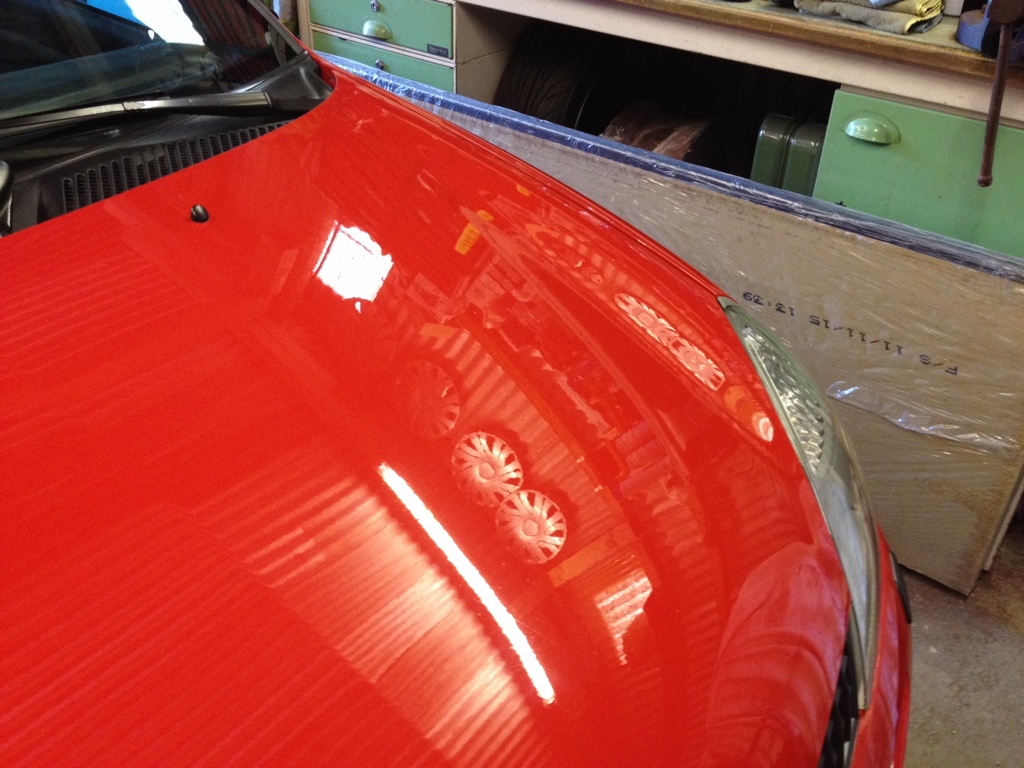

Not much of an update really but has taken some time, given it it's first wash this year. Rinse, Snow foam, iron x, wash and clay. Wheels gone over. Followed by going over body with a DA using Megs cutting compound, zaino polish and sealant the following weekends. (Used the Fx kit too)
Not perfect but no point going to that level with way it gets used imo.

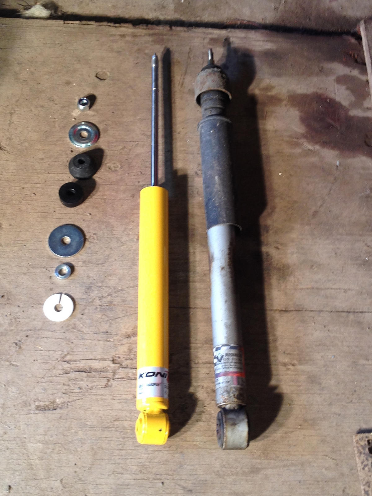

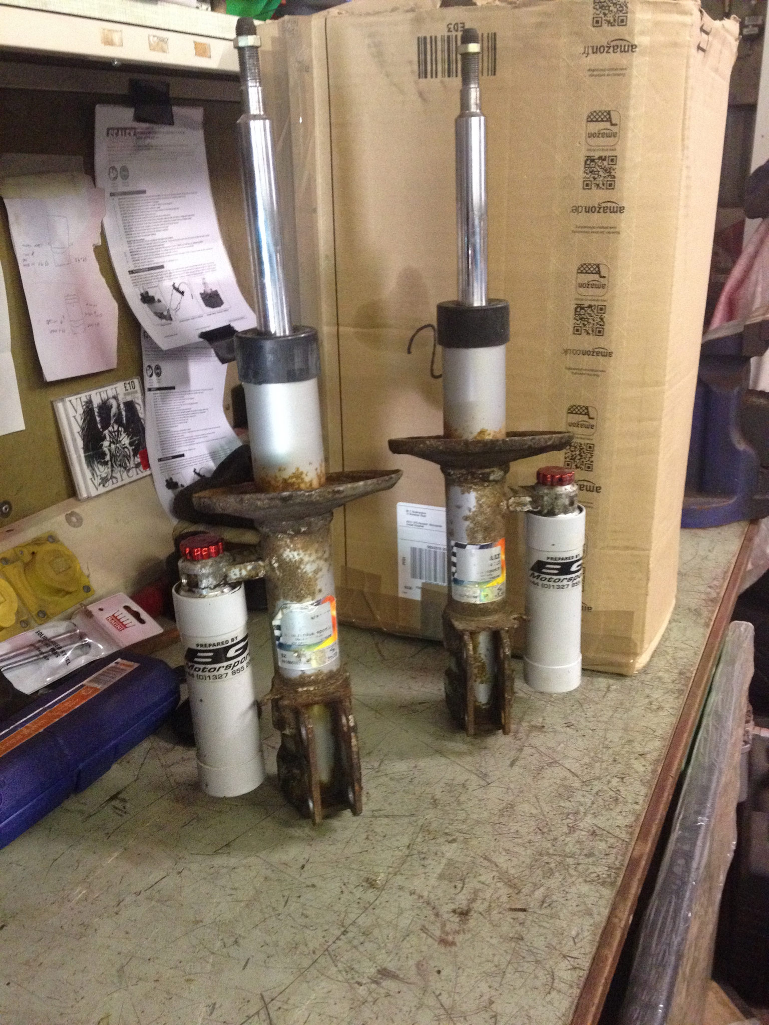

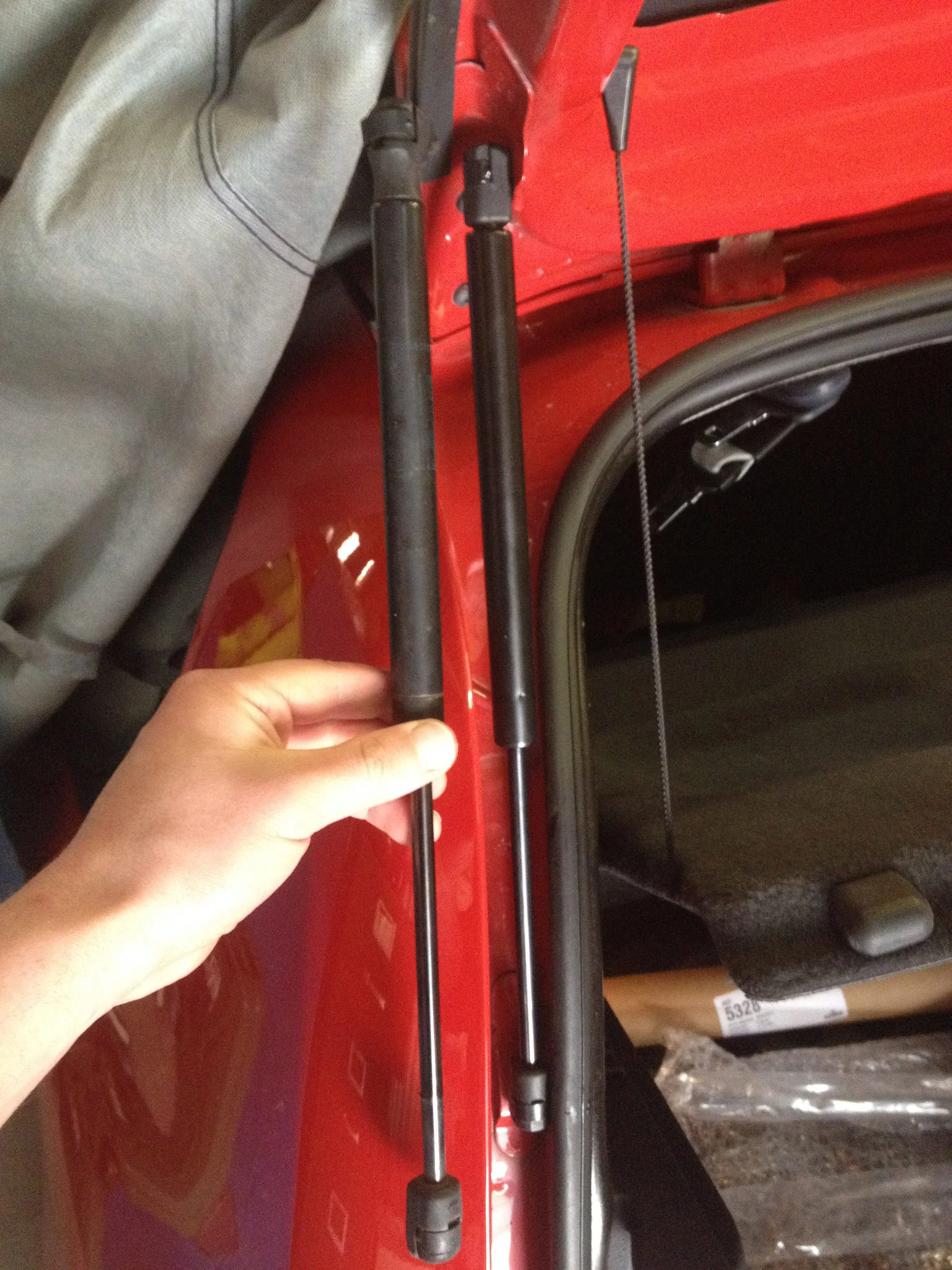

Wanted some adjustment on the rear and to get the standard ones off and kept safe. Had been toying with getting Koni's on the rear for a while and finally got round to ordering them.
Untitled by KeithRoberts185, on Flickr
All fitted ready for next month.

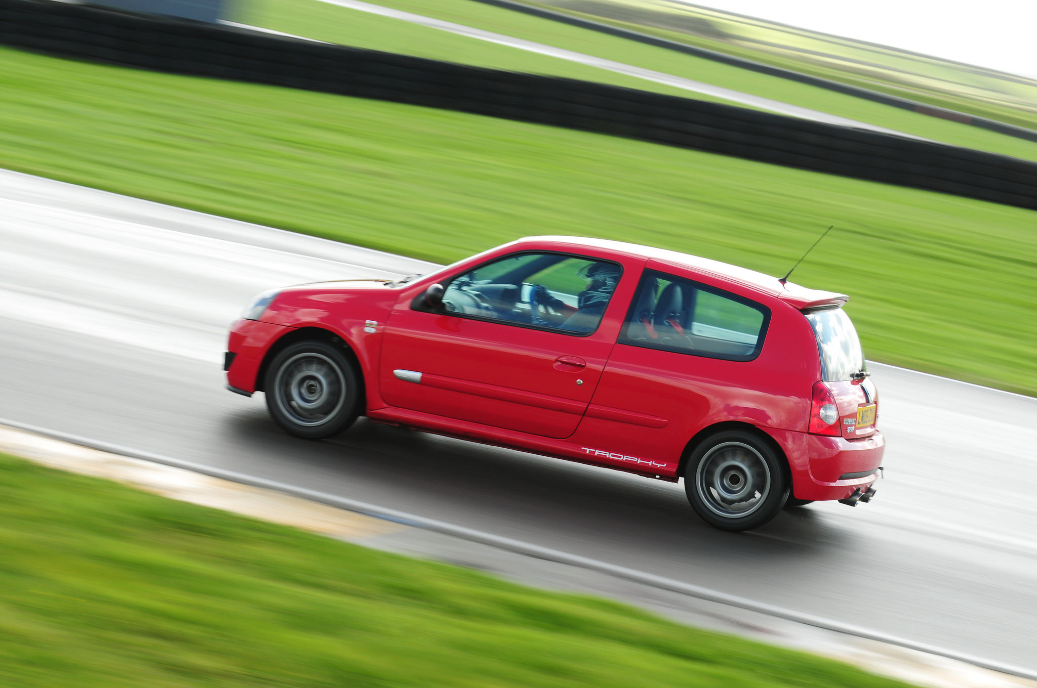

Doesn't come out often now a days but out of the dry into the Welsh summertime to be taken to Group B Motorsport for alignment.
Anglesey Trackday
Great day with great weather. Can't seem to find any photos from the day other than the above.

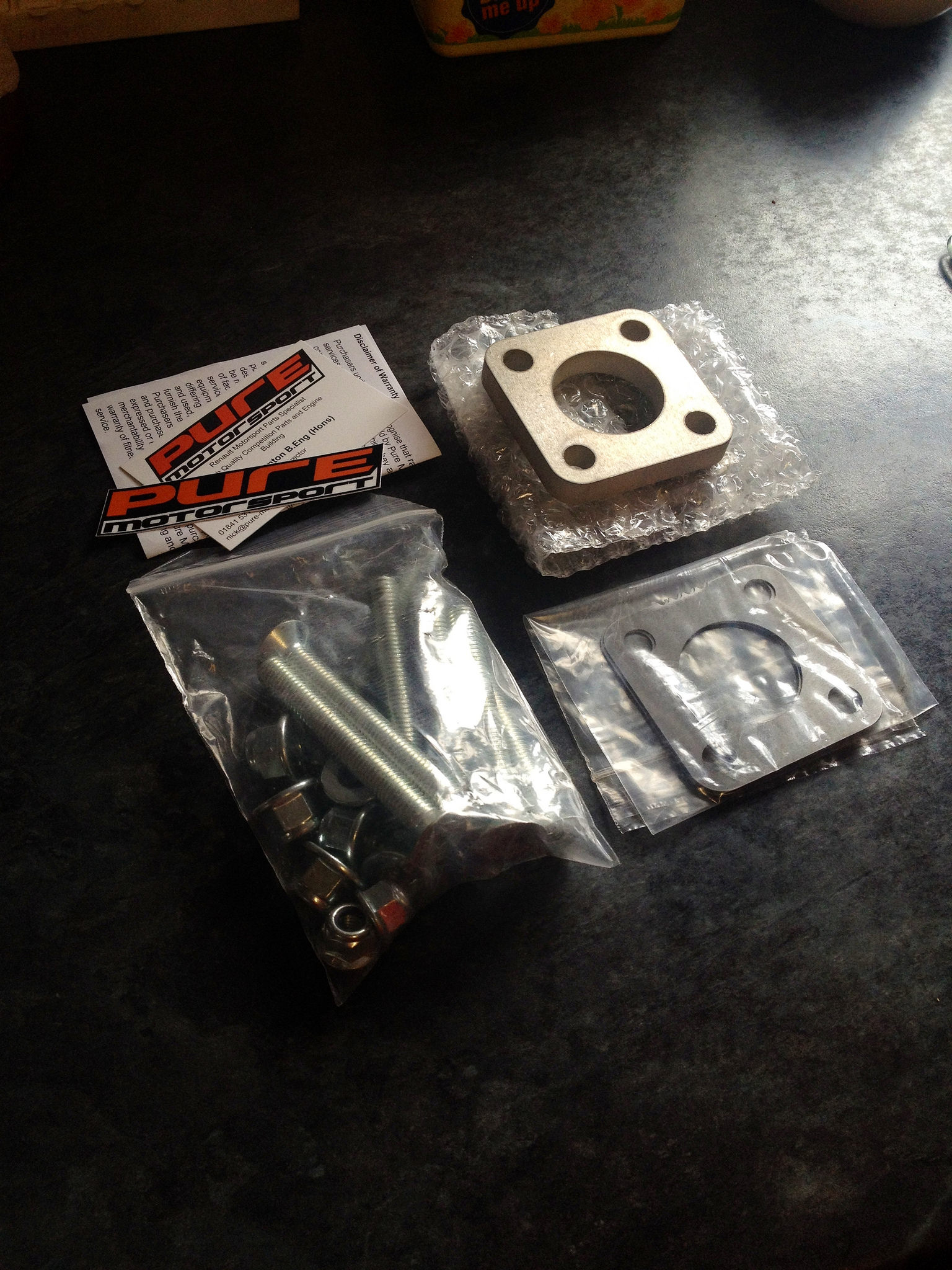

After the trackday decided to order a few bits from Pure Motorsport (Still yet to get around to fitting these lol.) Great finish on them as usual.

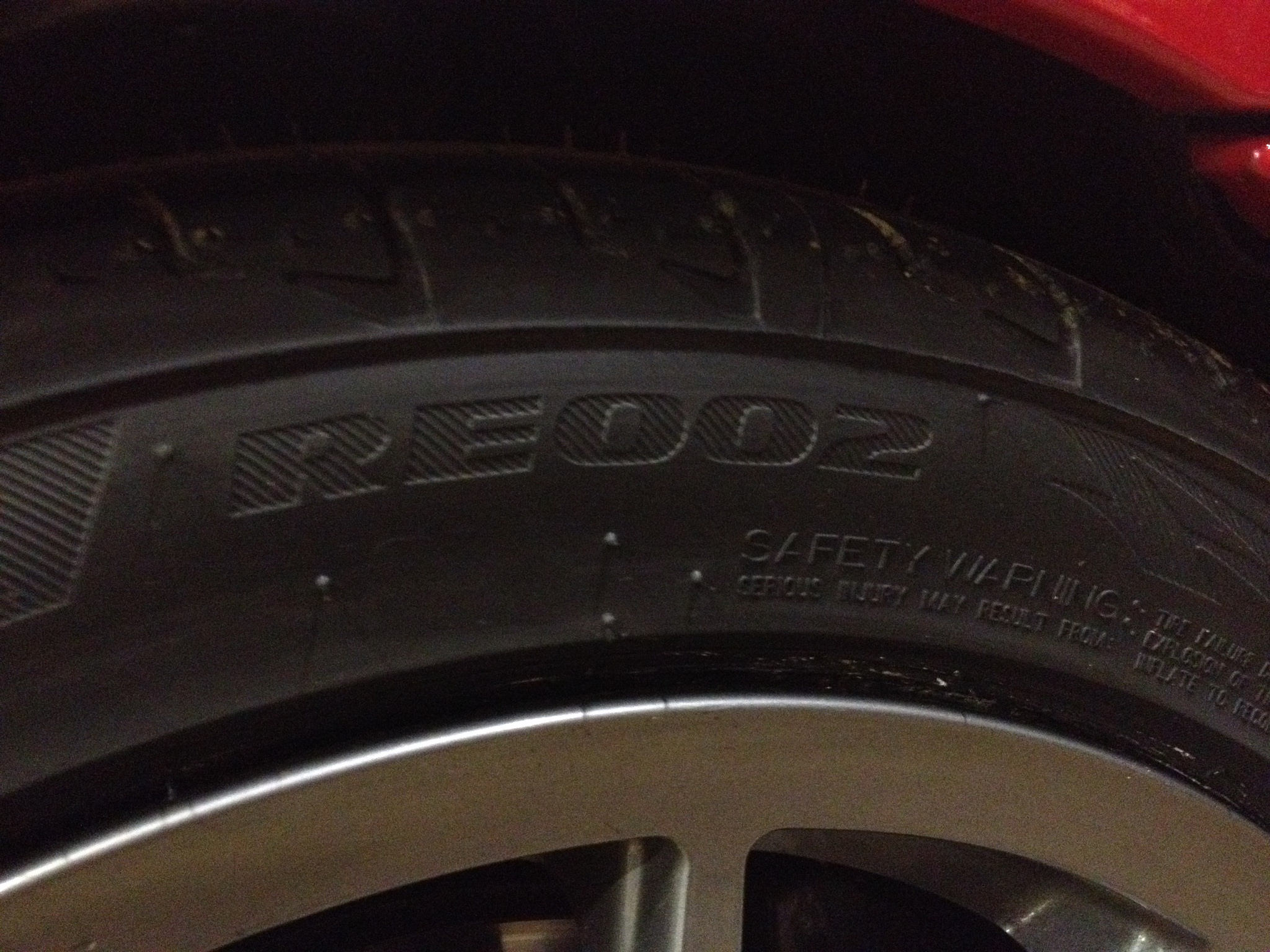

With MOT due, needed some new boots and decided to try Bridgestone RE002 as they looked bit more a between track tyre and normal Michelin PS3 I used before. Plus the price differential was significant on a set of 4 with the Michelins having gone up a lot since last ones I bought.

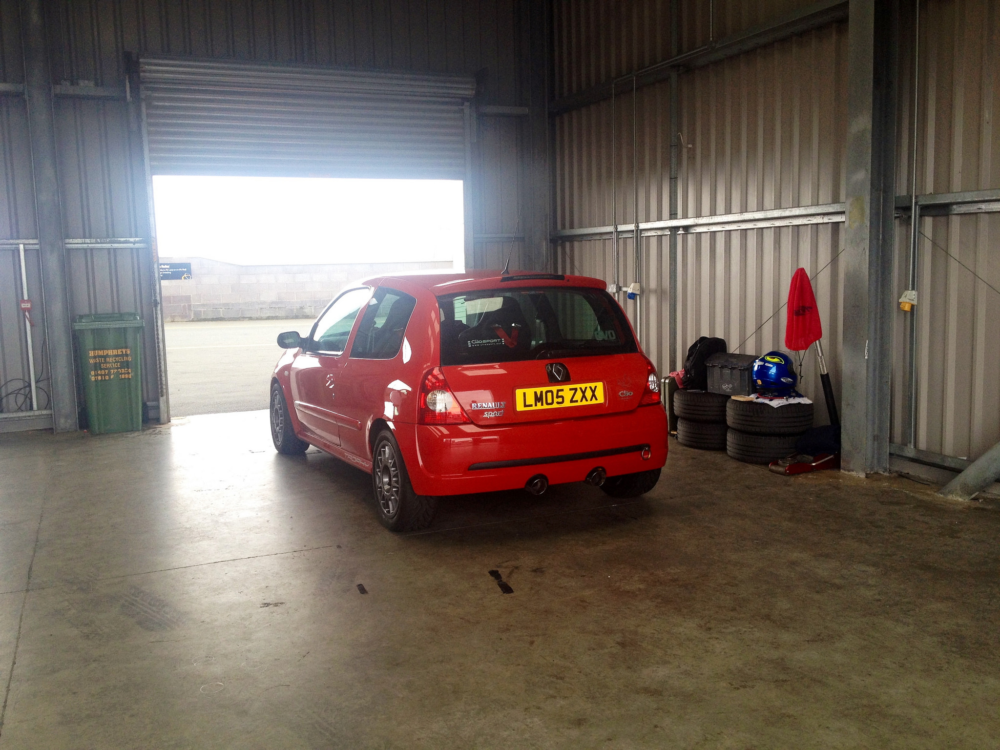

Renault Sport Anglesey Trackday
With Renault Sport coming to Anglesey I couldn't wait to sign up for it. Always brilliant days and great being able to try one of their cars.

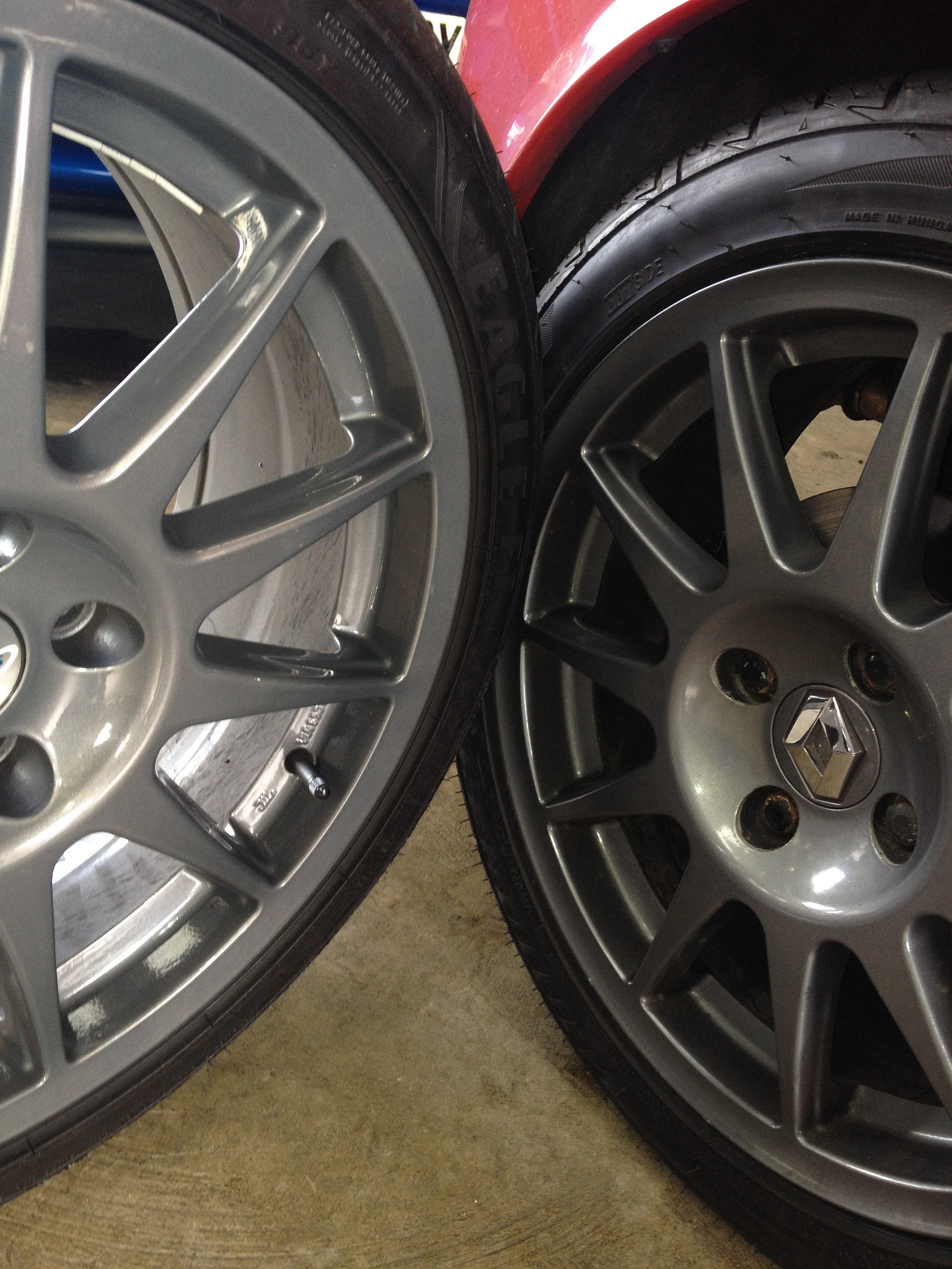

1st clean of the year, with track wheels getting done aswell following trackday.

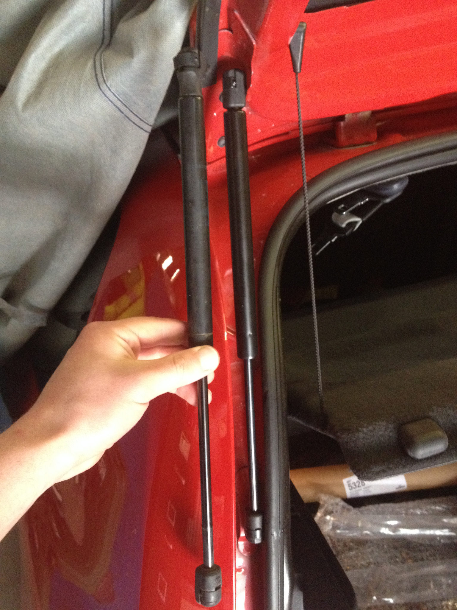

And after years of head injuries and having to get girlfriend to hold boot up during last trackday, ordered a new set of boot struts from SGS engineering.

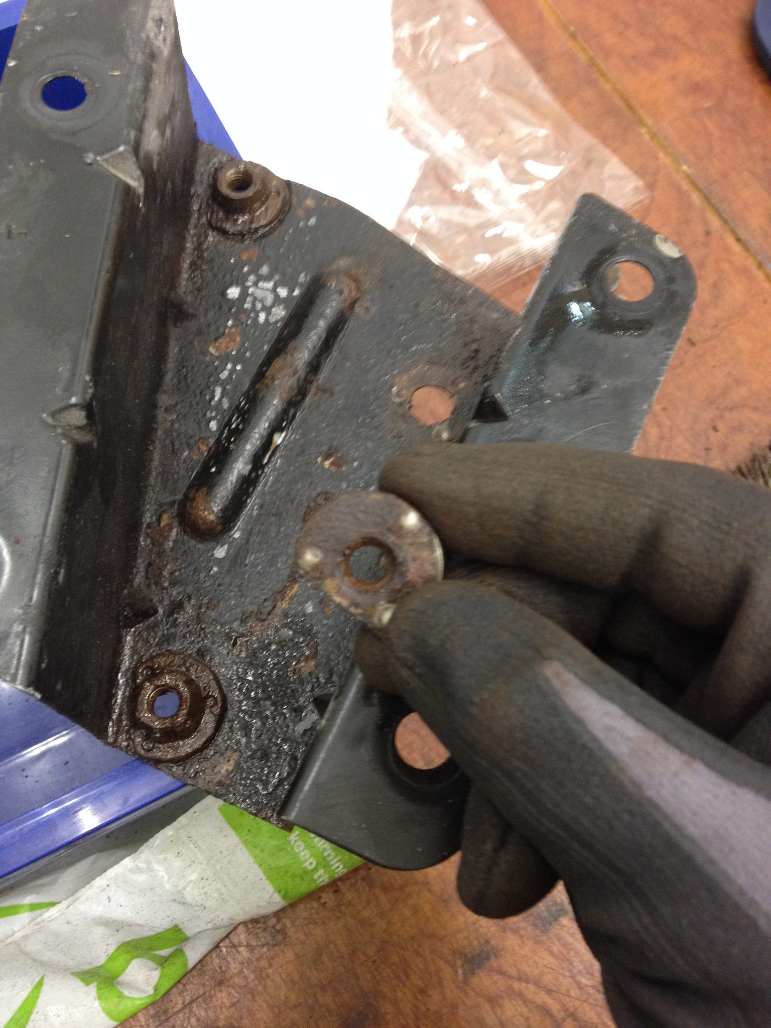

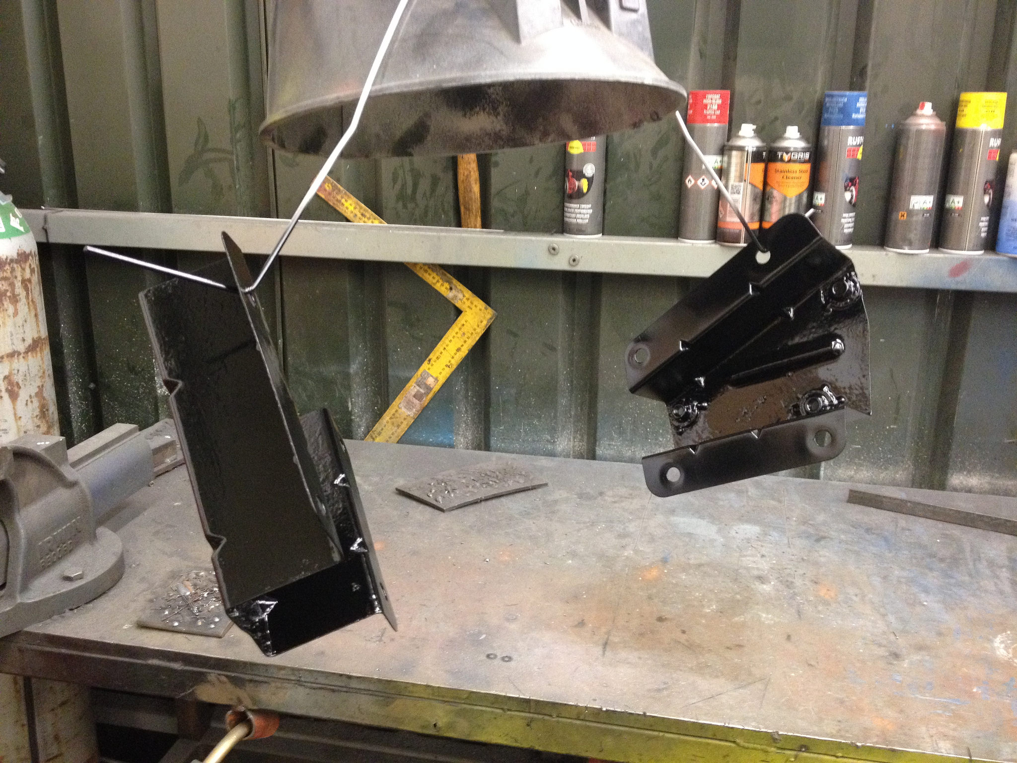

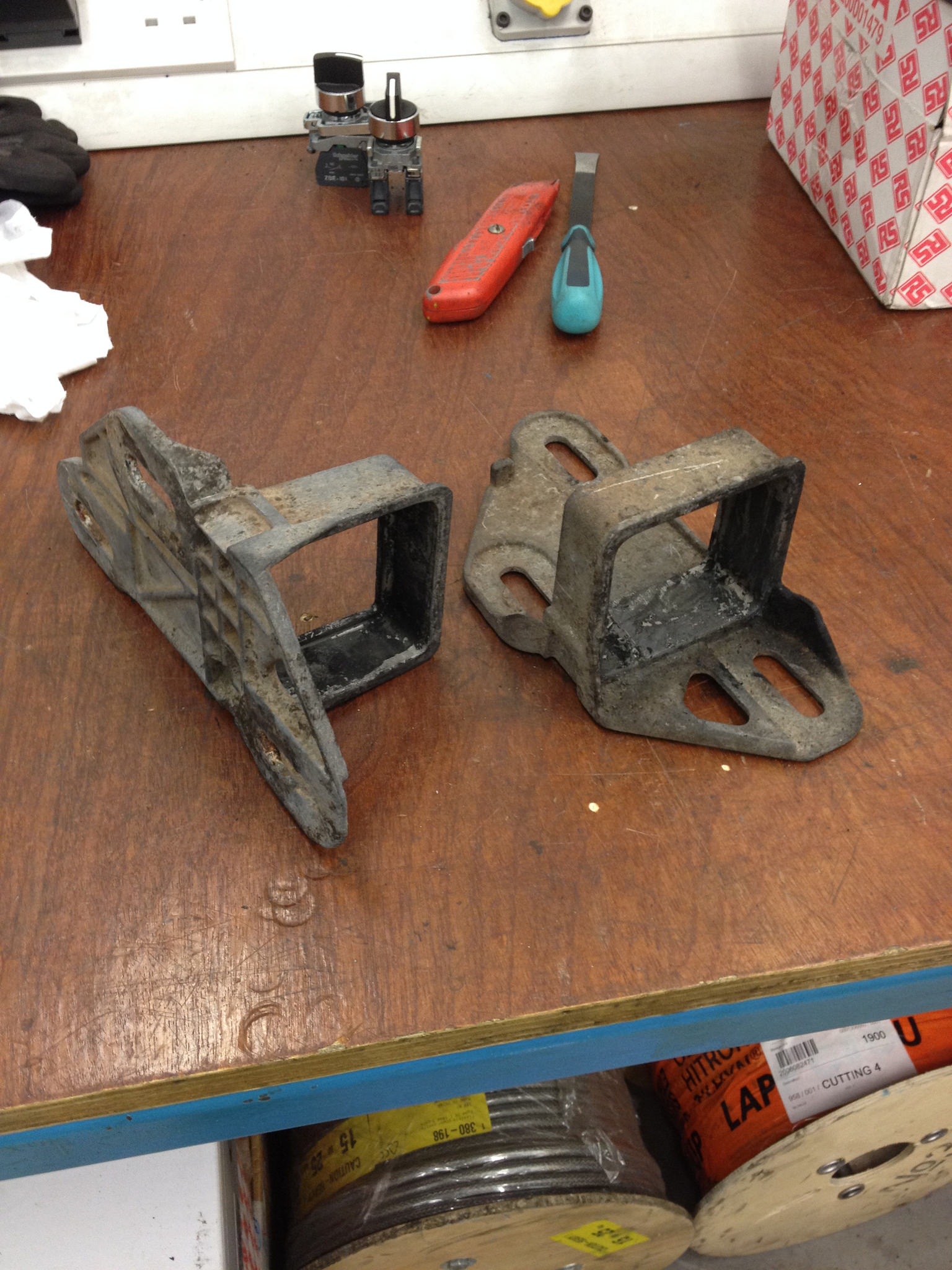

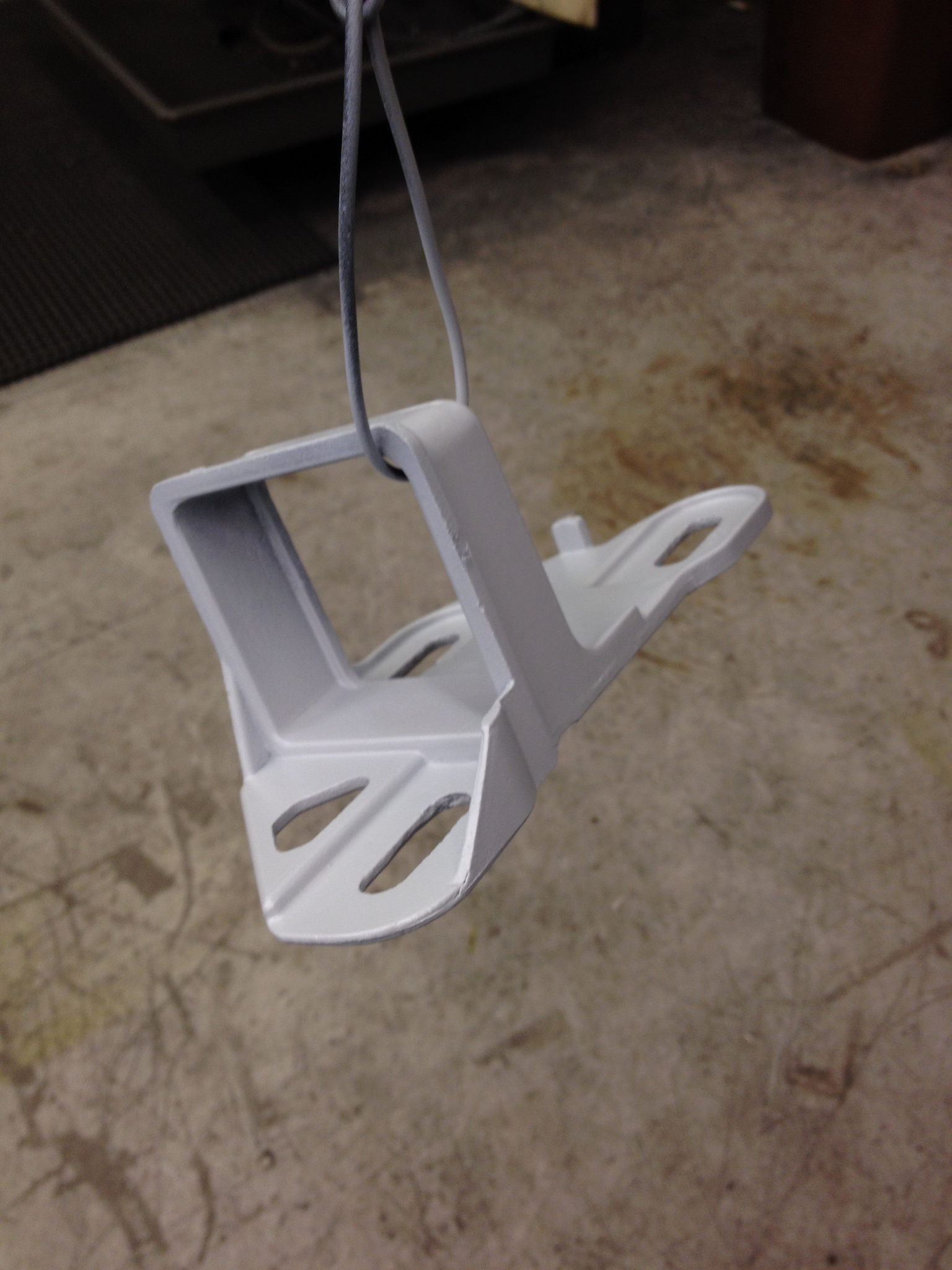

With last trackday highlighting the rear exhaust mounts being past their best especially around Church corner I ordered some powerflex exhaust bushes and got around to sorting out the rust on the rear hangers along with tacking the (un)captive nuts on.
Bilt hamber deox used to get rid of any rust.
Rubber burnt off in a furnace at my old work, then realised you actually don't need to get rid of all the rubber as if you do the bushes are undersize, so had to shim the bushes to get them tight with rubber (only few mm).
Primed and ready
finished

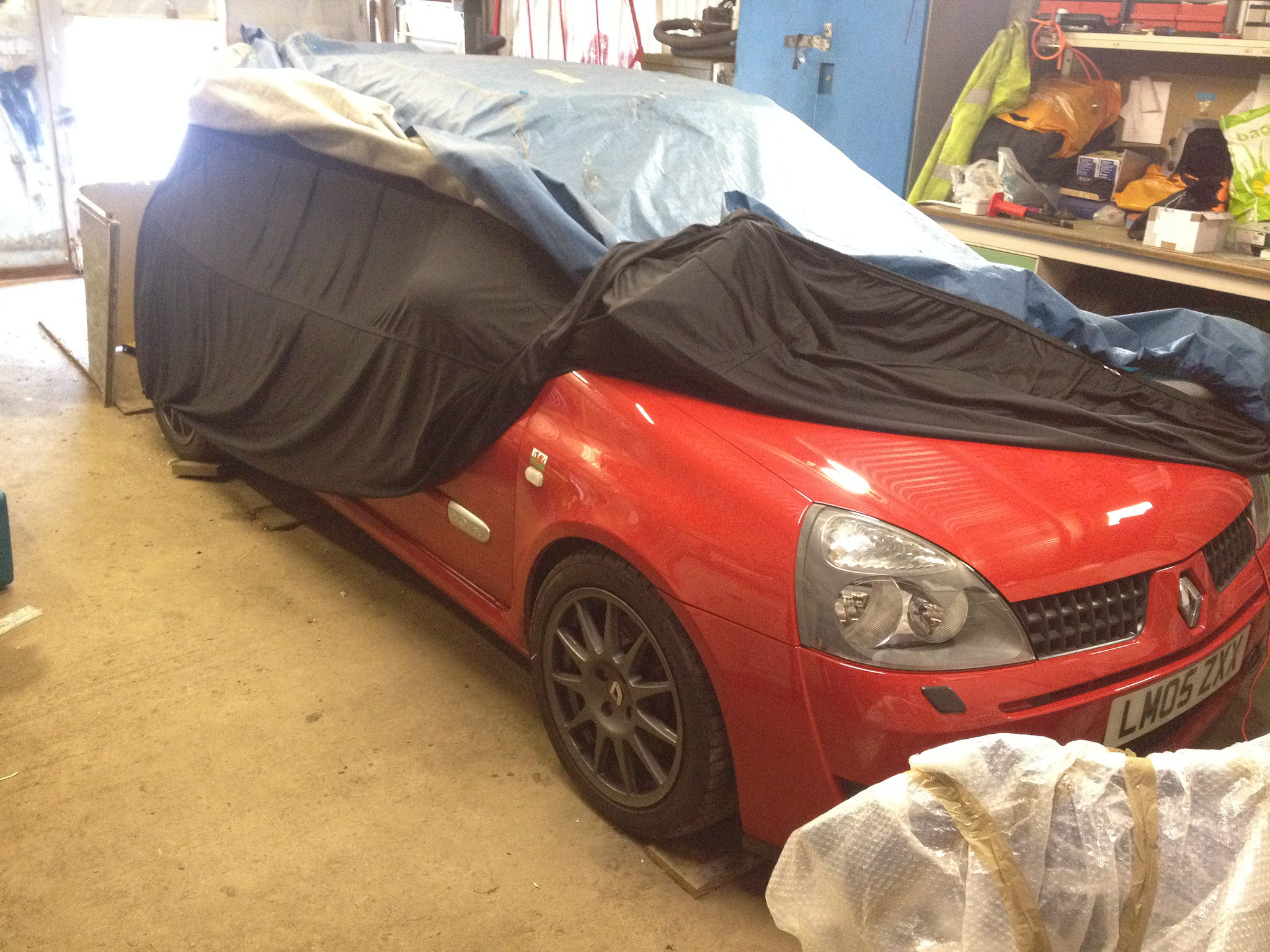

April 2018
Bit later this year getting out of its hibernation.

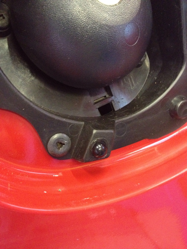

When is a Clio 182 Trophy not a clio Trophy?
When it's 'red' handles are actually red again,

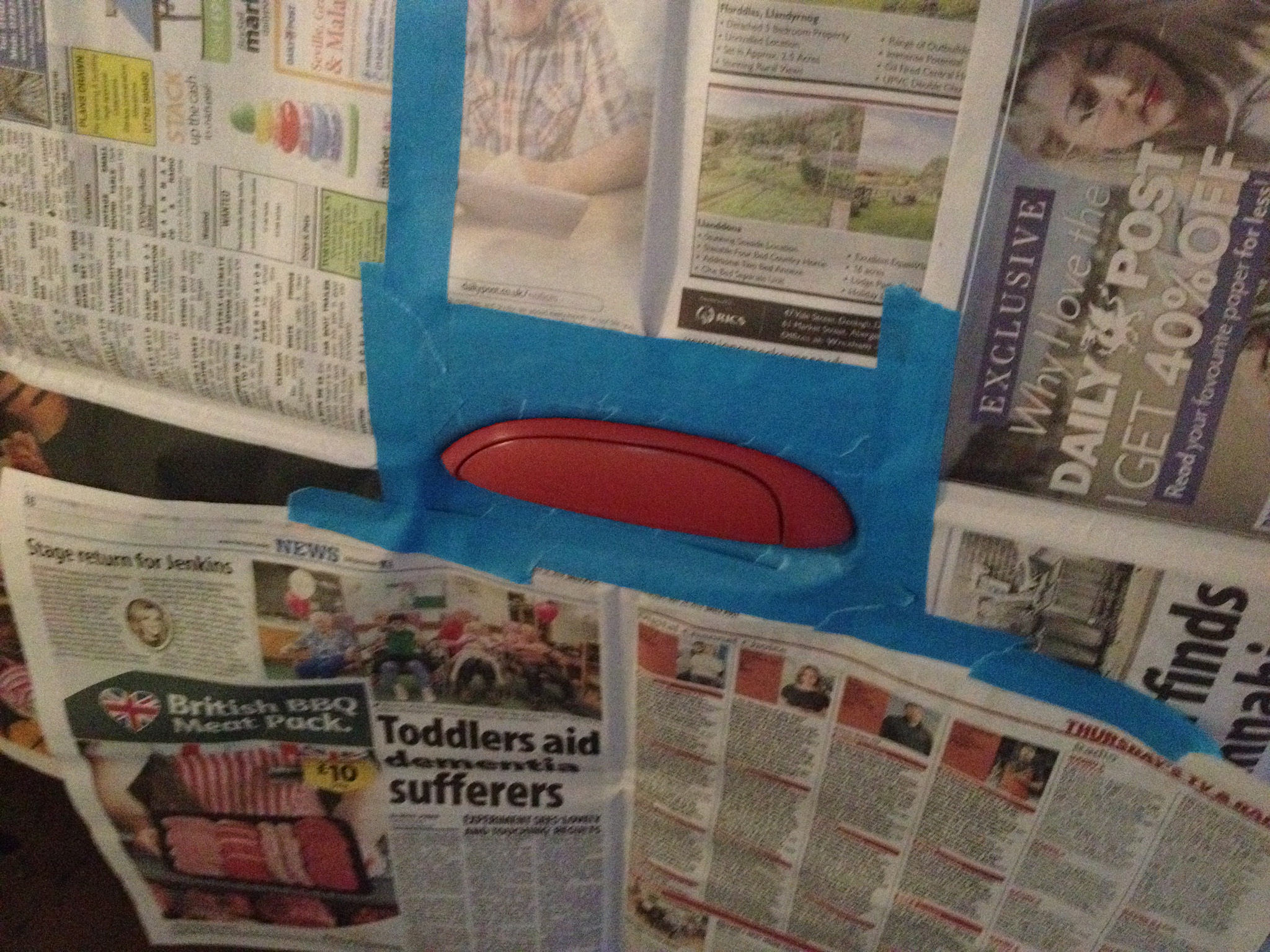

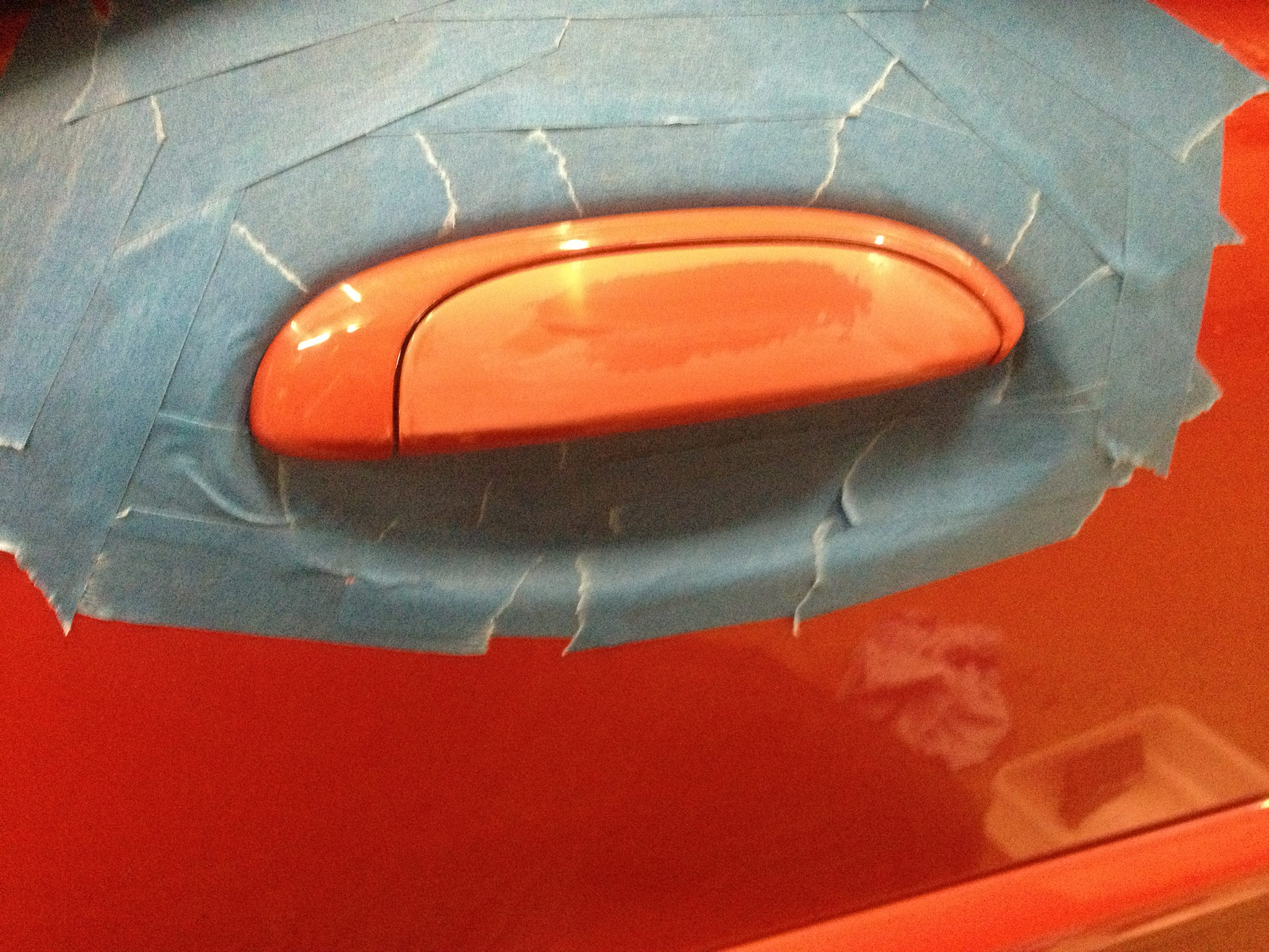

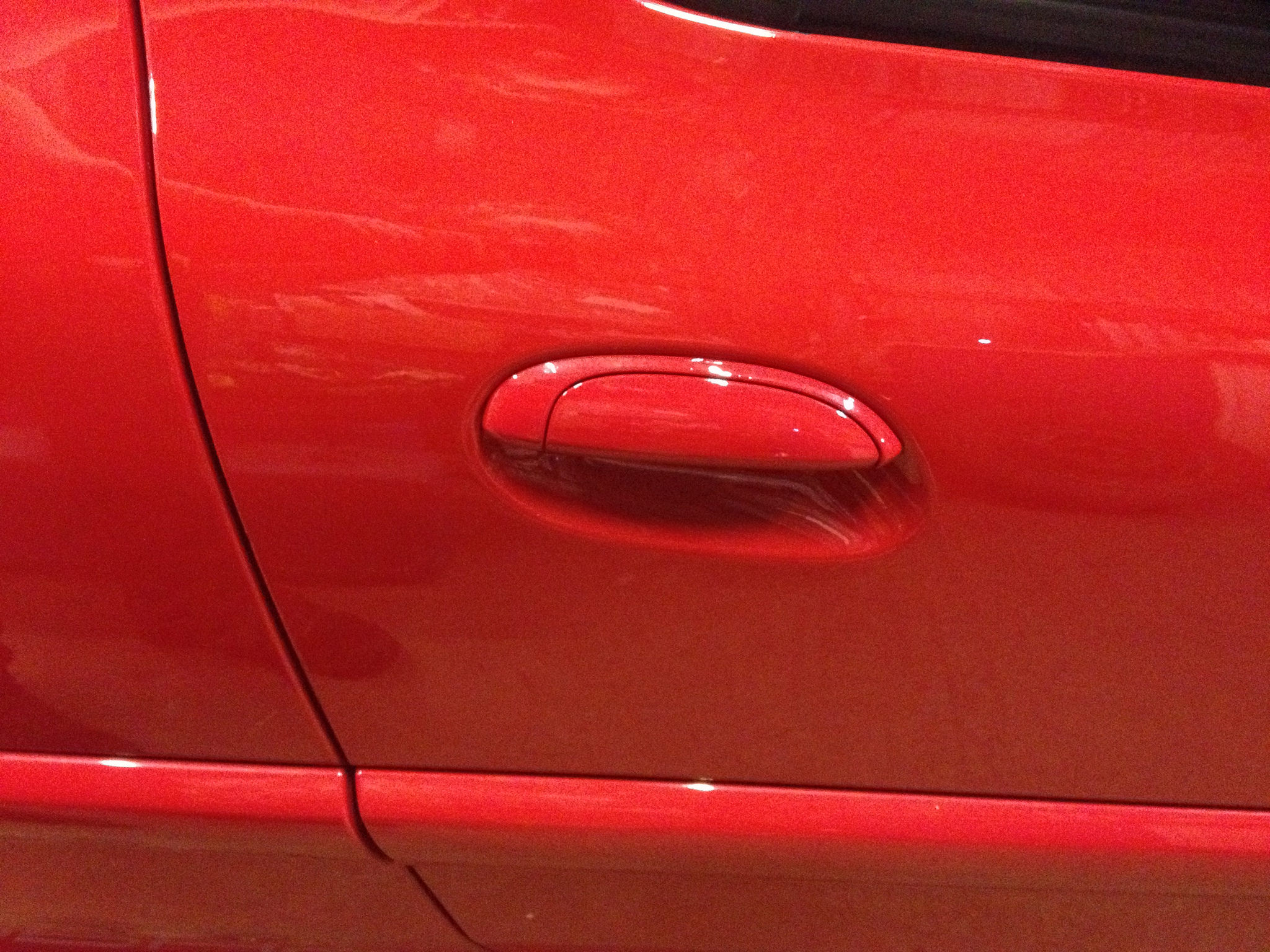

Decided to try something, seeing as the handles are mounted onto the door and there is a panel gap (ever so slightly) I tried to spray them in sittu. Masking wasn't an issue, only concern was the final coat of lacquer and whether I'd have a clean line.
Very happy with how they turned out, will see how they last but the time and hassle I saved in taking door cards off and all I can't be happier with the finish.
