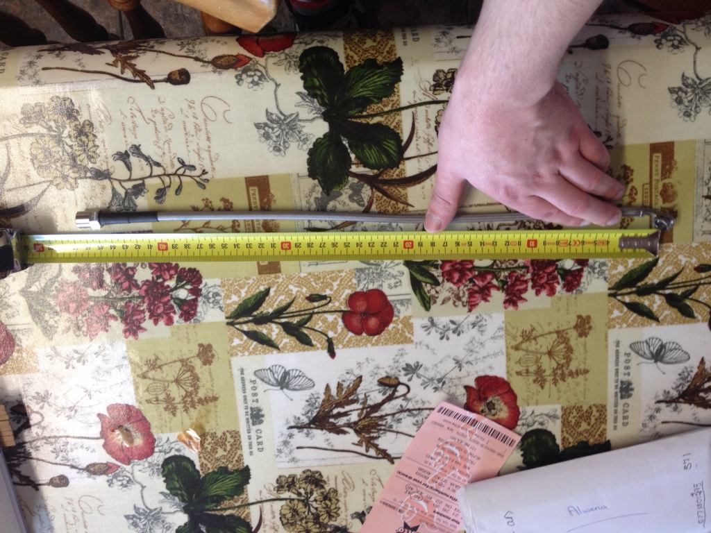

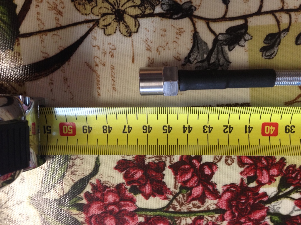

If it's not too much trouble then that would be great, Keith. Thank you :smile:
They measure approx (+/- few mm) 465mm from end of standard threaded fixing to middle of the Banjo fitting. The banjo is a 45deg fitting.
Pure Hose length is 430mm assuming they fully inserted hose into fittings before crimping.
Ones I got were HEL ones.
Any other questions Andy just let me know :)

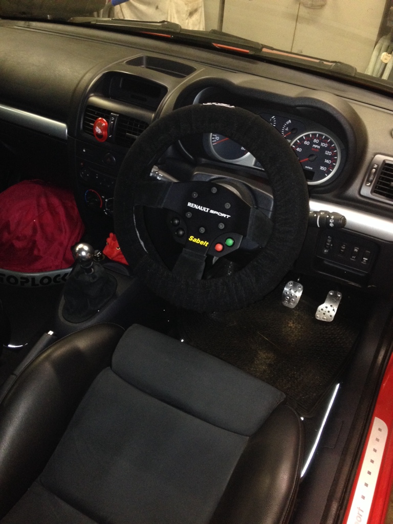

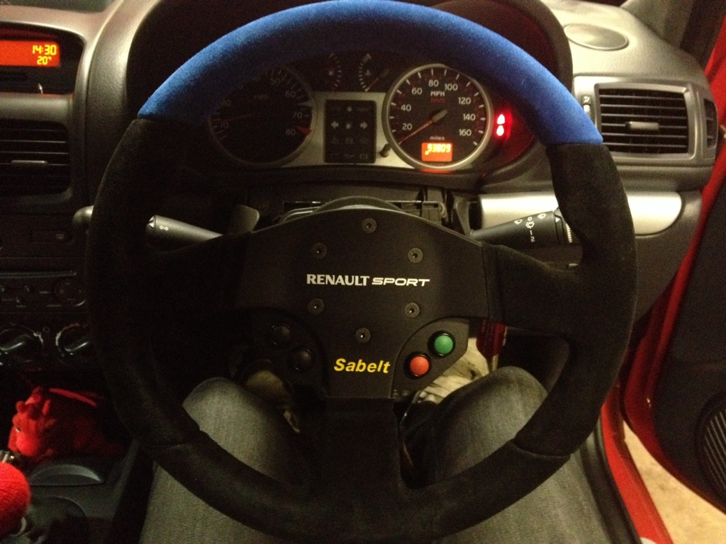

Been busy this month trying to get all things sorted. First on the list was to get my Sabelt wheel fitted (4-5years in a box - yeah I'm a procrastinator lol)
Had made the cruise control/limiter look up previously so all was straight forward enough, or was until the indicator stalk.
To cut a long story short, one I had bought 4-5 years ago was faulty, the small contact arm had broken off and meant indicators were stuck on in one position. New stalk sorted that out
Wheel cover to try to keep it looking decent.

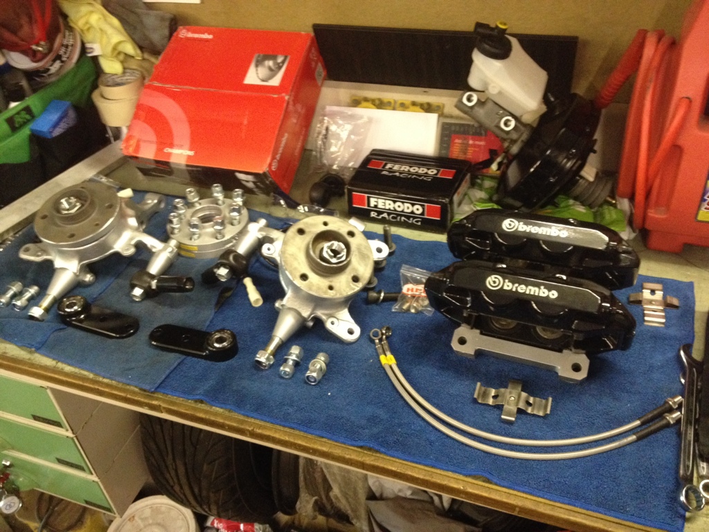

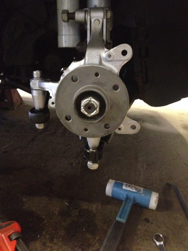

Booked so time off work to make sure I got the hubs and brakes fitted. Finished one side this afternoon an will do the other on Sunday.
My collection of parts

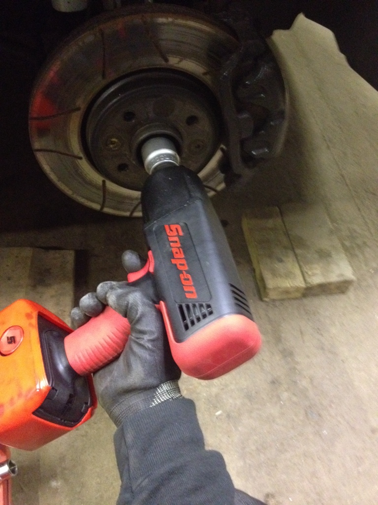

Thankfully one of older brothers had bought a new battery impact gun so borrowed that. What a machine it is. Made no work of the driveshaft nuts.

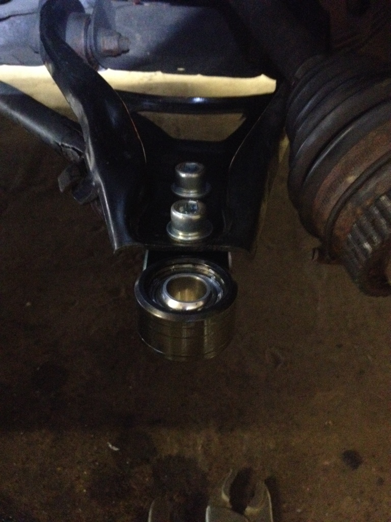

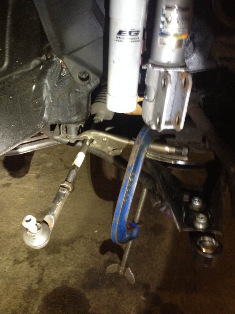

Had fun with the steering arms lol, almost gave up to go get some oky/acetylene but thankfully stubbornness payed off.

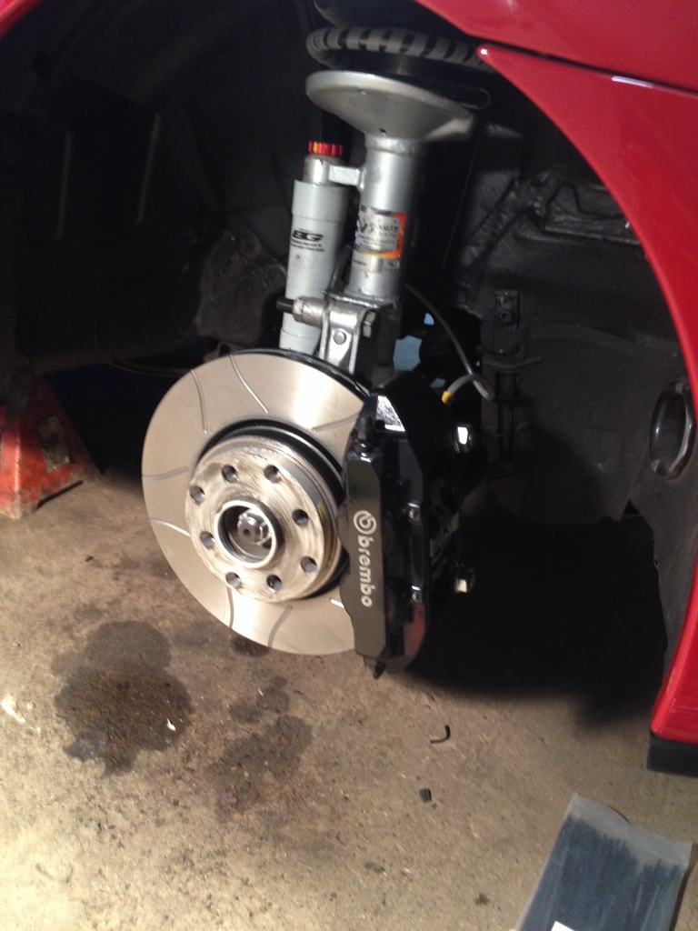

Decided to hit both jobs and fitted the new brakes too. Was in one mind about changing two things but seemed stupid to have to take brakes off again to fit new ones after sorting the allignment.
All looking very discrete in end.
Need to get other side done, bleed brakes, set up alignment as hear I can before getting it to Birchdown lads for service and some other jobs.

Not fitted the mc yet, got it all built up, just need to check wether i need any thread adapters or not.
Ive not had chance to take it out for a proper test yet. Waiting for autoglass to arrive today so doubt ill get chance today either but hopefully during the weekdays next week. But initial slow drive around and tbh it feels ok, got feeling it will be if you like a long brake pedal; stick to the standard one. If you want a shorter pedal; like the 197/200 go for the conversion.
I tend to like a slightly longer pedal so might end up sticking with the standard one for time being
Will let you know when i take it for a proper drive :)

Like you I prefer the brembos with the standard MC, the extra pedal travel is actually quite good and allows you to vary braking pressure better I find.

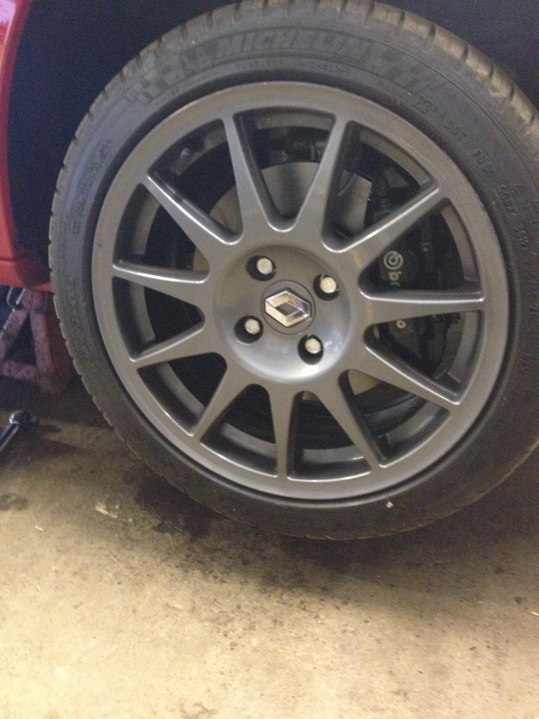

Haha thanks, such a nice feeling finally getting them all on.
Initial impressions apart from the noise ;) is very positive. Definitely don't think ill be changing the MC now.

@dablk assuming you're not going ahead with conversion now? They're brilliant stopping power, maybe overkill. Pads I'm using has meant I've been unable to see 100% what they're capable of but they do stop lol.
