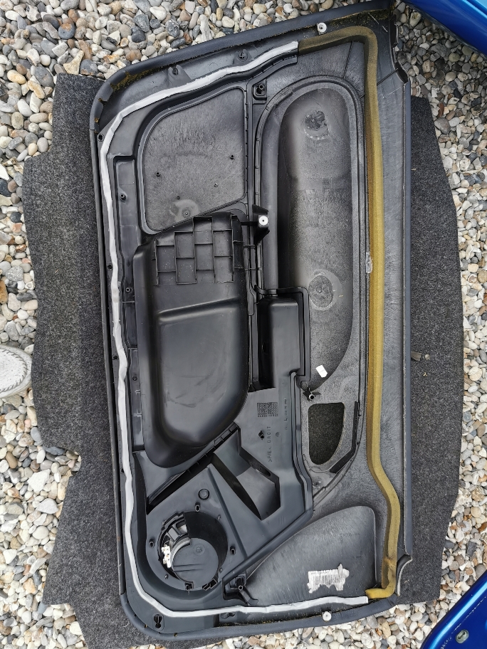

Door cards got put stripped and the sticky stuff applied

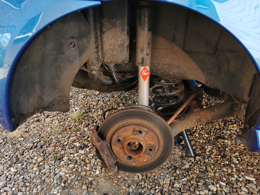

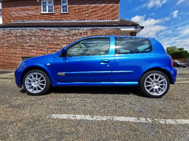

So yesterday I managed to get a bit done
Rear Calipers changed and bleed
Lower ball joints replaced
Track rod ends replaced
I am really unsure of the brakes the pedal feels rock solid iss that how they are on 172 cups
And finally the wheels turini's [emoji7]
The cars rough but looks great from a distance [emoji23] it don't stand me in much so I can live with that
I am just under 1400 quid now happy days [emoji6]

Looks fantastic mate. Great rescue effort. Wheels have changed it dramatically.

ride height looks huge! sure its on the correct springs? try and get hold of a 2nd hand set of eibach sports or cooksports will make a huge difference.

wheels always make a car
Its never going to be a minter but it's going to put a smile on my face out on track for sure [emoji16]

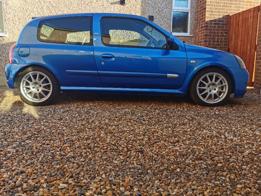

Looks like all the hard work is paying off mate! Nice job you've done there, those wheel definitely make the car!
Whats next on the list then?

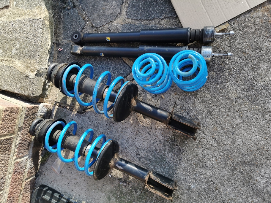

Suspension is definetly next
I've ordered some camber bolts
And like i said above I think I've got some grams lowering spring with fairly new cup shocks coming just waiting on the seller

I managed to bag the suspension 135 delivered I've also ordered some eibach camber bolts
I'll get the geo done when it's all fitted
Need to find out a fast road / track setup I really have no clue with these clios

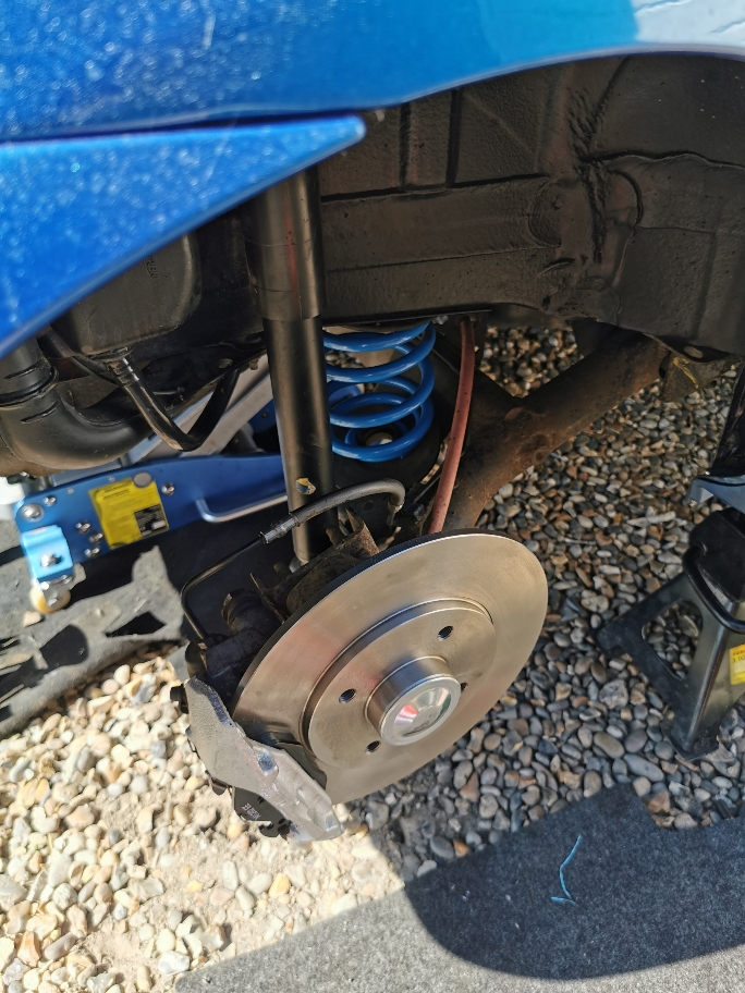

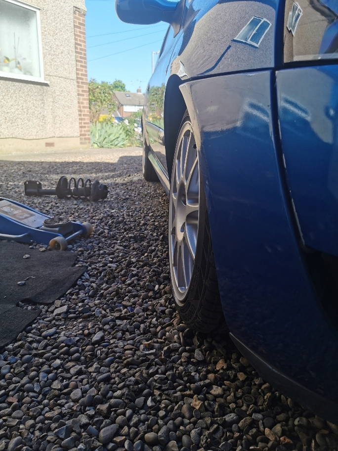

  172 cup
So Saturday morning I managed to get the rear brakes done and the springs and shocks on the rear done
Then went out car shopping I found a bargain 16 plate golf gtd that I'm going to flip

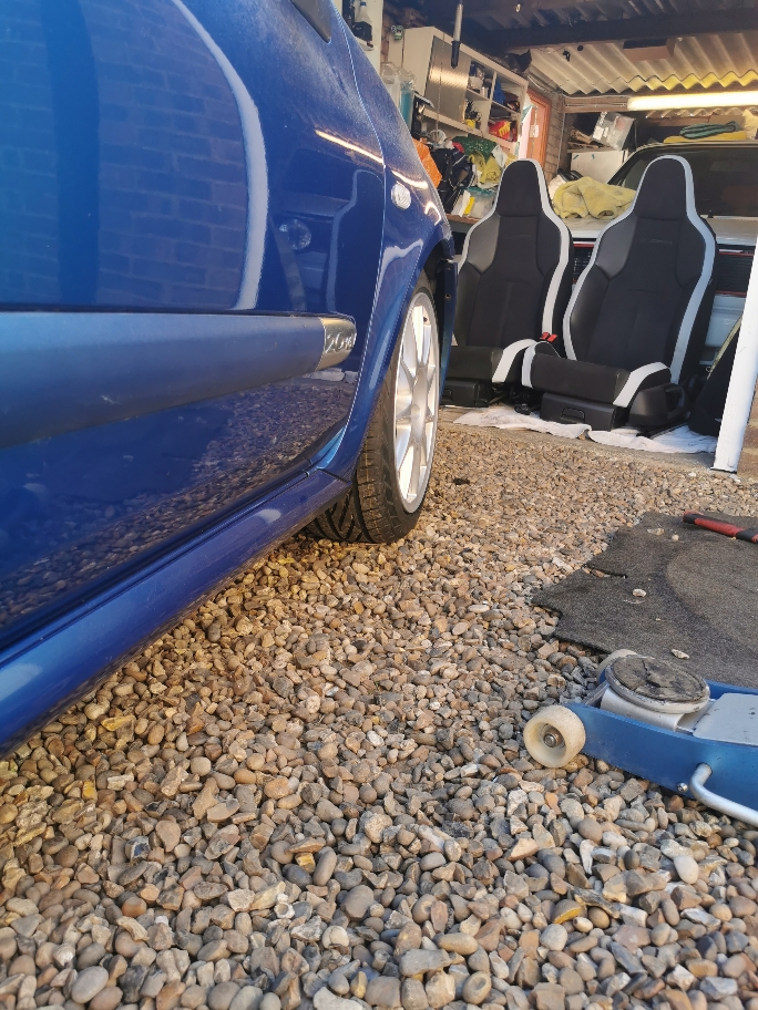

Today I managed to get the front lowered swapping over the shocks and springs
Also added the camber bolts and basicly set it to maximum [emoji1787]
I will get it all aligned when the log book arrives as I can't tax it till it comes

"How much camber do you have on that?"
"Dunno! STANCE BRUV innit!"

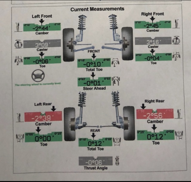

I need to get some setting for the guy to set the camber too I really have no idea what is good camber for a clio

Heres a setup i used before i did a Rollcentre correction kit.. I'm running AST5100 though and as you know my car is a track pig.. You could try running around 1.5 or 2 degree negative camber all round to start with as a road/track car.. Clio's work well with 10 mins toe out on the front as it really helps the turn in.. We all have different driving styles so give it try and see how it feels...
Edit: ignore the rear left as that was realigned with shims.. I run 10mins toe in on the rear..

nice one i will show it to the tracking guy

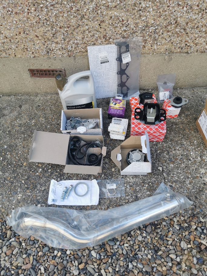

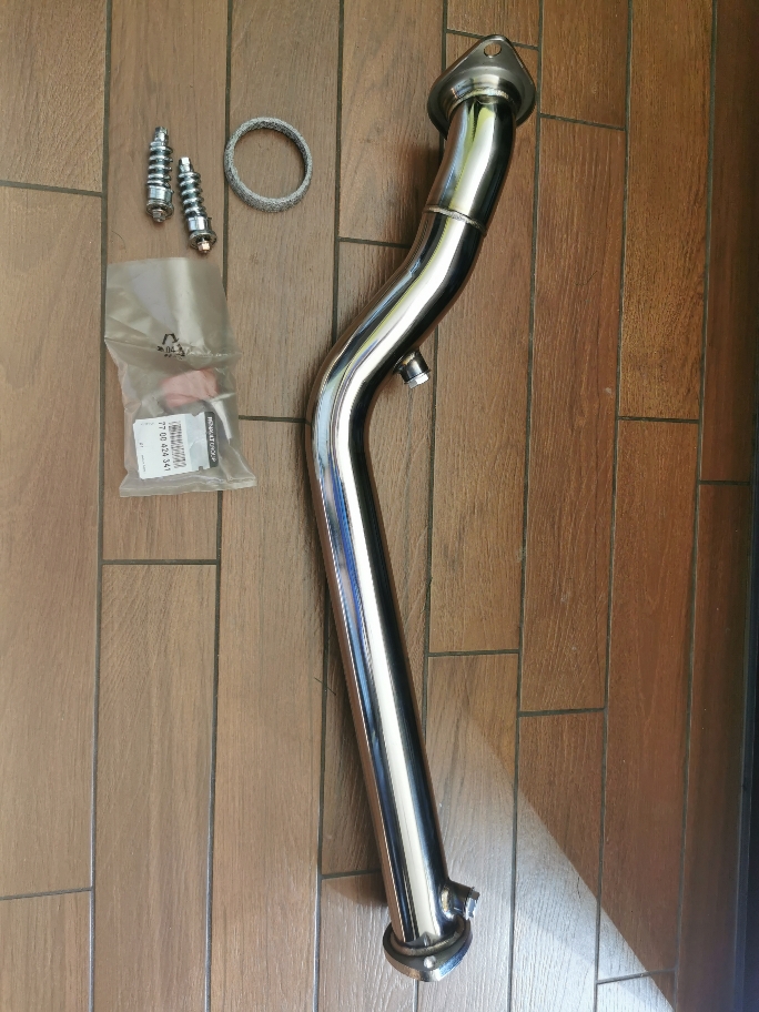

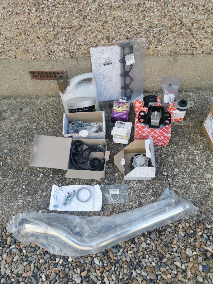

so i have spent a few quid on the car this last week as i had a touch with some cash
genuine cambelt kit water pump Dephaser Pulley Water pump & 5L Coolant that was 250ish
rear exhaust powerflex exhaust mount as mine is battered
powerflex upper engine mount insert
Bosch Car Battery 12V 44Ah Type 063
its going into my friends garage Retro Resus for the belt to be done he is going to look into the brakes and high speed fan error too and hopefully tracking as he builds race cars
should only need a set of 195/50/25 semi slicks for them old ropey tsw wheels and i can book a track day after that :oops:

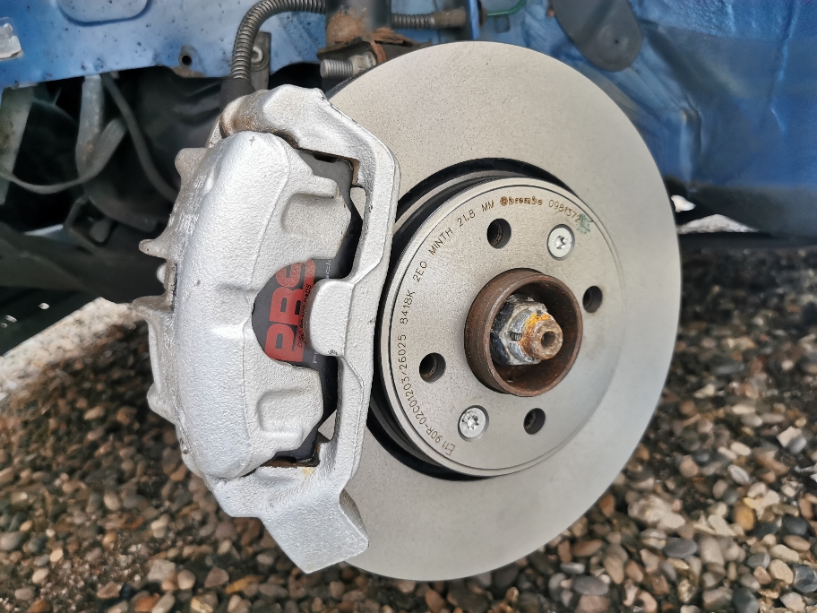

Still racking up the miles so far I have done about 300 miles and all seems well except the engine feels like it's got alot of movement and as it already had a power flex dog bone mount I've ordered 3 new febi engine mounts and I still have the powerflex poly insert for the top right mount so that should tighten it up a little
Neew pbs pads and brembo hc discs have been fitted
Should be going for the cambelt and few issues end of the week [emoji6]
