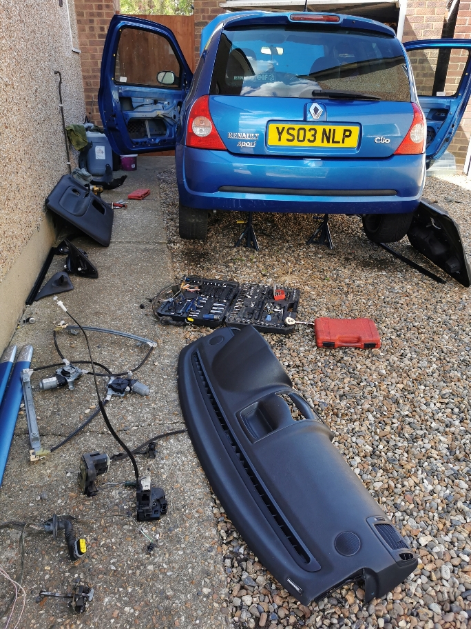

  172 cup
to be honest its been easy working on the whole car so far (y)
cars going back on its wheels tomorrow

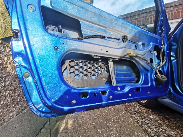

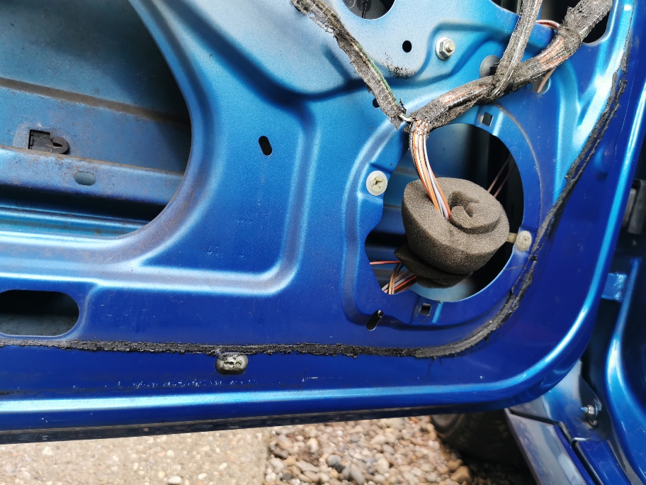

both doors need to be stripped down so i can swap the lock over and mirrors

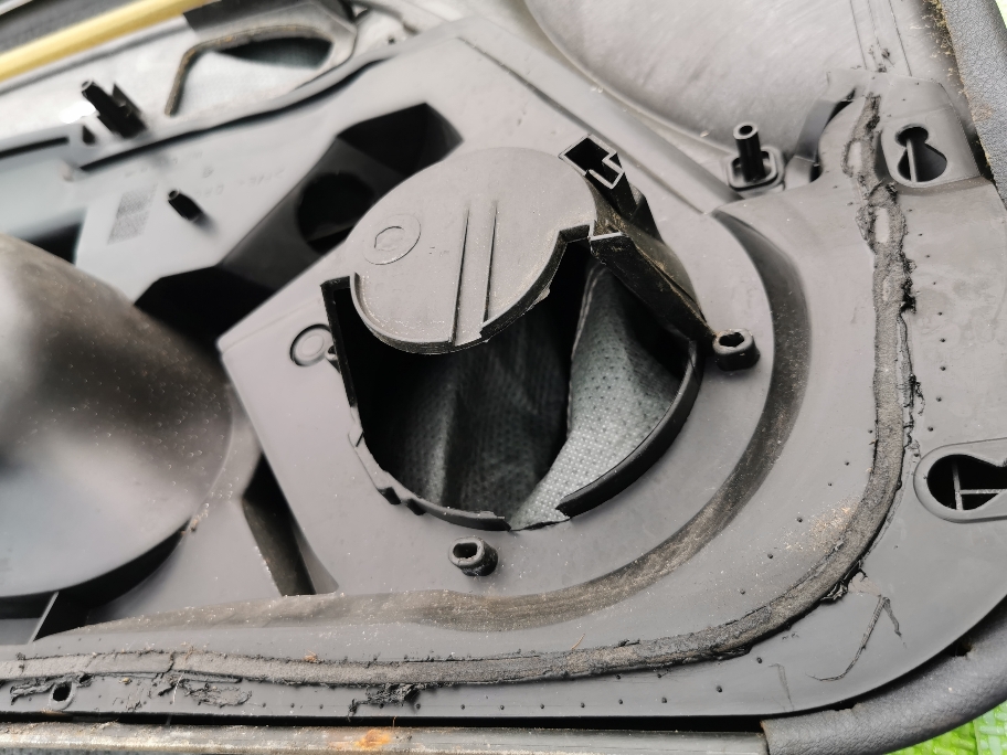

i have ordered the butyl sealant for the door cards
new number plates
still no warning lights on the dash :p
fitted the radiator and i have a rubber mount missing from the bottom
a screw on clip from the rear arch liner missing
the clips that hold the front arch liners in
the front part of the arch liners
i need an airbox as mines damaged
a passenger mirror cover idealy from a cup
a battery clamp
thats my list so far so its not that bad might even chuck it in for an mot next week :ROFLMAO:

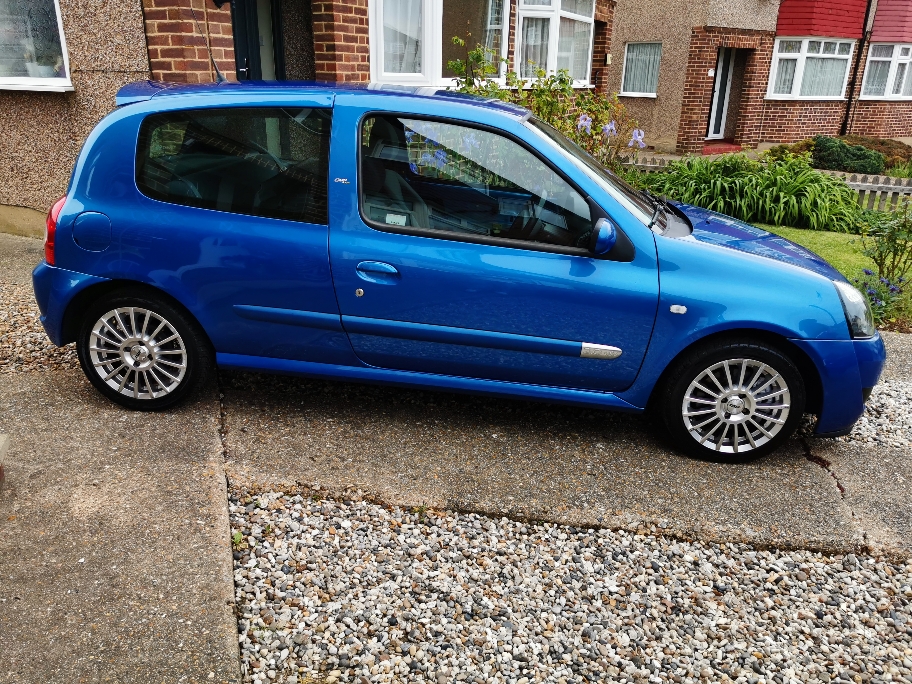

The cars back on its wheels [emoji16]
Fitted the new alpine stereo and a parrot hands free also got the amp and sub into the boot
Refitted the uch

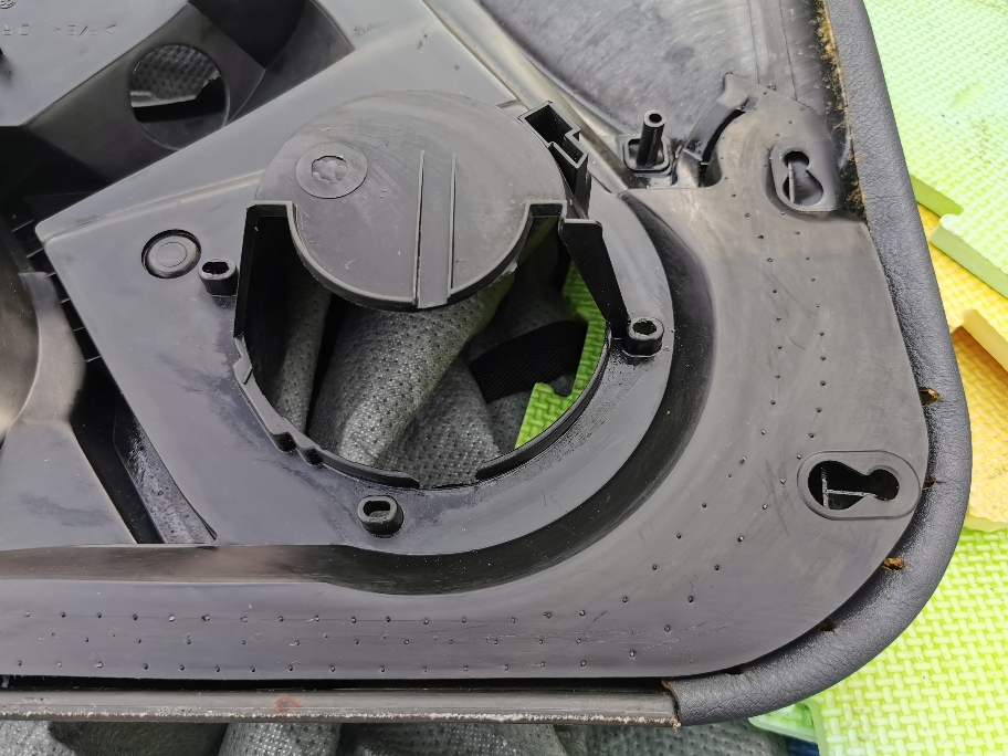

Both doors have been stripped down glass locks seals and handles all swapped couldn't for the door cards as I'm waiting on the sticky stuff
another long day
Sent from my VOG-L29 using Tapatalk
  172 cup
Gave the clio a wash and polish today even though I have not driven it it's amazing how dirty it got from siting with me working on it
It has loads of marks and a few dents i will get the front bumper painted and decide on I what else to get done
Drove it round the block and the pedal feels solid made me think something was wrong but the brakes work well just need to clean the disks up, I want to replace them after I get an mot and I think I'm getting booked in Thursday or Friday

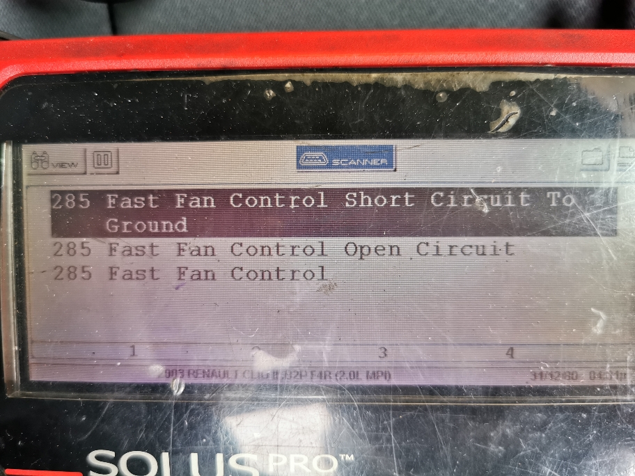

Serv light came back on the dash and the only errors I have are the fan but it works
So far I'm about 650 into it [emoji1303]

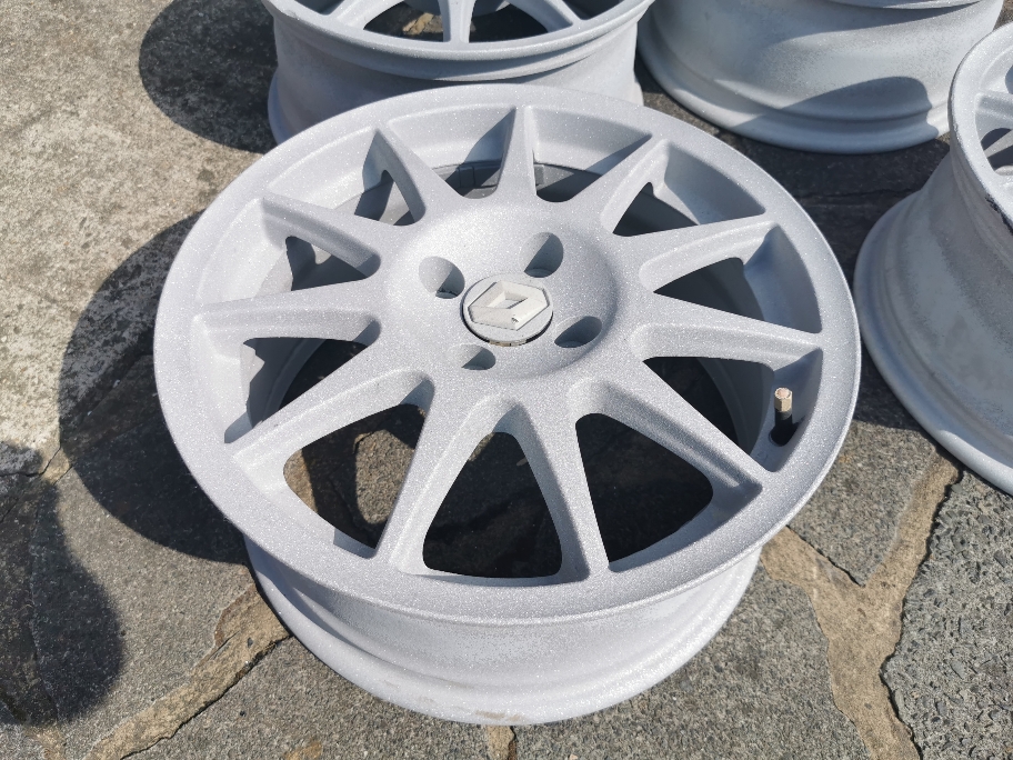

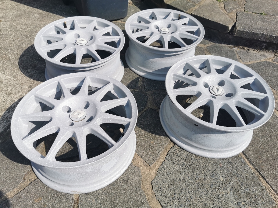

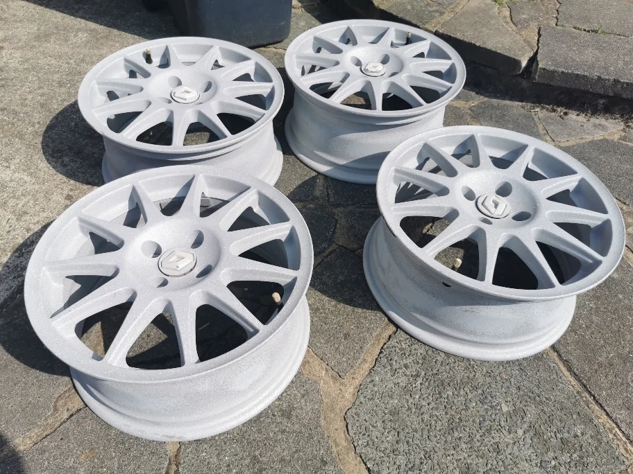

Also found a set of turini's [emoji7]
They need a little work but come already sandblasted
Another good buy at 150 quid [emoji1303]

Bargain Turinis! As already said it will transform how it looks. If the other wheels are 15" some one will buy them for use on track or keep them if you plan to use on track 👍
  172 cup
Bargain Turinis! As already said it will transform how it looks. If the other wheels are 15" some one will buy them for use on track or keep them if you plan to use on track [emoji106]
yeah they are 15" I was planing on keeping them and buying some used semi slicks

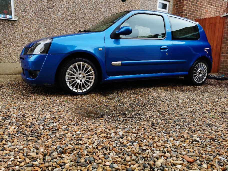

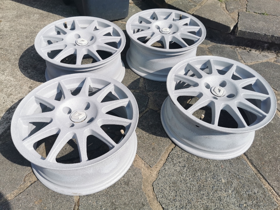

A Cup on Plain silver Turinis look ace i must say. Mine are used with Rainsport 3 for wet days.

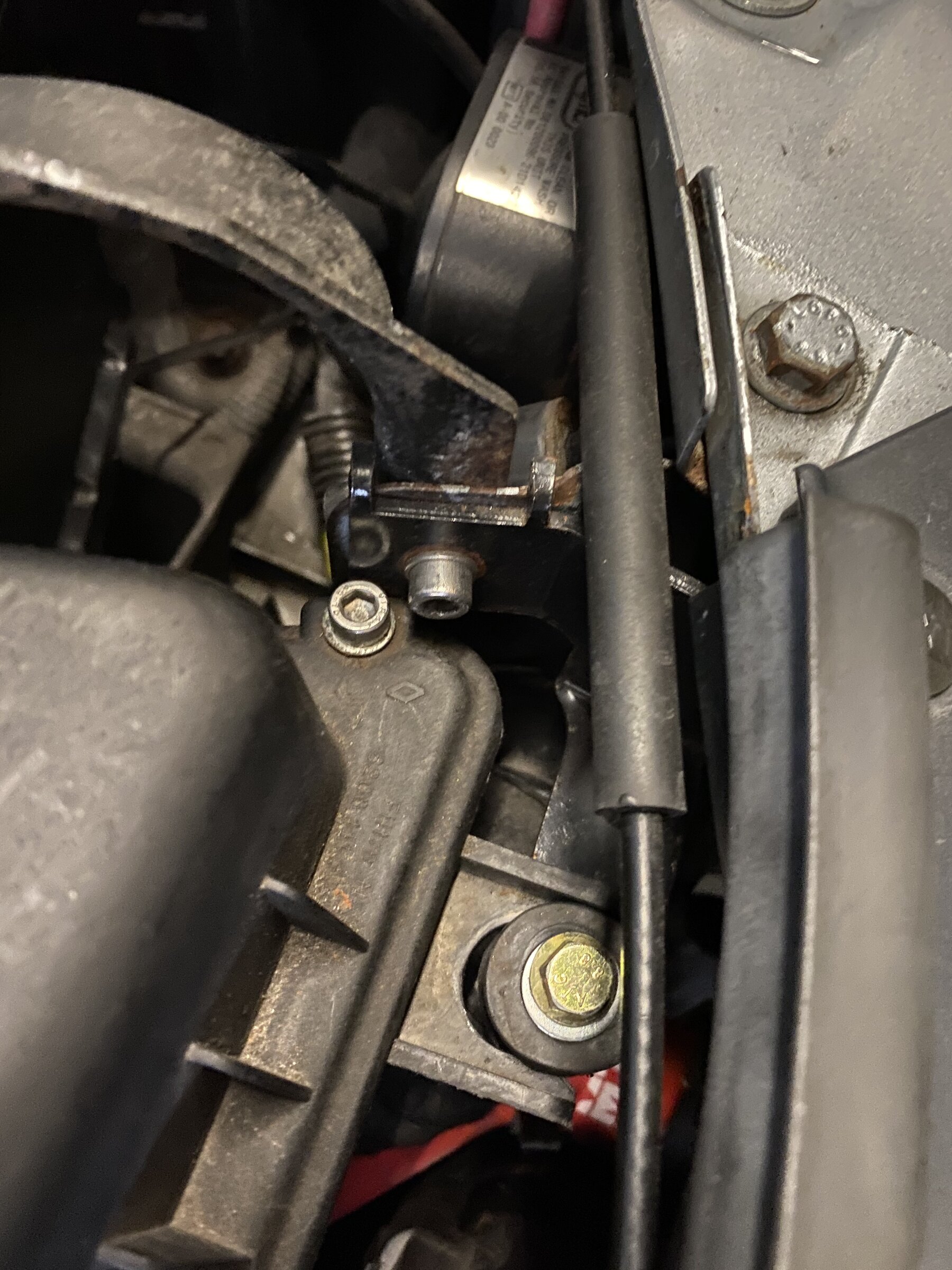

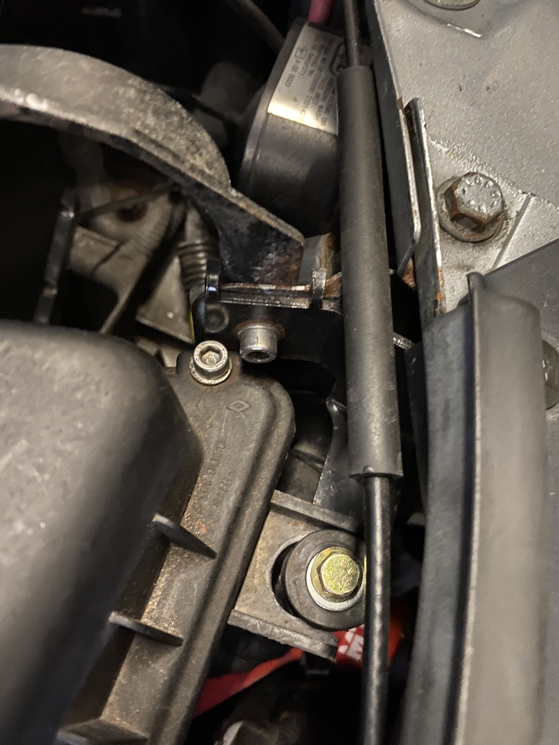

can anyone help
i had the original air box brackets missing i have worked out the back one attaches to the ecu cover
i am struggling to see where the front one bolts too

can anyone help

@Danboy66 This is where the front one attaches. There is a third bracket underneath which bolts under the battery to the battery tray. Hope this helps.

Two bolts hold the long bracket on. Hopefully the front bracket is still there. Mine was missing the rear bracket when I bought mine and sod's law that was the only one that Renault had discontinued.
  172 cup
I removed the long ecu bracket to front panel above been doing loads of work on the car in that area and I wanted to paint it
I have both front and rear brackets as they come with the replacement airbox I bought only one long bolt though I'm sure I'll have some something in the garage I can use

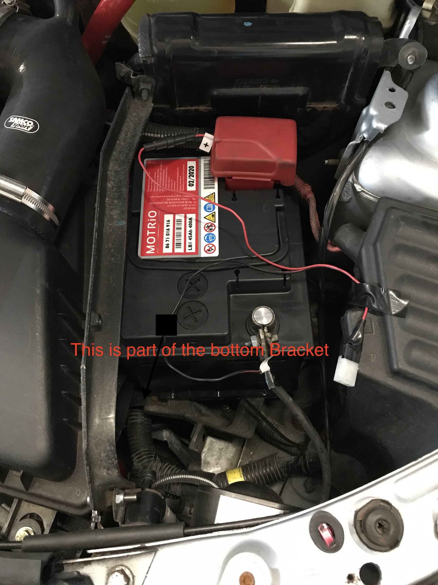

This picture shows part of the bottom air filter bracket. Bottom left of battery hopefully you can see one of the bolts.
