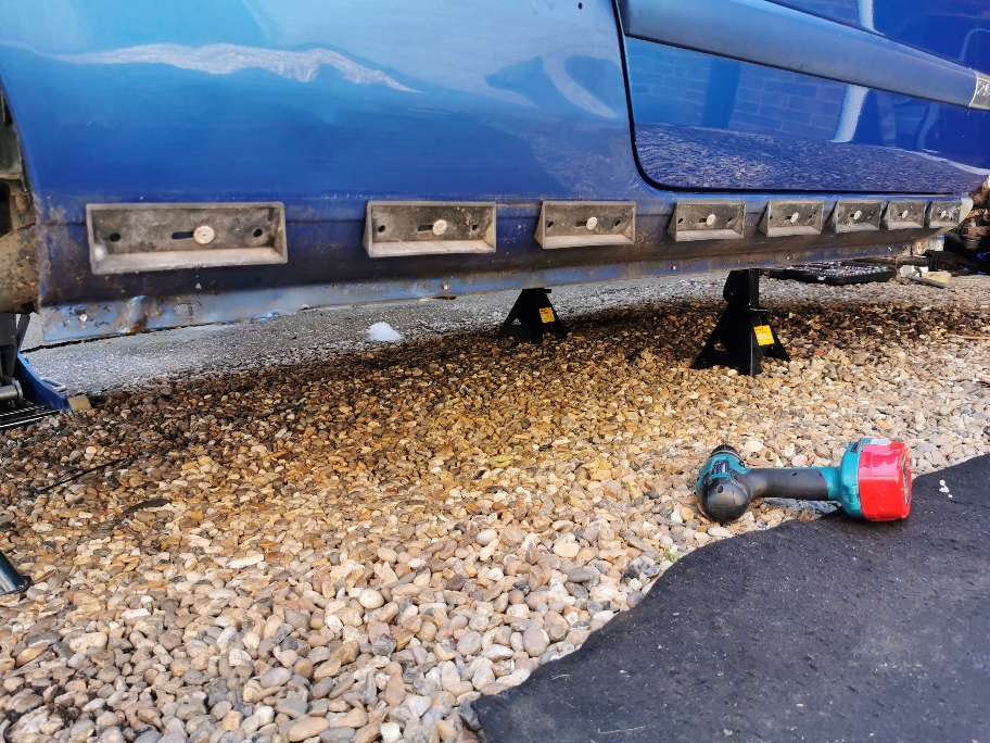

Yep. Just run an 8mm drill through the existing holes, then treat the hole and riv-nut away.
Sent from my SM-G977B using Tapatalk
I've bought some m5 flanged button head bolts with some Form C washers. Plan on just using flanged serrated nylocs on the back, easy to buzz on and off with a rattle gun and a spanner.
What ever suits you mate.. 1 handed job on 1 knee vs 2 handed job on both knees.. [emoji23]

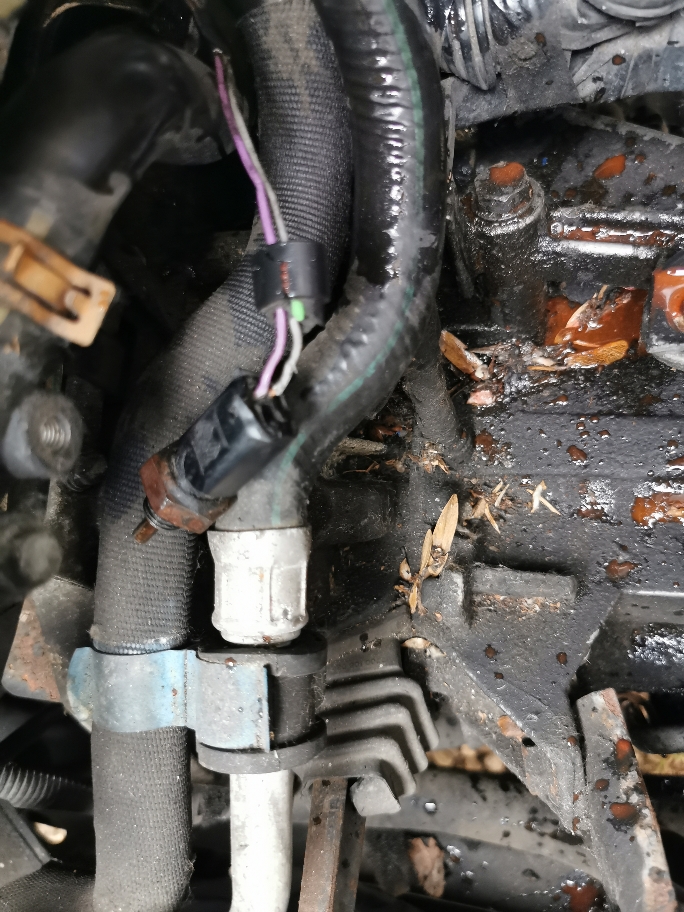

Looksike I might have found my fan issue
Any ideas on a new plug?
Looks like new sensor will need to be ordered too

I might have one of those plugs on an old loom in the garage
I'll have a look tonight and if you want I can clip it off with loads of excess wire for you mate :) Will send it with the clocks for nowt
Messaged you
The fans work with it unplugged so that's a start

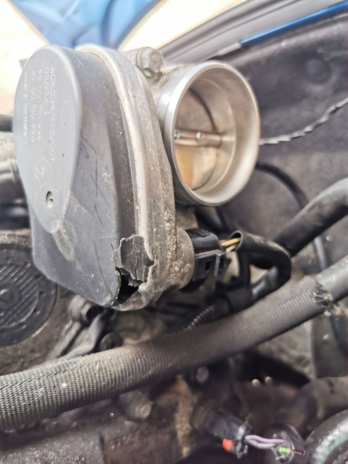

Found the throttle body needs to be replaced

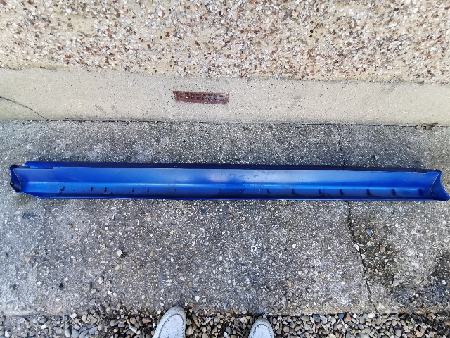

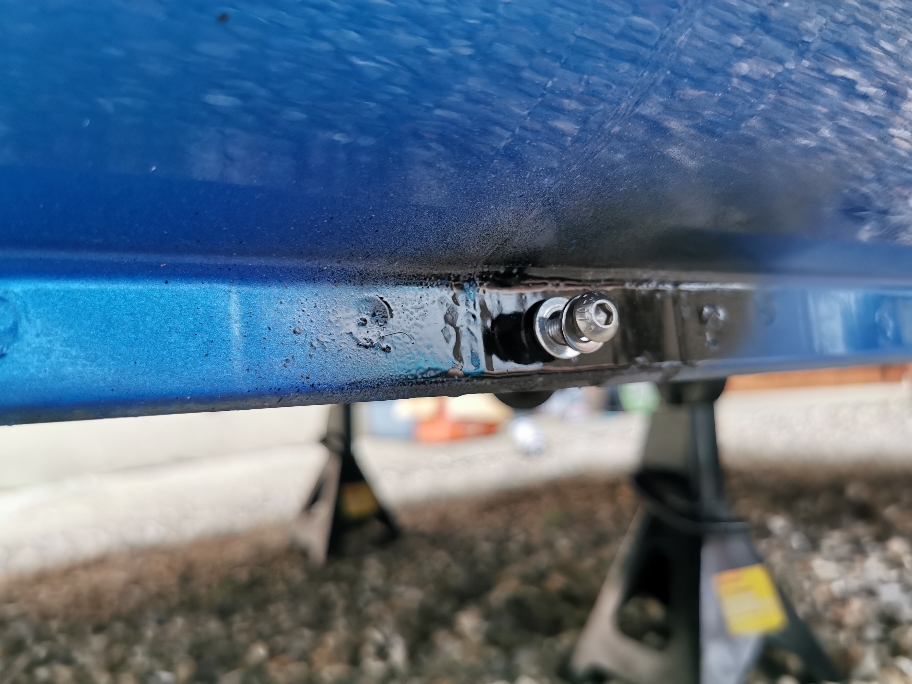

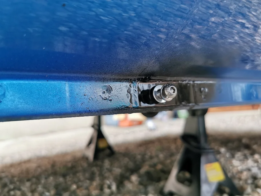

Fitted the riv nuts for the skirts and straighten up the sills
Only had black paint hopefully that should keep the little rust at bay
Sent from my VOG-L29 using Tapatalk

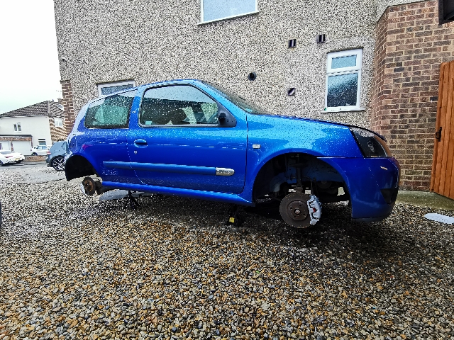

So I collected the used panels
2 doors
2 wings
Bonnet
front bumper
Headlights
Rad and fan as my fan was damaged
Fitted a lambda and Throttle body wich has cured the serv light and engine management lights on the dash
Finally no lights but still have a fast fan error but letting the car get to temp the fan kicks in so I'm glad it works

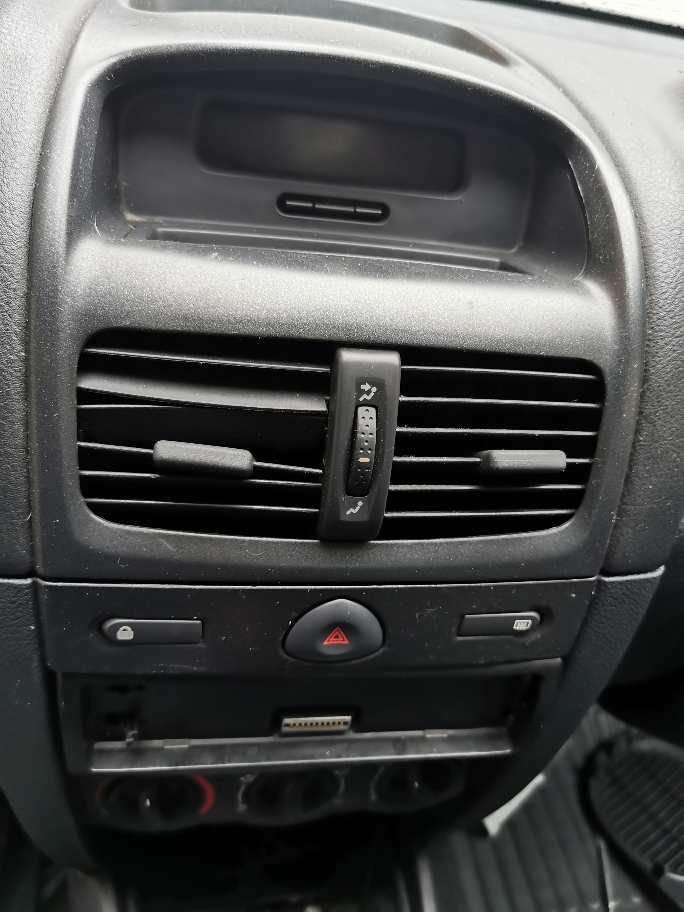

Centre vent

Impressive progress. Gonna be great when its finished. The centre vents are part of the lower dash and a right pain to swap over.

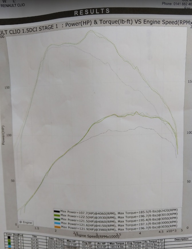

Yeah they done me a map which the car drove like s**t, took it back various times they couldn't put it right, car kept going into limp mode, spent hours and hours in their waiting room, not ideal on a brand new motor so I got it flashed back to standard. They mapped my mates golf r and with 2000 miles on the clock it went bang, they said flash it back to standard it's undetectable and take it to vw under warranty, which he did, VW told him to do one as it had been remapped.
The amount of people I've spoke to since who have had issues is unreal too, under trays flying off cars due to not being fitted properly etc it seems their maps are fine I'd they are uploading another companies work such as Apr etc but I wouldn't use any of their own or cheap stuff they buy in. I paid £449 for the map on my car and I recon it would have drove better with a Tom Tom map of Belgium on the ECU.

I had mine mapped there as well, Took it to EFI in the end and should of done so in the first place, Probably a post in my Megane thread somewhere with graphs [emoji1787]

Impressive progress. Gonna be great when its finished. The center vents are part of the lower dash and a right pain to swap over.

i have done a few dash swaps over the years a painstaking job
Mate the dash has been out of my car so many times to do various things i fail to remember.. The Clio dash removal is an absolute doddle..
This was my map, it makes stock torque until after 2.5k then spikes up, when really a turbo diesel you want a big lump of torque at 1500rpm as i had on the previous car with the same engine! i knew the minute i looked at the graph it was going to drive horribly, they said just test it for a few days and any issues come back to us 😂
as if the power delivery wasnt bad enough it was in limp mode before i got out the industrial estate lol
anyway back to 172 cups!
