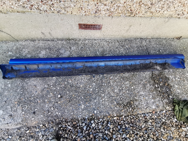

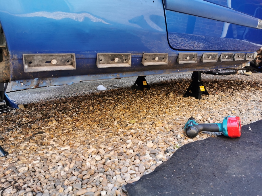

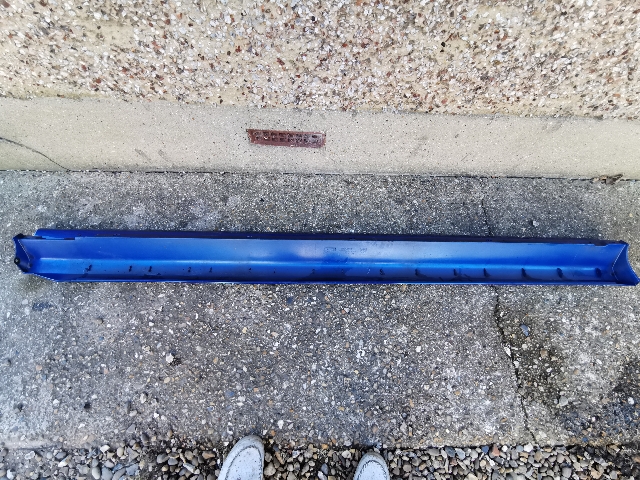

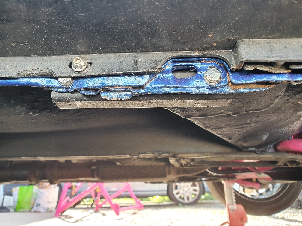

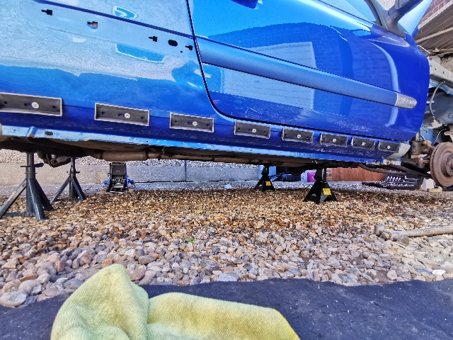

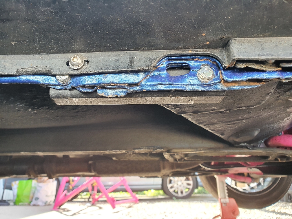

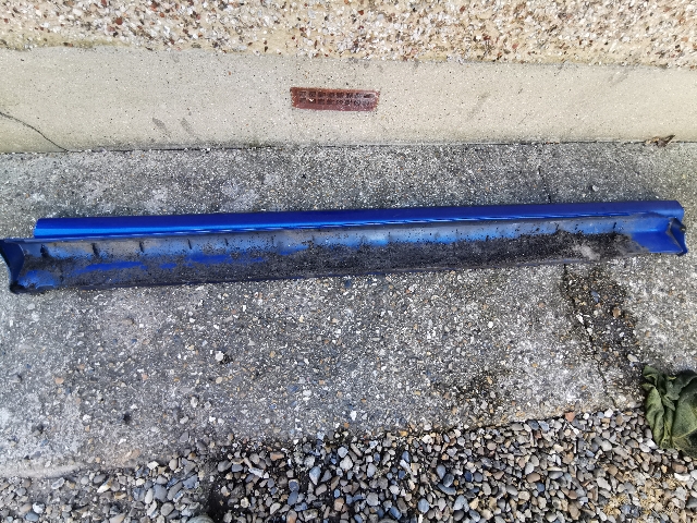

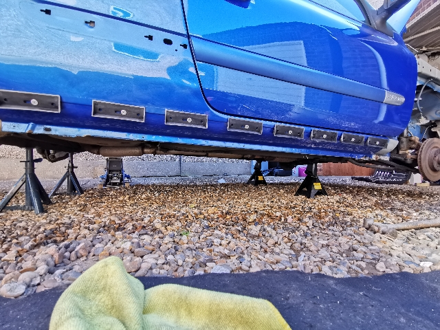

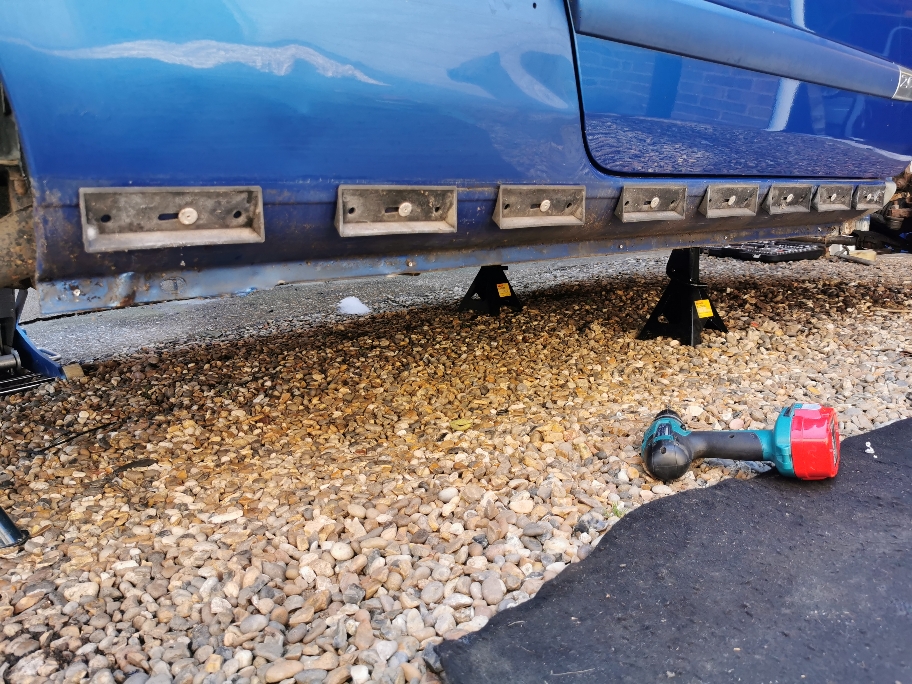

Get those sills as well cause they'll be corrosive s**t in there too.. Just pop rivets along the bottom and they pop up and off the hangers. Replace with m6 Riv-nuts and dome head M6 bolts..
Loving this thread..

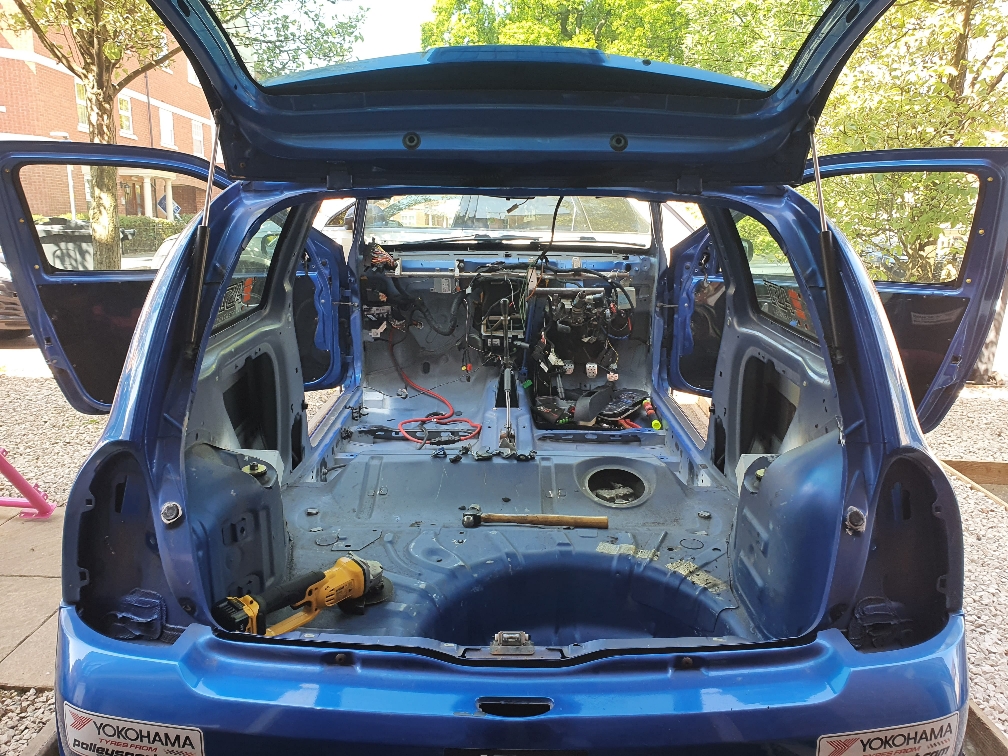

Dont go this far though. You wont need to if youre keeping the interior...[emoji23]
Im currently prepping it to spray all the interior..

Forgot to say about the popcorn pot that thing has been used for everything bleeding brakes, now mud pot I swear it's indistructable [emoji23]
I like the sound of the riv nut along the skirts I have not got a tool any idea of the cheap ebay ones are any good

I got mine from Amazon.. its like a bolt cropper type tool.. Once you own one its addictive..

Where the front jacking point is, no doubt its folded over and rusty, straighten it all up and treat it with rust restorer. Then get a 1 inch square steel box section and bolt it up against it so it doesn't fold up in the future when you need to jack it up..

Only drivers front is bent up but that does look a good idea too I was going to have a go at straightening it but didn't want to make it worse

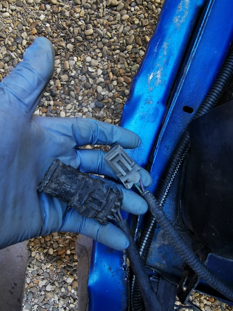

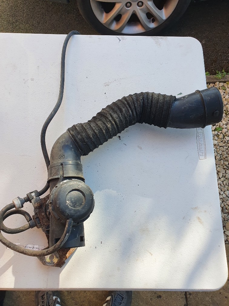

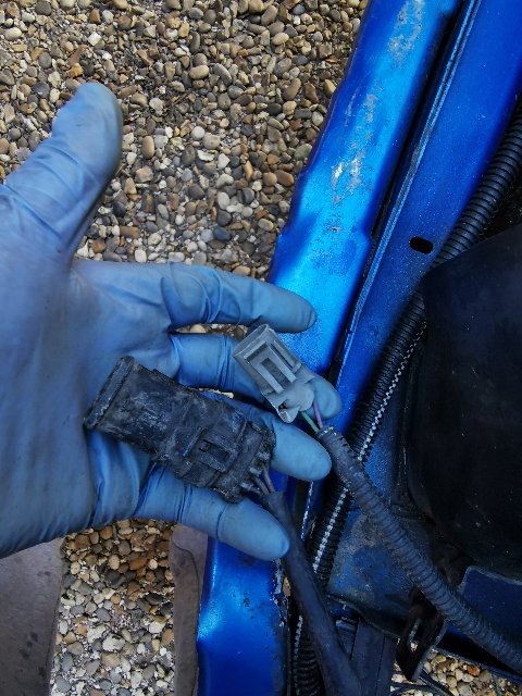

Left front corner I have 2 plugs that wasn't pluged into anything
Any ideas
Any ideas
Not going to be doing much more today taking my daughter for a bike rive now so maybe a quick wipe over when I get back View attachment 1469078
Sent from my VOG-L29 using Tapatalk
Black is foglight and grey is acoustic valve
Dont quote me on the grey one though

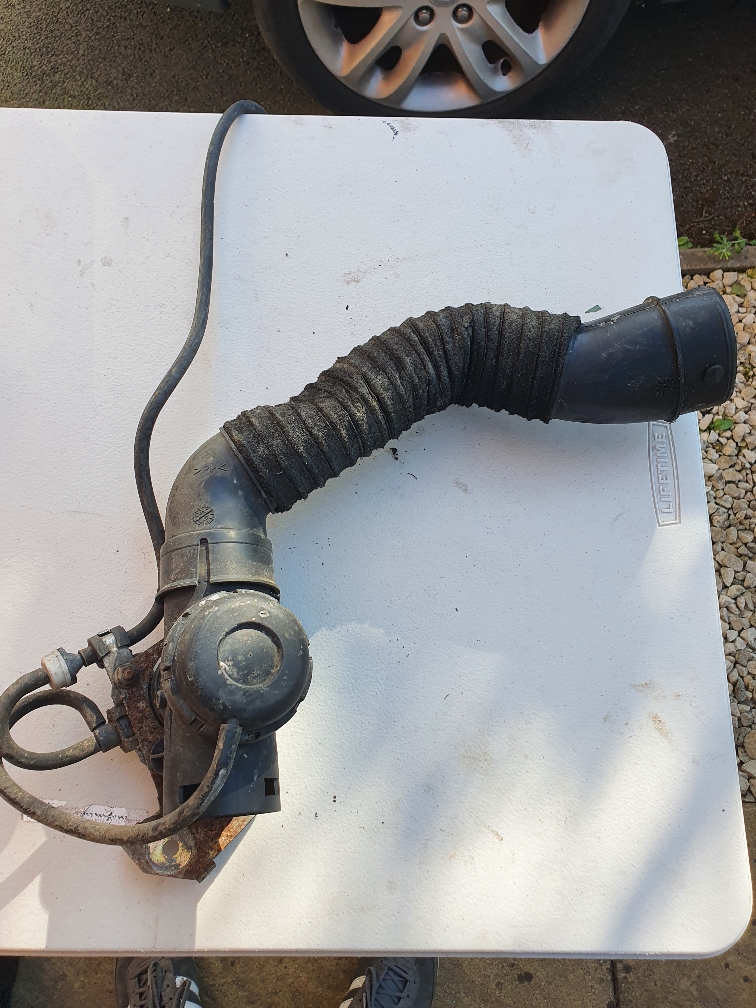

Looks like mines missing then that explains the blanked off vacum near the throttle body
I think it's got a panel filter fitted

You can have this one if you wanna go OE.. Just pay postage and ill send it ya..

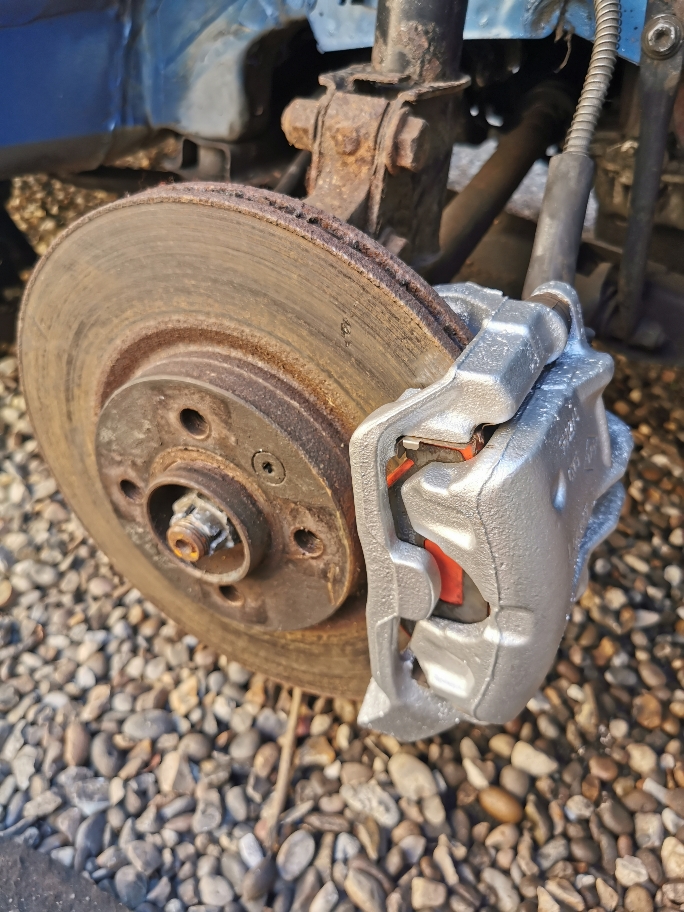

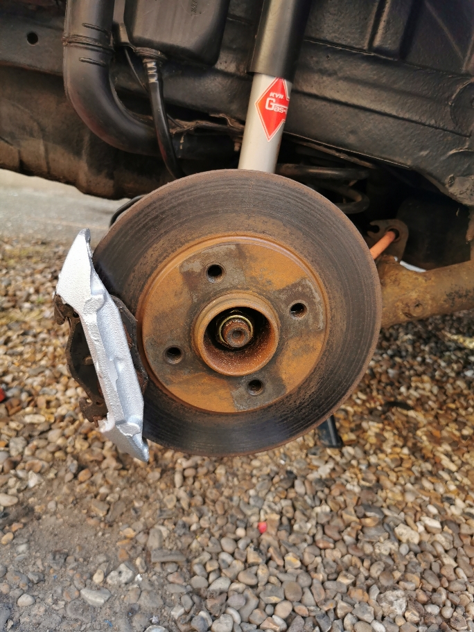

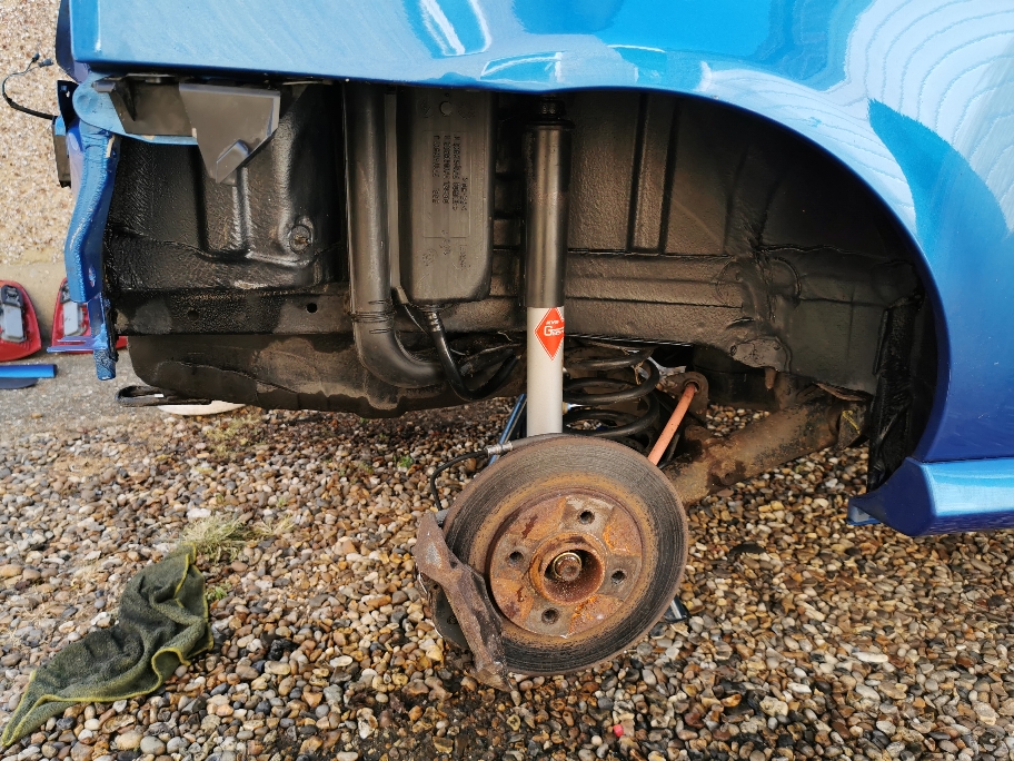

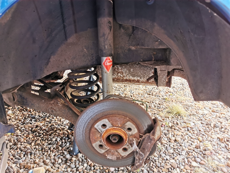

Removed all the brake Calipers today, cleaned and painted nothing special just a quick blow over, I wanted to check out the Calipers more than anything

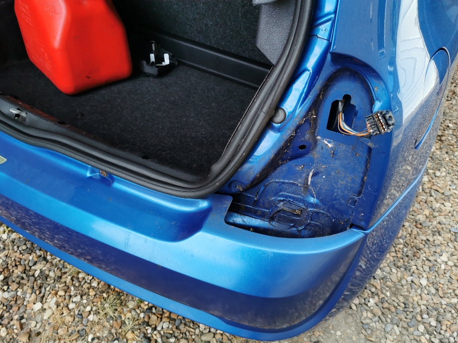

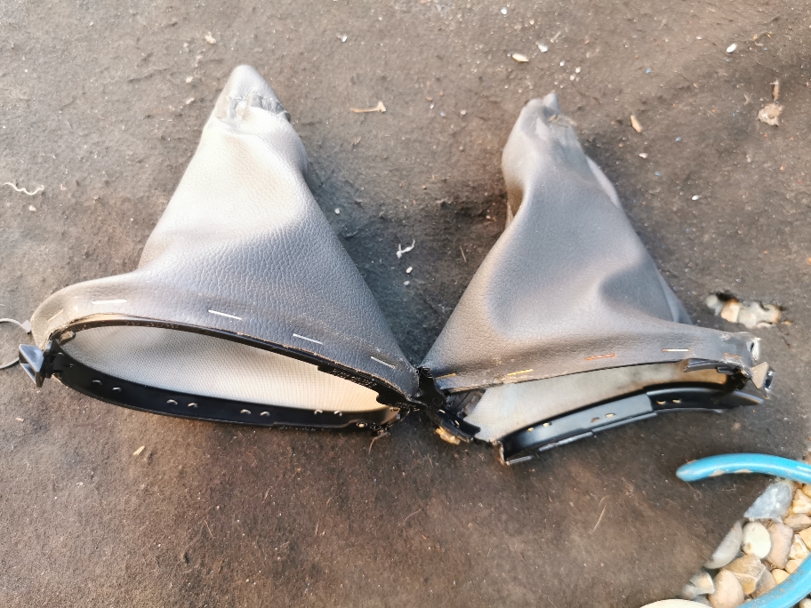

My buddy phoned to say he had a scrapper on and did I need any parts, so I grabbed a couple of window seals a gear gaitor and a rear light cluster to sort out a rusty terminal

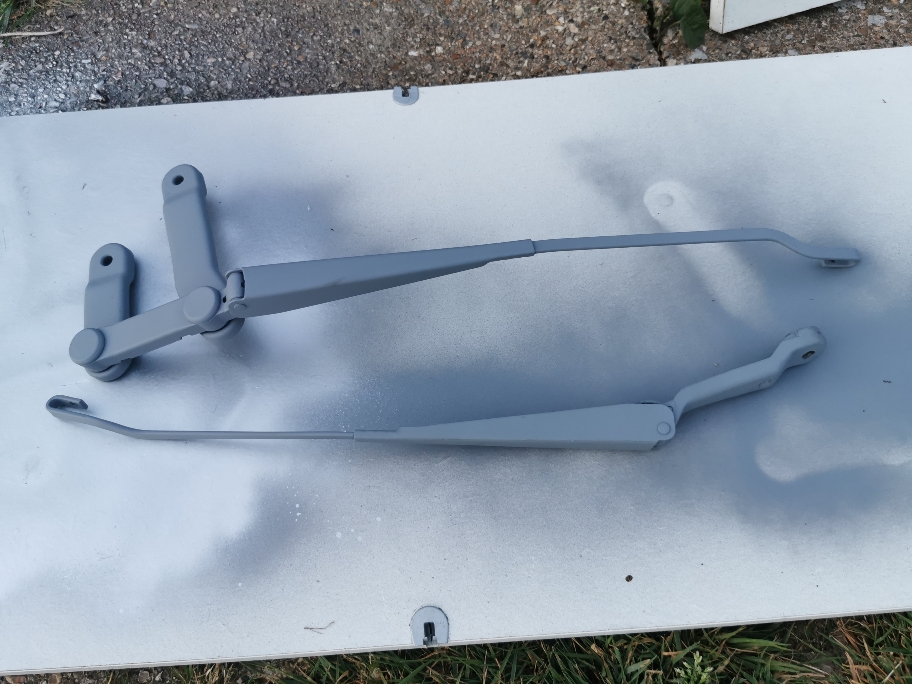

Painted the wiper arms too
Not a bad day considering I've been to work for 8 hours too
