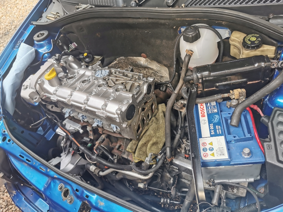

Change of plan the cars going to Beaniesport on Friday for the cambelt and exhaust to be fitted

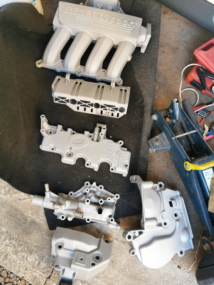

I'm picking up some bits from James Seaton that have been aqua blasted to tidy up the bay too

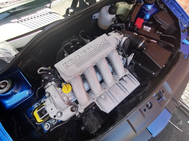

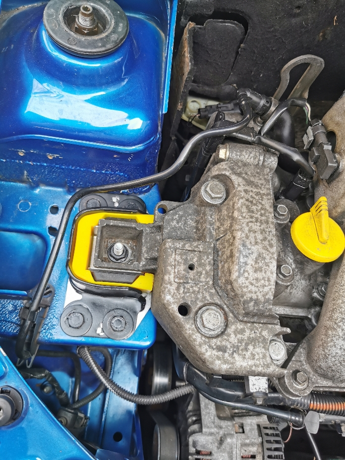

Fitted the engine mount with powerflex Bush and painted the bolts

Second that with Chris. Mines going back in a couple of weeks for more work. I also did the Aqua Blasting on my cup, really happy with how it came out.

That looks sweet hope mine comes out as good as that tbh the cars a bit of a beater but I'm slowly working my way through it

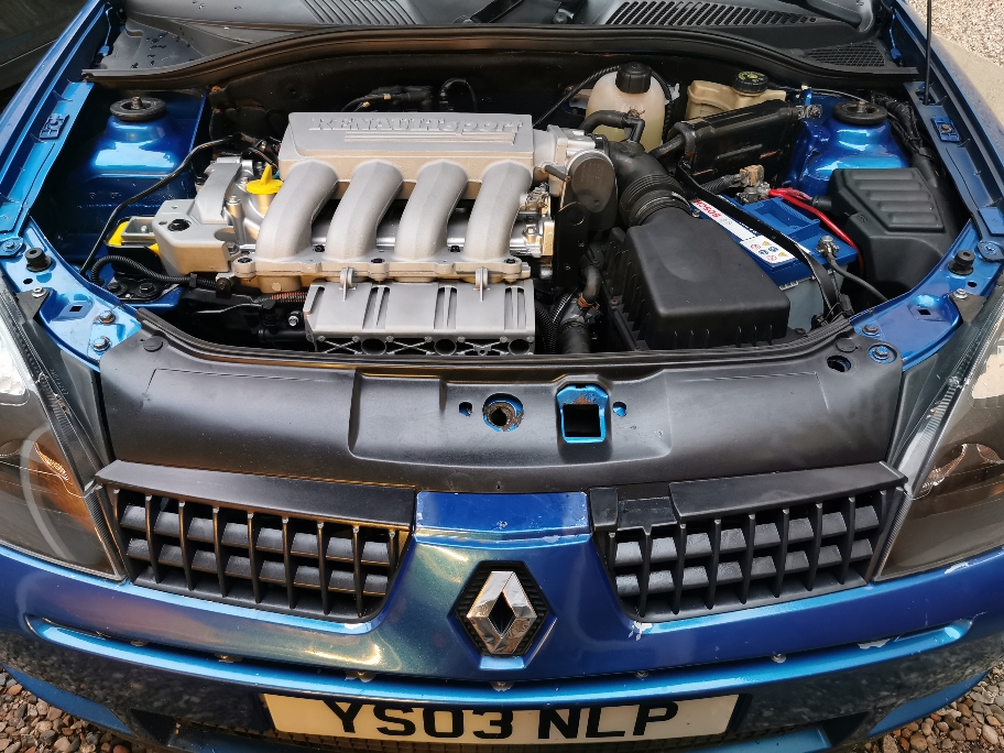

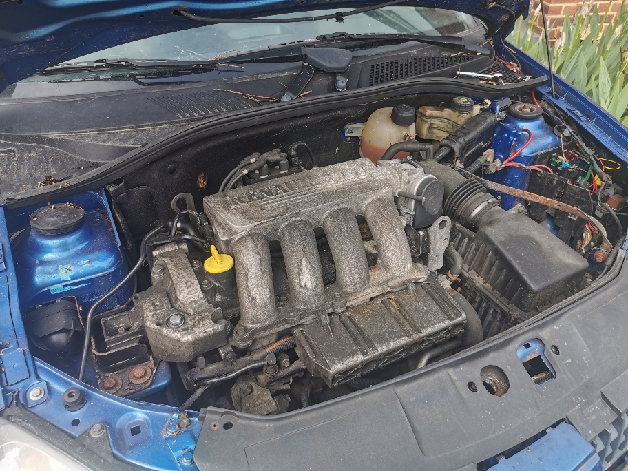

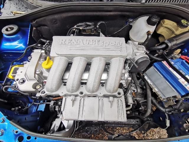

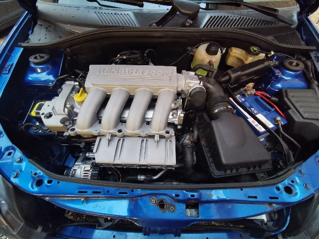

Cam belt and water pump a dephaser pulley and resealed the rocker cover was done by beaniesport Friday
So I've cracked on with it today and ordered a few parts
New Alternator
New radiator
Used power staring pump as it was leaking
Thermostat and gaskets for the block piece as I've got a clean one to fit
Breather gasket on the rocker cover
Power stearing fluid
I've flushed all the pink antifreeze from the engine ready for genuine antifreeze
Blown all the power stearing lines through ready for new oil

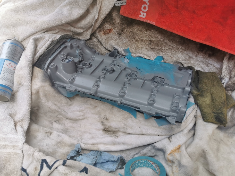

Start painting a few bits ready for when it goes back together
And a few pics of the car it actually looks good from 20ft away [emoji23][emoji23][emoji23][emoji23]

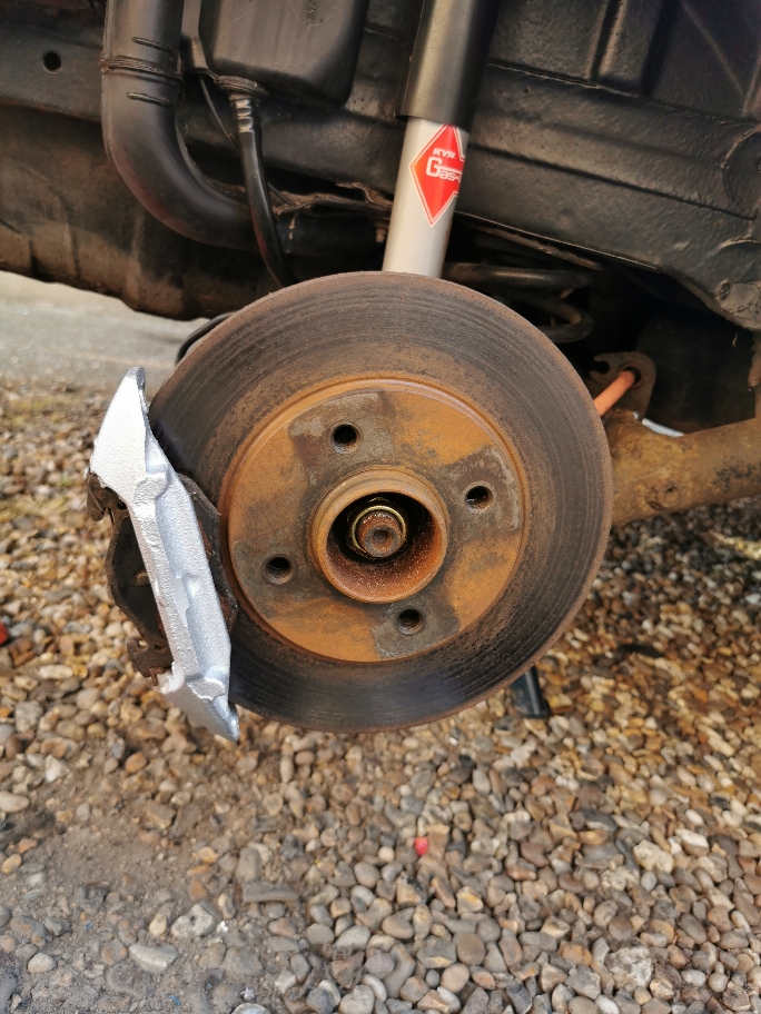

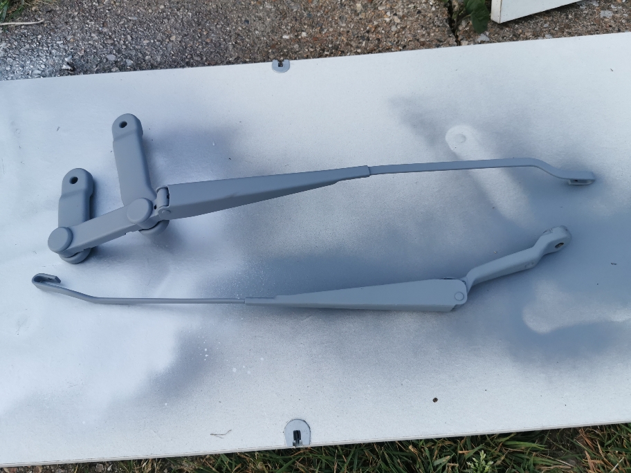

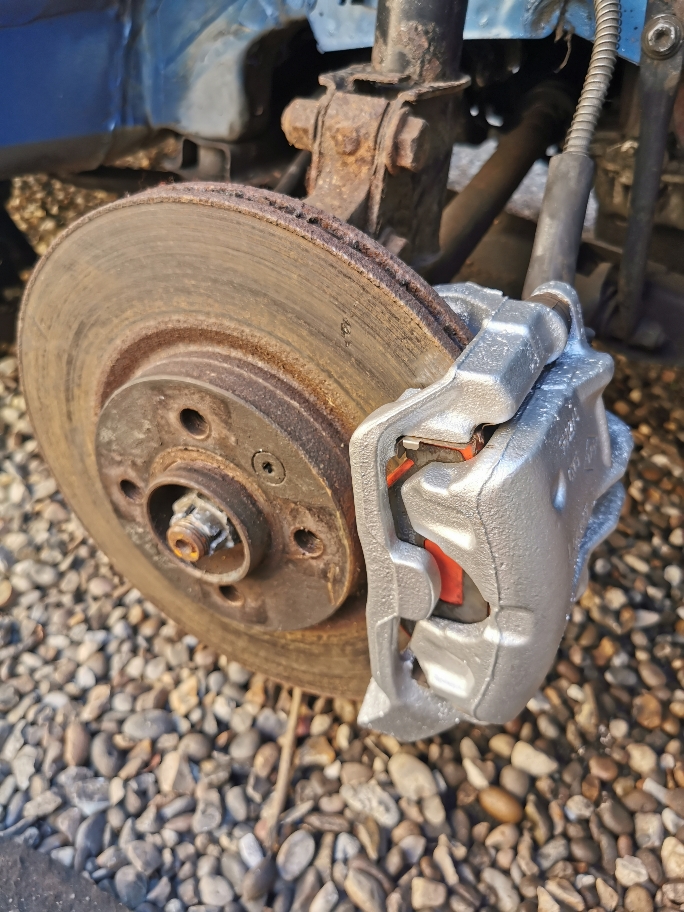

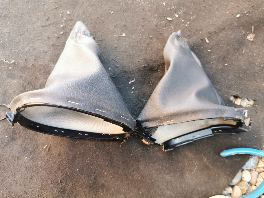

Removed all the brake Calipers today, cleaned and painted nothing special just a quick blow over, I wanted to check out the Calipers more than anything
My buddy phoned to say he had a scrapper on and did I need any parts, so I grabbed a couple of window seals a gear gaitor and a rear light cluster to sort out a rusty terminal
Painted the wiper arms too
Not a bad day considering I've been to work for 8 hours too View attachment 1469499View attachment 1469500View attachment 1469501
