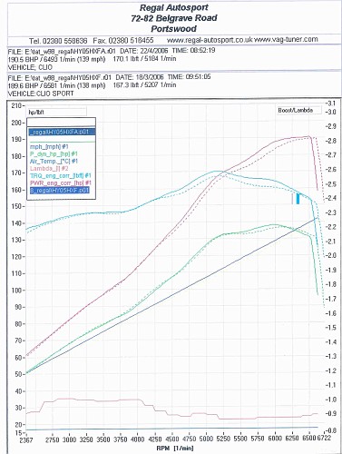

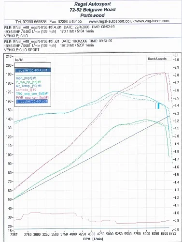

we have nothing to hide with our products. Here is our rolling road result....
Tho a think it might come out small due to Fotki....
Power is up across the rev range, as is torque.
Dotted lines being original car, standard system but with ITG panel, then solid lines with BTB system fitted.

The standard car appears to have an unfeasibly high power output cos the actual gains are small. In fact about the same as I got with group N and manifold.
A ''Fantasy Island'' dyno I fear.

I think what we have here now is strong evidence to suggest group N's and pmurray's, not forgetting inlets, are not all they are cracked up to be.

The engine already produces 90bhp/litre with good torque. Tweaking the map whether its a group n or a p murray map will get you better gains in driveability but peak gains will be small as the original map will already be optimum on full throttle and 5k rpm + revs.
I saw a thread on the williams clio forum where some foreign bloke had a throttle bodied engine that reved to something like 9000rpm! and had 240bhp. This would be a pretty hardcore engine that made all its its power 5krpm+
From what I have seen on this forum a 182 will make approx.
+5bhp with exhaust filter remap
+15bhp with that and cams
+40bhp with all the above and ITBs
+45bhp with higher compression
Thats for a car running road cams and peak power at around 6500rpm.
I hae seen people claim ridiculously high figures for there mods but they dont add up when you look at the big picture.
Fair play ja.jack for doing the back to back tests you cant really argue with the results can you?
