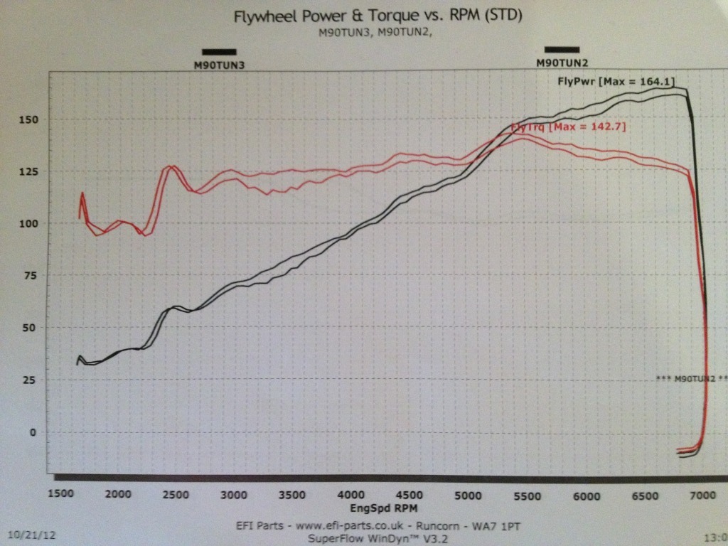

Headed down to EFI with the NW lot for the RR day, great day, alot of nice cars there, but car of the day for me had to be the mental RWD Mk1, shame he destroyed 5th gear..
So got my car on... Result Below..
164.1 BHP and 142.7 Torque
Quick conversation with Scoff, he thinks my timing is out as the peak power doesnt come in till the rev limiter.. Which is understandable as the previous owners "Friend" did the cambelt.. So il have to get the timing sorted out and head back down there some time to see what power it pull when everything is correct!

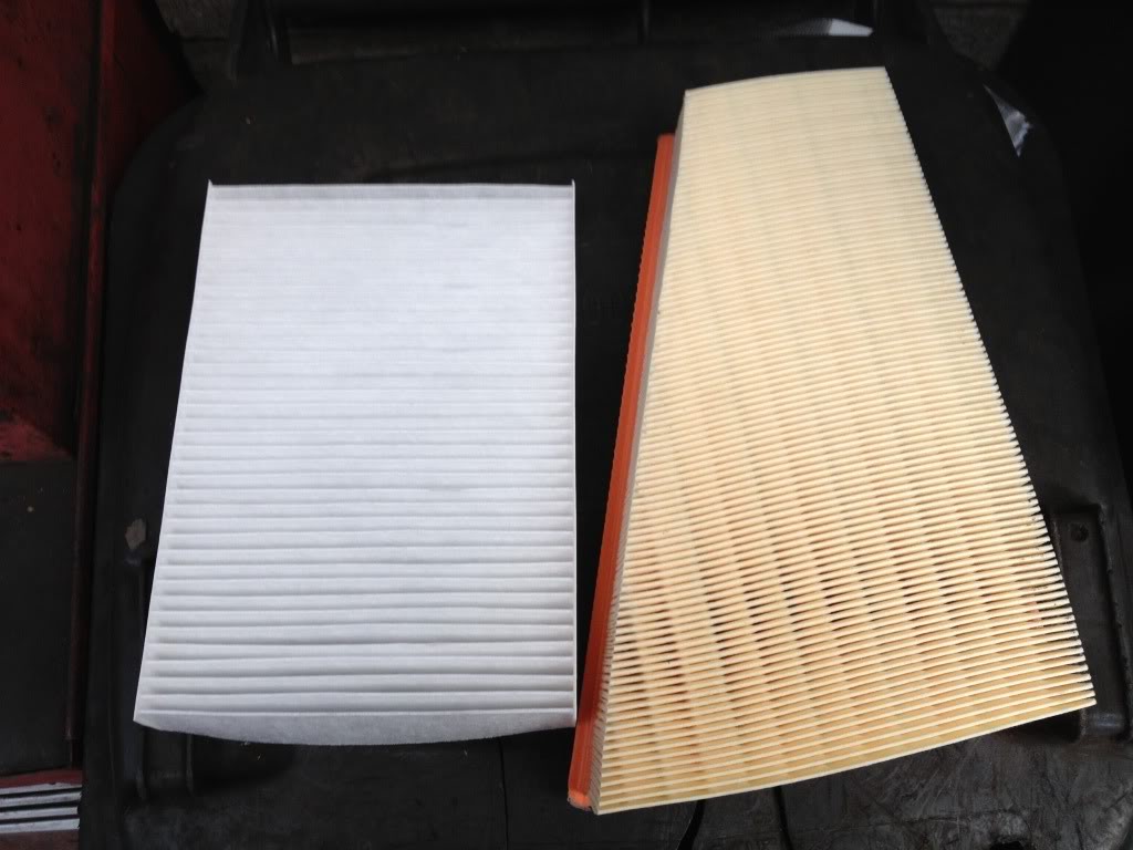

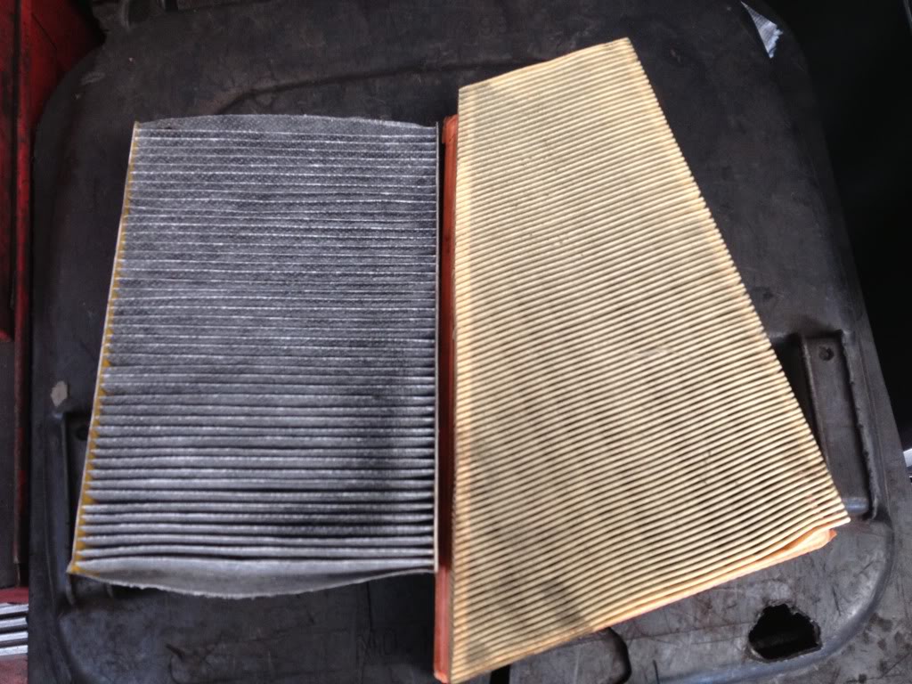

Decided to change the Air Filter and Pollen Filter, both were looking a little tired upon removal!
Old:
New:

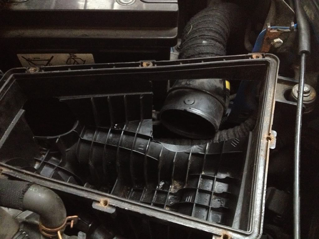

Also whilst the air filter was out, (if you actually read the previous updates , then this will make sense..) I decided to grab a picture of my modified airbox... Same basic idea as the Megane 'Airbox Mod', gives a bit of induction noise (not to loud) without going down the expensive induction kit route, will try get a video some time, if anyone is interested..

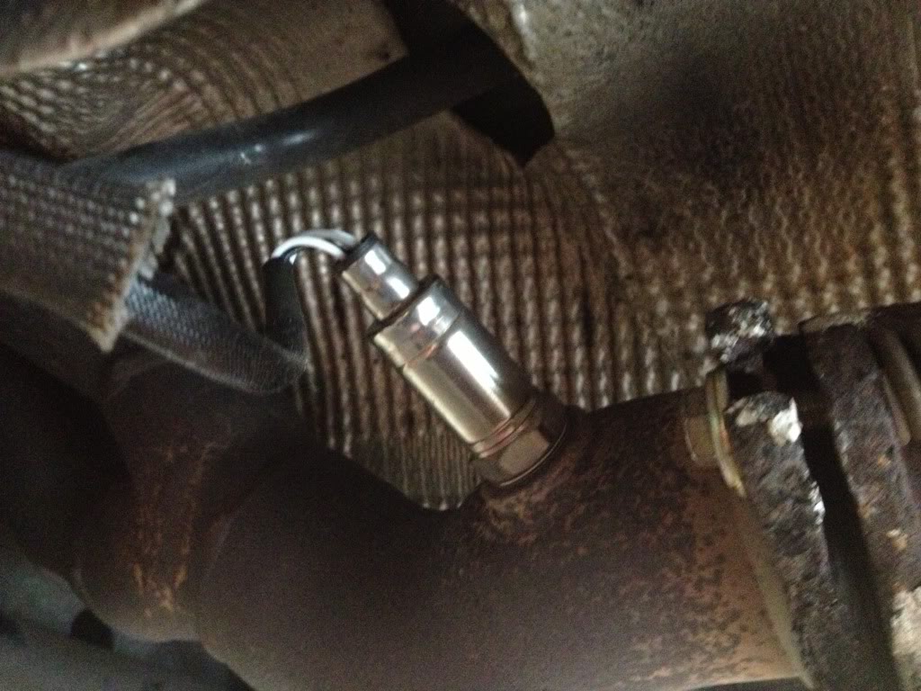

Engine management light was coming on and off, turned out the Pre-cat lambda sensor was about s**t so fitted a new one! seems to idle a bit better now too

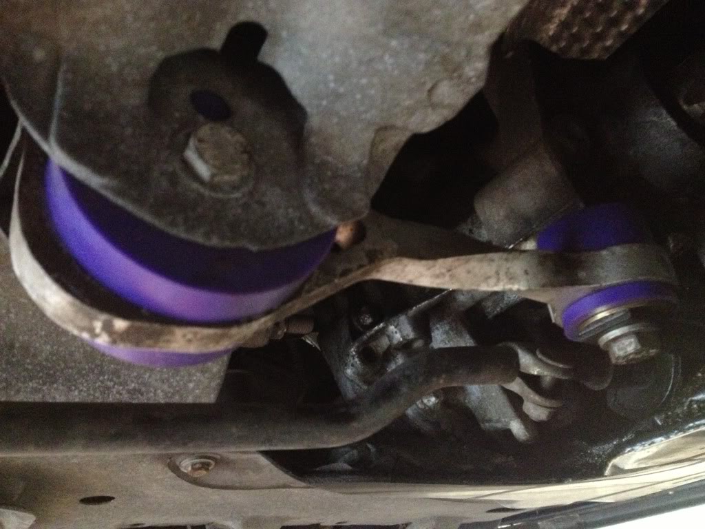

Also while it was on the lift I decided to take a pic of my recently fitted Polybush dog bone mount since I didn't have one for the last update :o

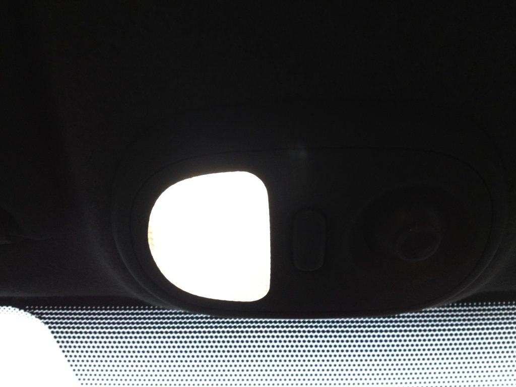

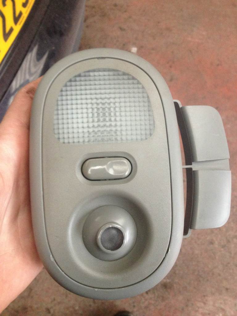

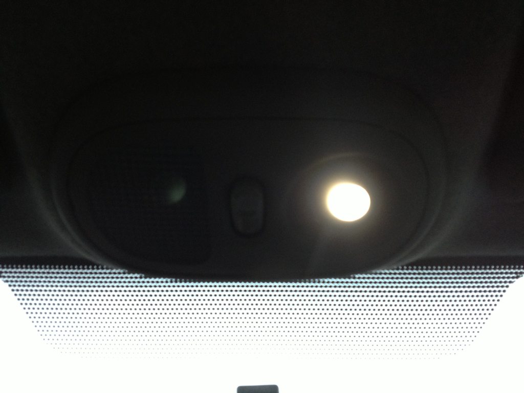

Again nothing major just decided to have a play with the interior light...
wasnt happy with the poverty spec light I had so I wanted to change it...

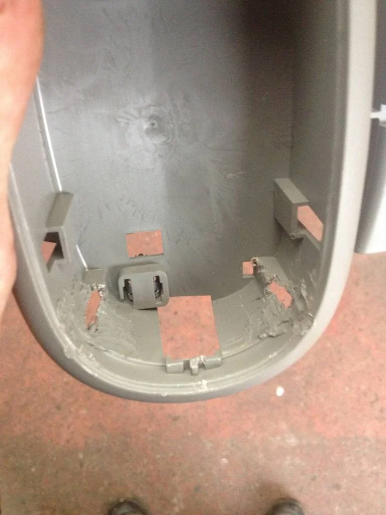

So off to the scrap yard I went to source a new light...

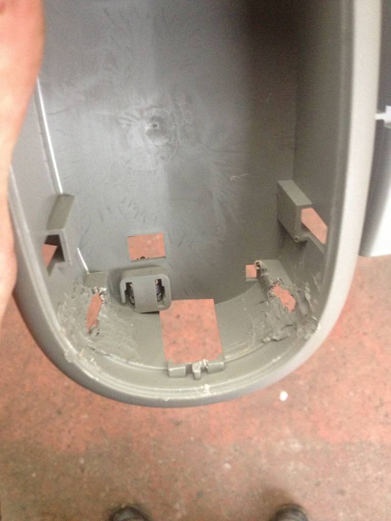

upon attempting to fit it wouldnt so some modification had to be done to the housing..
Pikey modification!
And it fits!

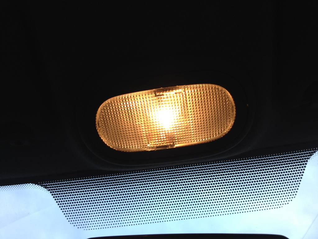

So Before!
After!
something simple but im happy with it :)

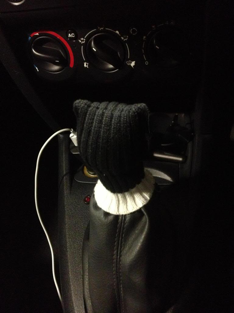

Not really an update tbh, just a quick vid from inside the car of my 'Airbox Mod'
Also the Ph1 Gear Knob has gone into winter mode! :o
were did u get the beanie for your gear knob mate? Looks good...

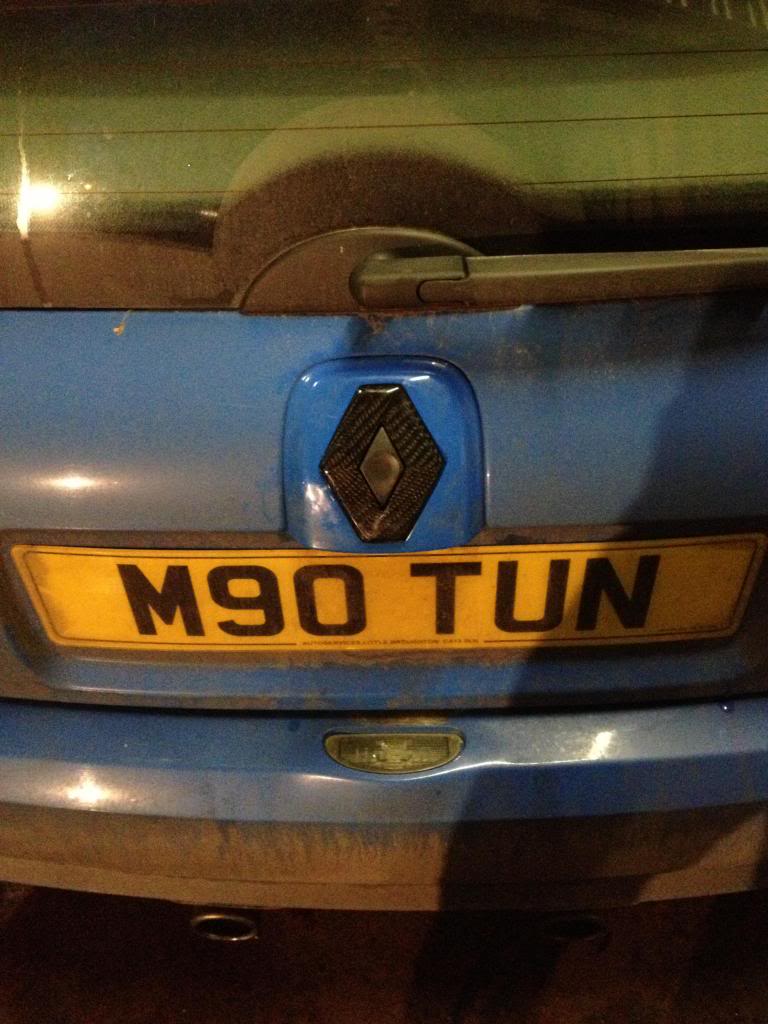

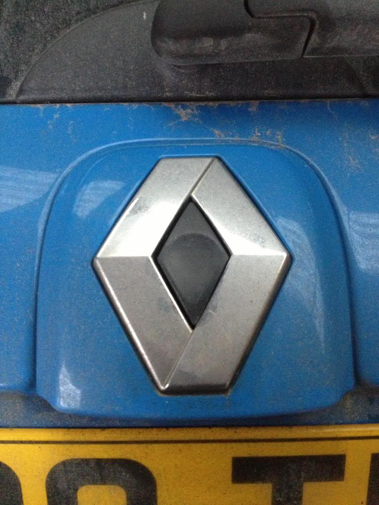

A month back I asked Chris If he could wrap a couple things for me (Rear Diamond and Dial Surround), last week I remembered about it :o So paid for them on friday and they turned up today and so i got them fitted while I was bored at work..
Before:
Yes the car is filthy...
After

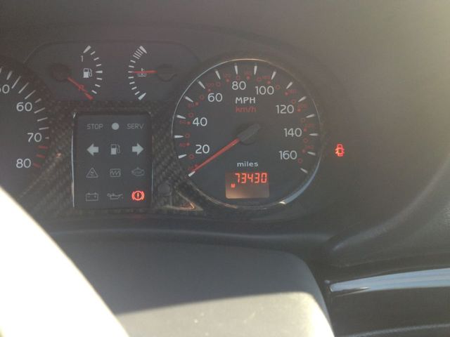

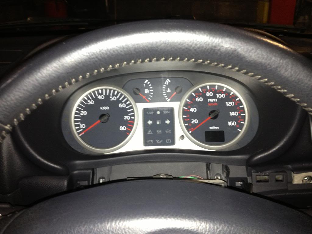

Dial Surround Before:

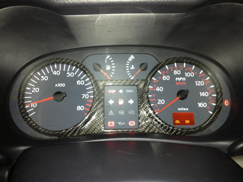

After
How hard was it to fit the surround mate
Fairly simple, top dash off, clocks out, strip them down, you need a way of melting the little bits of plastic holding the surround in place (I used a soldering iron) Take old one off Glue or Remelt some plastic to hold the new one one, put it all back together..

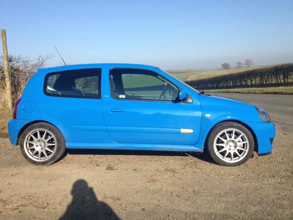

The car is pretty much how i want it exterior wise!

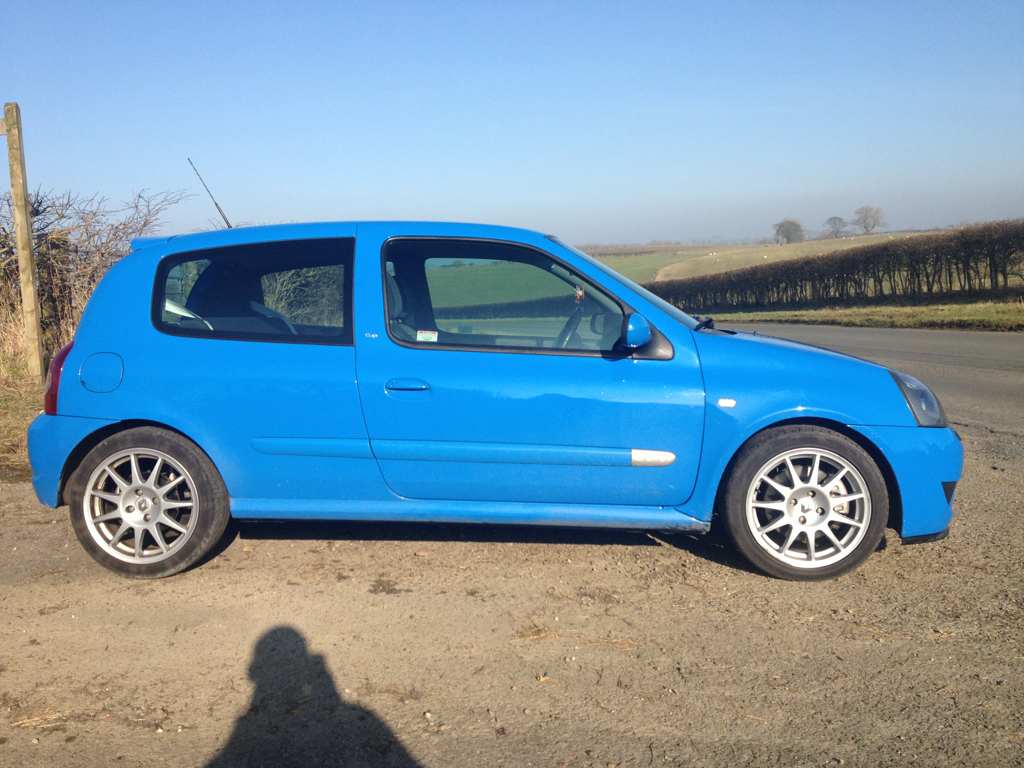

Managed to find a set of eibach sport lines for a bargin price of £50! They replaced the broken springs I was rocking!
Not an obvious drop but for £50 i didnt care!

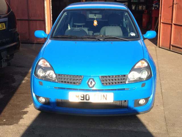

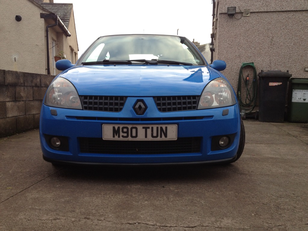

Bought and fitted a set of 172 xenons! Freshen the front end up nicely!
Not a great pic :o

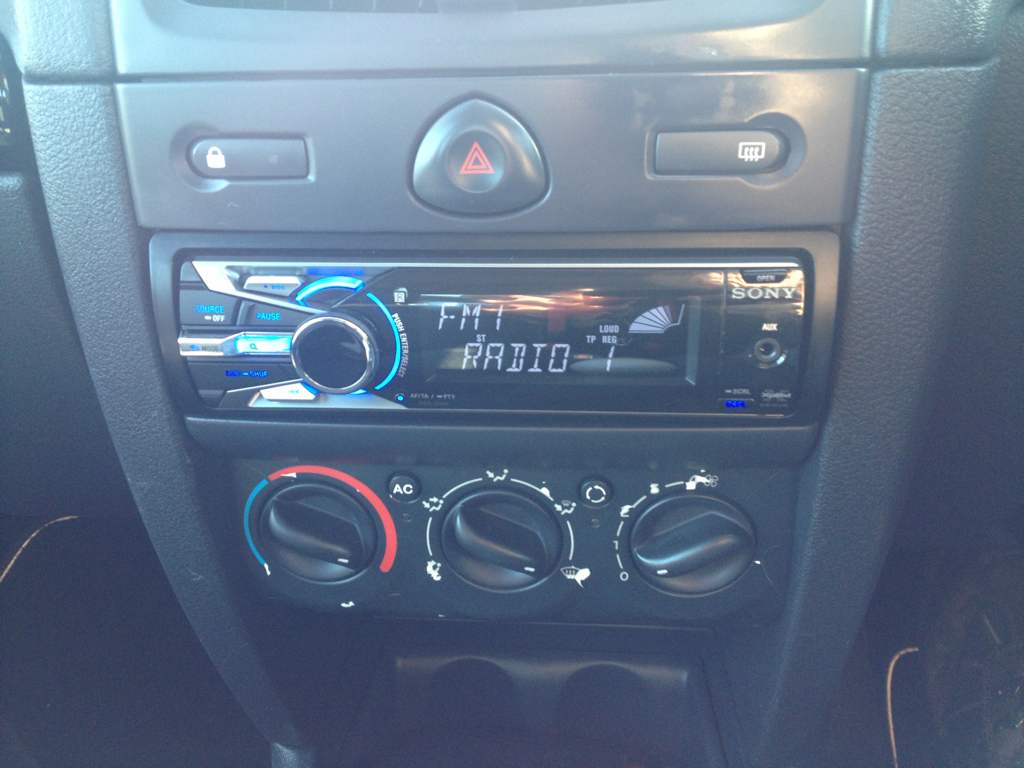

Picked up a new head unit so i could use my iPod!

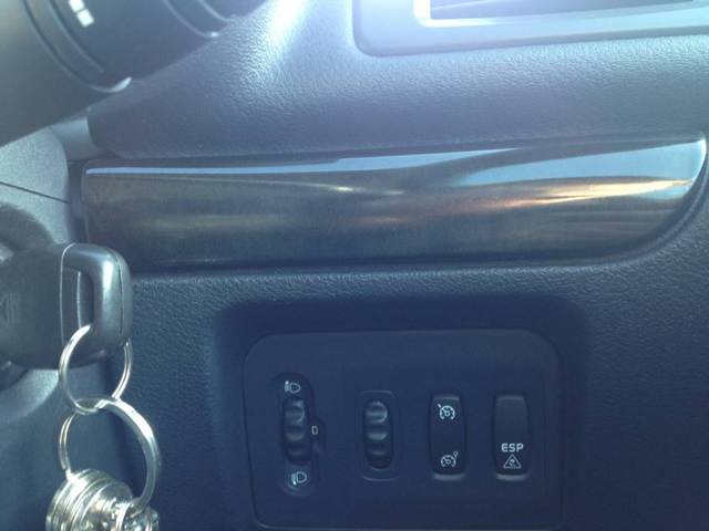

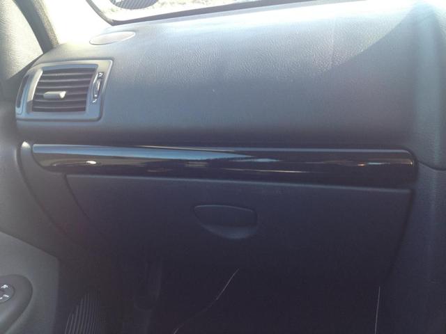

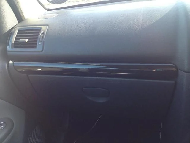

Got sick of my dash strips being all scratched and marked so found some ford panther black and sprayed them!

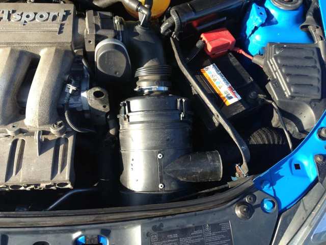

Also got myself a bargin ph1 airbox for the lovely price of £5! Stuck a standard filter in and away i went!

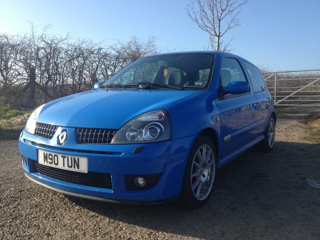

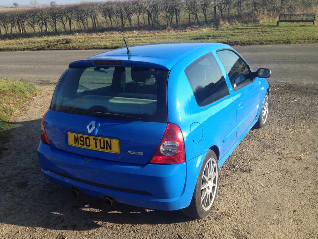

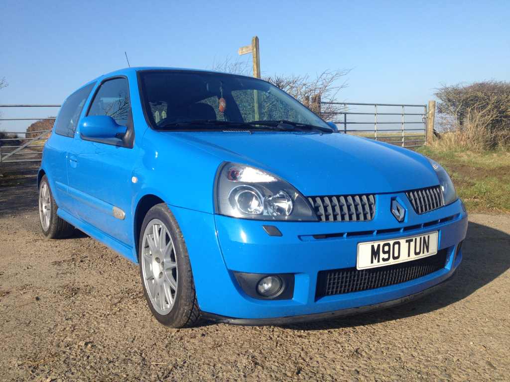

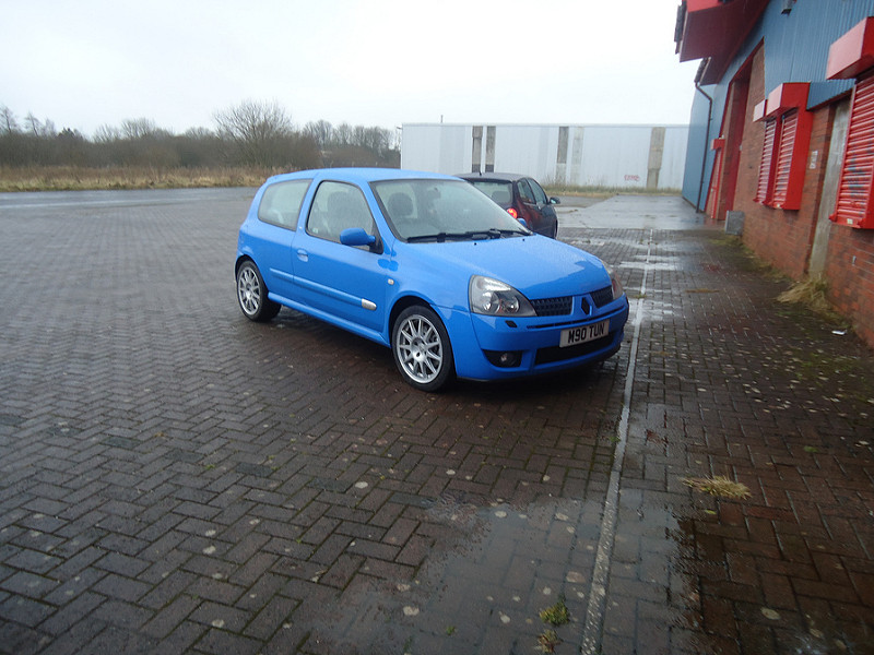

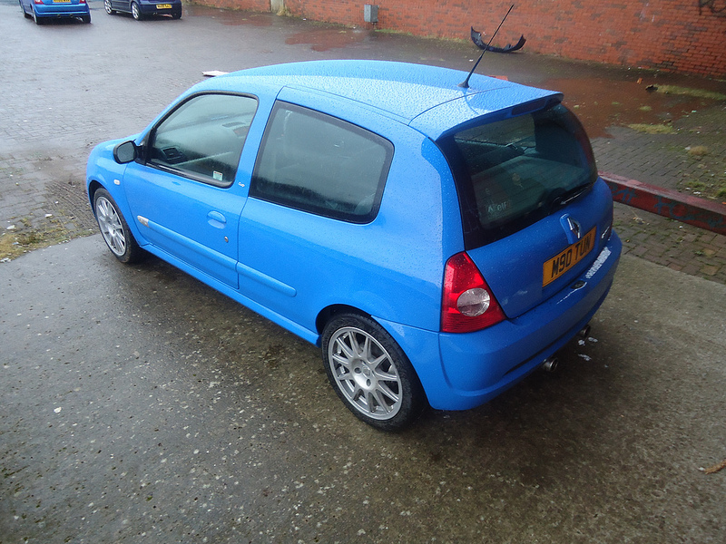

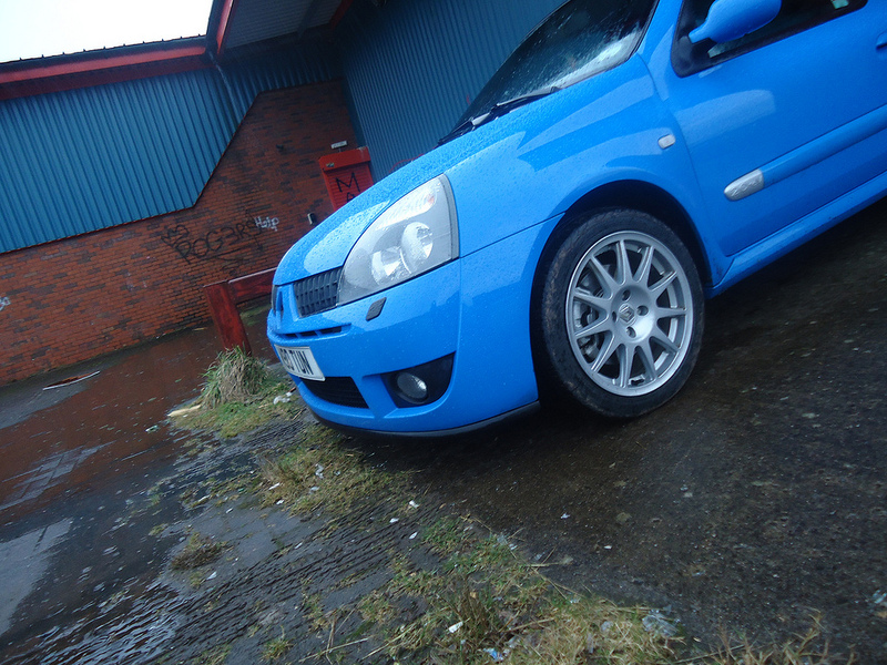

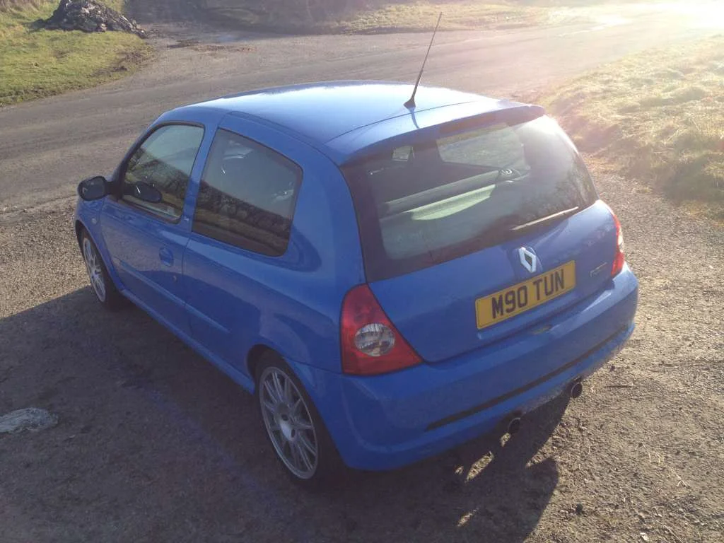

Pics of the car, slightly filthy..
All i need to really sort now is the paintwork an exhaust.. Once thats sorted il be happy!
£5 for that airbox? Jesus. Is the the Espace one or the Clio V6 one? Looks like the Espace to me. You could sell that for around £60+ LOL!

Its a Ph1 airbox Neil, there was a Ph1 in the scrap yard (RIP :( ) so decided to grab a few bits off it, airbox, Light stalk if i decided to go for an aftermarket wheel,
