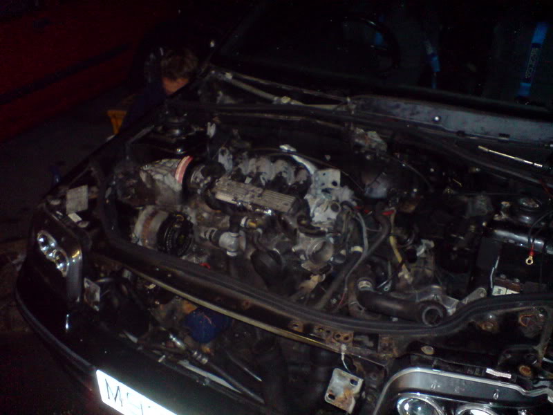

i have done it, the volvo lump is exactly the same block as the rsi.
here is the volvo lump in my engine bay, the inlet has now been changed for the polished one below. putting the engine in was the easy part the hard part was the wiring loom. had a few teething problems with the turbo melting the accelerator cable housing and a boost pipe popped off on the motorway, next thing on the list is a new bigger exhaust system, if you got any questions i will try and help you out

Myself and Djw Dave have worked on his car for erm some time and only got it on the road this month, as above wiring is a b**ch!
DYP, have you managed to get the rev counter to work at all?

nah not yet mate, away alot in USA so aint had time, its on my to do list, hows is yours running?
Its Daves, its just a lot of my blood and tears on/in it! ;)
Seems to be running well, maf has been turned down and its using a lot less fuel! Thank god, was 40 miles to a tenner at 1 point! Seems pretty quick, so reallly looking forward to tuning it a bit! Hows yours?
not to bad need to get lil bits sorted, want to re route the acc cable somewhere else as i melted one from the turbo heat haha. next on the list is a new straight through system, what sort of boost is daves running

tbh the conversion is a rather large task.. its took me a fair few months and its running but giving me a hell of alot of problems. advice i can give is start with a 1.8 rsi and your life will be alot easier.my first attempt was into a 1.4 and it was alot harder.take your time with the wiring and ensure the exhaust downpipe isn't holding the engine at any strange angles. You can pick up a good volvo 480 for pennies now,start with the whole doner car,making the wiring alot easier to understandand you may have luck with some nice leather seats from the volvo.i regret selling them seats soo badly.
