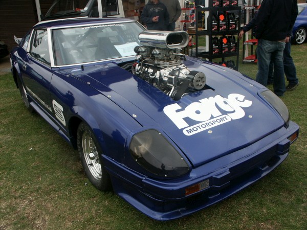

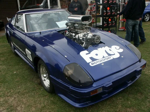

how do they get engine stickin out of the front i love american muscle cars and locve the charegr on fast and furious......info about this would be great, pm me

thats not the engine sticking out the bonnet lol thats the supercharger and its out the bonnet because its a v8 so that sits between the v and dosn't fit hence the hole
