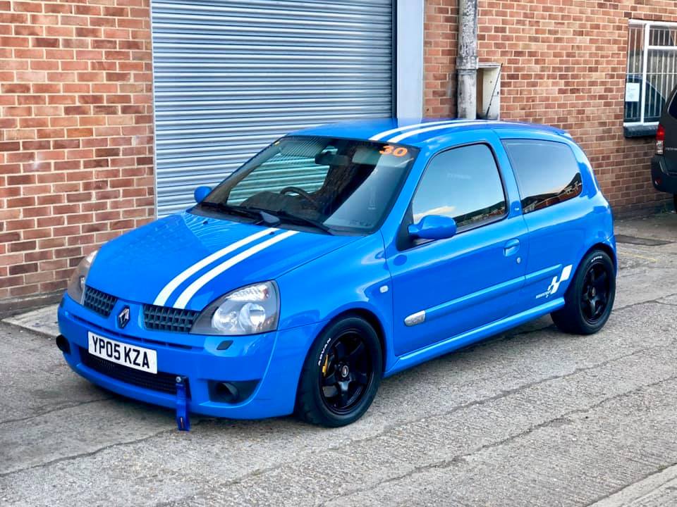

Just bought my old track car back, an 05 Racing Blue 182. It's a nice spec and always went well. But I need more power! I've been looking at the Engine Dynamics 230 turbo conversion for £2800 fitted or the 280 turbo conversion for £4600 fitted. There's also the K-Tec 260 supercharger kit for £4300 which I feel would be more reliable and better suited for heavy track use! Thoughts please :D
