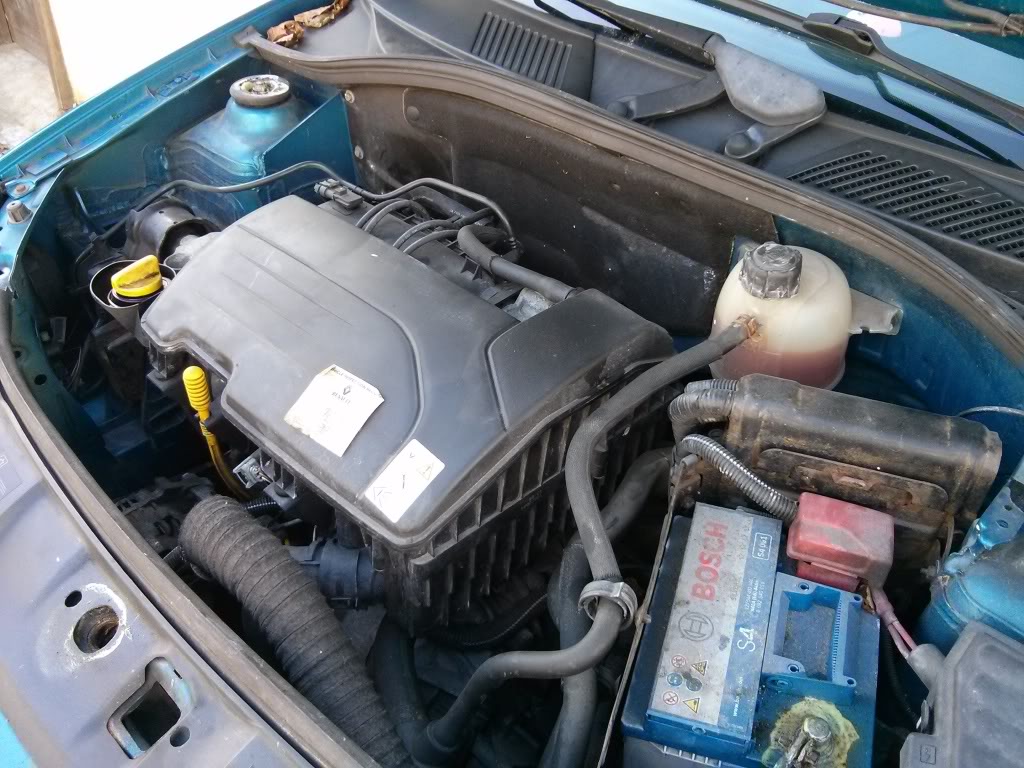

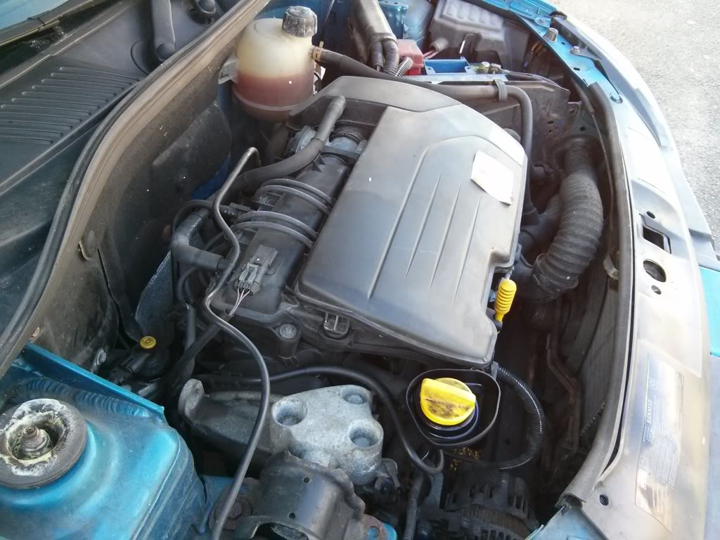

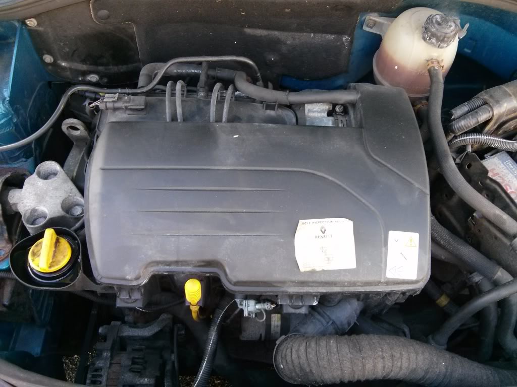

Hey, can someone tell me what type of engine this is, and where the throttle body is, the car is idoling funny and I think it needs cleaning but I have no idea what engine type it is or where it is
Thanks :)
  1.2 172 conversion
The black box on top is the air filter lithere is a jubilee clip on the top right undo that and lift the cover by the bottom bit of a wiggle and it slots off the throttle body you will see in on the right hand side near enough located in the same place as the f4r
