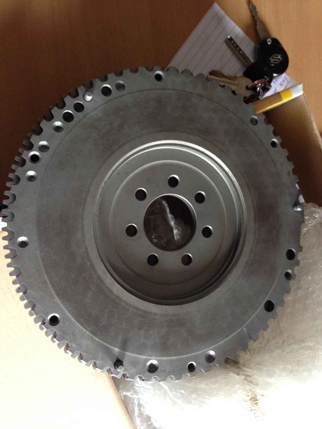

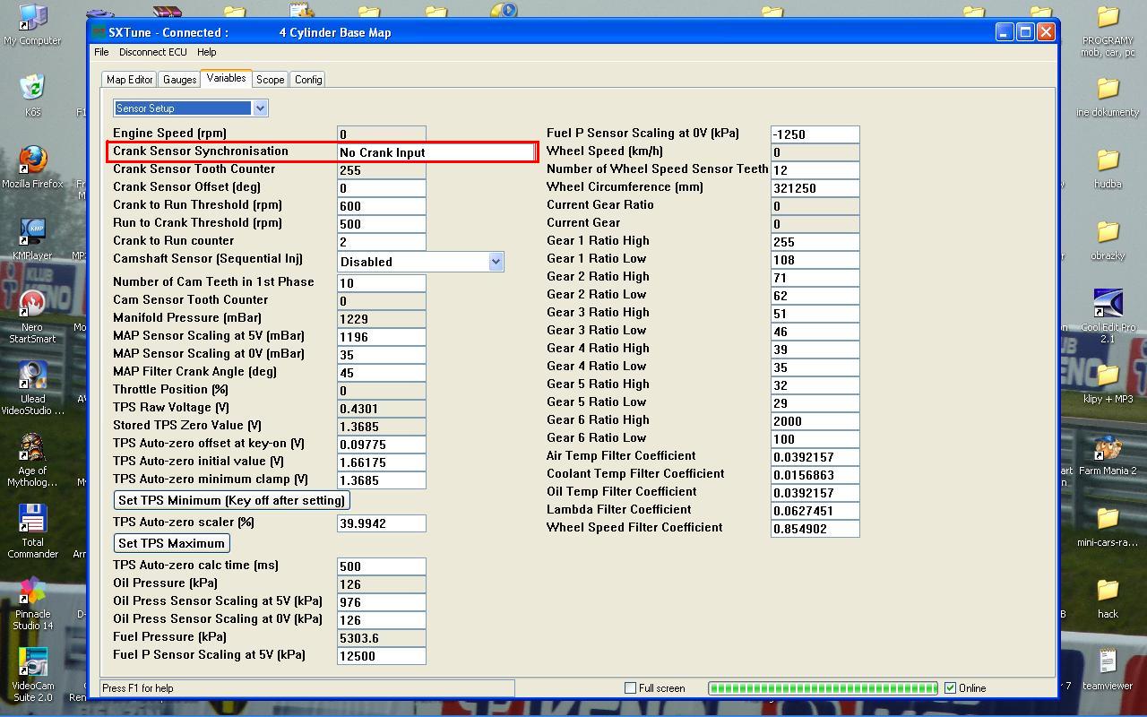

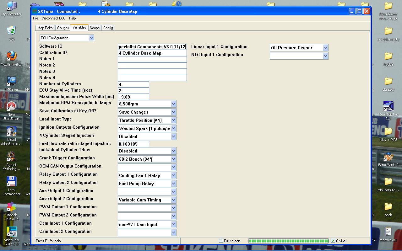

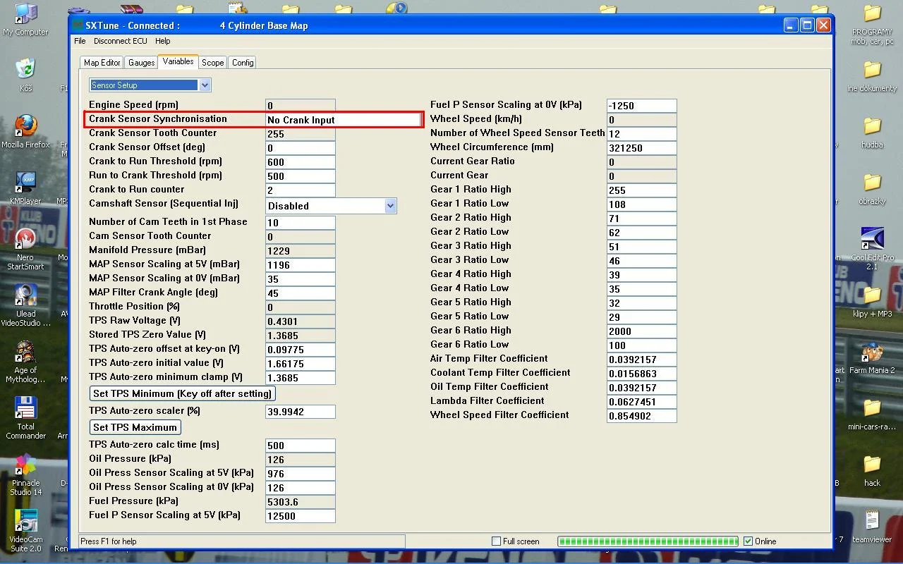

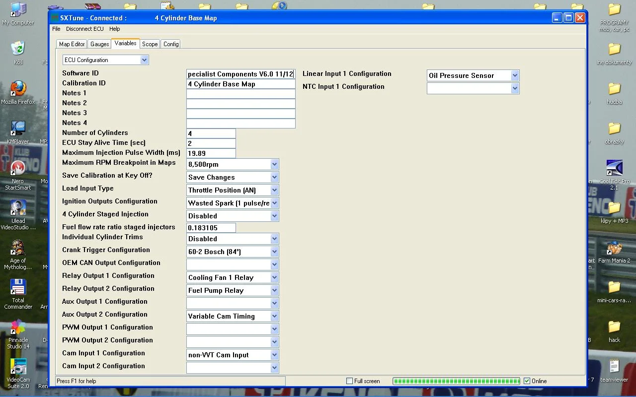

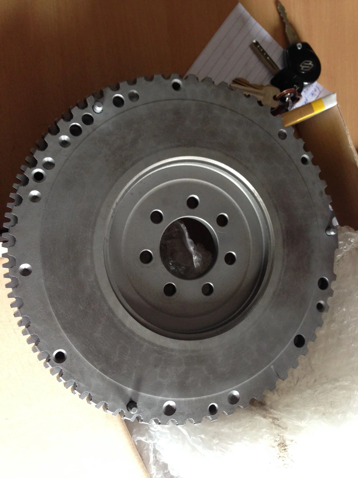

I have problems with my renault clio sport 172. The car ran without any problems, I mounted throttle bodies and the ecu typhoon 2 from atpower. After connection, I tried to start the car and I could not. Engine rotates, fuel is injected, it indicates the engine but when I look in the computer status crank sensor so there is written not synchronized. Can you tell me what could be the problem? Already I tried to replace the two sensors and help. I mounted a new flywheel because I changed for underload.
Thank you for your help
The connection is correct, advised me yesterday of the problem may be that the settings I have set the number of teeth on the flywheels 60-2 and said it ought to be 58-2 but I do not know whether it is true ...
