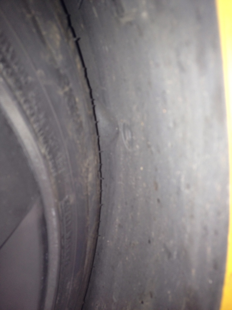

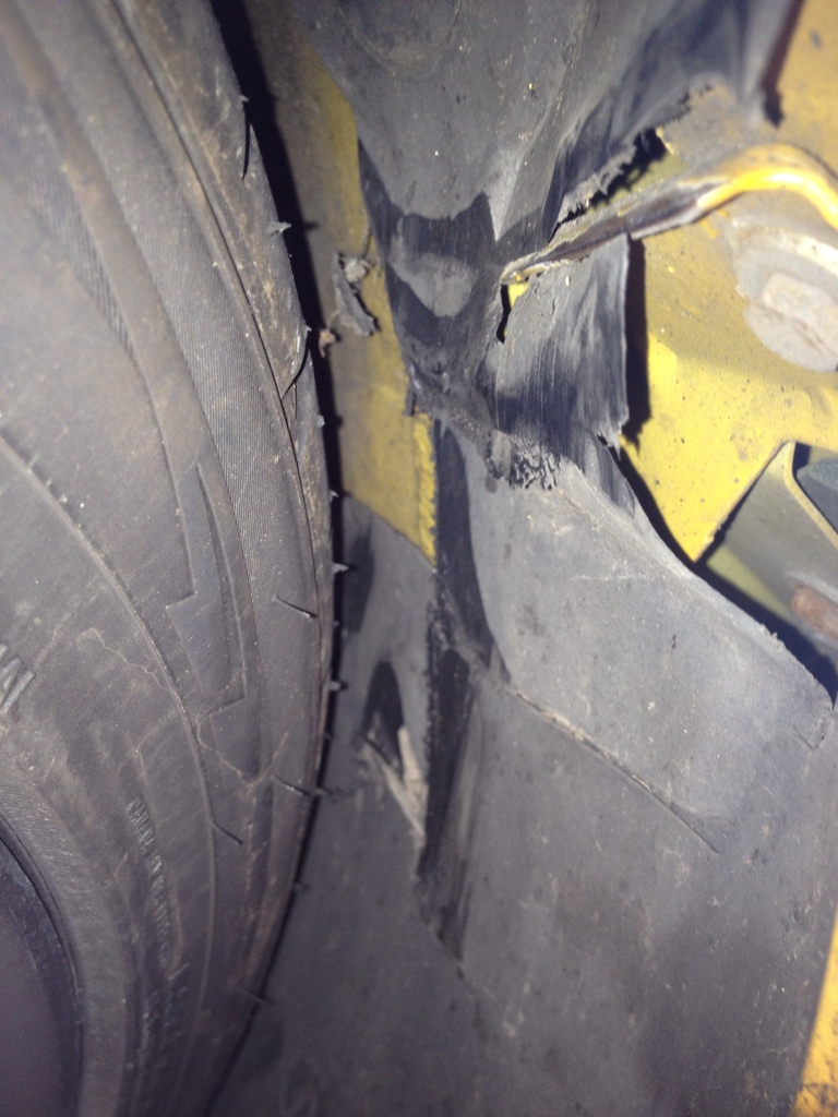

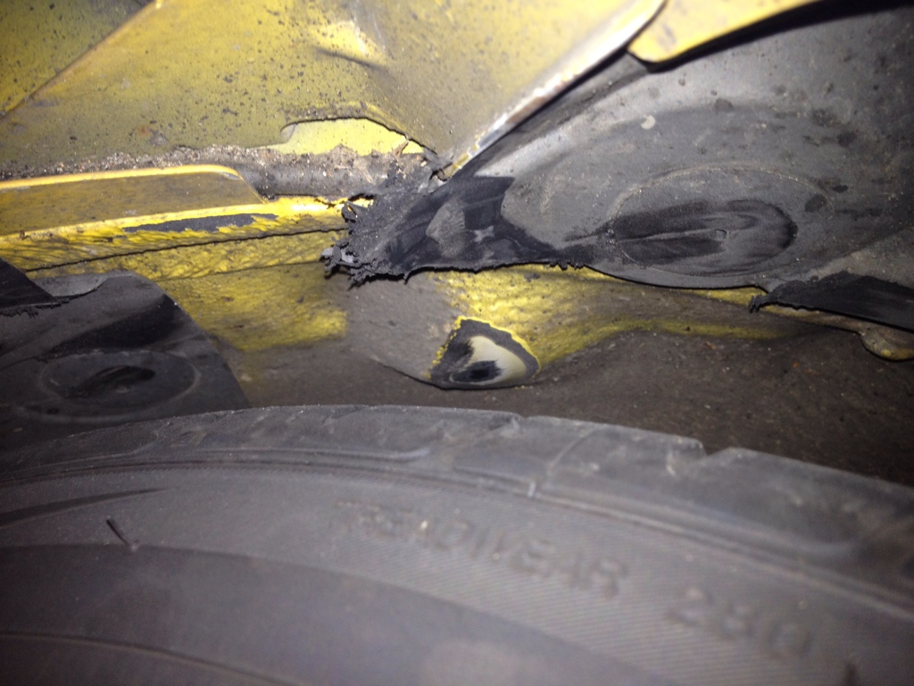

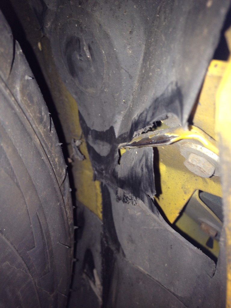

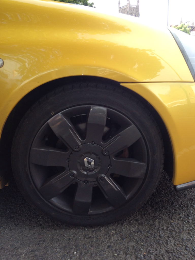

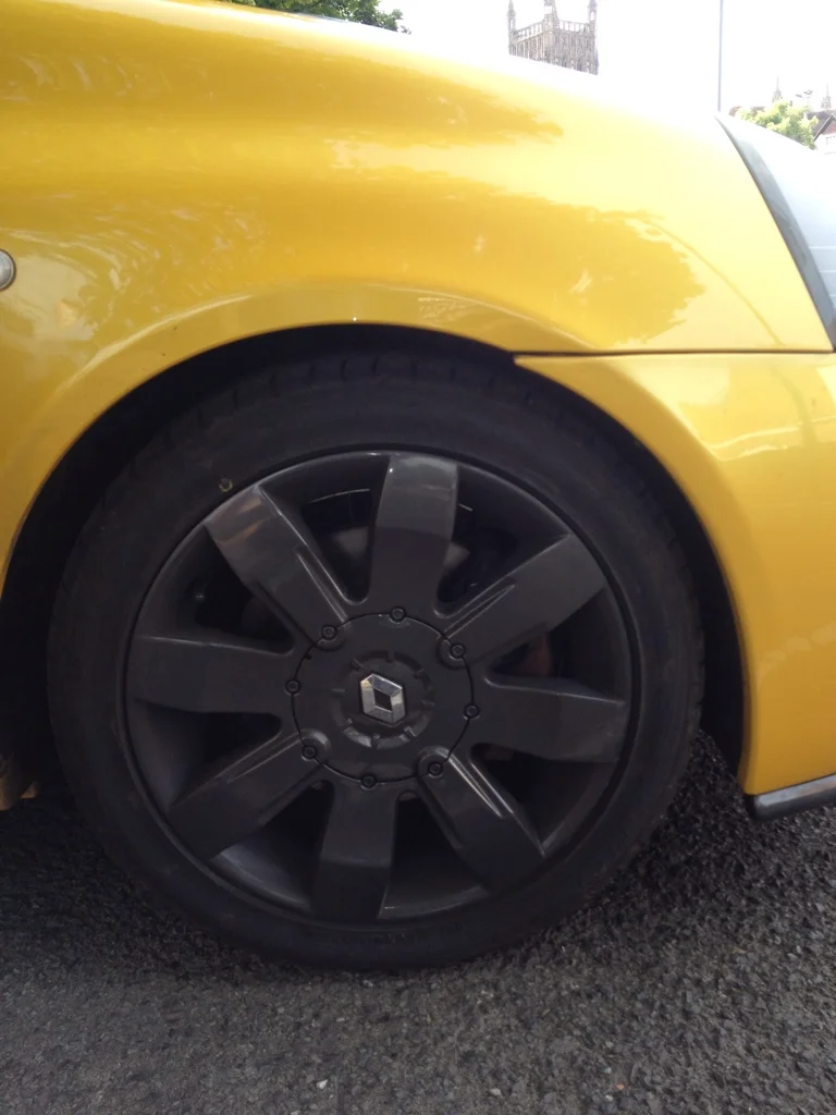

Here are some pictures
Its driving me insane haha
Scrubbing on the right wheel
how close the tyre is to the arch liner
How the wheel sits (very far forward)
Left hand side scrubbing in the same place
Cant even turn a corner without it doing it :-(

Looks well forward, and definitely not what sport lines on standard suspension should look like!

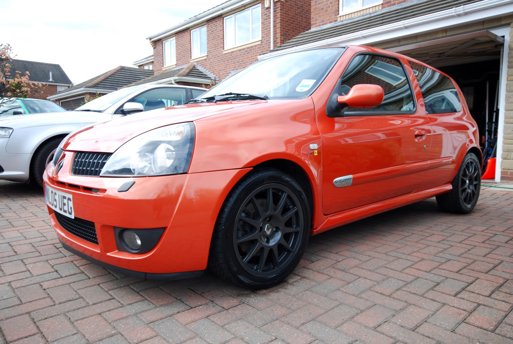

This is brookies with the same setup:

Wheel look abit more forward then it should in that picture and 205/45 is the right tyre size. Probably best taking it somewhere to get it looked at properly.

thats called castor, and it seems like you have far to much of it! similar to the way a bike rides. you'll probably notice uneven wear on the tyres too. Adjustable top mounts will solve the issue (ast make a good set but are close to £200), you may even find the coil over top mounts you currently have are adjustable in which case the garage hasn't realised or adjusted them wrong.

I've only seen the wheels sit that far forwards in the arches when the car/subframe/wishbone is bent. Thats nowhere near central (ish).
