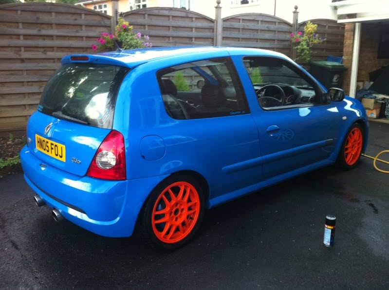

rite i have just fitted a set of OZF1'S to my 182 and they sit abit to far into the arch for my liking..
basically i want to spacer each wheel out 10mm.

this is now my car looks by the way :)

Really nice car btw :D
