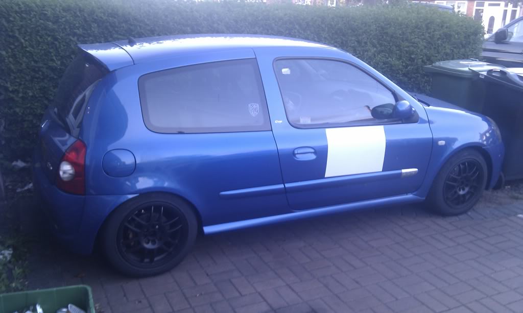

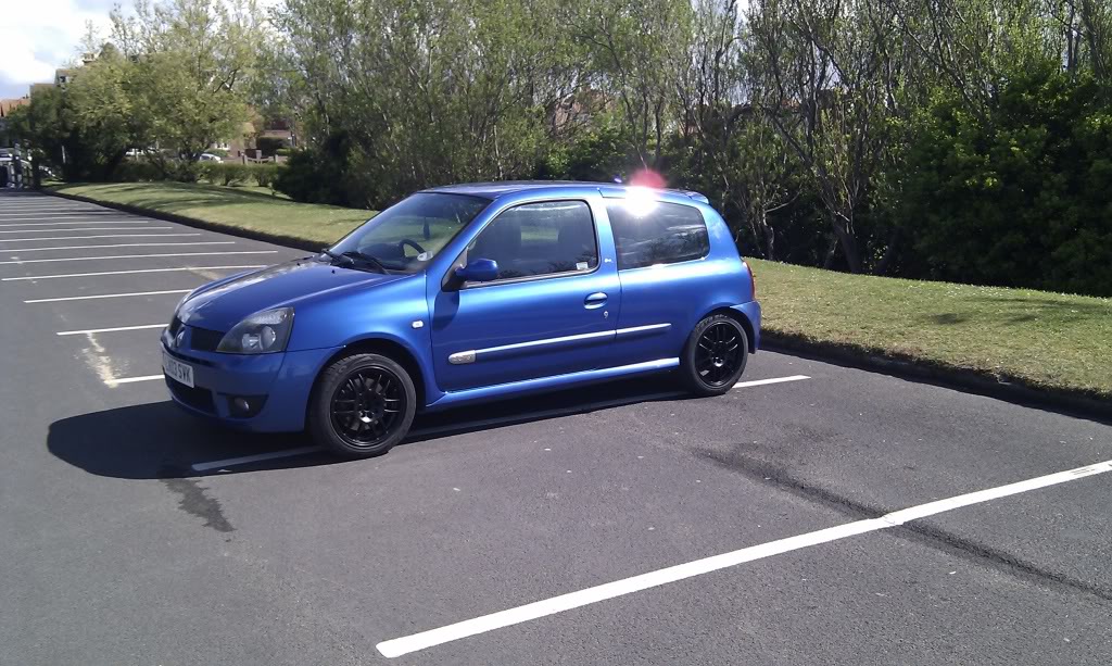

This is how it looks at the moment.

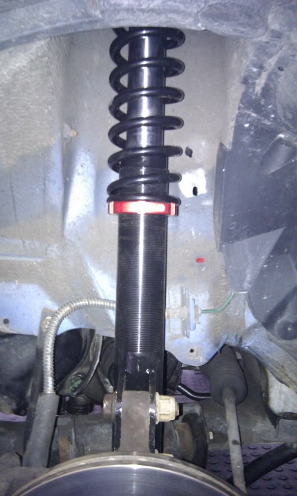

This was also fitted

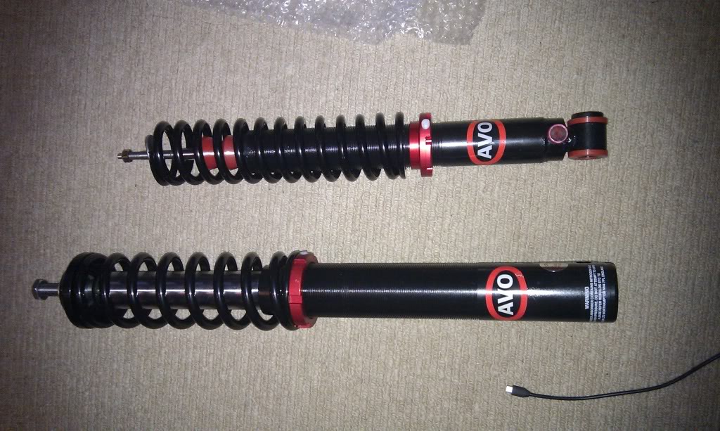

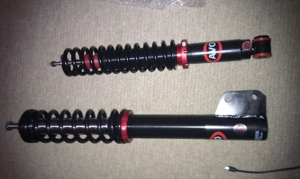

Also got a pair of these to go in soon.

It was clever photography mate, it is covered in dents and scratches which doesn't bother me as it is purely for hillclimbs and track use.

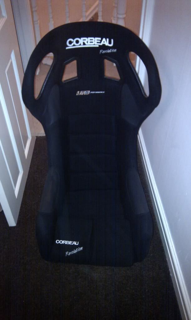

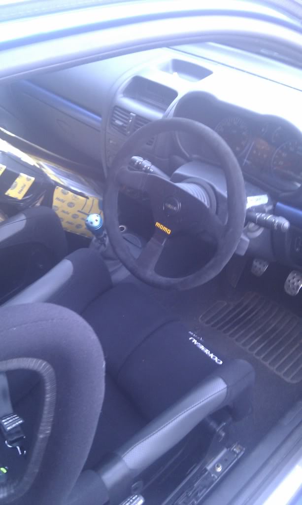

The seats are amazing, but I will be amazed if they both go in easily. One is XL to fit my fat ass in it lol.
I will probably have to mount the passenger seat behind the drivers seat.

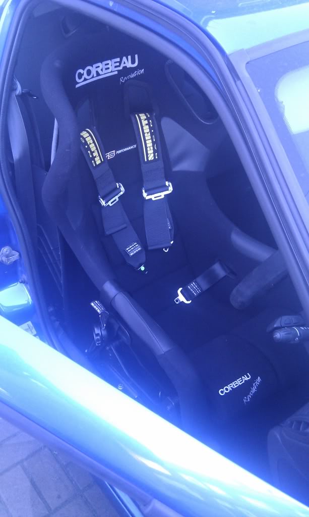

Looking forward to having the seats and my harnesses in. I was getting thrown around like a rag doll at the weekend.

You will like the seats. I have two of these in XL's fitted and a safety devices roll cage. They all fit in.
Used Recaro side mounts and Cobra extra low sub frames.
Let me know if you need any details.
