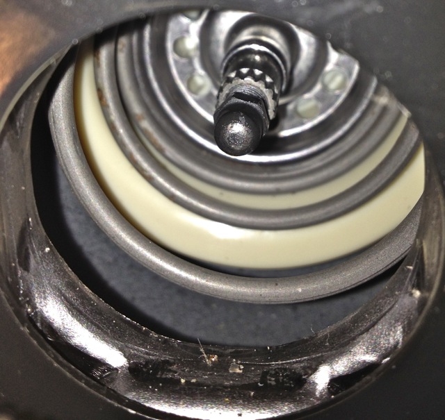

I think i have found the reason of the issue, i think the push rod is slightly pressed due to the different brake cilinder.
Does anybody know if the 172 servo's have adjustable push rod's like the once on the picture ?
That way i would be able to compensate the length.
Absolute worse case scenario would be a different brake servo i guess.
Well as nobody was able to give me any info it was investigation time.
I removed the mbc again and checked, the 172 indeed uses the same type of servo as in the picture.
Adjusted it and the pads are now free from the discs with the new bigger mbc. I haven't driven it yet but im very confident that this will work fine now :up:
