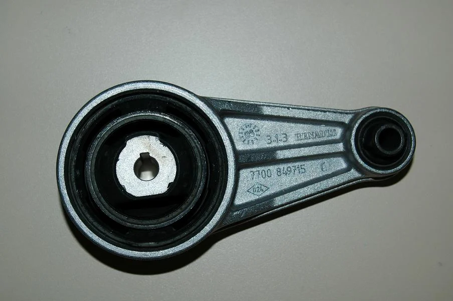

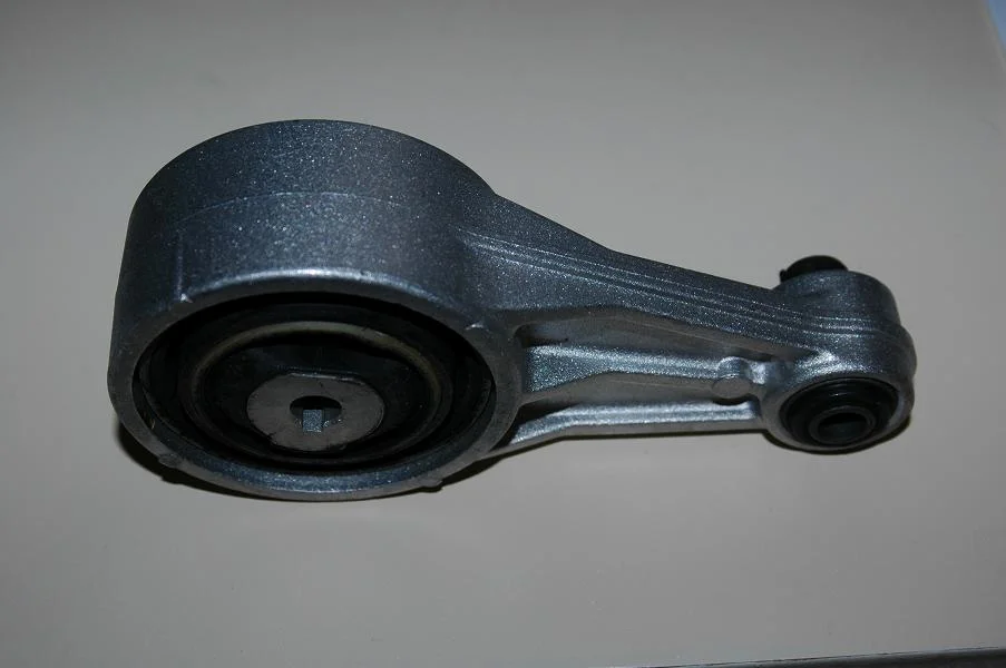

What the hell is this, part no: 6 000 073 662.
The bushes are facing the same direction, how the hell is that gonna fit!?
I have been told by renault that you can't order the twisted ones anymore!!
Which one is better to have, the original twisted one with uprated mounts or the straight one with standard mounts as shown below, renault say they upgraded to?
+ will this fit without extra brackets to accomodate for the directional issue of the bushes!!!

You'll need the other bit that dogbone attaches to which inturn attaches to the gearbox.
Its the one with two bolts.
BTW the bolt holding the dog done to the shell and the bolt holding the dogdone to the mount which holds it to the gear and the 2 bolts holding the mount to the gearbox are all done upto 62NM +-10%
Nice one edde your a superstar, renault are useless, they categorically said that I dont need anything else to attach it even after I told them what you had said, any ideas of a part number for this bracket so it will make things easier when I call on Monday?
I'm surprised the parts still not it stock it was not so long ago from what I remember. ALos they usualy keep a decient stock or make noted on the parts saying superceeded by part number x/y/z etc and you need the y/z parts to make it work.
Its the part in the picture no part number sorry. Try Matt on 01254386661 he'll have a second hand one in stock if there pricy.
