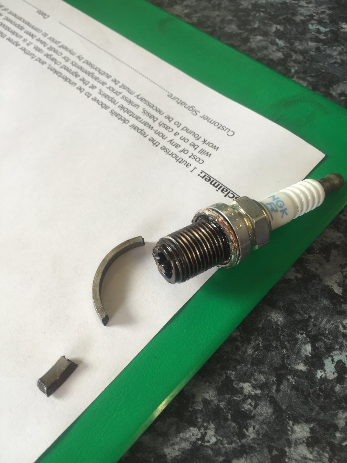

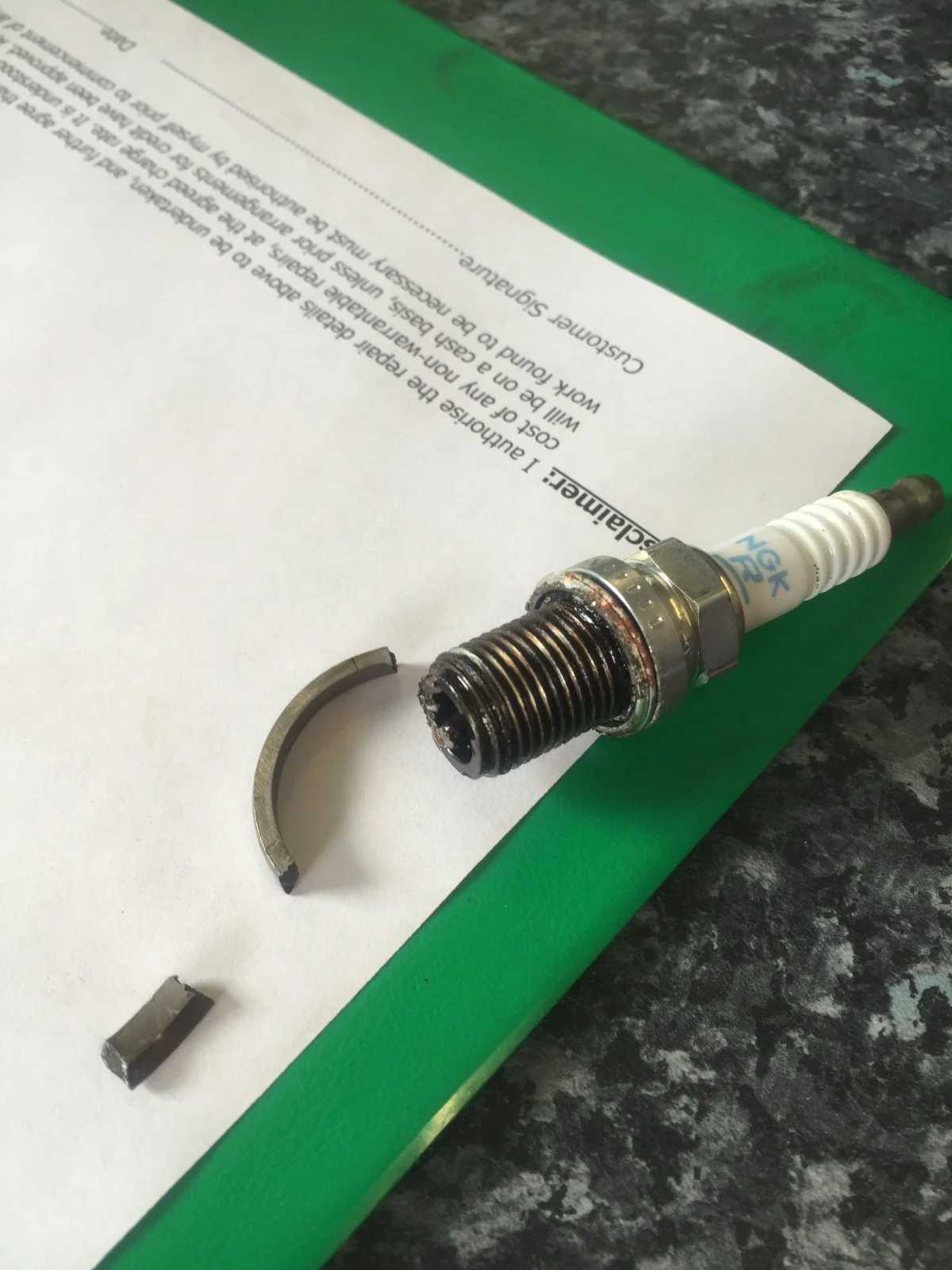

It's *******! They were about to do the compression check.... They found part of my spark plug flying about! Was rattling in the inlet manifold..
