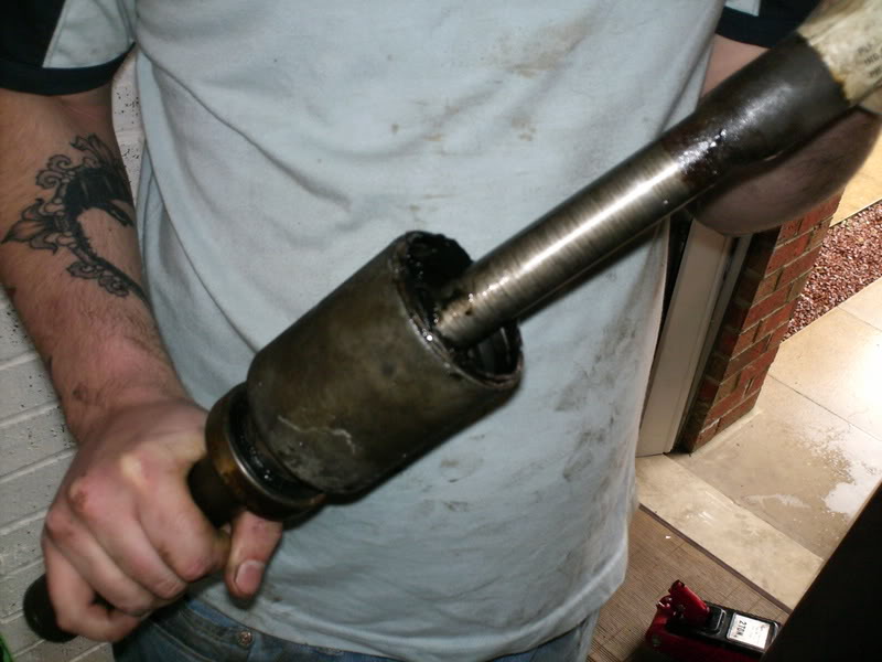

here's the suspect
as you can see the boot is like inside/outside lol i dont know how we can get into the back of the carrier housing either so we can take the bearings off and clean them up and if we'll get away with putting a boot over the carrier rather then being pressed in? like it is in the pic
well the bit you have in your right hand just pulls off of whats in your left hand, that will leave you with a tripod joint with 3 bearings on it yes? there should be a circlip on the end of that tripod,
take that off and the tripod comes off
edit - im pretty sure its that type of joint, i've never looked at a 1*2 one as said and its a bit hard to see from that pic
right managed to slide a new boot over the whole shaft lol laughing the whole time as we have no idea how we got it to stretch so much without splitting, hopefully this will do rather then a new shaft but it will be enough for a temporary fix :) repacked with new grease
