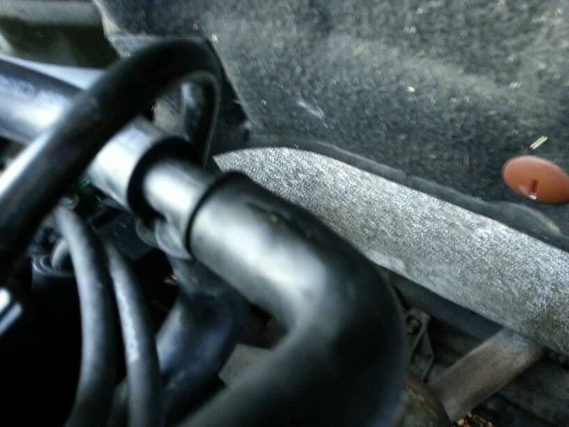

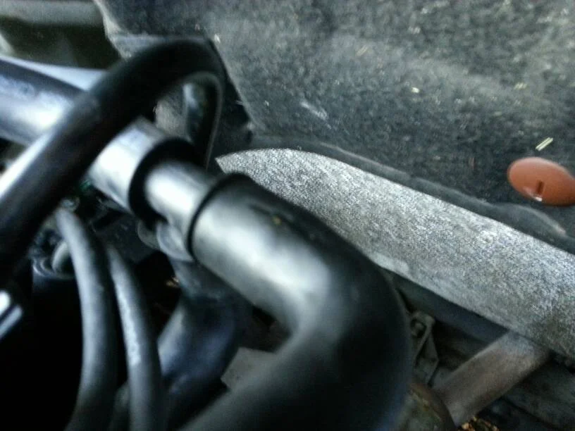

No black smoke, nothing! Running sweet too. Heres a picture of the 3 way connector. This connects as a hose onto a nipple on back of engine.
Attached :)
Attached :)
Oh god Luke I forgot yours is where they changed the engine!!
Follow those pipes and if one leads to a block near the oil filter you want to speak to Ryan just incase!!
Haha, yep ;) One pipe goes into the air box, the other end of that small pipe goes into like a splitter which goes 2 other way, one other pipe goes to top left of the engine onto a nozzle and then the other goes below it then on the end of a nozzle which is also on the engine.
What could it be? A bit of oil gets in my air box and also in those breather pipe system. Worried!
I take my earlier statement back, It is another possible thing to break, Ryan (Derv Destroyer) probably has best idea judging by his earlier post mate
Possibly a worn seal/hose somewhere in that system?

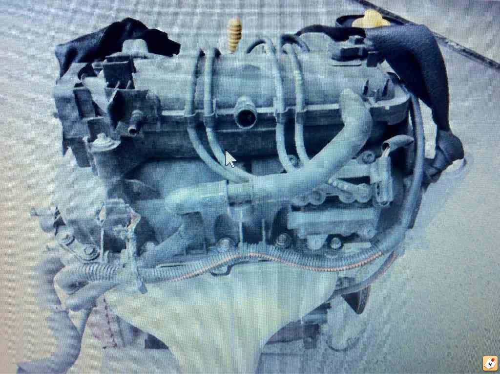

whats the engine code? i'll go look it up for you.
is it swamping the airbox with oil or just a coating of the box?
a coating is normal, a puddle over a few weeks isnt !
It's still a D4F raz, it's the one where they changed it after the mk2 ph2 (mine; D4F 712) but before the 1.2tce if that helps mate?
One sec I will find the code that follows after D4F :)
Edit: Luke's (Op) is D4F-722 mate
lol i know its a D4F , i need the three digits after as they're all slightly different
Edit: ta, will go look it up, im sure those hoses is one for the case breather and some vac
They haven't got the modin oil cooler, just checked, it's only 1.5dcis and 1.4s that have it.
I know where the hoses go tho.
Why it has a dual case breathers I dunno, odd design.
Those coil packs look a bits to change lol
Well f**k about! That is quite a change compared to the 712....
Bit fiddly for the coil pack as you say lol
What you thinking it is raz? I still reckon it is internal for it to not show any external signs of leaks....(unless Luke is missing them lol)
