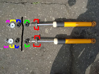

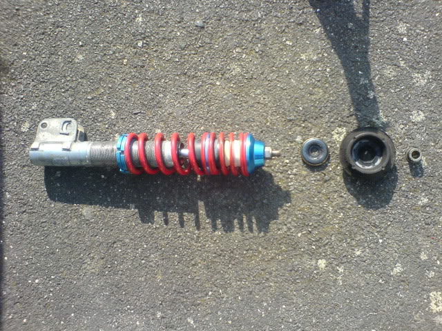

I took delivery of some v maxx coilovers today :) and there are 4 rubber bushes loose in the box... Where do these go? There isn't any instructions

ReaR: (Black line Indicates above/below Chassis)
Front: (Remove travelling nut above blue cup before putting on other bits in order of photo)
