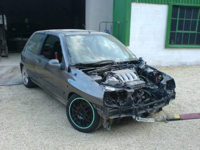

valver/172 hybrid thingy. Nearly there....
Daniel
Car  Whichever has fuel
Just towed it up to my mates to get wiring and plumbing done. Everything else is in. :D :D :D
Then its off for a repaint, new seats/harnesses, and got some new wheels for it too :D
(excuse pic, taken on my phone....)
What Valver parts did you keep in the end? And what went 172?
Engine, gearbox, brakes, hubs, arms, driveshafts, ECU (decoded), rad, alternator is all 172.
Williams subframe with Williams steering rack converted by a proper rack company & is now manual.
Going to order some new williams coilovers as the valver ones are pisch.
I think thats about it mate.
