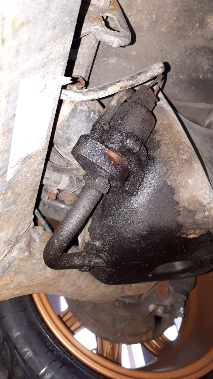

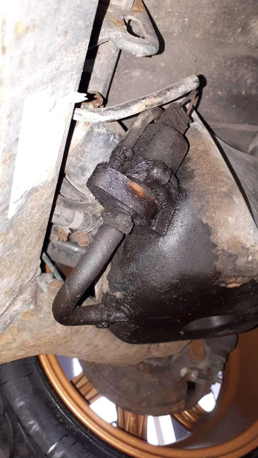

Oh and what's this any idea as it is leaking some petrol, looks like a sort of pump

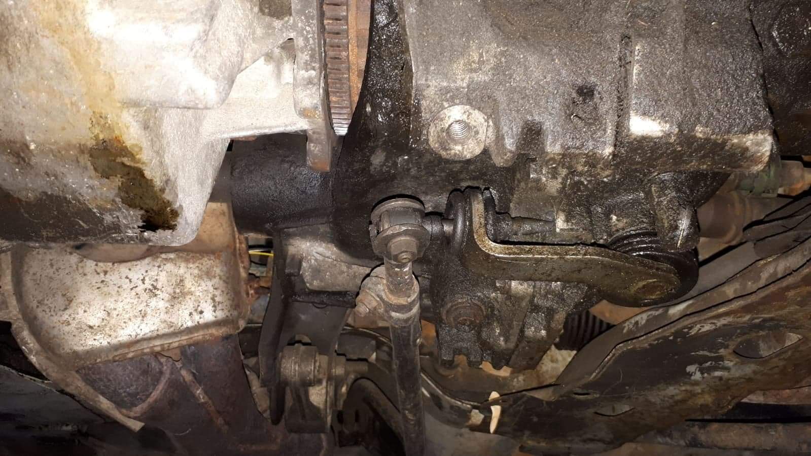

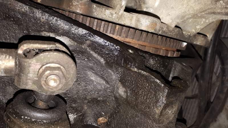

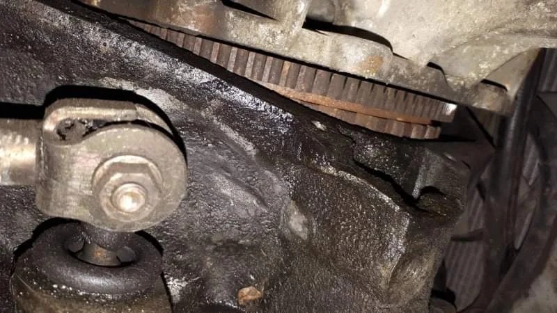

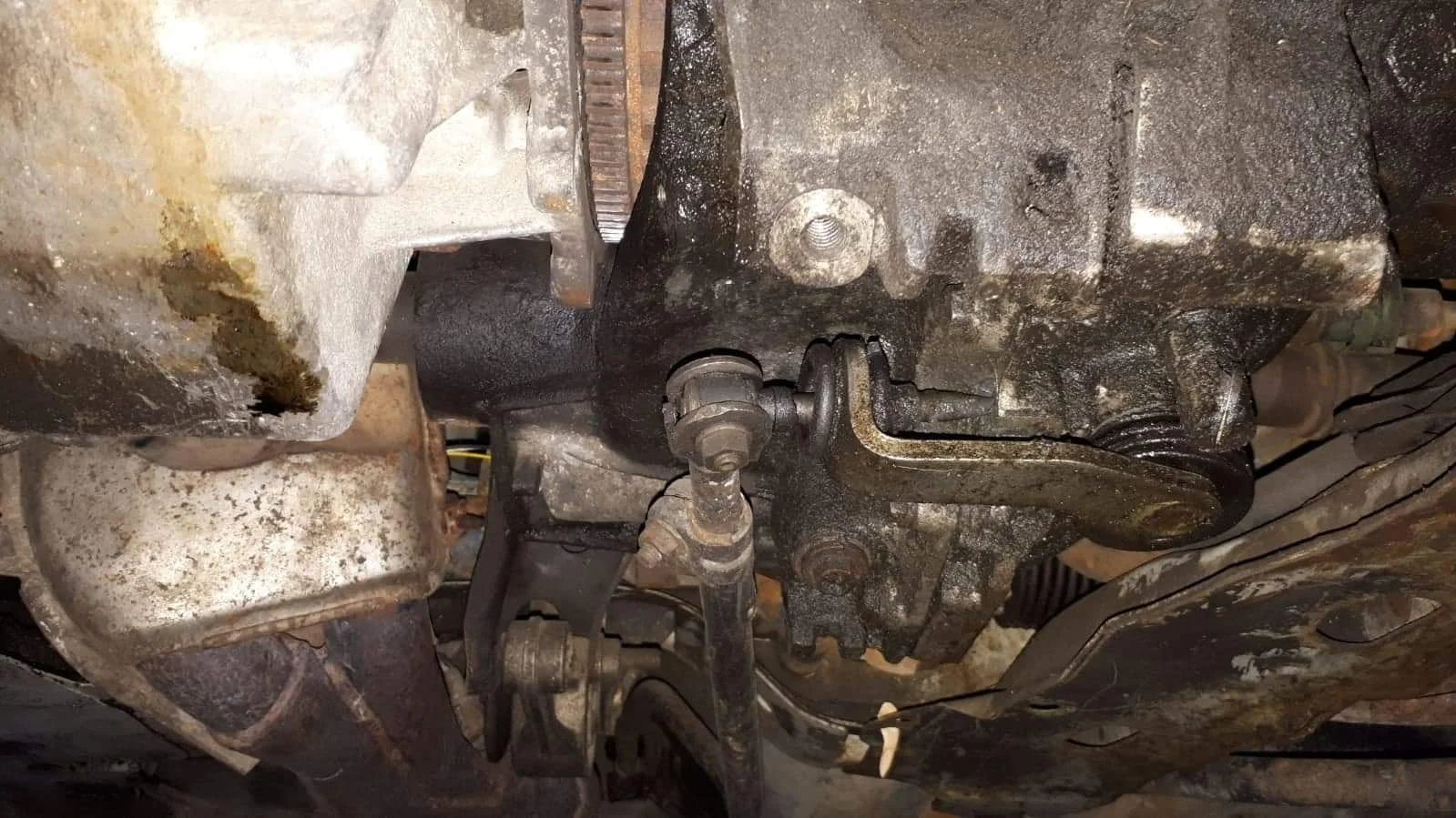

That looks weird, the flywheel is quite exposed there, is that ok?..
