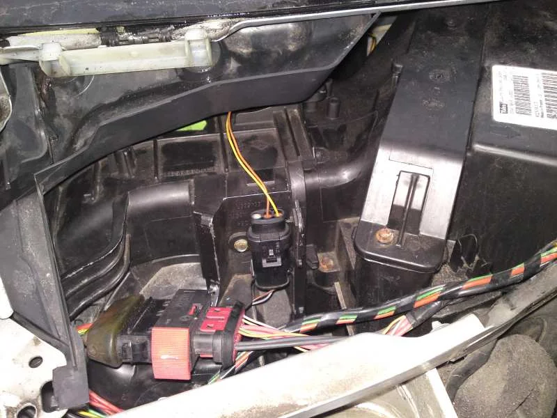

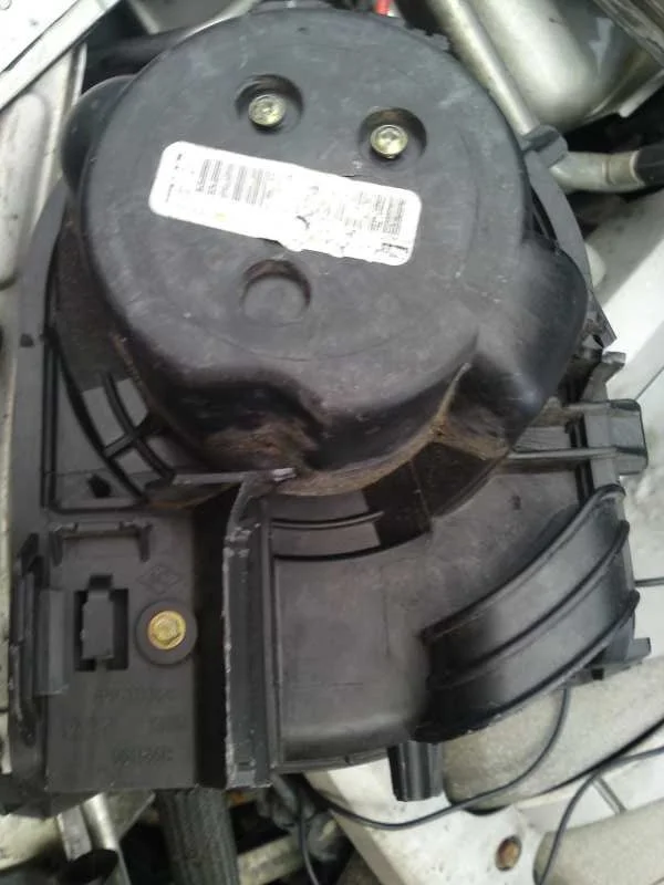

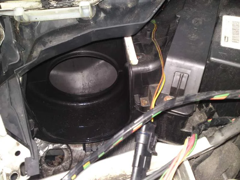

I took it out and when I started to move the fan itself it would kind of work. I spun it manually and it started to go so I must have helped it along. I then pulled it and when I kept my hands on it you could feel it start to turn or try to turn but as soon as I let go it stopped.
I checked the voltage coming through the connector cable and that was 12v so was fine. I then wiggled the cable and it would start and stop the motor turning. I eve greased the connections but to go avail. Anway I hit the read of the motor, the part with the sticker on and it started.
Seems ok for the time being, hit it a few more times also to make sure. It must have been stuck or must have had some dirt in between the stator and rotor. Anyway just added three photos to this.
I've heard a few people have said their fan started working once they hit it. It must just clog up with dirt.
