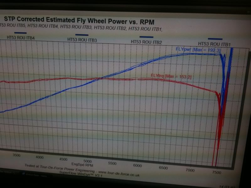

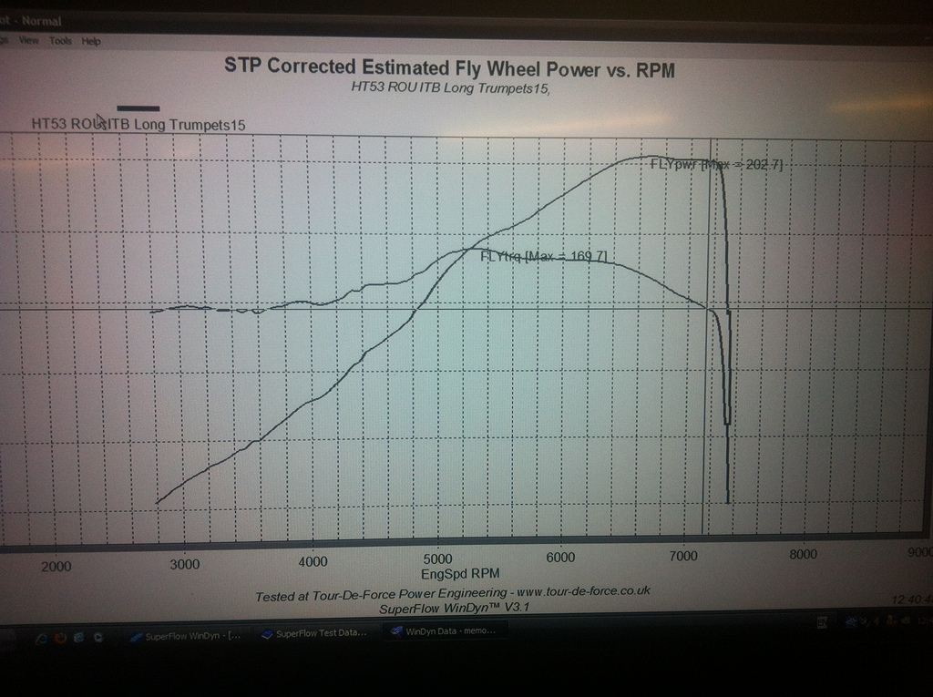

Do the longer trumpets! I went from 45mm to 90mm and gained around 15ftlbs of torque and 10bhp, I'll post the graphs when I get home, granted mine are jenveys, but the principles are the same F4r's like a long trumpet ;)
45mm trumpets
90mm trumpets

Not quite sure we would expect gains as big as that Lewis TBH in this case, peak bhp is unlikely to change as its so high up in the rev range where longer trumpets are less useful, but if we just gained 500rpm that it made the same torque as currently for it would be useful.
