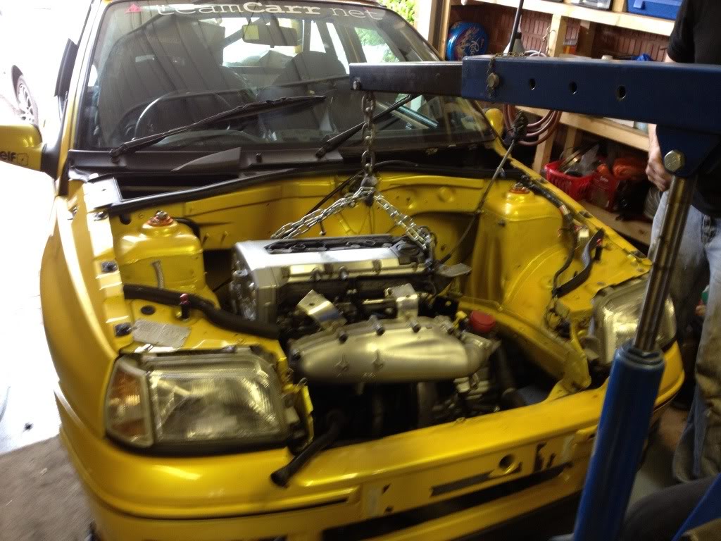

I need to attempt an engine and gearbox swap on a Mk1 with non-removable front crossmember thingy (technical term lol) and I fear it is going to be difficult...
I need to get hold of a guide! lol
  182/RS2/ Turbo/Mk1
First thing to do is make the cross member removable really TBH mate, will be a right pain otherwise.
Trivial once you have done that, just lob it in the hole like so:
Hmm... I'd rather not chop it up but if it comes to it...
If I don't chop it up, I'm guessing splitting the box off the engine while it's all still in there will be a good idea, rather than attempting to take it all out as one?
I've never done it before but should be doing it at a proper garage with a friend's dad over a weekend, but I bet I can't get it done in a day like I want to... lol
It just looks like hard work whether you take everything out the top or faff with doing the subframe route!! :(

you could always take the subframe right off and just lift the whole lot in from the bottom like doing a calibra etc.

short while ago i changed a box with the engine installed and dropping the subframe. imo it's easier to just take the whole lot out!
a few connectors, cables, water, brake calipers, shifter rod!!!!!(get's forgotten a lot) and you'll be able to lower the lot

Its a pain cause unlike a lot of cars the steering rack has to come down as its on the subframe.
