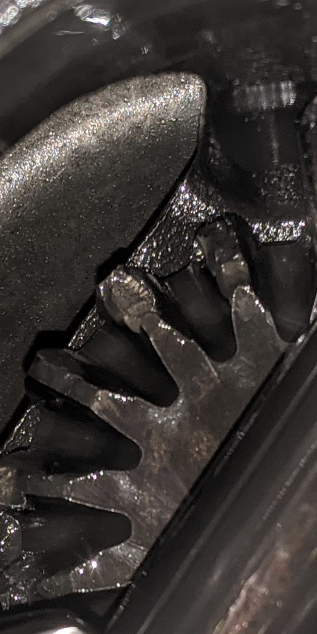

Following as mine does similar, mine is the circlip diff though, lost the circlip the other night, with a proper violent bang, so much it shut the engine off and wouldn't start for 5 minuets. Changed the circlip and restored drive, but try and pull away or with steering, starts knocking loud and violently juddering again. Not even tried to get it in to any other gears, but can pull away with just the clutch fine. Think it's going to be sending the gearbox somewhere to get it looked at.
  clio 197
Just an update on mine as it might help, took mine apart again new circlip is already damaged then was greeted by this once the cup part was removed.
Looks like the teeth have stripped off the other side. Might help you out.
