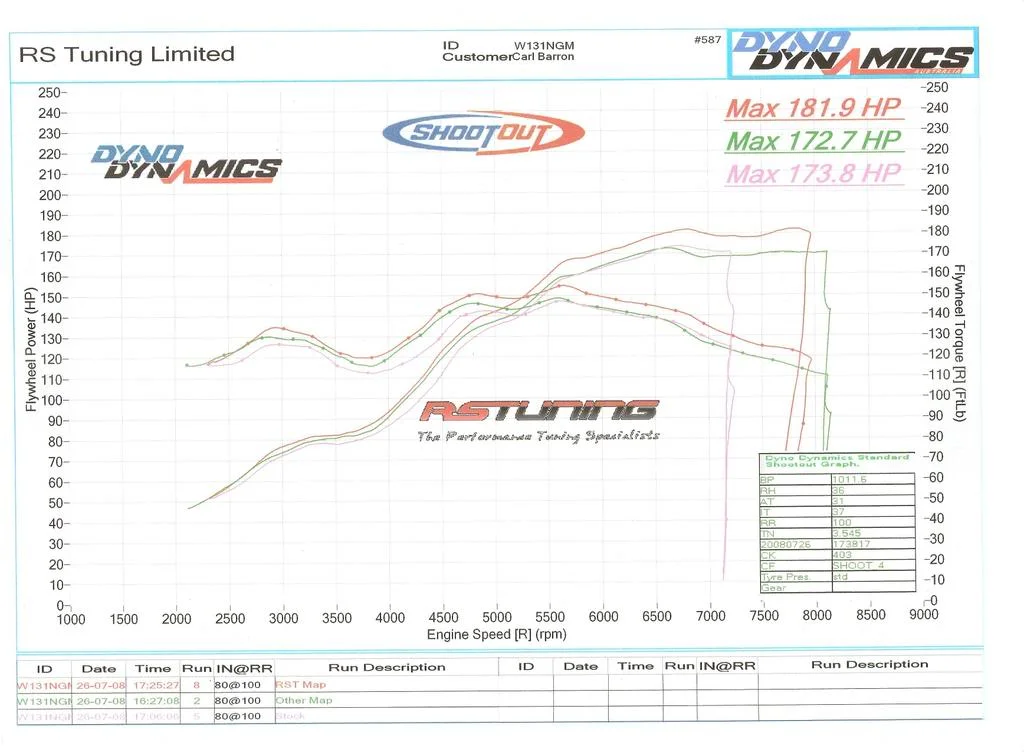

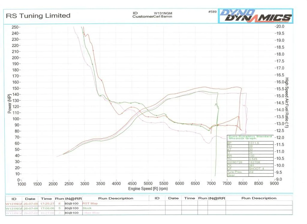

Visited RStuning (http://www.rstuning.co.uk) in leeds this afternoon to get the car remapped. Decided to go for a custom map due to car having cams and a few other mods. Even with the scorching heat of 27c the car still managed to make 181.9bhp after paul had worked his magic. (could have had higher bhp but the midrage was better with that map). Paul said standard 172's make around 160bhp on their rollers.
The car is so different to drive compared to before the map, it pulls very strongly and has less flat spots.

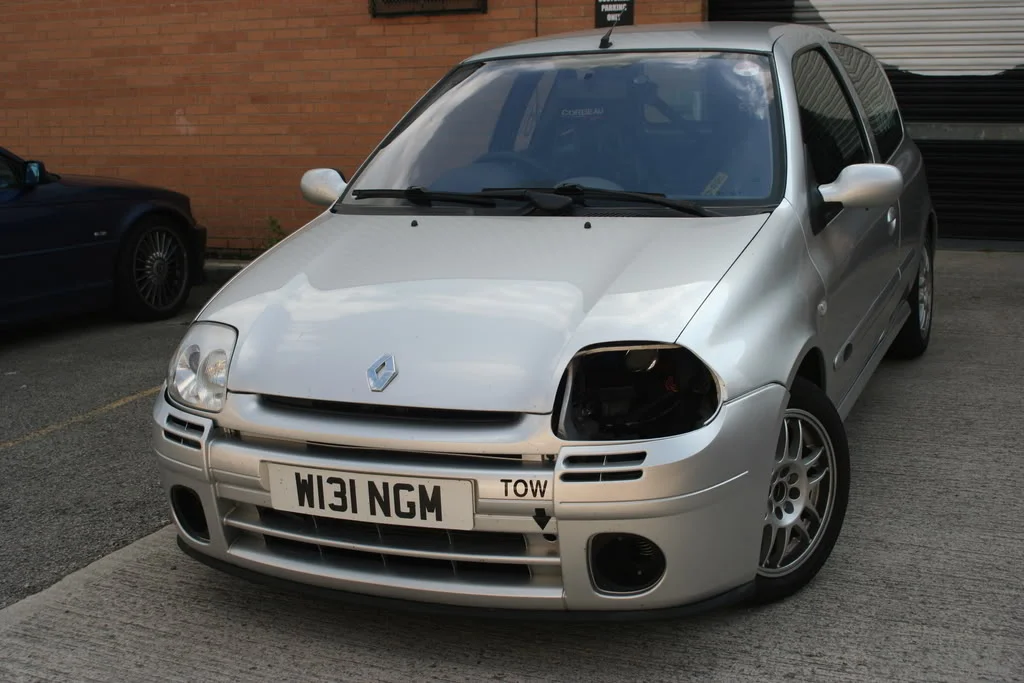

Car waiting to go into the RR room

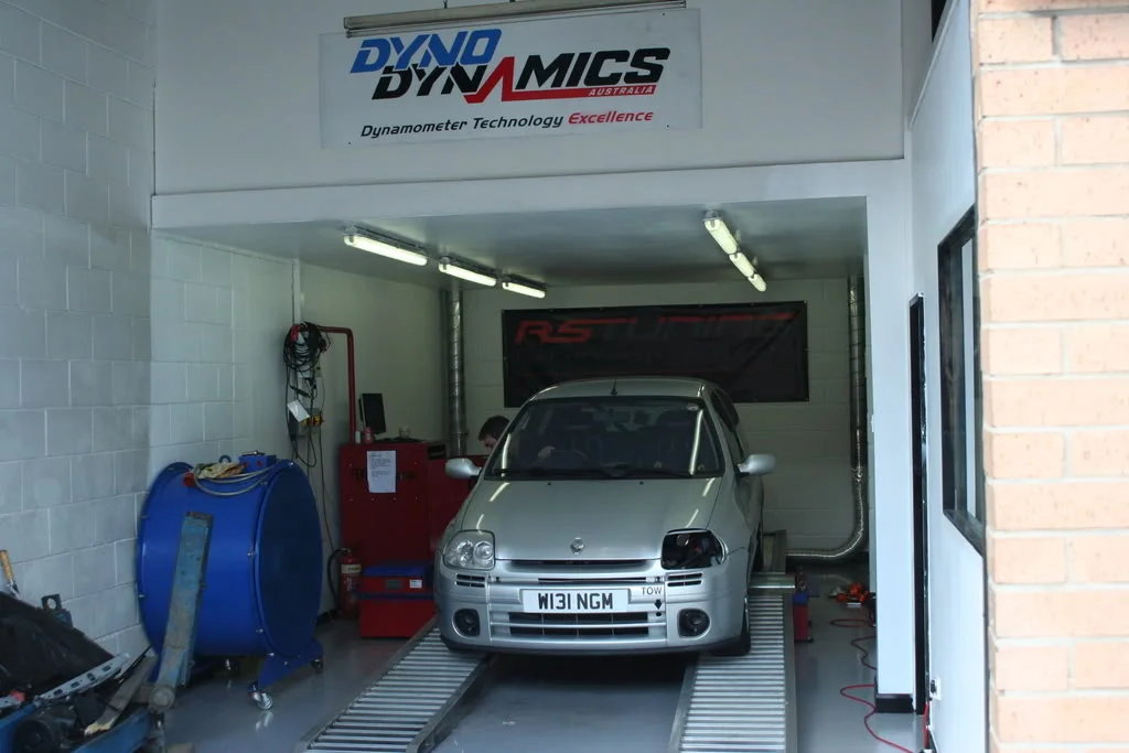

Paul reversing the car onto the rollers

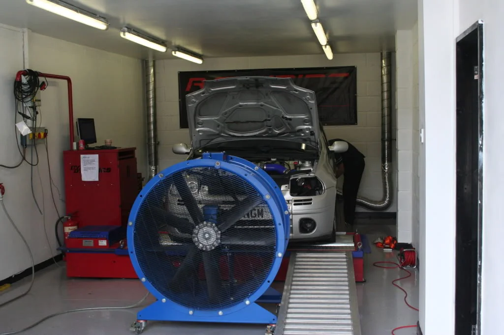

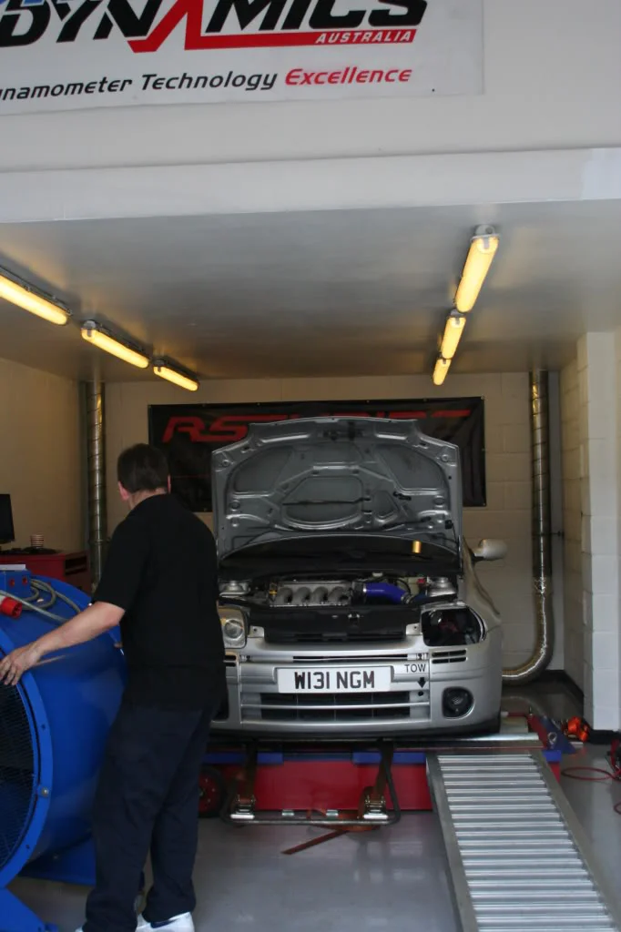

Fan getting moved into place

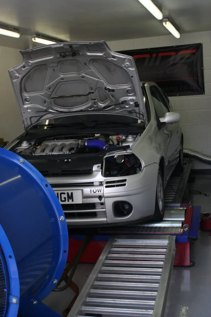

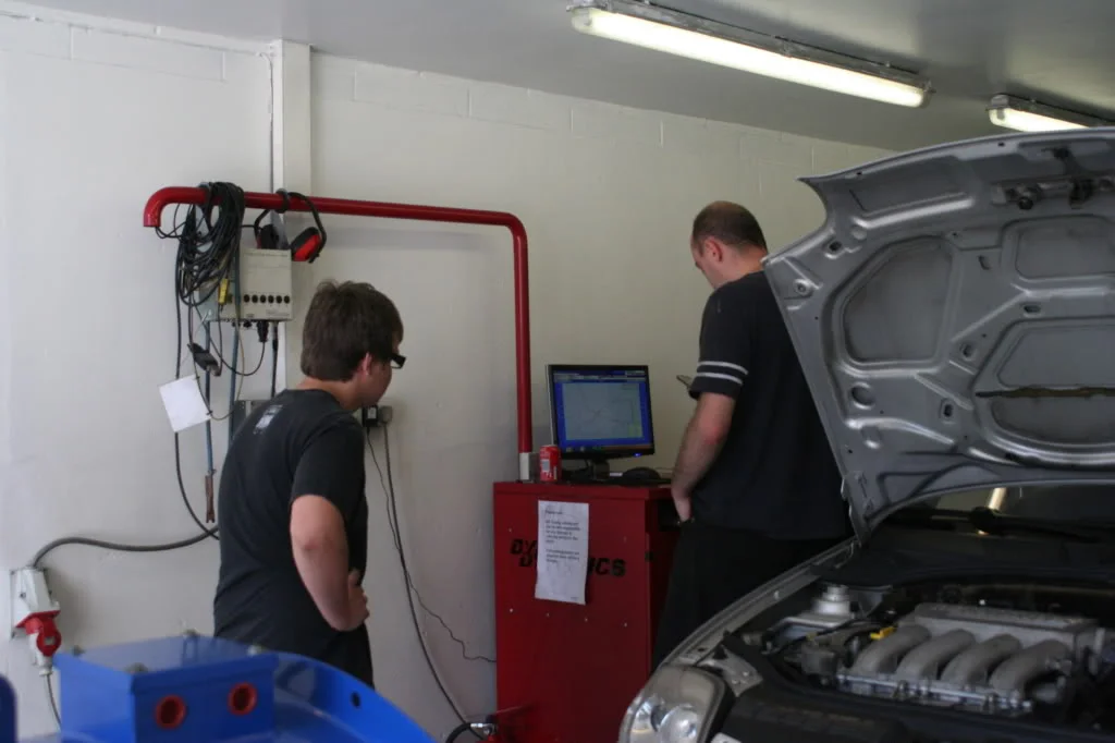

All set up, let the tuning begin...
Power Graphs (Pink = Old map, Green = Default Map, Red = Pauls map)

i dont know much about your car, but is it road legal to have only one light ?

he just took the light off for the rr session fella, to try and get more air to the relocated filter
nice result fella, wats the full spec, i spot the relocated battery and cup racer stylee intake set up
- Cat Cams 420
- Powerflow SS exhaust + decat
- Relocated battery with open induction behind headlight
- Custom Map
- and ofcourse full stripped with cage,buckets etc
ahh reet, still looks amazing with one light
yeah headlight gets removed for track days

Id be cringing in RS tunings small room with the wheels spinning that fast lol what if one flew off :O

On another roller that would be over 190... There's so hit or miss RR's! Dyno Dynamics read SO low...Same as the one up here. 18bhp diff between that and dastek and Falklands.
ali rs-tunings always under read though.
yeah going to get a RR from somewhere else for pub bragging rights ;D want 190bhp+

you now offically own a 182? lol
if 182's actually made 182bhp yes ;D but on those rollers i would suspect a 182 to make around 170bhp

seems to be a little low power figures but good effort though.
Stock internals and 8200 rpm redline, good luck with it.
If you look at the new map you'll see the redline is not 8200 anymore.
And as for low, nope, cat 420's are a very mild cam and that's VERY strong for them mods.
Maybe he should go use a s**t dyno for a more pleasing figure:rasp:
