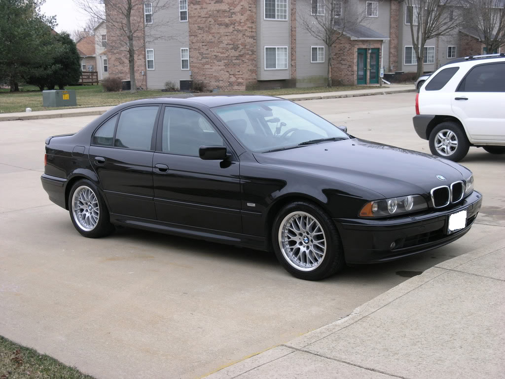

What were they off? Not bad offsets tbh.
Look like the Style 42's off the e39 5 series - also known as the RS744/745. They're 18x9 (et24) and 18x8 (et20), 5x120 bolt pattern.
These are 17's, but you get the idea.
