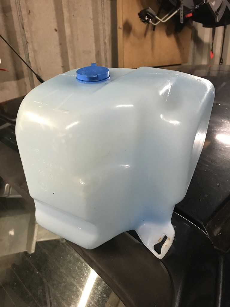

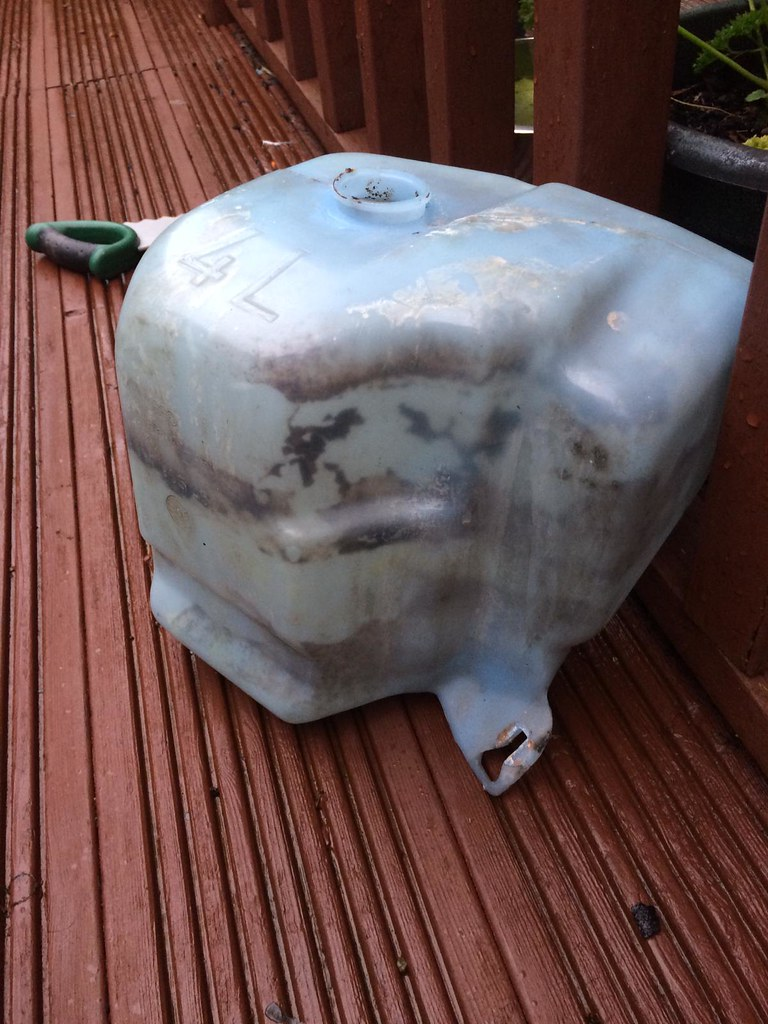

I came across a fantastic way to clean them the other day.
From this
To this
This is what the guy did.
"I basically just gave it a wash and rinse with your standard washing up liquid and then soaked it overnight in a bucket of hot water with bleach and washing up liquid inside. Rinsed it all out the next day and it came up like that"
