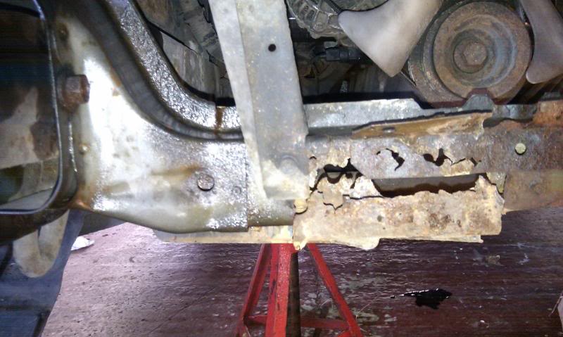

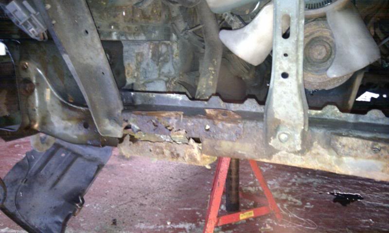

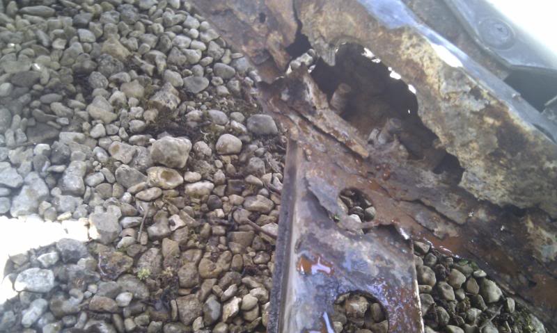

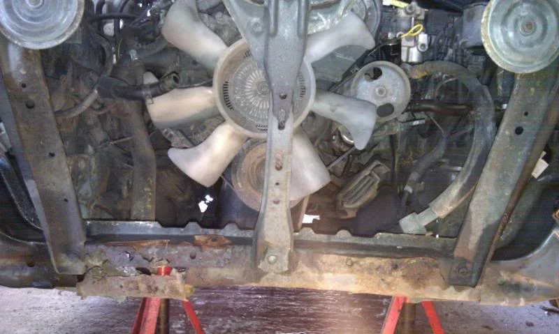

Off to the Ring for a few days at the end of the week, so set aside a couple of days to prep my mates 200sx. First things first, the radiator was well past it's best, so out it came.........oh f**k :eek:
That's the main cross member between the front chassis legs for anyone who's not familiar.

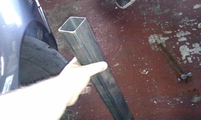

So after the initial thoughts of "what shall we buy to go to Germany in?" I decided it was fixable.

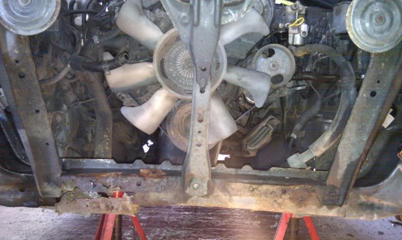

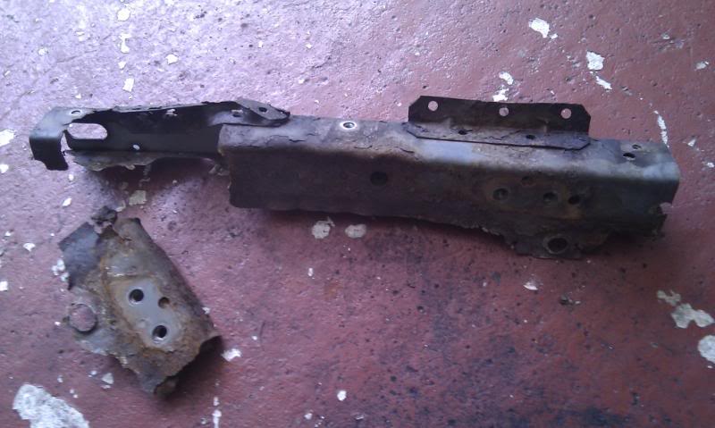

Chopped that out

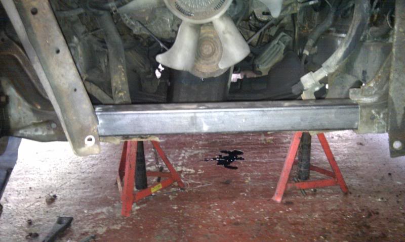

And got this ready to replace it

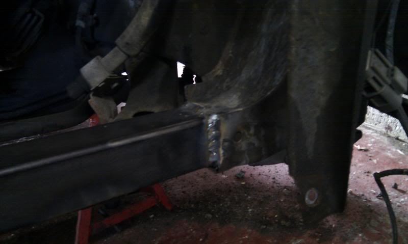

Snug fit, proving to be surprisingly easy :D

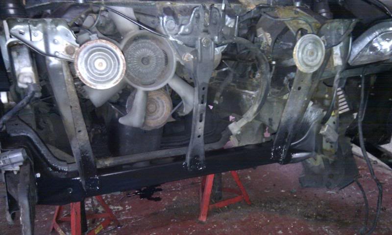

Well pleased with that from a borrowed welder and a non-reactive mask (not used one of those in about 8 years :dead: )
All finished. Should fix the aweful brake judder as the track control arm is attached there.

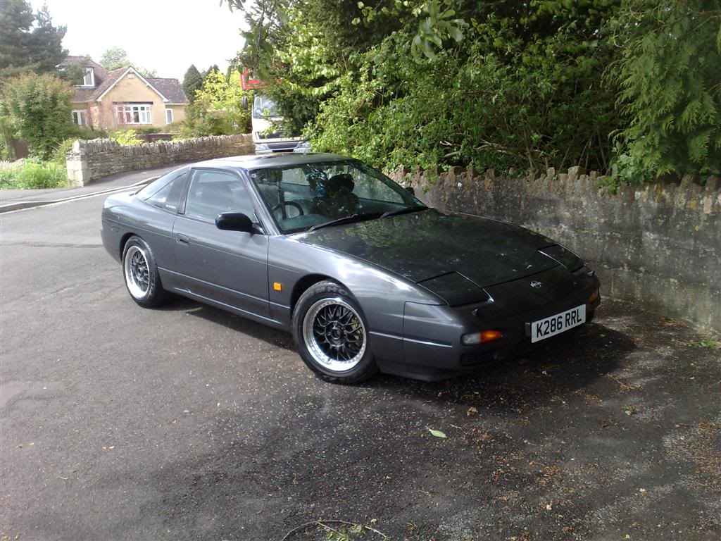

Is it a track focused 200? Or just a snotter you're taking to thrash about?

Any pics of the actual car?

lol 13's and rust... its moved from the bootlid to the crossmember!!
cills etc allright?
saying that i saw a mates 14a with rot holes around the front and rear subframe to chassis mounts!

Rest of it's pretty decent. Not perfect, prob need the rear of the sills doing next year but they're not hard.
