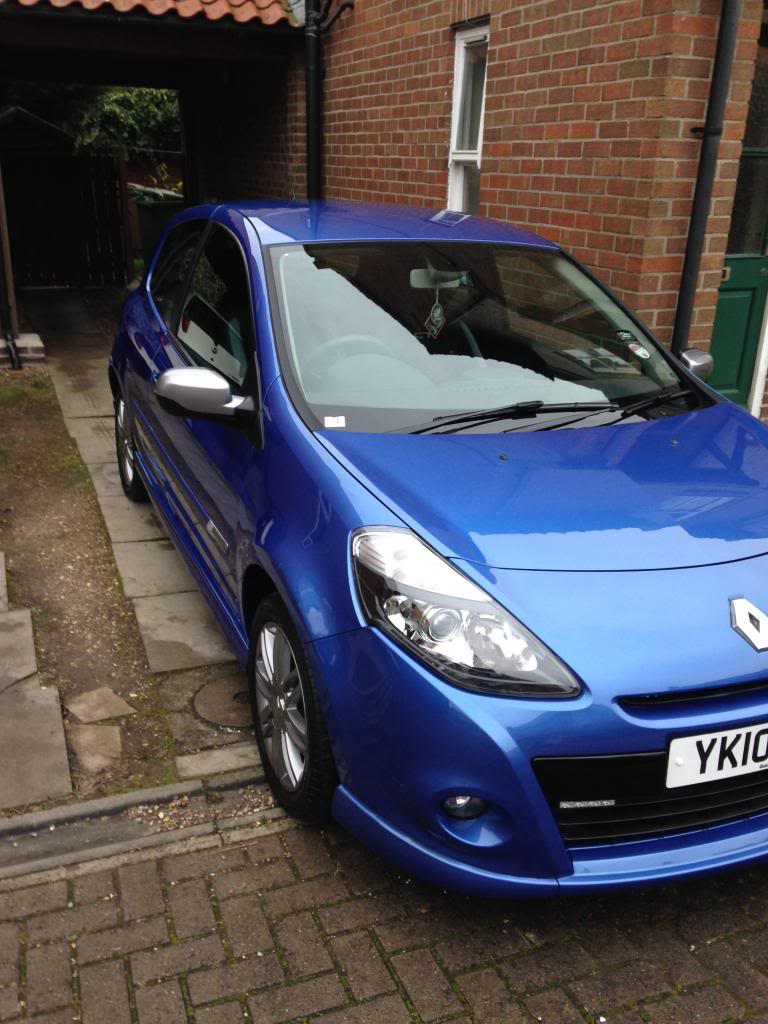

got in to detailing about a year ago courtesy of this forum. I'll call this a good clean not a detail as I'm still a bit of noob with it but thought i would share would i have done with a few pics (Excuse the quality me + iPhone 5 = crap pics) further tips and criticism welcome got to learn somehow.

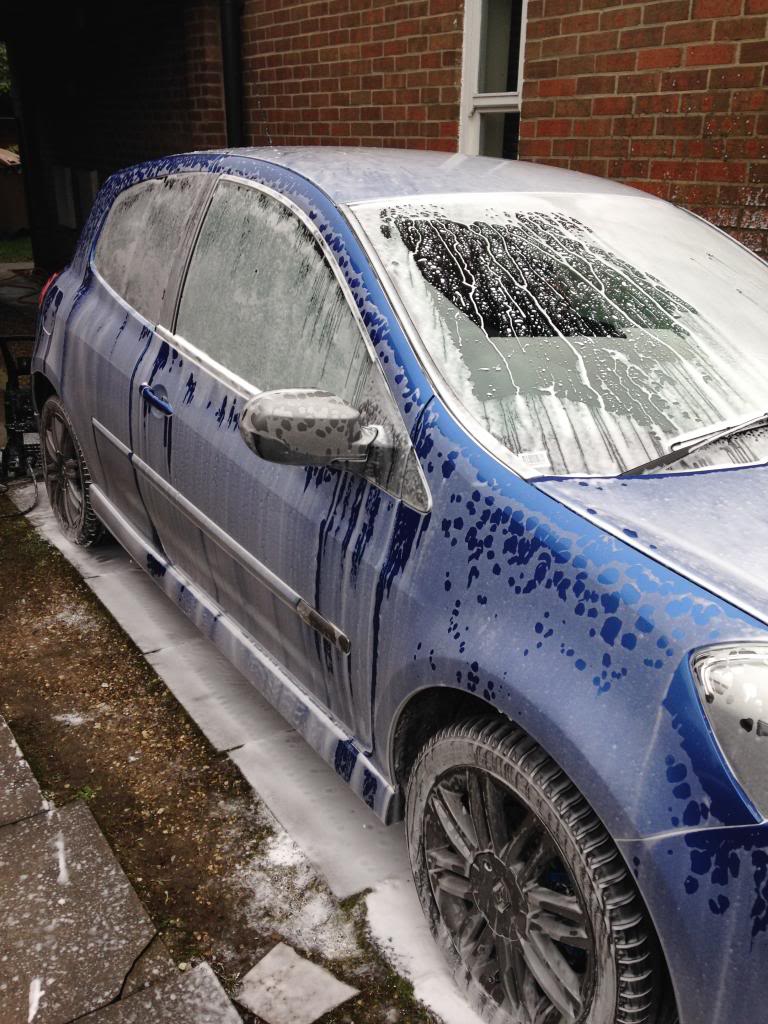

Snowfoamed with AF avalanche

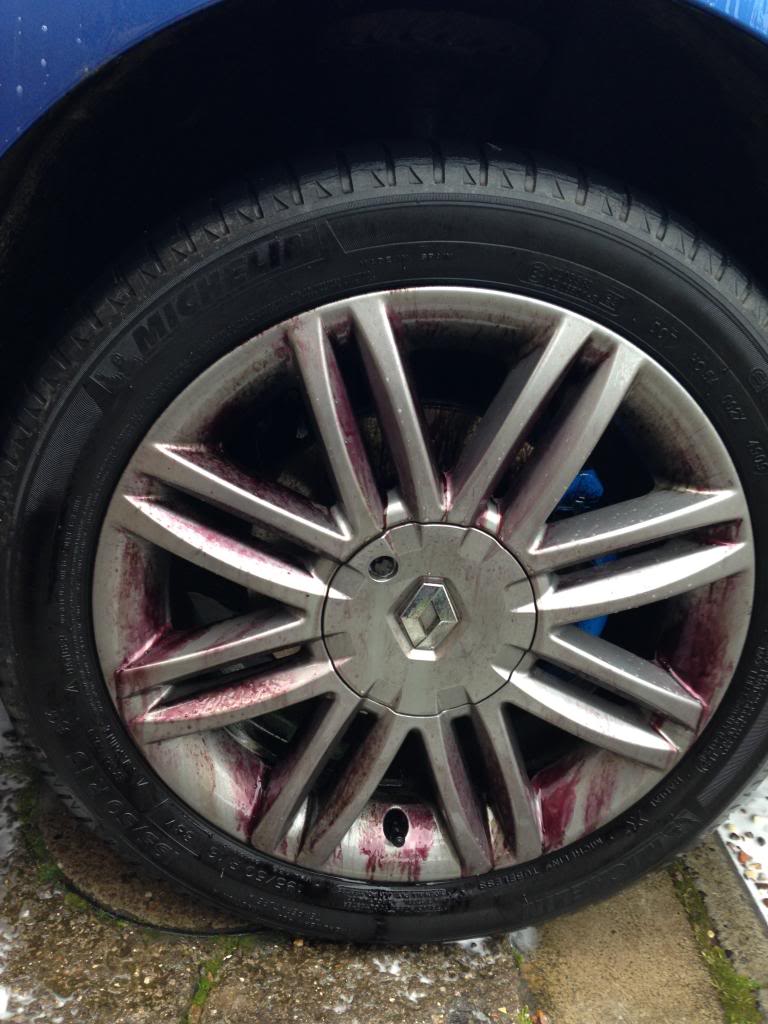

AF iron out all over
2 bucket wash with AF lather and AF citrus power AF imperial on the wheels

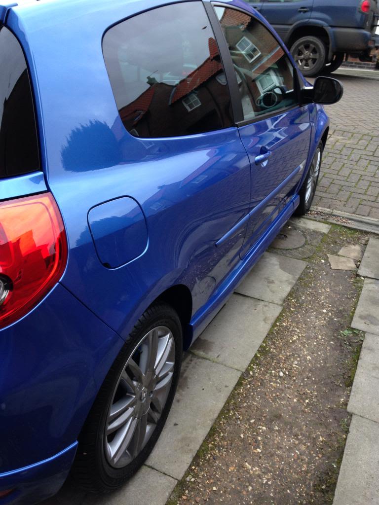

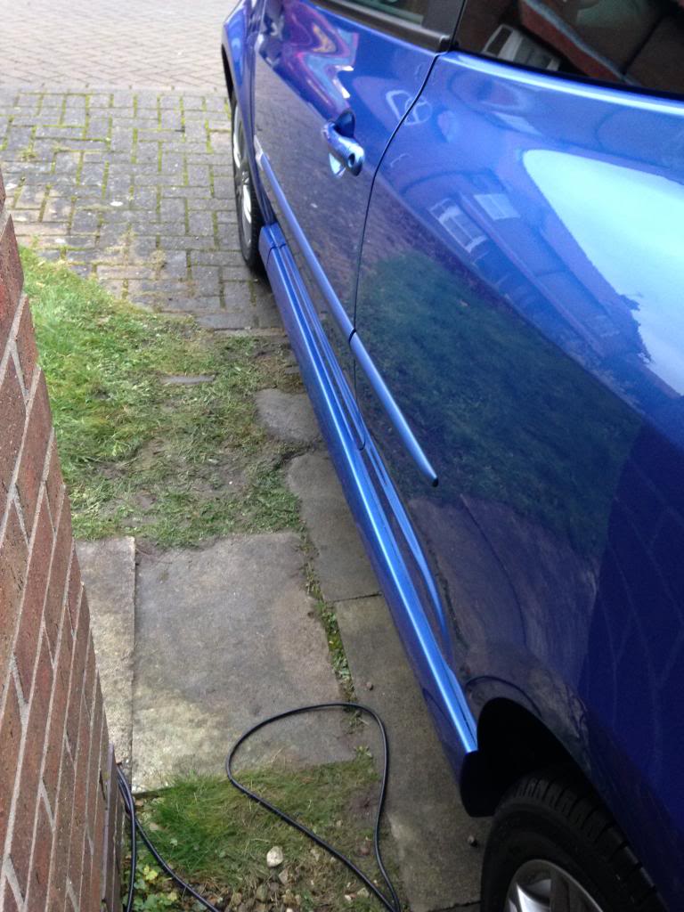

polished by hand with AF tripple not brave enough to do by a machine yet
waxed with AF passion loved this wax had soul before and found this slightly easier to work with.

wheels sealed with mint rims

I use all AF products i find they work really well and are easy to work with not being that experienced. Also the mercury didn't get rid of all the black on the exhaust ends any tips to get it off? just used a foam applicator and a MF.
Lovely! Wire wool 00 grade will give the mercury more bite.
Also, unless it's a mistype, your process is a little squewed fella! It should be snow foam, wash, then iron out. Not t'other way around!
Good effort.
As Jamie said wash before Iron Out and maybe get some ObliTARate as well to use before Claying just to reduce the amount of contaminants the Clay has to contend with.
