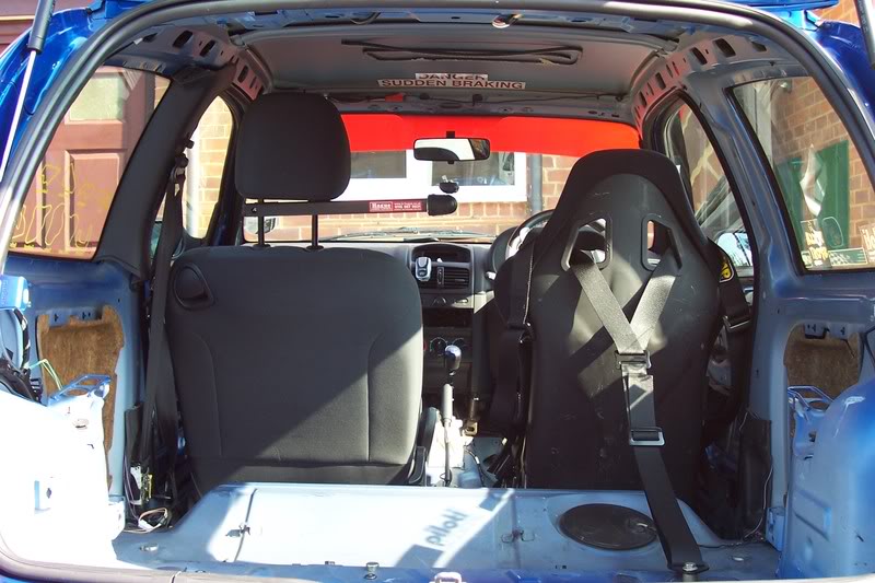

Mine looks like this and along with a few things you can't see (under-bonnet sound insulation, engine undertray lining, carbon canister, power-steering) I've taken 117kgs out leaving it currently at 904kgs with about another 15kgs to come when I finally swap out the passenger seat. If you've a healthy engine to start with that'll put you close to or just over 200bhp/ton which is plenty fast enough.
Save the engine-mod money and spend it on trackdays and tuition...much better value.
