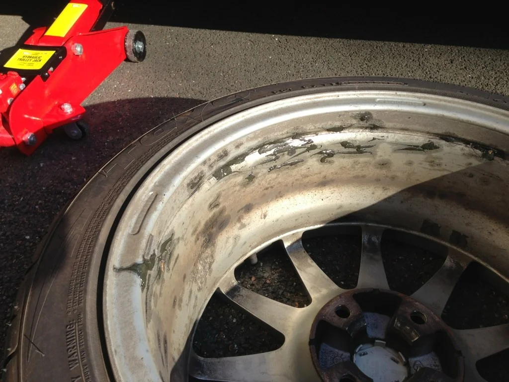

Hi took my N/S front wheel of today and noticed this grey/brown thick grease on the inside of my wheel...

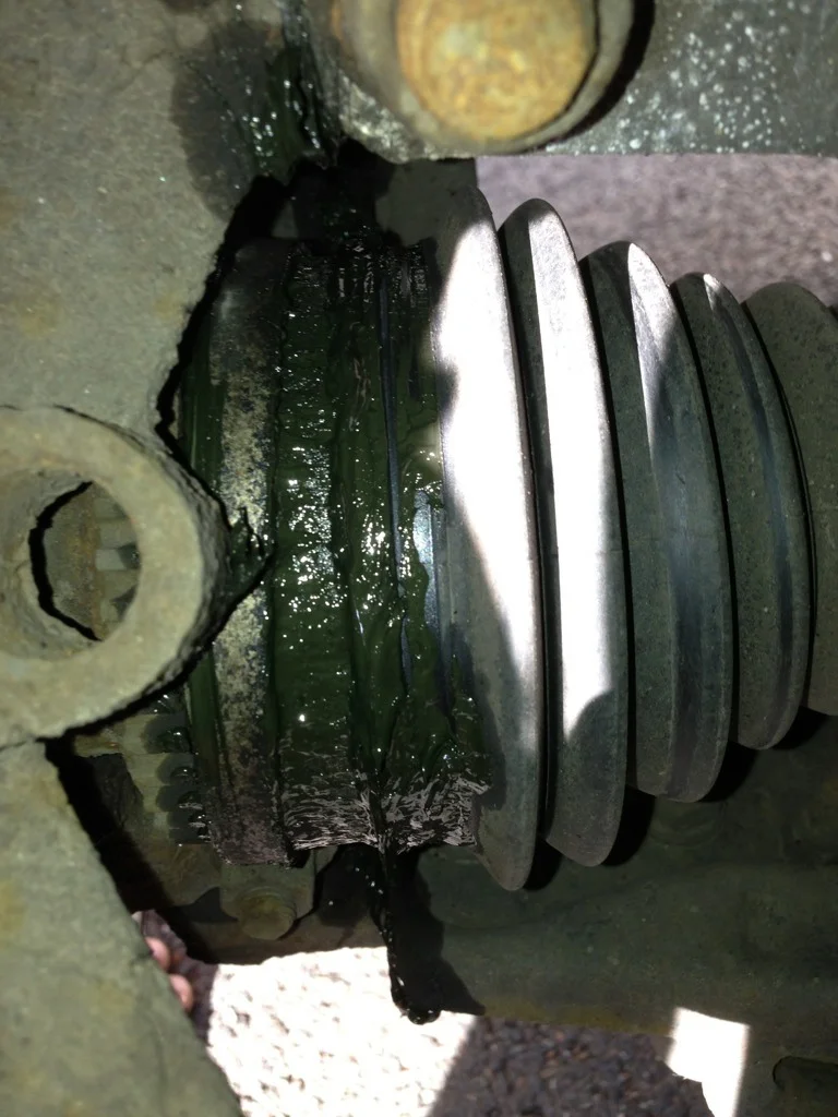

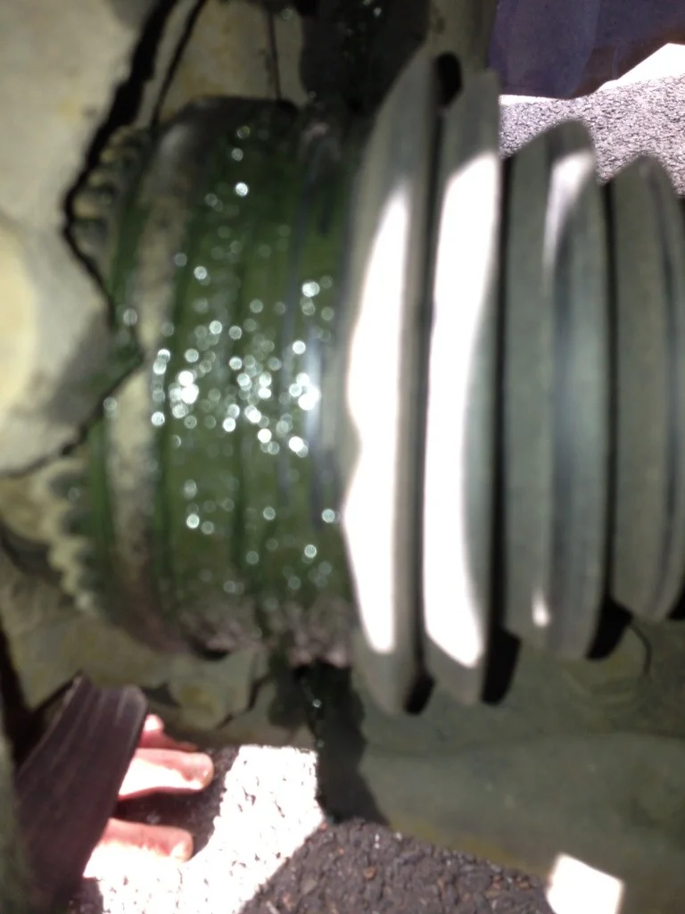

Then had a look behind the caliper, think its the cv joint(?) and had great all over it... I haven't had any work done on that side in over a year, except new tyres last month. Is it something to worry about?
Yup that's CV grease. The shitest stuff they put in cars, bloody awful to try and remove.
And yes you will want to replace your CV boot, as it could eventually knacker the joint if it's not lubricated well. Try to find out of the boot has split, or it's just slipped off, if it's the later it's easy to sort.

Looks as mentioned that the cv boot clip has simply split there. But as Dan mentioned check it, I all's ok, repack with cv grease and use a jubilee clip on it. Without taking end if cv shaft off and using standard boot clip that's the best option a jubilee

Jubilee clip is not a bodge, its better than the clip that was there.
Dr HMS Derv Destroyer
  MK1DTi/vivaro/corsa
the standard clips are awfull! and so are the newish type grip and lock clips. jub clip and be done. its only there to hold the boot on. nothing serious to flap about
