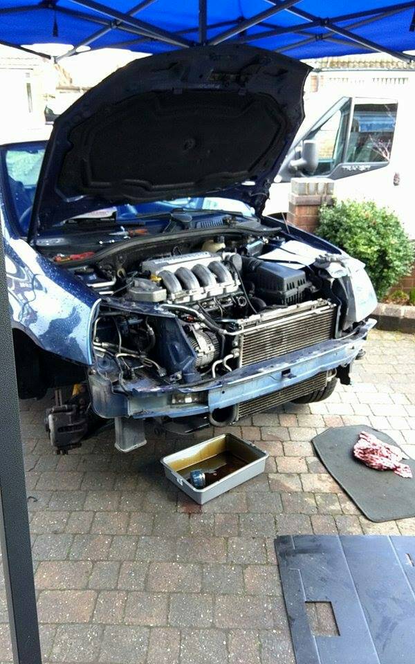

Following on from the above today I set about getting the list of jobs done.
Started by getting the gazebo out and cracking on striping down the front end, draining the PAS fluid and oil.
Then my battery died so I cracked on and got everything done:
Dephaser
Belts
Alternator
PAS Pump
Etc
Had a bit of a moment when jacking the engine up and down and caught the brake reservoir which popped the rear nipple out of the servo pissing brake fluid all over the floor. Bit of a panic at this point so rang @Jonff to see if he could remember if the servo just pushed in like most others, he couldn't remember so gave @Scrooge a quick call who also didn't know but assured me that every car he's worked on they just push in. So did that and it all seems to be holding fluid so I'll bleed the system (via CLiP) tomorrow.

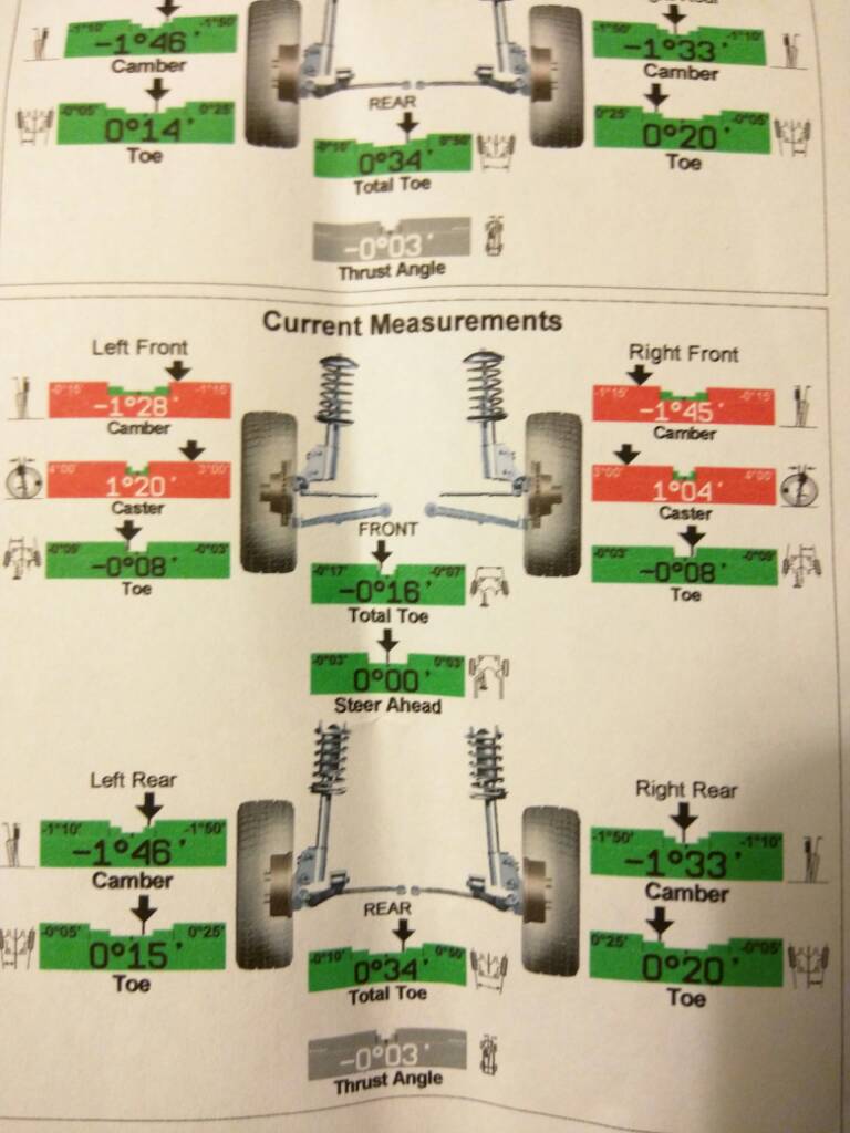

So today I had the day off work and decided to get my tracking sorted again. Had a few things changed since last time and done a good few thousand miles.
Ignore what you can see of the before measurements as they aren't correct as he didn't save them.

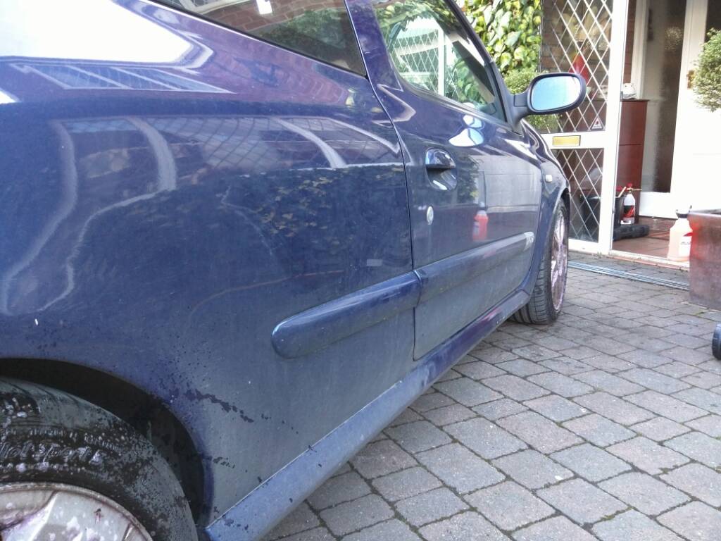

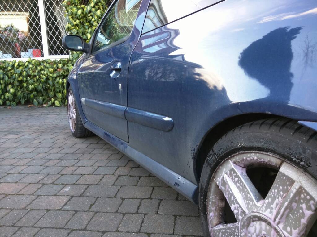

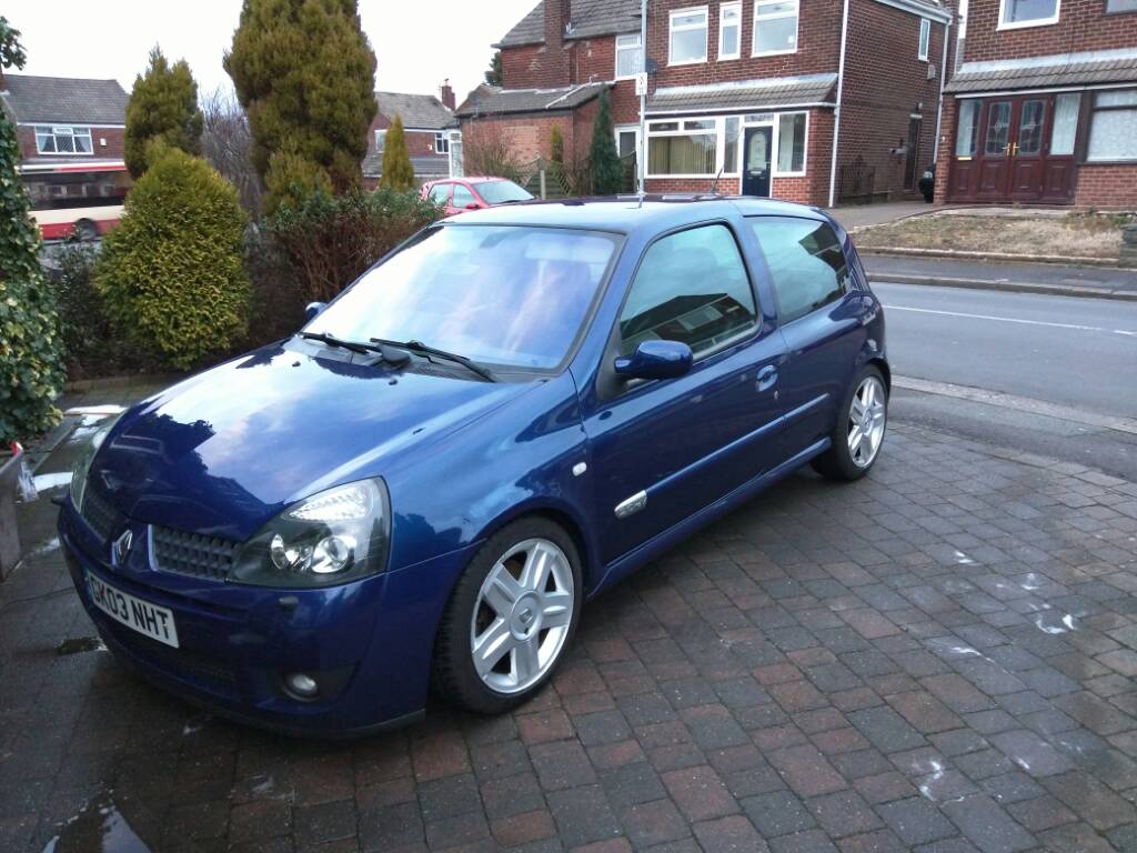

Just before I left, my snow foam lance arrived in the post so decided to give the car a well overdue clean as it hasn't been done since November.
Nearly forgot to get a before picture but remembered whilst the wonder wheels was working away.
As much as it doesn't look that bad the wheels were black and pictures seem to hide the worst of the dirt.

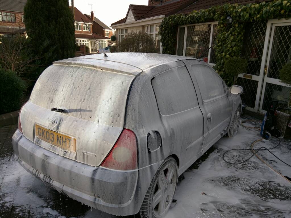

So I'll come back to the wheels later as they are ruined and need a refurb but got the snow foam out to give it a go.
Had a play with a few settings but it was too watery most of the time and the level of foam you see there used a LOT! of the bottle (Auto Finesse - Avalanche)
So let that dwell, went round the details with RDS and a brush then rinsed off. It had moved a lot more of the crap than I expected.
Then washed it and rinsed it again.
Forgot what Monaco actually looked like.

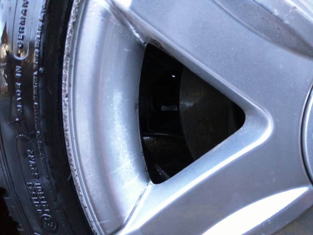

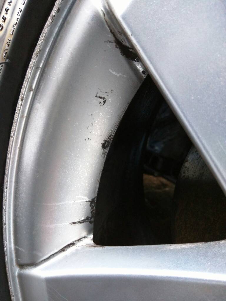

So the wheels. After 3 hits of wonder wheels and one of iron x they were still bad (now the paint is flaking and there has been a poor refurb but there were massive brake dust streaks, even more so from the sticking caliper.)
So out came the clay cloth which left them looking a little more presentable.
As you can see there was a little left and the paint from before the refurb is starting to come through.

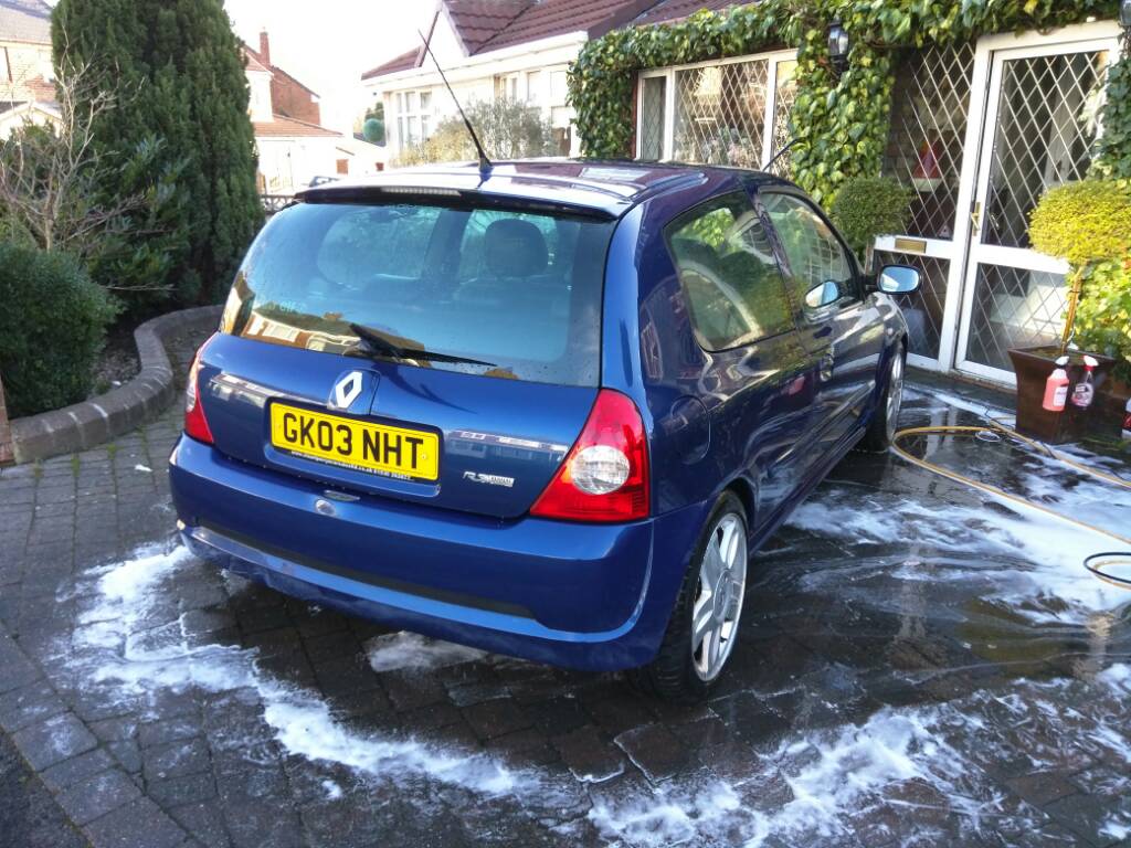

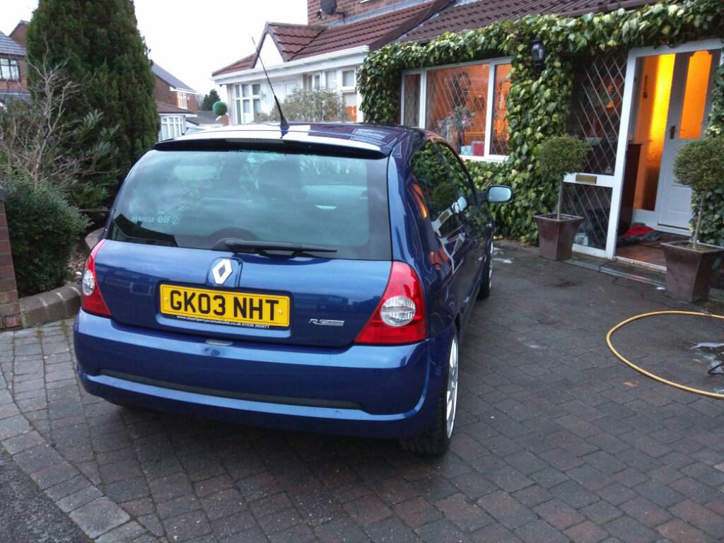

I realised earlier in the day that I'd ran out of wax/sealant so nipped to Halfords and grabbed some AG HD wax. I have to say it isn't the best wax I've used and I'm not a massive fan of wax anyway but this stuff is fool proof. Put as much on as you want or as little it still buffs off with no effort.

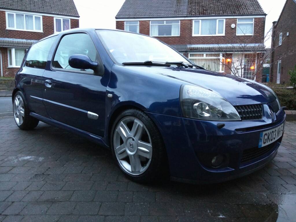

So as it was getting dark I stuck some tyre shine on and took a quick few snaps. (Some of them are from before tyre shine)
Much better. Interior still needs doing but I'll do that this weekend. Also the paint really needs some correction work doing!

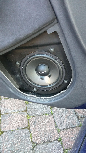

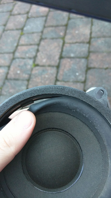

So my speakers have sounded like arse for a few months now and with another 'ring trip coming up I decided the ~2000 miles I'll be doing would be too much to put up with s**t sounding music.
Ordered myself some pioneer replacements and set about getting them fitted.
Old Torn Speaker
by Rhys Bartley, on Flickr
New Speaker
No wonder they sounded ruined! I've also ordered plugs, filters, oil etc to service my car at the end of the month when I've got a week off.
