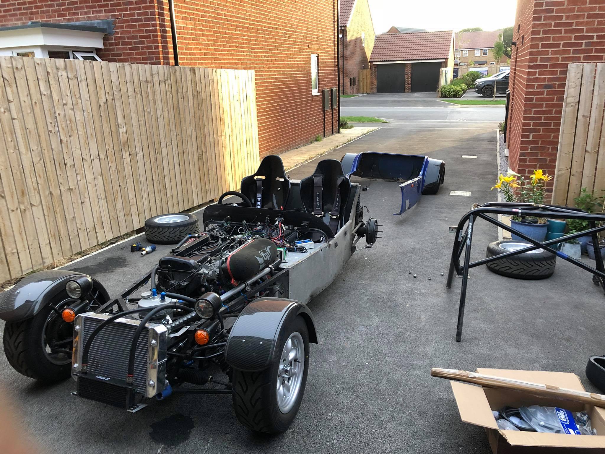

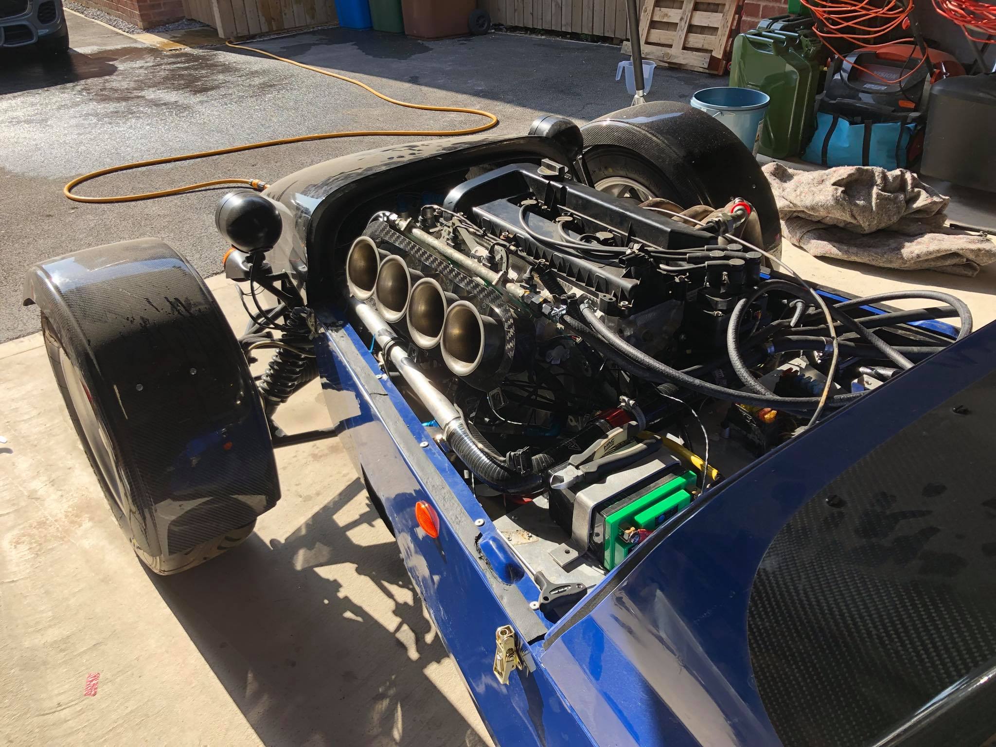

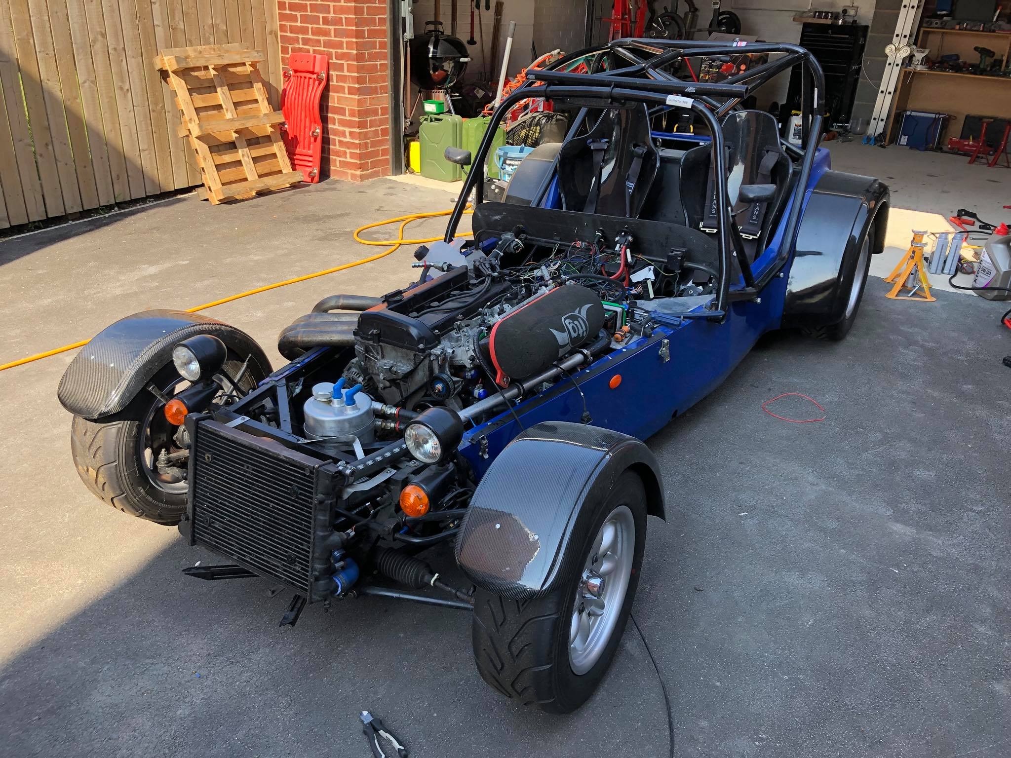

Its in and the car is back on its wheels. It even starts. Slow going but we are getting somewhere!

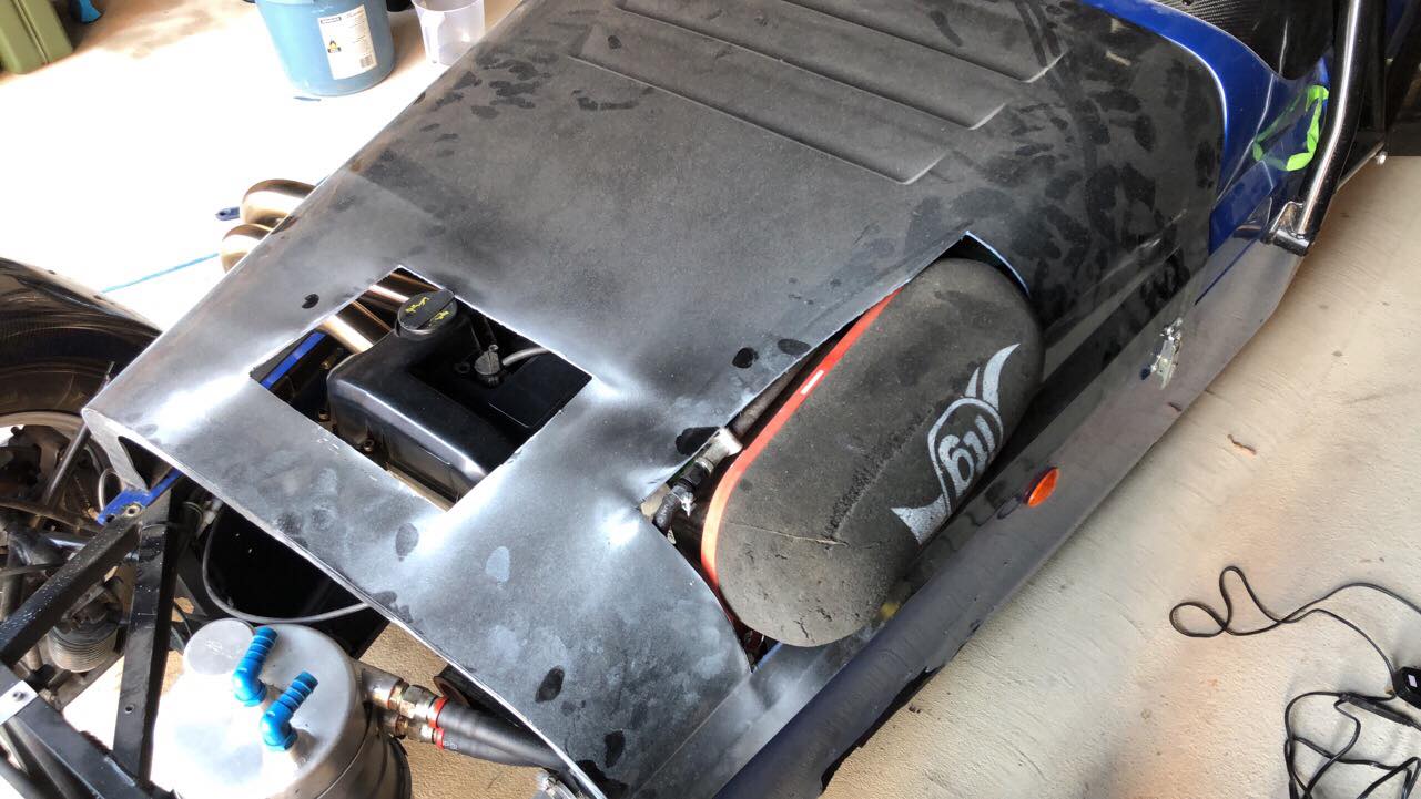

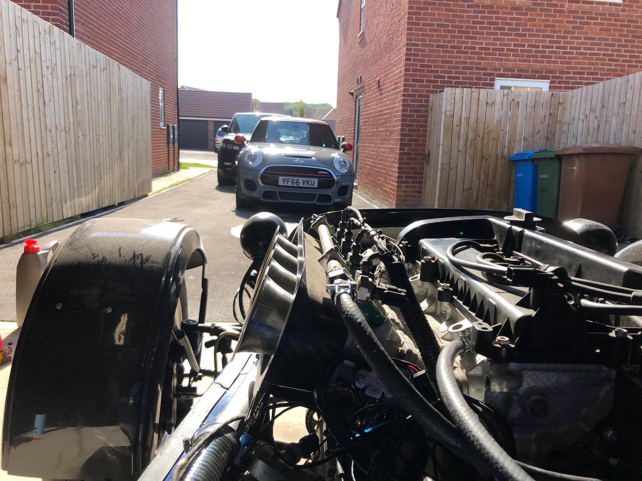

Only issue is... most of the induction side is higher than my bonnet line....
massiveCoRbyn
  Several
Doesn't look like it fits. Maybe it's better if you scrap the whole thing and give me the engine to put in my rally car?

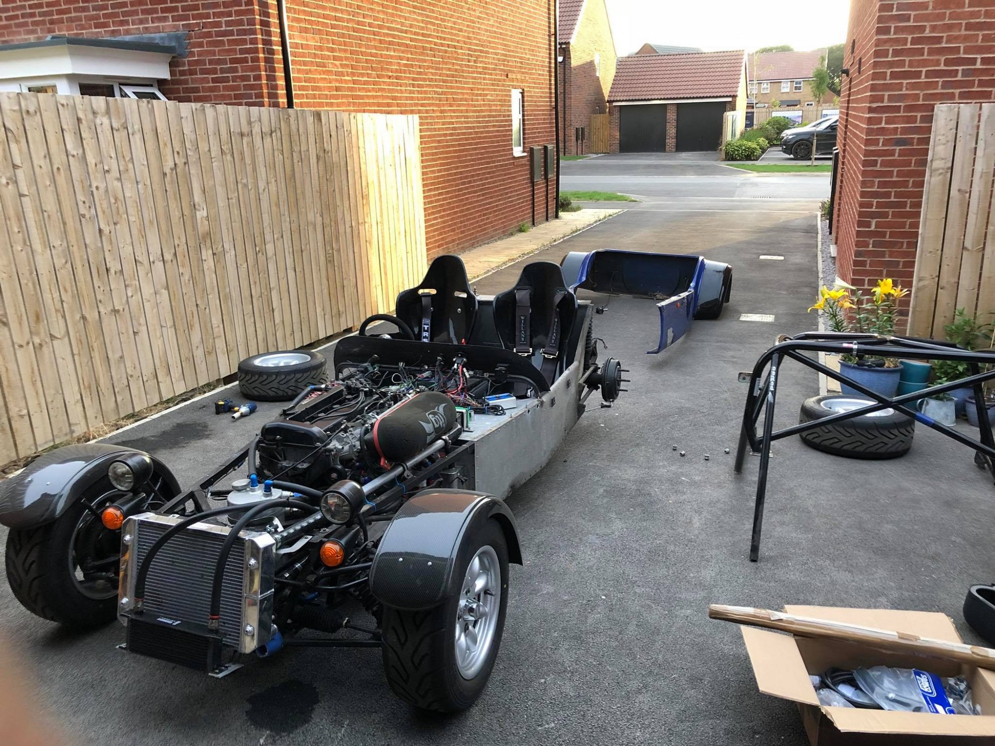

Cut an appropriate hole for the filter to bike through

i think you can get engine mounts that will drop that enough to get all but the filter under the bonnet just . I am sure i got shorter more solid rubber mount sections to drop on to drop mine , it was a tight fit .
Waitaboutery
  Alpina D3, AC Cobra
Sadly I'm only 1mm above the chassis hoop at the moment, so I can't really go any further down. The Aero Race chassis really weren't designed for tall Duratecs.
I could cut the hoop off and then put smaller mounts all round but that'll cause me fouling issues with my dry sump lines. I'm leaving it as it is atm.

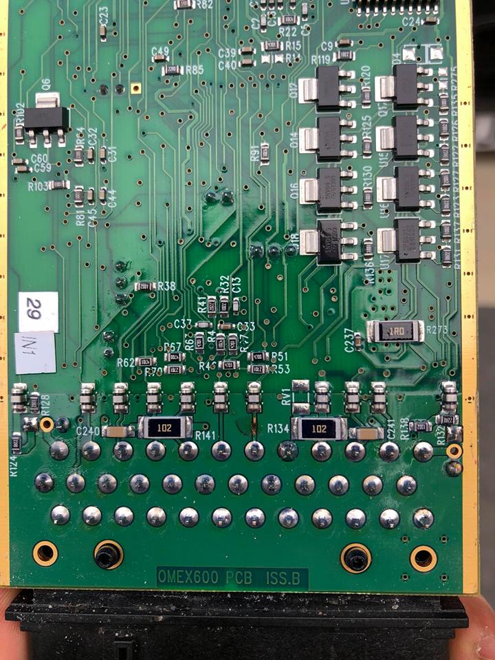

Finally got round to buying a new garage laptop so I can check all the ECU feeds.
Low and behold, all the sensor inputs are off the charts. TPS 100%, temp 100 deg, cranks permanent signal. f**k.
Everything was getting a 5v feed. So, I took the ECU apart. Not sure if it was a good idea. Anyway the sensor ground was fucked. I've re soldered it and all is well! Totally winging it. See near R134...

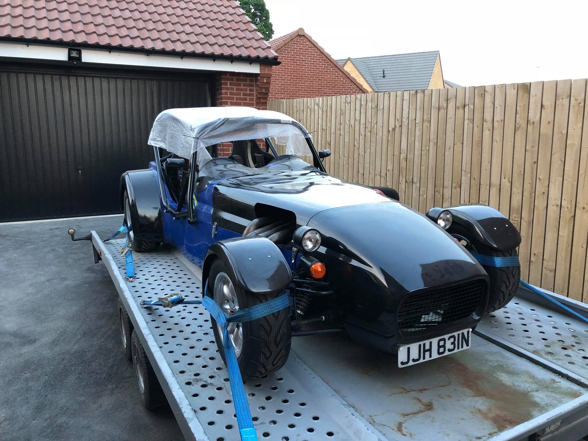

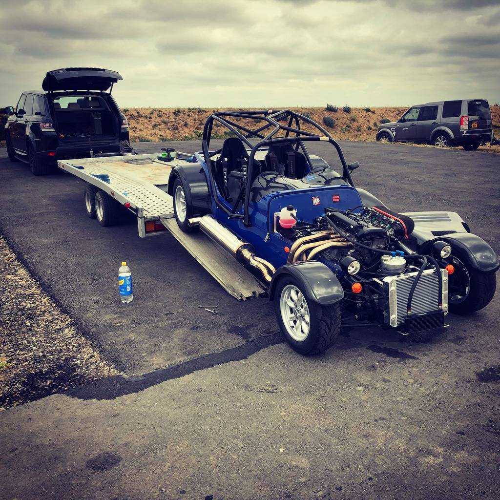

Dragged it out last night onto the trailer. Made a make shift roof as it was outside all night...
Going to a custom exhaust place today, so its got a ride out to work the AM.

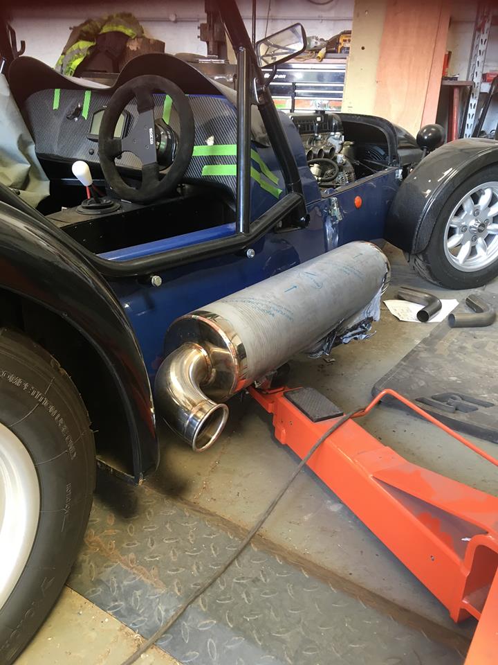

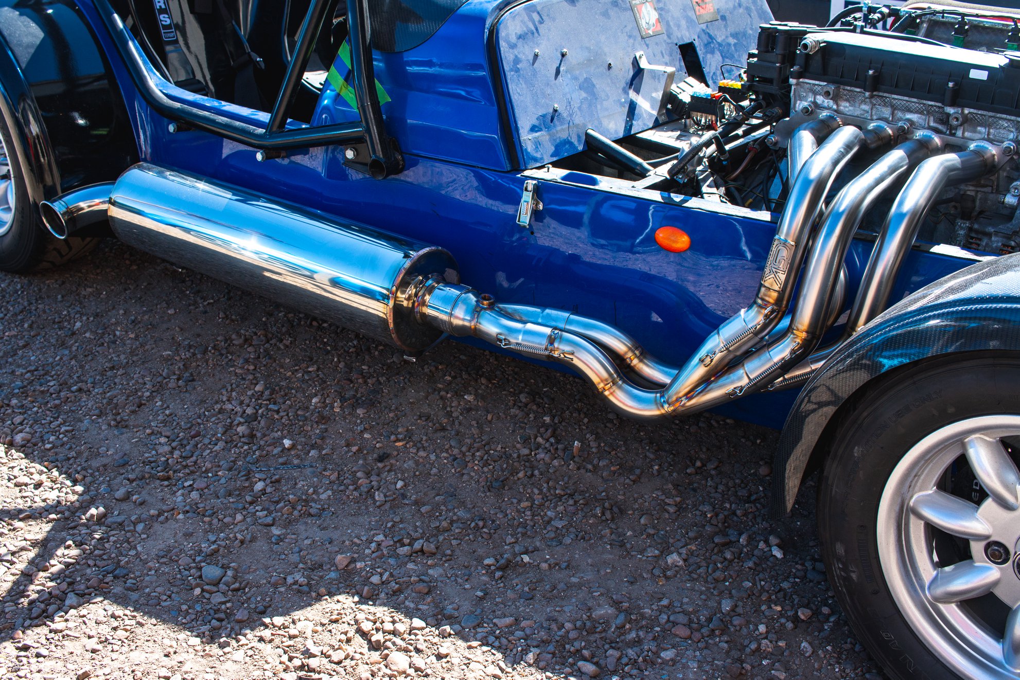

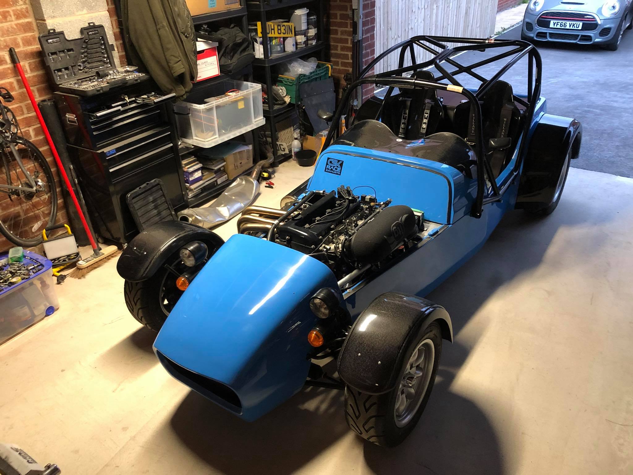

New sexy exhaust is done.

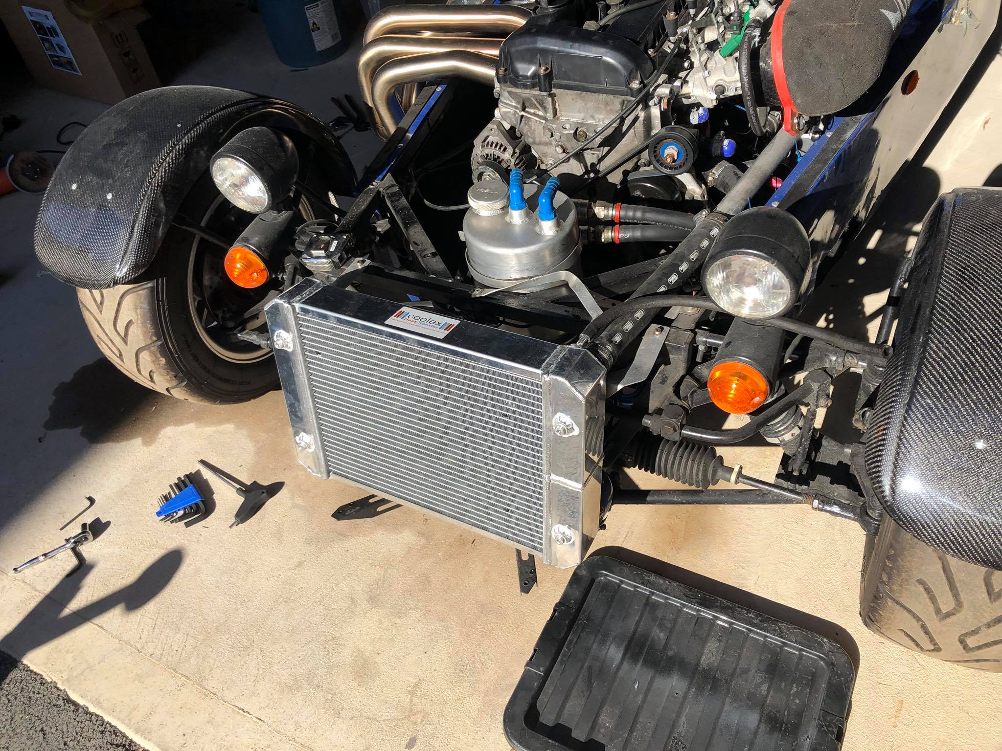

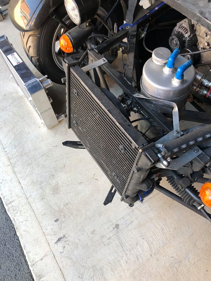

Got it all running in 30 degree heat and found it was strugging to hold a steady temp and idle even with the fan on.
Big rad time!
Old rad:
New big rad:

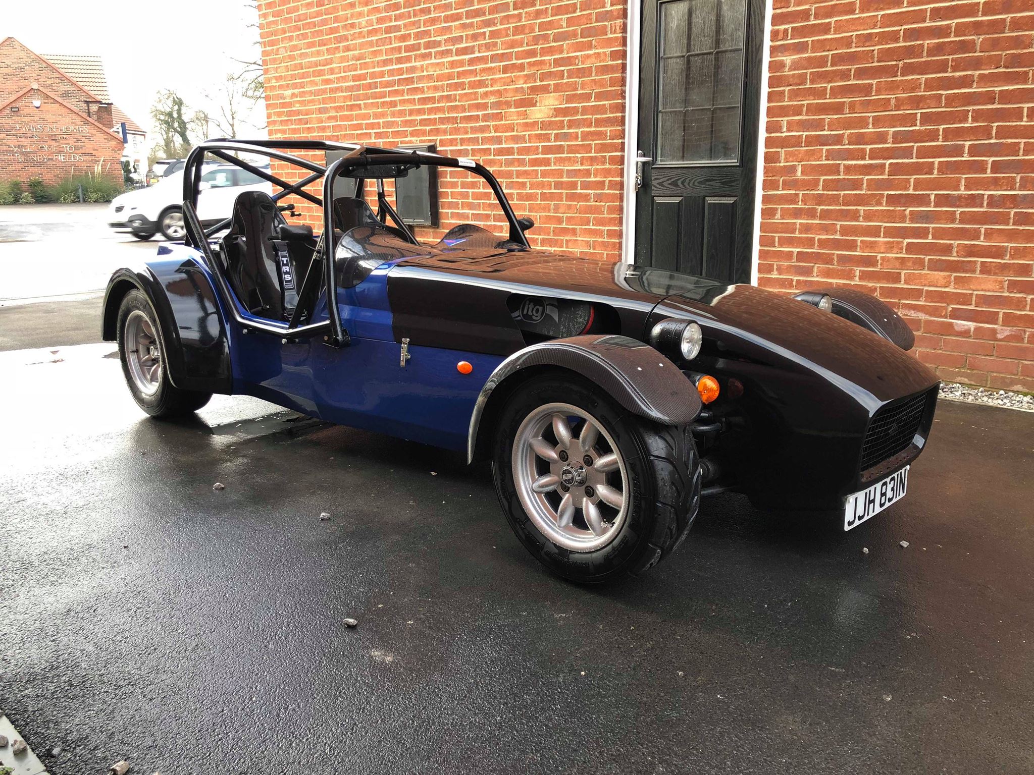

Oh yeah, bonnet didn't fit, cut a hole in it..
Ordered a whole new body for it too, to come in August.
