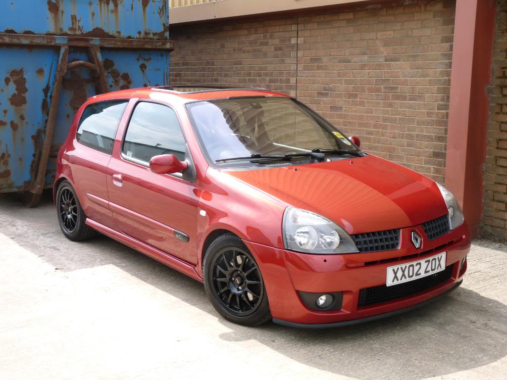

Looking Good Bro! Were Did You Get Your kit from?
Bought the bumpers and wings etc second hand and I used all the mechanical parts from my old ph1 clio

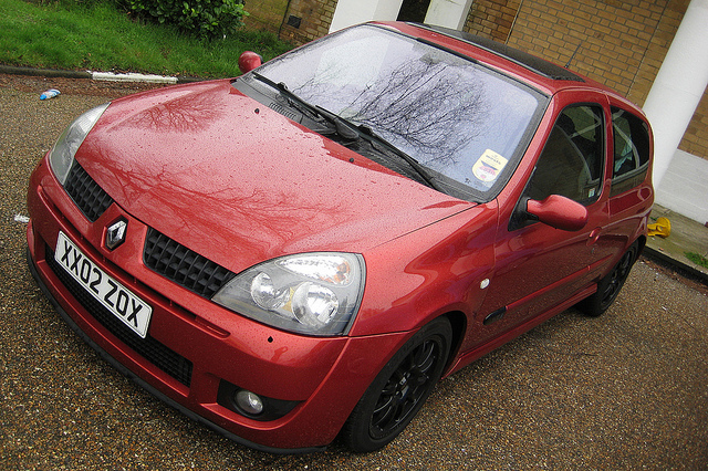

Fitted the RS200 steering wheel today - will post pics soon.

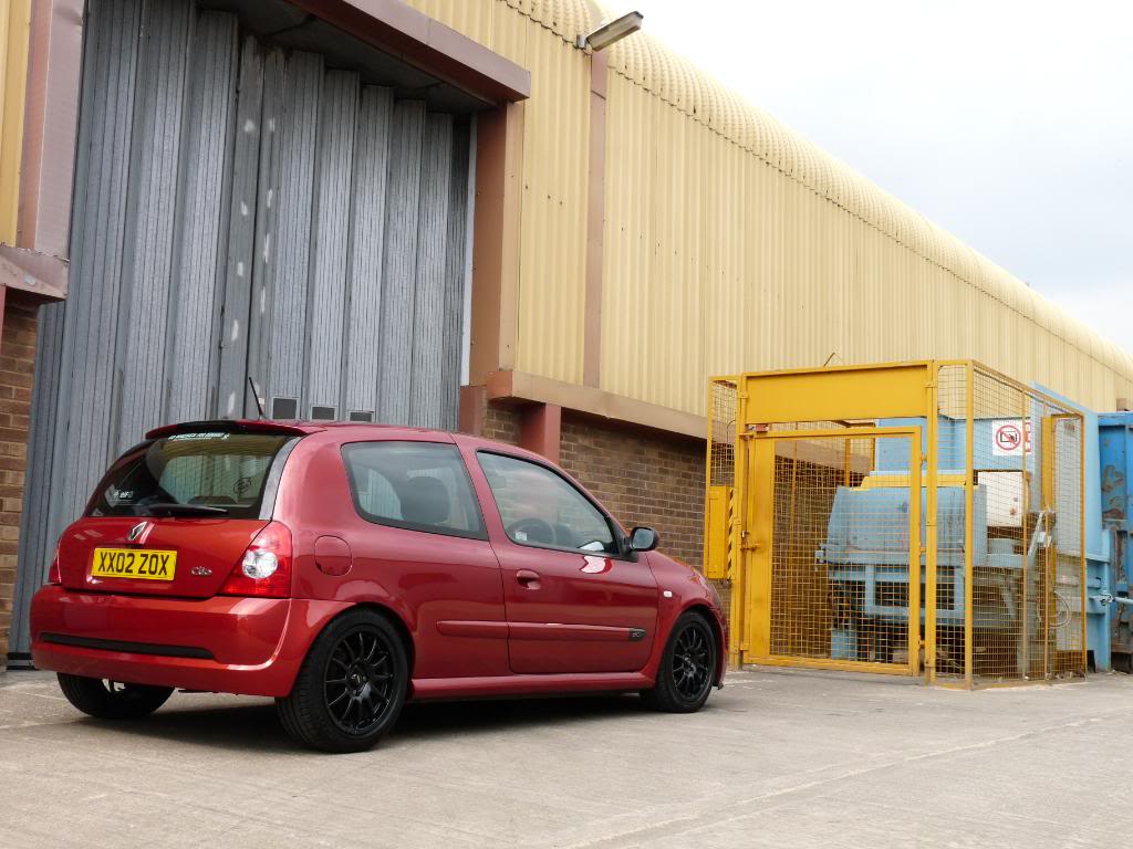

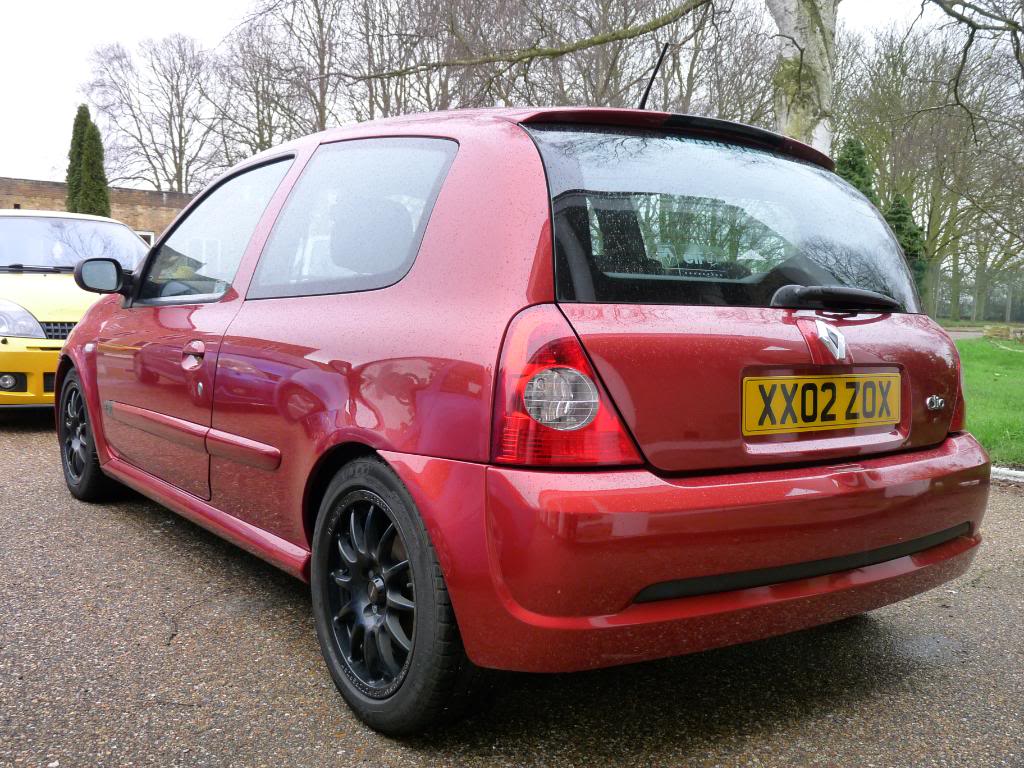

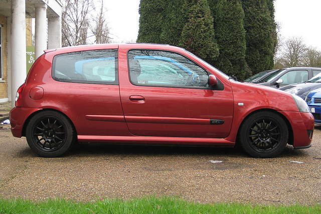

Quick update of pics of how she stands at the moment though after a coat of poor boys black hole :)

Really good progress! Liking It. Can you tell me the what wheels they are you have on? The first set you had from your Ph1.
  Discounted 1*2 parts
Re: Flame Red DCI 80 Sport Rep

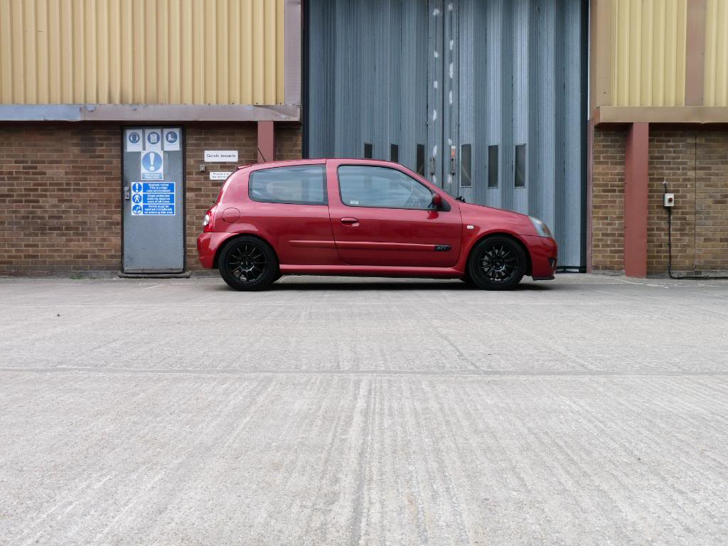

The first wheels we had were OZ F1's in 15" (these are standard on the ph1 172) and the wheels I have now are Team Dynamics Pro Race 1.2's in 15"
  Low!

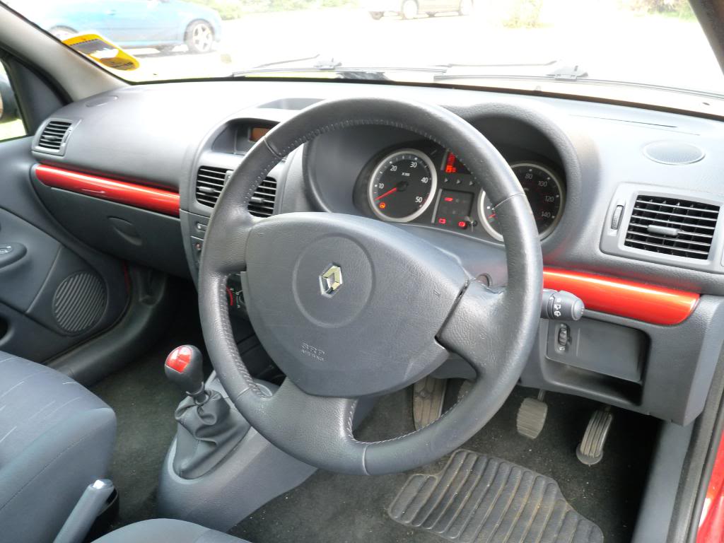

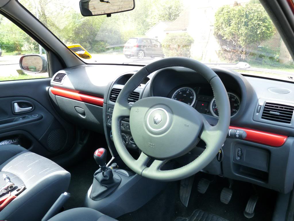

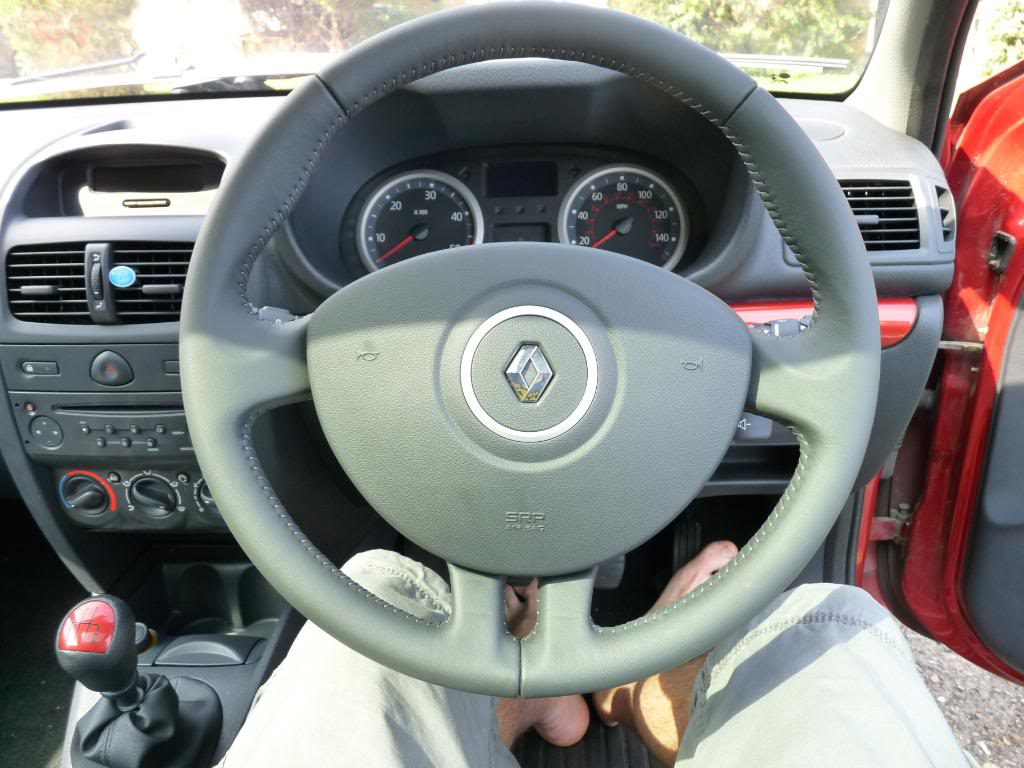

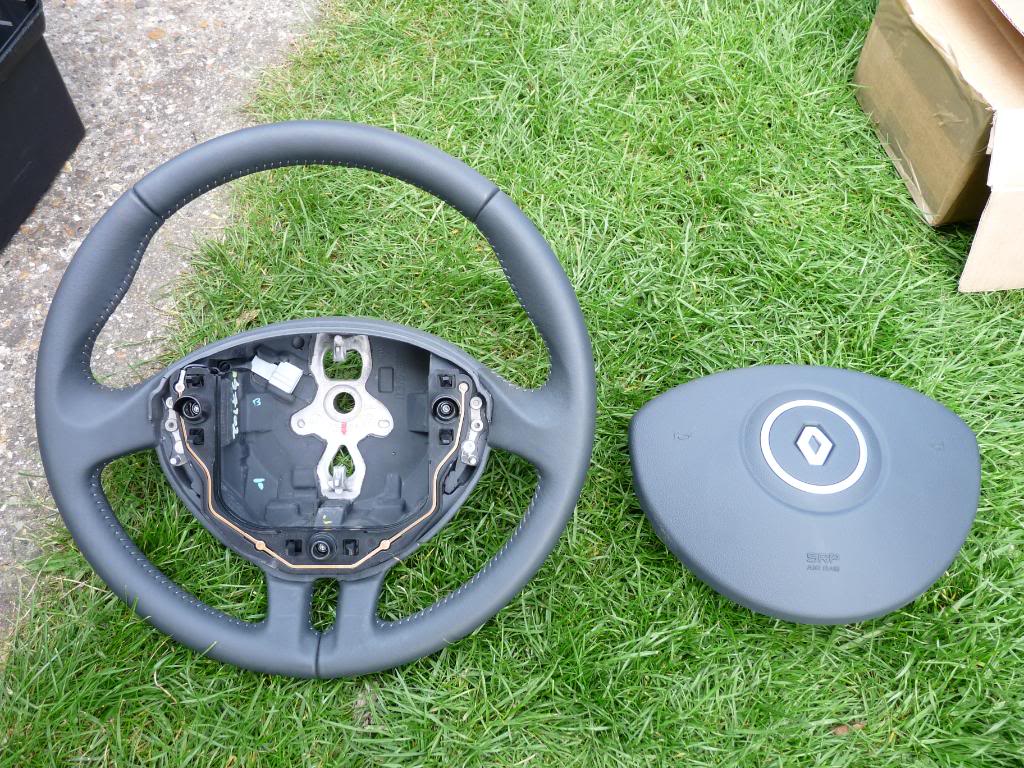

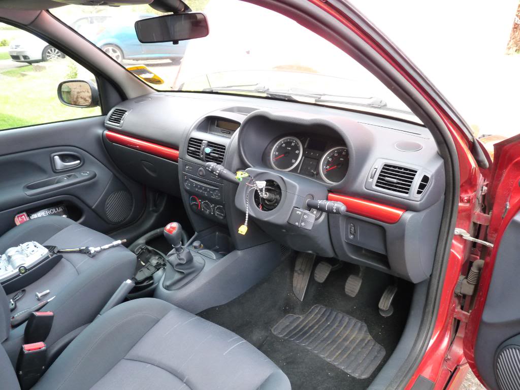

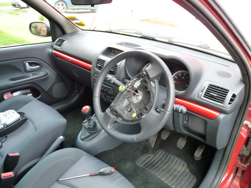

RS200 steering wheel now fitted - a few pics of the installation
Old steering wheel
Airbag removed - 2 clips on the back of the steering wheel
Old wheel removed - T50 torx screw

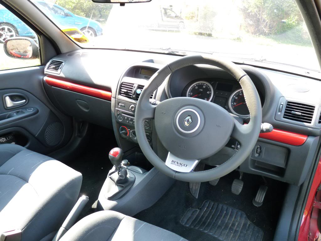

New steering wheel and airbag

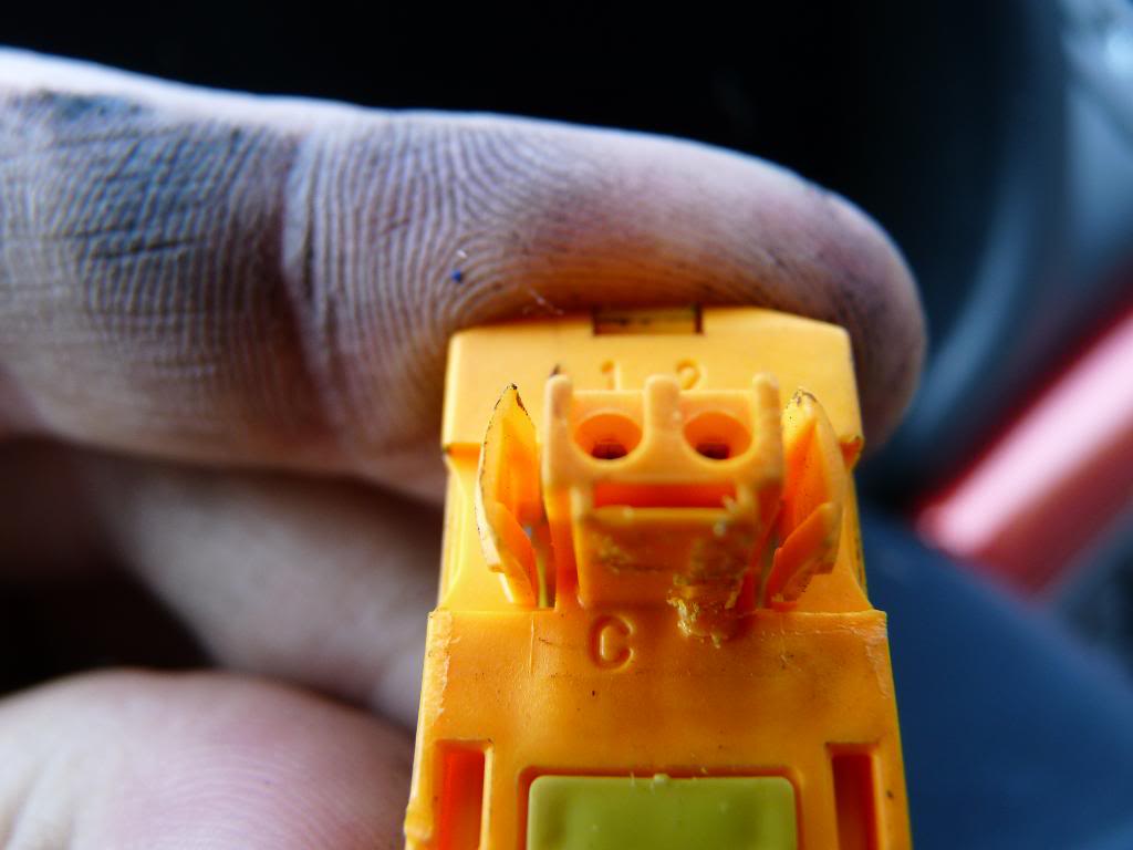

Airbag connections - the green connection fits fine but the orange one had a lug in the wrong place so I cut it off and filed down!
New wheel on
Fitted Renault Sport steering insert

looks a bit dishy... does it sit any closer?
Yes it does sit a bit closer to you which gives a slightly bigger reach to the wiper and light switches etc. OK for me but the other half didn't like it to start with!
