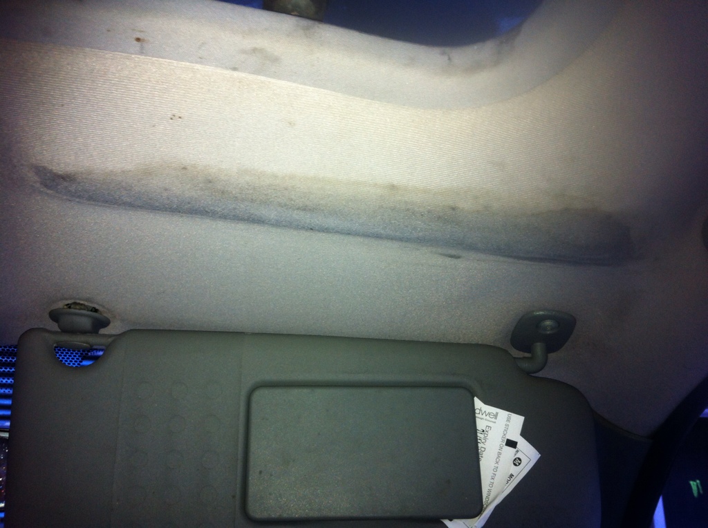

Sooooooo, after all the shitty weather i noticed that my drivers seat was wet and the lining behind my sun visor was soaked. Drainage pipe blocked do you reckon? Amd how easy is it to find a blockage in your bulkhead and take your sunroof out?

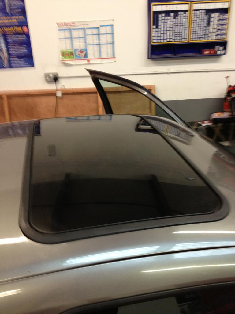

Needed a new seal as the original had come away from the roof sheet. Water was getting in under the frame and making some nasty marks on the head lining and seats.
Yeah im thinking maube its only when we have excessive rain like yesterday. Gna rip the sunroof out sunday and give it a good clean. The seal seemed fine so might be the hinges.
I have the exact same stains on my drivers seat and headlining, i had my sunroof seals changed 18 months ago so i'm sure it can't be that. I'm assuming it must be blocked drains. Although the clamp that locks the sunroof down is broke although its still fully operational im wondering whether that is causing a leak?
i know mines an electric sunroof, but my seal gasket failed under the plastic trim, had to unbolt the sunroof, take the crappy old gasket off with a scrapper and i sealed it again with black waterproof silicon bathroom sealant. not had a leak since. ( done months ago and we've had heavy rain on and off over here for a while )
My brother had a similar problem with his Clio, so rang a local place that repaired sunroofs. They suggested rubbing Vaseline into the rubber where it meets the glass and it worked a treat.
