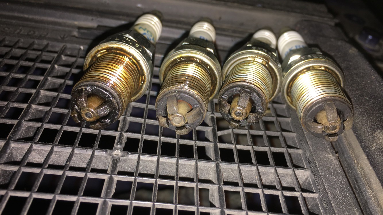

So I changed the sparkplugs on my 1.8 16v and notived that they are a little wet, but I don’t know if this is too much or if it’s normal for the age.
I just want to know if the piston rings are bad or something like that or if the engine is fine.
I have never seen blue smoke from the exhaust btw.

I was talking about the part of the plug that goes into the cylinder (don’t know how its called exactly)
looks like 2 cylinders are burning richer, could be injector problem, could be compression problem, easy enough to check for both, can swap injectors around and see if the wetter and blacker plugs follow the injector, and compression test will show if there are bad cylinders...
check the rocker gasket again, they are a pain to get right and that above is typical symptom of oil leak from the rocker into the plug wells

One explanation is the gasket was replaced, but the plugs/plug holes were already full of oil and you're just seeing the mess left behind from the previous leaking gasket.
The plug on the left of the picture (No1 gearbox end) is not firing correctly, and No3 does not look much better.
Talk about gaskets & oil on the threads is irrelevant.
To check the condition of the piston rings, start with a dry compression test, followed by a wet compression test. ( A measured 20cc of oil squirted down the bore from a syringe )
If cylinders 1 & 3 improve significantly over 2 & 4, there is a problem with the rings.
If there is not a significant improvement with the wet test, but the compressions are inconsistent between cylinders, then you are looking at a valve sealing problem.
Compressions should read 180 psi or 13 bar ish, but all being the same is more important, as I doubt the gauge will have a calibration certificate.
You need to do this before looking elsewhere.
As you have confirmed the plugs are pictured in order, this has eliminated a coil pack problem, thank you.

If you bang in a 4 electrode plug into a system powered for a 2 electrode, you end up with 4 weak sparks, rather than 2 good ones.
But that`s by the by.
Crack on with the compression tests.
