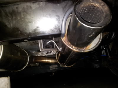

I've taken some pics if it helps at all, going from front of the car to the rear this is what there is now...

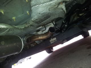

The 1st I come across is this small triangular type rubber on a stud after the cat, and i think a silencer...
from Nearside (passenger side)
from Offside (drivers side)
rubber is splitting and so will need to be replaced soon.

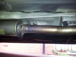

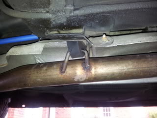

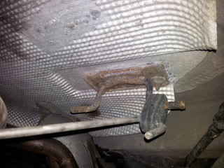

2nd is after the exhaust has gone over the torsion beam, where the exhaust pipe splits 1 into 2, and is located slightly offside of centre...
looks like there should be two oval rubbers to hook two hangers through? only 1 hanger and rubber present.

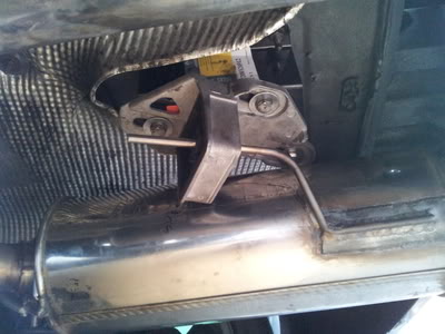

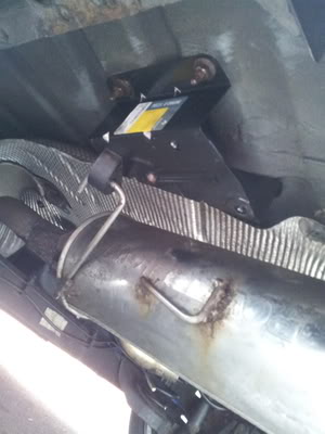

3rd is located on the nearside, to hang the nearside silencer from
2 more triangular rubbers, need to replace one rubber and put a hanger in place.

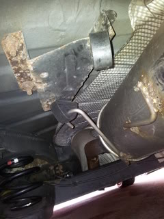

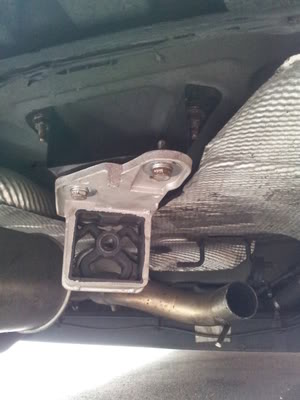

4th is in the centre but supports the offside silencer (you can see the 2nd mount again in the background)

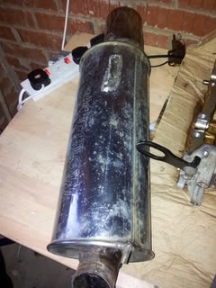

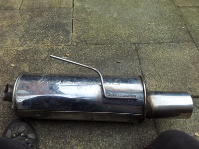

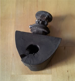

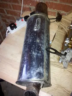

With the help of a mate, i've removed the offside silencer. all that was holding it up was a bodged split rubber (below), screwed onto one of the four studs you can see in the top left of the image above...
and a hanger (which had broken off)

As I said above I couldn't get the new mount to fit whichever way around I put it; eventually realised (after searching CS) the problem was that I didn't have the plate which fits onto the 4 studs, which the OEM mount bolts on to - someone had obviously removed it in the past. Looking at the last pic in my first post, the nuts welded together are those which fixed it in place originally, and whoever fitted that bodged metro rubber decided the plate was no longer necessary. morons. New plates from Renault Loughborough (£25.00ea).
Nearside silencer - the metro rubber was splitting, so needed replacing. Not as easy as it looked - needed to remove the plate, replace the rubber, hook over the hanger, twist back into place so that the plate slotted over the 4 studs and bolt back in place. Fiddly, but sorted. Plenty of copperslip used so that next time will be easier.
Offside silencer - the original hanger had broken off at some point, gauging a hole in the outer skin of the silencer. My mate kindly TIG'd a steel plate in it's place and spot welded a threaded bar on so that we could mock up a replacement hanger. Using the new plate and OEM mount we mocked this up in place. The MIG then broke so had to leave it until the morning when I asked the lads in the workshop to bend and weld a new hanger for me (massive thanks to them!). With it all welded in place, it was simply a case of bolting it all back together, again with plenty of copperslip.
Hole in silencer
