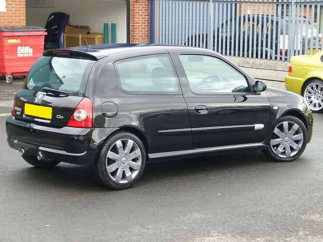

Never mind. At least it confirmed to me that I definitely want a 182 with all of the toys. With that in mind, could anyone have a look at these pictures and tell me which Cup packs (if any) this car has?
The advert simply says "RENAULT SPORT CUP PACK".

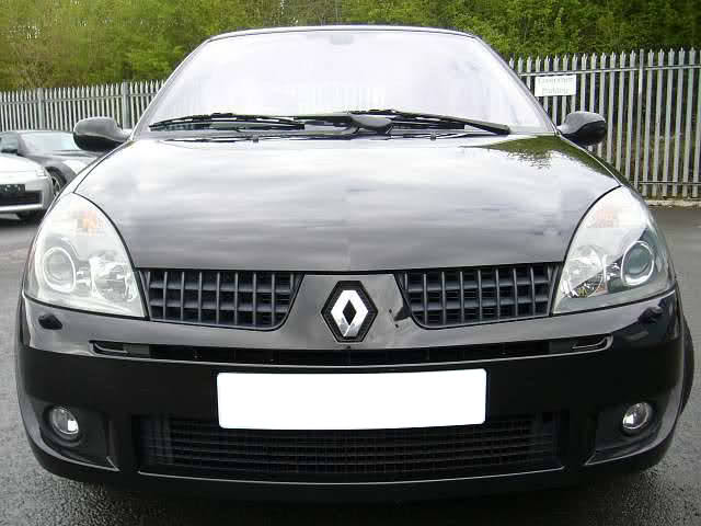

I'm not familiar enough with the normal 182 to tell the difference spoiler wise, though unless I'm missing it (which is entirely possible), I can't see the front splitter that I think the Cup spoiler pack gets you?

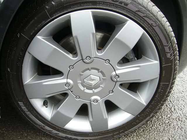

I also can't quite tell from the pictures which [shade of] alloys are on here and hence if it likely has the Cup suspension, which is more important to me than the spoiler. I think. :)
Thanks.
The packs are..
Suspension and wheels.. Which those are cup packed wheels
and then spoiler/splitter. I cant see a splitter but its highly likely its broken or the dealer just didnt fit it. But that looks like a cup packed spoiler to me.
So id say thats got both packs :)

^^^ i'd agree, but always the possibility someone just put 182 cup wheels on it.
  VX220 Turbo
difficult to tell on the spoiler but it's missing the front splitter if it's supposed to have both packs fitted.
£140 from renault (might help you nock some cash off it)

b. I wasn't even wrong about the front splitter.
c. Looks like it probably has the suspension pack (though I am aware it may just be the wheels).

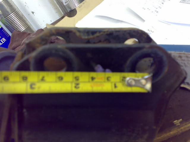

or whip a wheel off. The bolt spacing is 60mm to where the hub bolts to the suspension leg :)

Measure here,
My opinion of that car would be it has cup suspension option, and did have the spoiler pack, but the front splitter is missing. As DRrollo said some people just put the Anthricite alloys on to make it appear to have cup suspension. Only real way to tell is to measure the bolt spacing (60mm)

it's a 60mm bolt spacing.... cup suspension only lowers the car by 3mm...
See post 14......... by measureing this it will 100% tell you if it has the cup suspension fitted......
Thanks, it's appreciated. What I meant though was the difference between the 60mm of the Cup and the (according to the 172/182 buyers guide thread) the 54mm of the normal 182.
I could guess that I might not be able to accurately tell the difference in less than ideal conditions. But it might be more obvious than I think I guess.

Aye, its 60, to the middle of the holes...... I'd always check this if in doubt. As sourcing parts can be tricky as the non cupped versions have different hubs etc etc
Quick update, I spoke to Renault (who were very helpful, I'm impressed). They sent me a full spec list for the car, including:
  • Extreme Pack
  • C Pack
  • Cup suspension
I assume by "C Pack" they mean the Cup spoiler pack. I don't know what the "Extreme Pack" is though.
