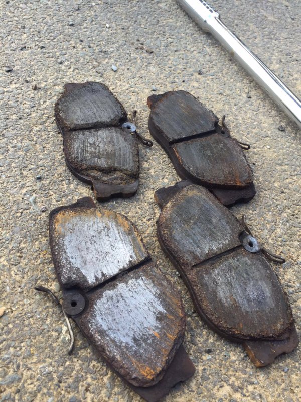

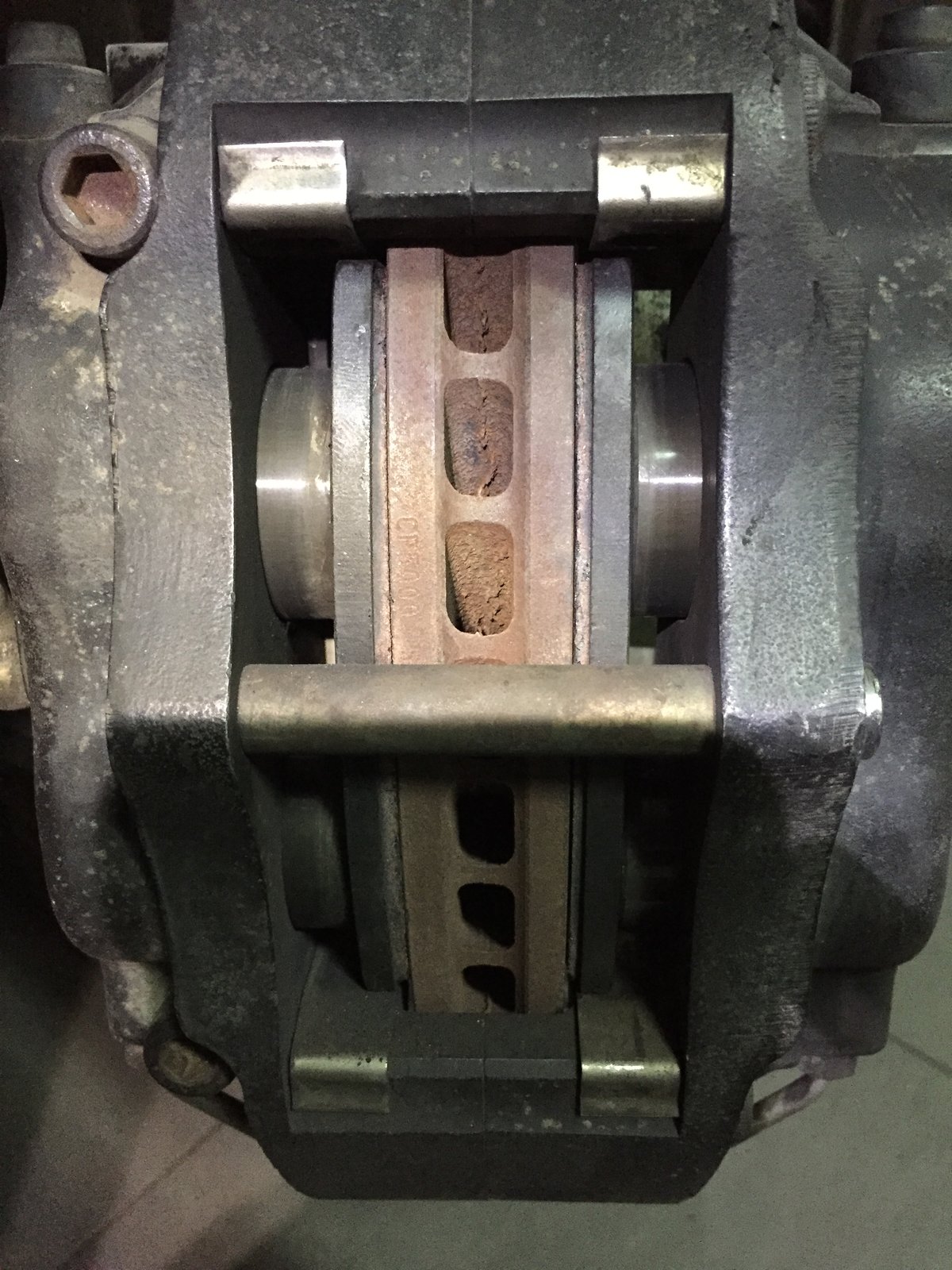

CP5100 AP racing calipers, 295mm disks. Ran Fedoro DS 3000 pads and only got 8 races (circa 200km) and they are toast - but race only car. Now aboit to try the DS1.11 pads which claim less wear - bear in mind I race in the heat of the middle east and have an 1100kg weight limit. Will know in three week how they work!
This is the pads after the eight races..,,

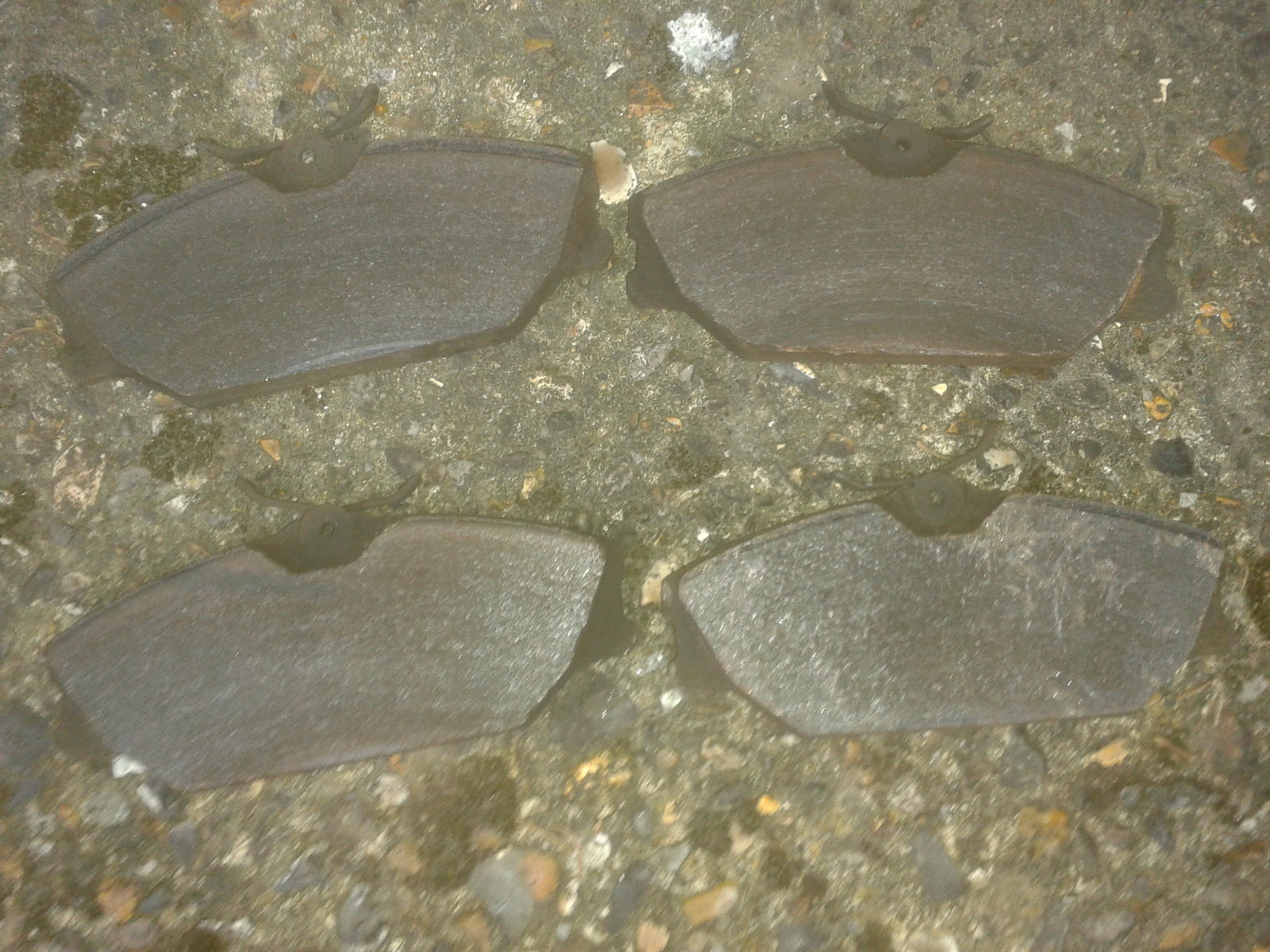

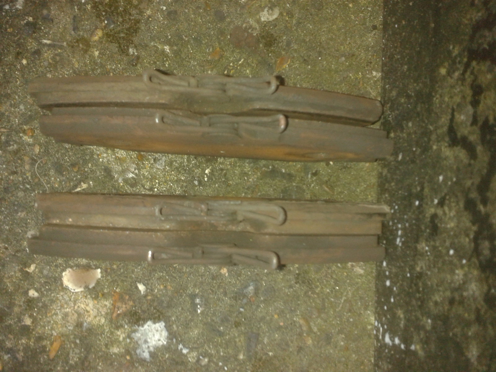

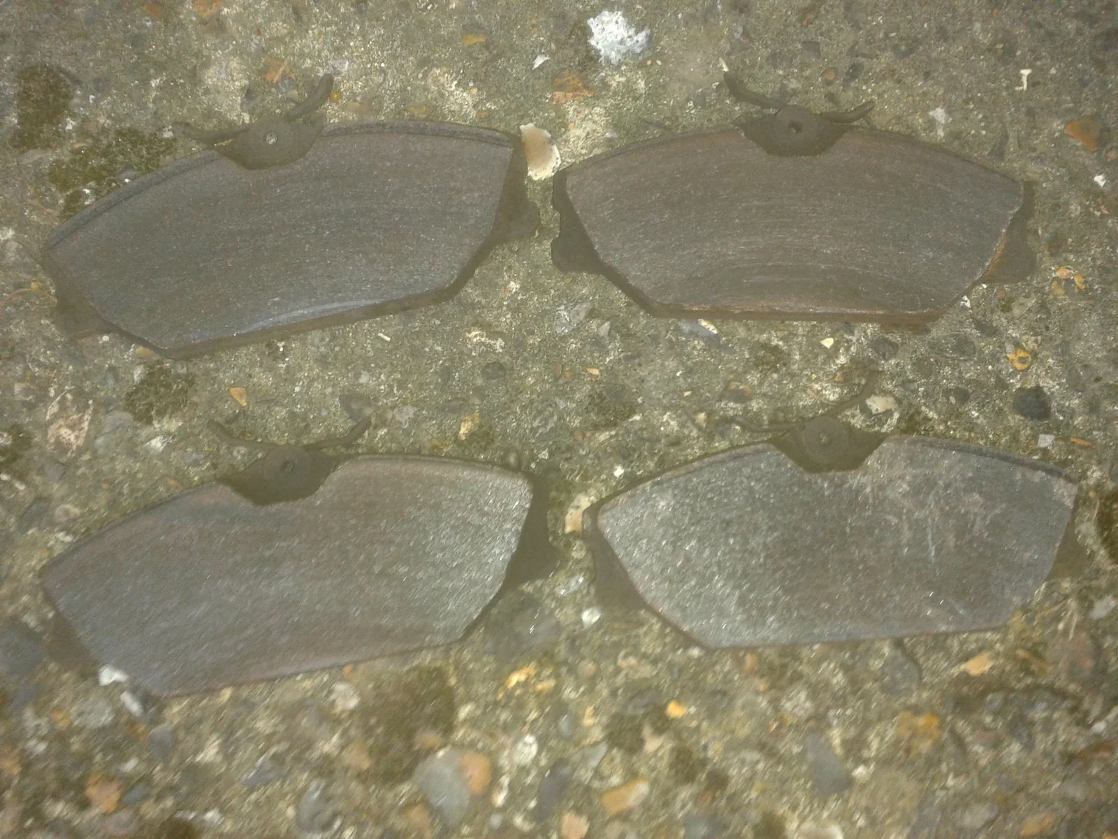

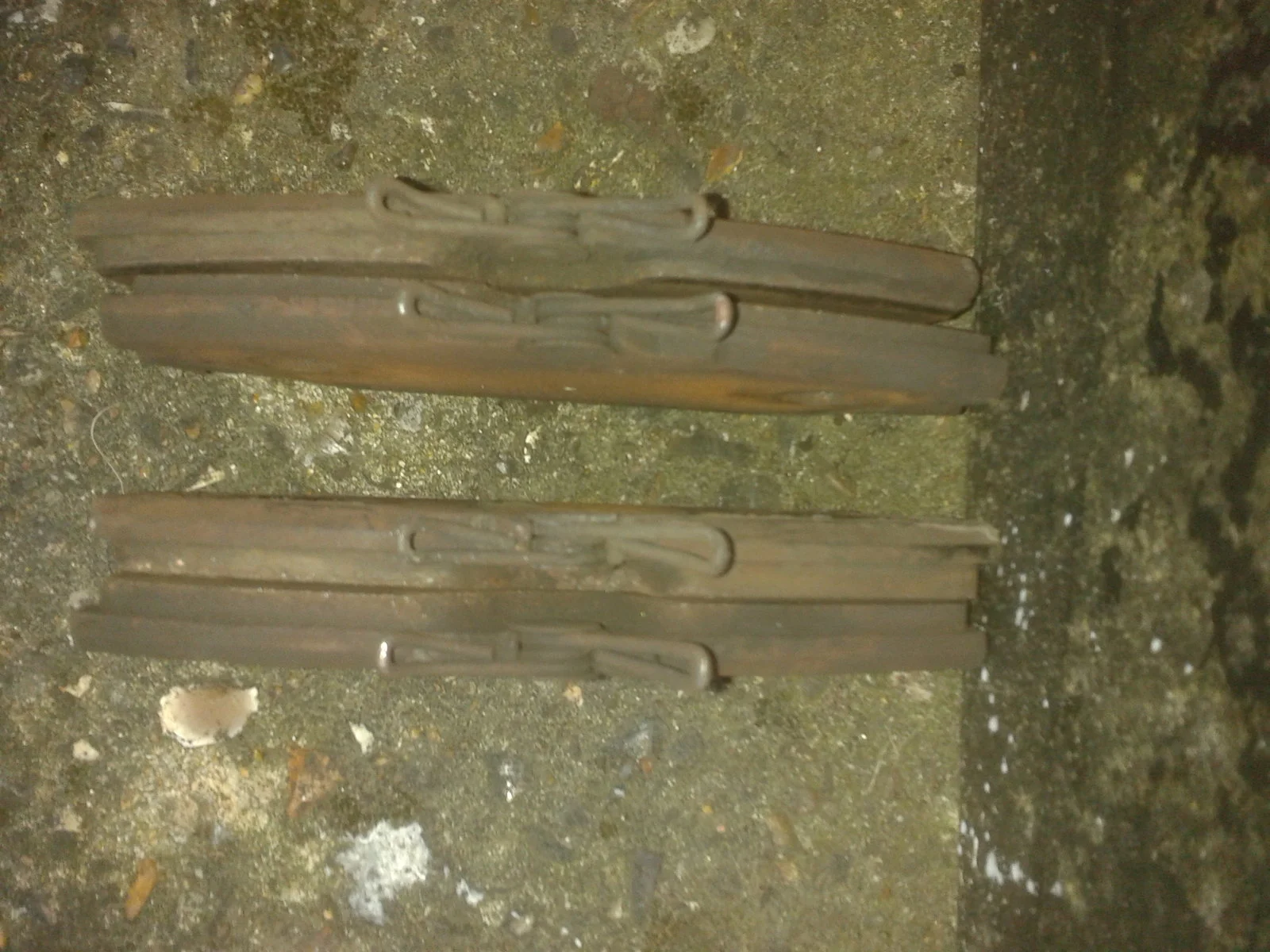

BREMBO PADS.jpg BREMBO PAD FACES 16K.jpg BREMBO PAD WEAR 16K.jpg I will continue to use HC discs & std Brembo pads.Replaced the pads a couple of week ago after 16k road miles & 8 hours on track at Llandow,Bedford & Blyton Park.
They did get a bit warm 1st time out on track after 5 or 6 laps as I started to build up some confidence,but I let them cool down for 10 minutes & after that they have been more than equal to the grip of the 595R`s,with no fade & very little dust.
I am impressed that there is no friction material cracking or disintergration,there is some still some wear left in them,the discs will do a 2nd turn & that I got some change out of £22 to replace them.
If you are just starting out on a budget,there are probably other basic running gear items that need renewing such as bushes,bearings,top mounts,ball joints,shocks etc rather than blowing a wad on exotic pads.
